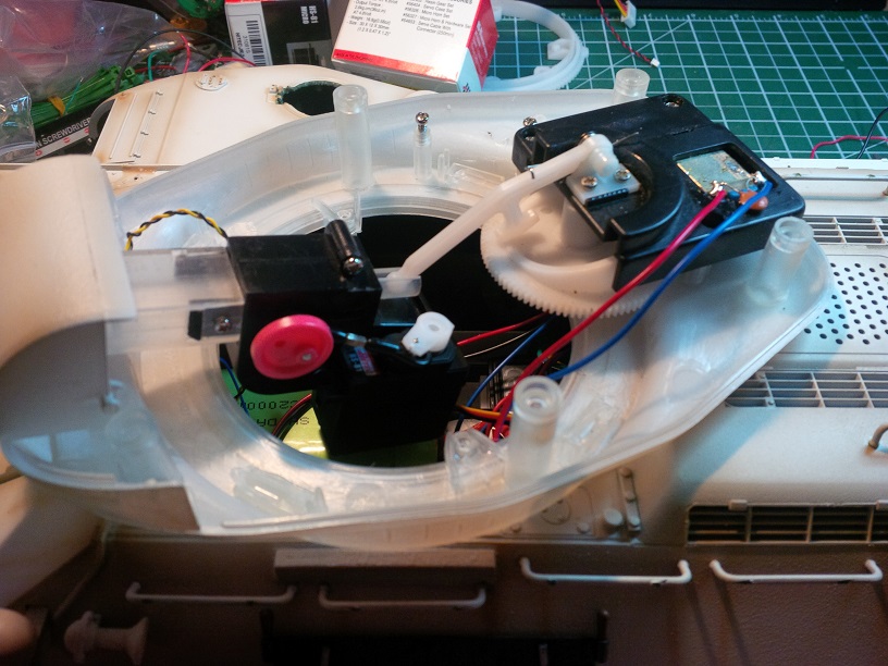

In the process of helping dgsselkirk put in a clark board on the T34/85 but the WSN recoil unit although matches wiring wise becomes really funky so have to look for another solution. Attached is the servo recoil using the WSN recoil frame. Simply gut it and keep the rod/gear connecting the gun barrel and that's it. No cutting or re-shaping any WSN parts.
