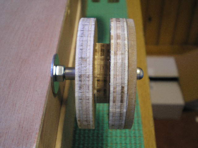

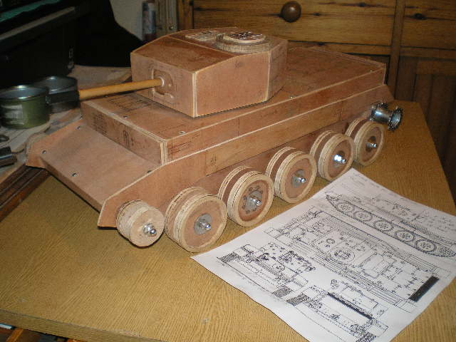

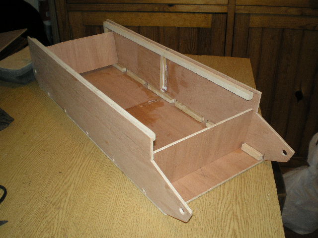

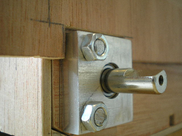

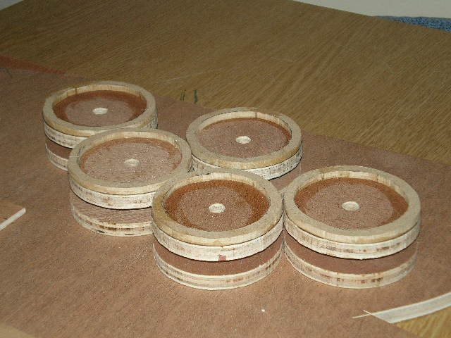

Hi, Here's some pics of my latest tank build. The hull and turret are made from 3mm ply from stermat stores, and the wheels from 8mm ply. There's a few more pics yet to come. Regards Geoff C.

Hull, wheels and turret.
Double wheels in ply
Wheels made from 8mm ply.
8mm pillow bearing from Motionco.
8mm bearing.JPG (69.69 KiB) Viewed 2327 times

Basic box hull.
Basic box hull.

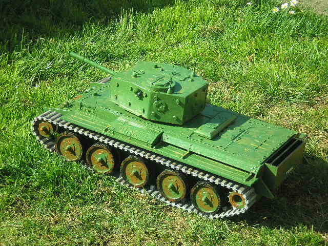

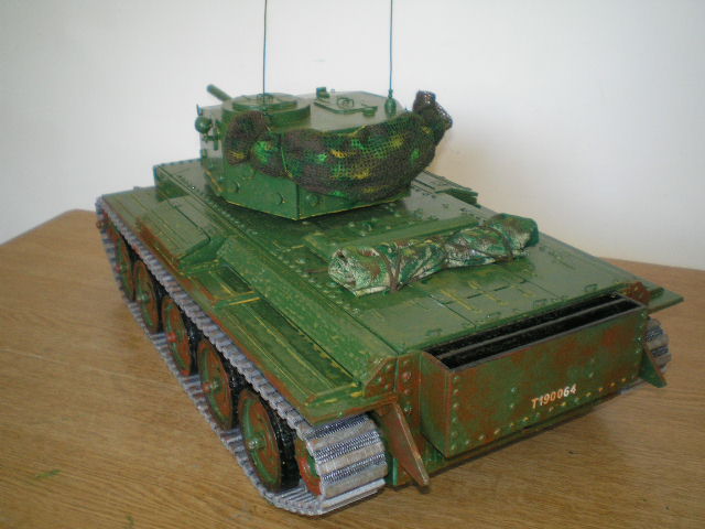

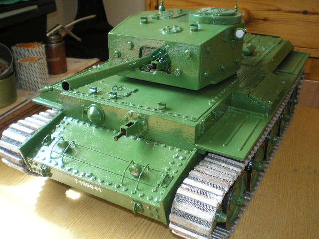

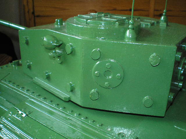

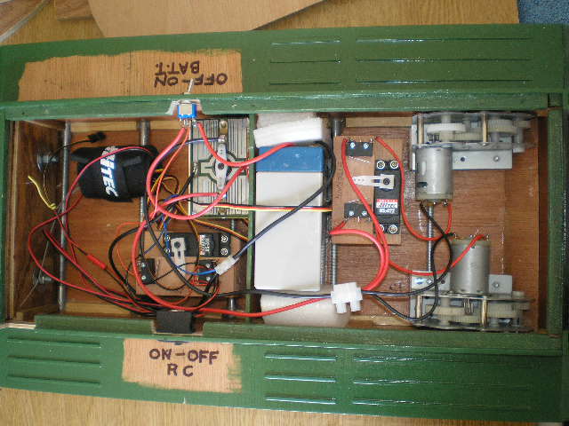

Hi, A few more pics of the build.
Side view showing weathering effect.
Rear view with Cammo nets.
Grass trials
Grass trials
Turret details.
Turret details.
Front rivet detail.
Front rivet detail.
Front view.
Front view.
Interior layout.
Interior layout.

nice work mate i like the 2 switch 1 servo speed controllers set up

The two switches in the front half are for left and right Turret, and the two switches in the rear are kill switches for each motor for steering. The forwards and back is controlled by Bobs Board and servo. Regards, Geoff.
