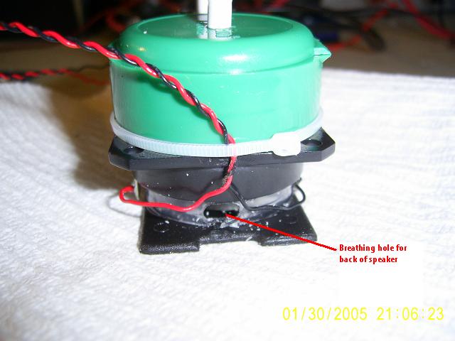

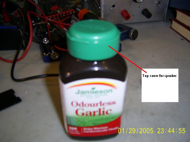

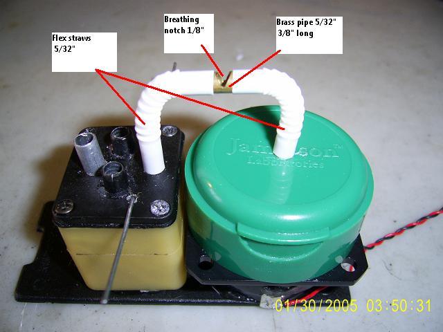

So is the speaker is in the green container and no fan needed?

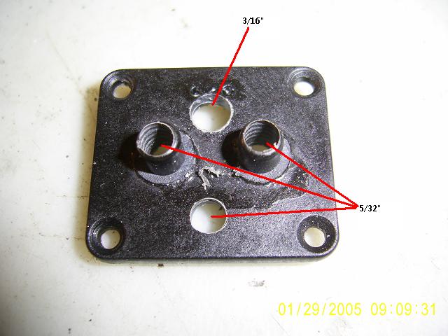

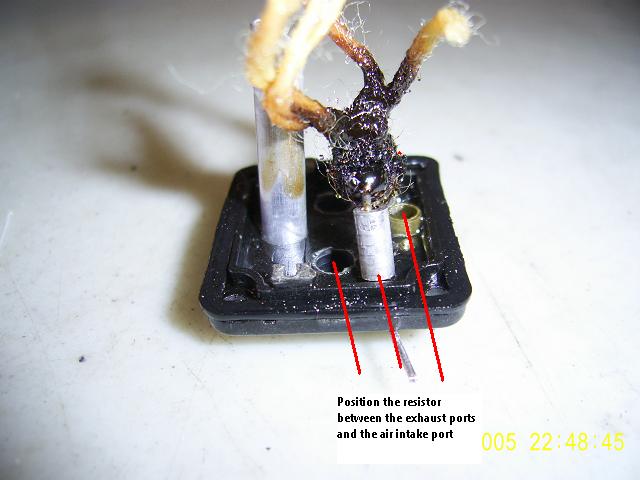

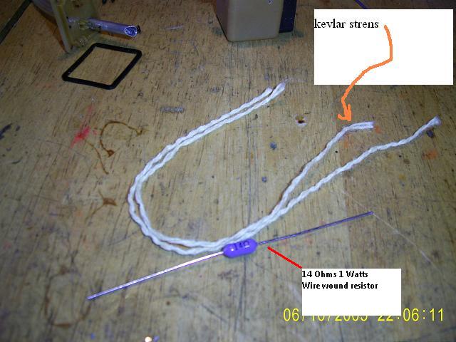

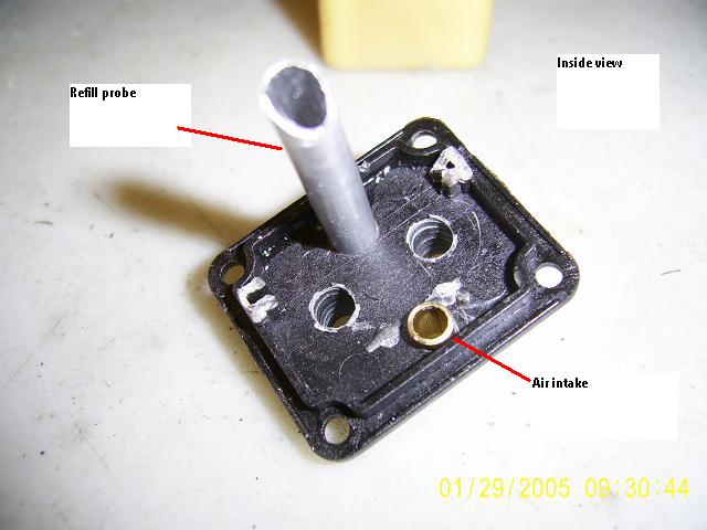

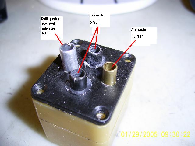

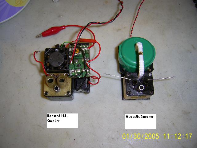

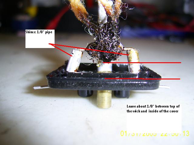

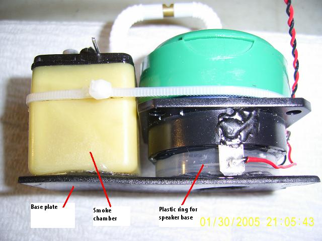

No fan, no piston and motor; just a small speaker and a smoke chamber....
As usual, I'm sharing pictures of the whole mod. ; witch is quit simple:

Your work on improving smokers is groundbreaking every time you post, I have tried to copy your ideas but never seem to get quite as much smoke as you do when I suddenly realised looking at that last picture (boosted HL smoker) that you turn the lid of the smoker round so its blowing across the heating element before reaching the outlets, where as the Heng Long standard smoker has the wick directly below the outlets and the leads the far side away from the piston.
Why didn't I notice that before - I'm off to turn my lids round

can i just ask, is the the resistor connected directly to the power source or do you use the resistors on the original smoke unit in the line? sorry just a newb at all this
Re: Acoustic Smoker latest design
I always connect the heater element directly to the power switch; even when using the stock H.L. smoke unit.
It does take the load of the transistor turning "ON" the smoke unit on the main board....
I usually wait for 1 minute to let the smoke build up in the unit before starting the tank; so I got a big puff of smoke when the engine starts...
