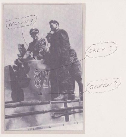

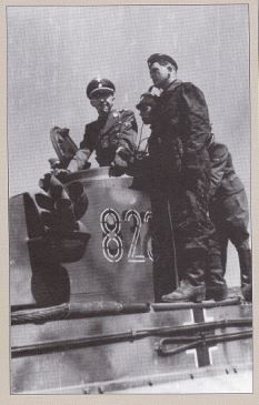

I thought I would check with the residient Tiger experts, here.
I have been researching Tiger I's of 8/SS Panzer Regiment 2, in the spring of 1943, pre-Kursk.
There is some reports that indicate for a time. they had Tiger I's that were grey, with patches of yellow and green.
I have seen reports they took delivery of some Tigers in Feb 1943, I suspect tanks received in mid Feb were made before the switch to yellow in mid-Feb.
"Tiger In Action"supports this but "Tigers In Combat II" says they were yellow with green and brown.
My theory is that the grey tanks may have been camo'd with yellow and green between the time the winter white wash wore off and when they were re-sorayed yellow with camo for Kursk.
I have attached some pictures, it is hard to tell for sure what colours were present in the old B&W's.
I'll be sad if it isn't correct, I like that colour drawing

Sorry to resurrect this old thread, but I have new data to answer the question.
None of the Das Reich Tigers were ever grey.
They were delivered to DR in the first "tropical" scheme, RAL 8000 / 7008. This includes the first 10 Tigers in winter 1942-3 and the six additional Tigers in April 1943. (Source; Doyle and Jentz, plus photographic evidence.)
The first 10 Tigers were whitewashed for the Kharkov battles.
In late March 1943, the tanks were painted again. The colours used are not known for sure, but it seems there were 3 colours, two dark and one light. That strongly suggests the standard paints (red, green dunkelgelb).
Glen, you were asking about Tiger 823. It's the only DR Tiger where we see a white number painted over a black number. This can be now explained thanks to some photos that surfaced recently, like so;
The crew of 832 cleaned the whitewash off their tank in February-March sometime. This left them with a greenish tank with a black number 832. Apparently no other DR crews bothered to do this.
When they were issued the new paints, the painters of 832 saved themselves some time by painting only the red and the Dunkelgelb and leaving the original green on the tank, incorporating it into the new pattern.
So the original black number was visible on this tank only, and the new number 823 was painted over it later.
