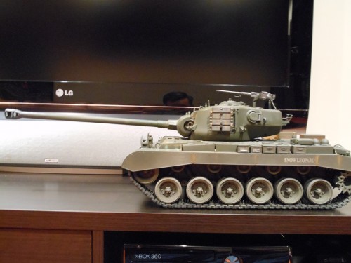

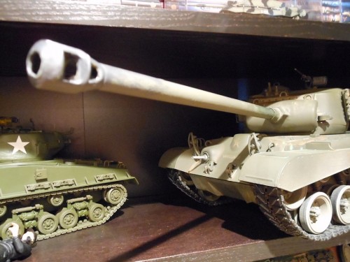

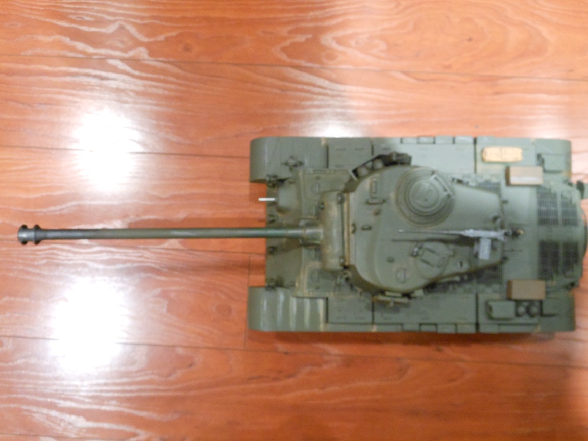

There is a kit out there somewhere that will extend the barrel, similar to the Tiger I one (Basically you saw off the existing one and add a section to it. I bought the kit, didn't like the look but instead switch to a single large pipe. I can't rememebr the size, but because the stock barrel muzzle brake is attached to the barrel itself, I just pick a thin alum pipe that will allow me to insert the old barrel into it. Since I can do whatever length I want, I used the Super Pershing measurement, the one off with the T-15 90mm gun barrel.
Obviously none of this will work if you need to keep the BB. I have to enlarge the gun mantel as well, but I kept the recoil using the old metal barrel insert attached to the new barrel (The old barrel has the plastic outer which the muzzle brake is part of, and then the metal barrel which is for the BB).
