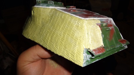

The first thing I did was to buy a second hand turret and upper hull so I could carry on using the tank while doing the zimmerit,
Having had a read of various techniques and materials, I started with milliput white,
I changed to the standard part way through, as I had to start again on one side of the turret as I hadn't mixed it right and it refused to set :'( . I find the standard is easier to see as the colours of the two sticks are different.

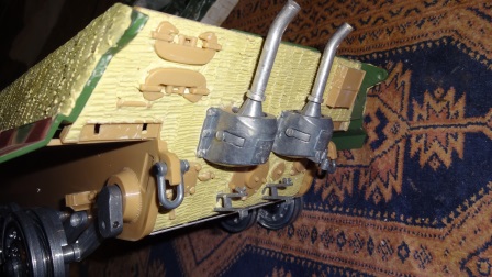

Zim on the hull:
Complete (Thank God for that :lolno: )
Weld Lines and Back Plate, the back plate was cleaned up with a warding file around the various covers/exhausts

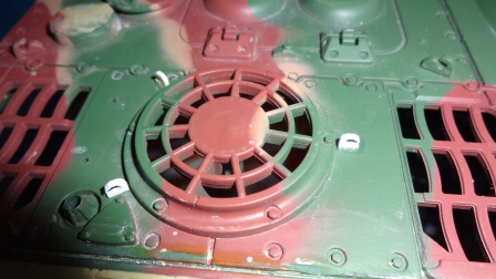

Test fitting the metal wheels to the Torro Hull, I went for lots of metal parts so the tank would last and have some weight to it, most of the parts were bought from Steve at Welsh Dragon.
I then decided to check the tracks and sprockets all fit on the hull, and make sure the top would go on (that and I wanted a sneak peak at the whole tank 8) )

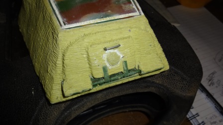

I drilled out the correct location for the aerial:
Next little job was to modify the turret rear hatch, I ground back the zim with a dremel, then made the pistol port out of a piece of swarf I found in a box of washers, then re-did the zim over the top.

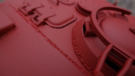

The next job was wiring up a new gun and elevation motor, before assembling the turret:
I then sprayed the turret with Halfords Red Oxide -for plastic bumpers :D

smooth primer color
