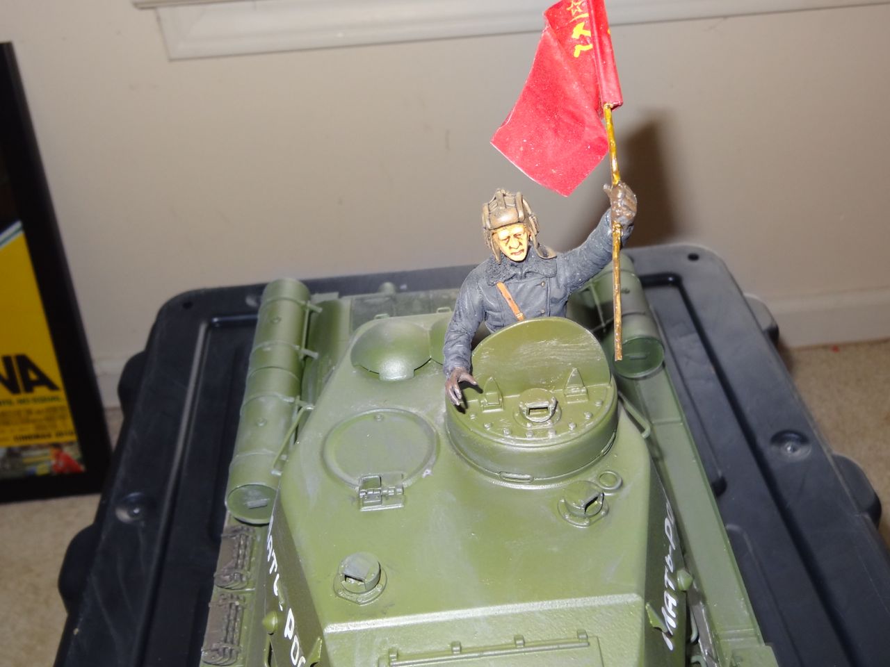

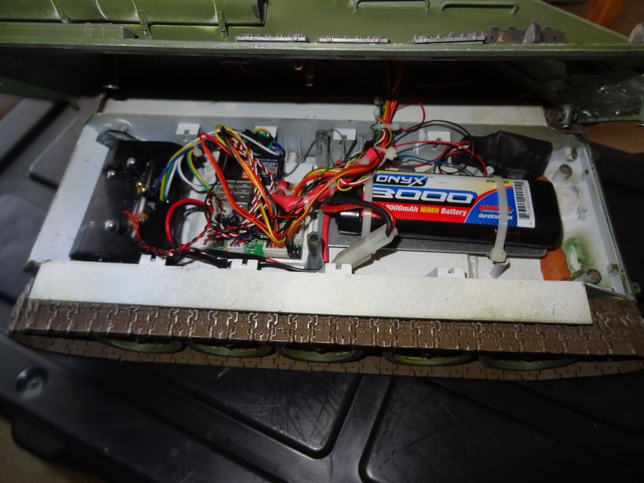

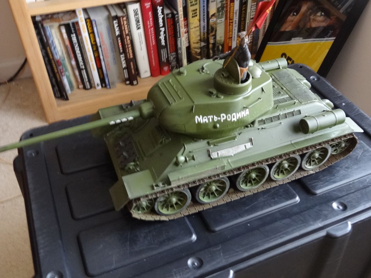

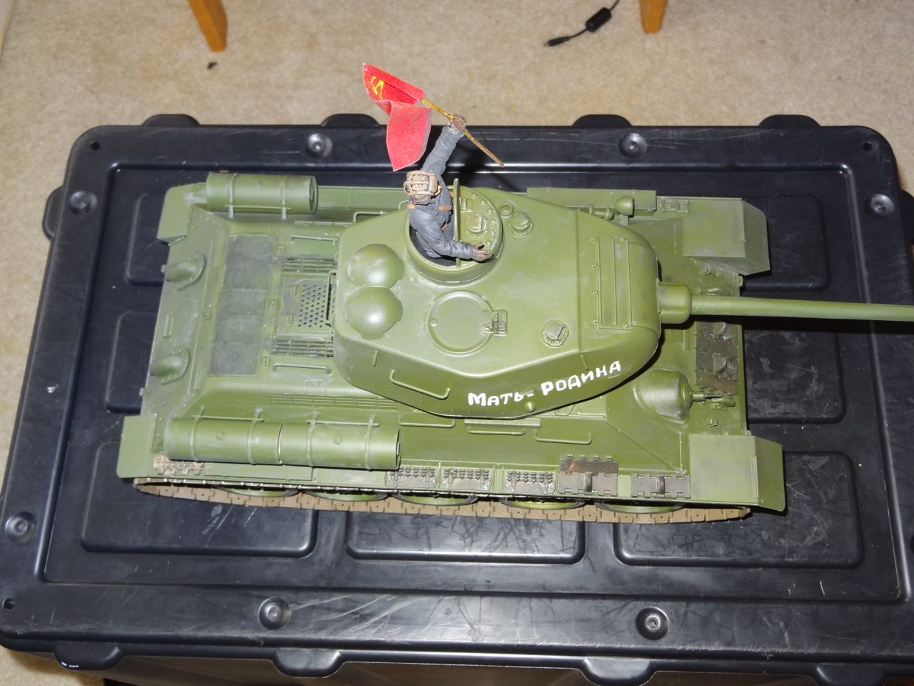

Here are a few pictures of a Torro/WSN T-34 I purchased from Welsh Dragon (great service to USA). I gutted the battery box, re-enforced hull with plasticard and brass tubing. It has a tk22 board with servo recoil. It is setup for a Tamiya battle unit and the infrared transmitter is in the mantlet. It has a HL high intensity flash unit. I will followup with a video of that. The figure is by Peter of Precision Panzer.

Sweet looking build dude, nice and clean...

Great job! Really like the figure with the flag! Just gives an added touch! I have one of these waiting in the wings to be "modified" Would appreciate more info on your reinforcement. I am looking at different ideas for this. I am an old plastic modeller who is just starting on this path so I too scour the forums for ideas.

i want one of these ! also agree the commander with the flag is a stroke of genius,well done !

dgsselkirk wrote:Great job! Really like the figure with the flag! Just gives an added touch! I have one of these waiting in the wings to be "modified" Would appreciate more info on your reinforcement. I am looking at different ideas for this. I am an old plastic modeller who is just starting on this path so I too scour the forums for ideas.
Thanks for not lurking anymore :D
Thanks! I used plasticard on the length of the bottom hull and inside the hull. I leveled out the screw holes and made a platform to support the battery and electronics. I used three brass tubes from side to side to provide rigidity. All of this is re-enforced with millput. The hull attaches with magnets and I used the screw holes with those little brass thingies for servos. The fit male/female and kinda snap in. This made the top secure but easily removable. Fyi it uses stock turret elevation and rotation units with servo recoil.
