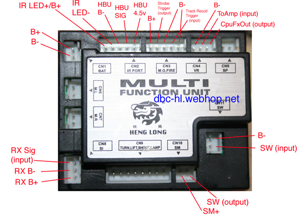

CN9 has turret rotation motor, machine gun+headlight and then the the gun motor control so it can only be that. You should have a 2 pin connecter splitting out the 8 pin right ? If you unplug the 2 pin connector you should get everything else (i.e. turret rotation/MG/Light etc) and there shouldn't be any firing at all. This would isolate the problem more specifically.

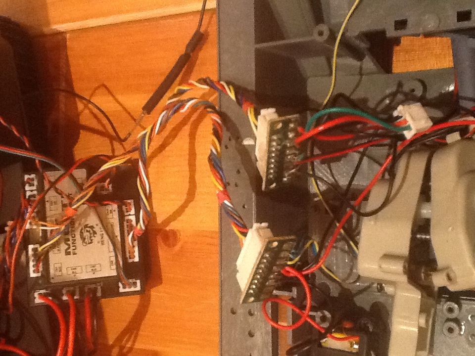

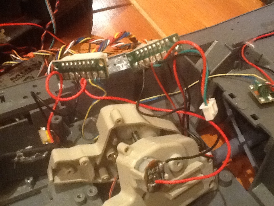

Have attempted to get a couple of pics to help.
Its not the rx - the left trims are disabled.
The connections do not appear to match the wiring diagrams posted on the two 8 pins units.
As soon as it has gone through start up the recoil motor runs at full. i may be missing something obvious
speed Thanks for the help

Hmmm......What happens if you leave CN-9 plug in, but unplug the 2 pin connector that is connected to PIN 4/5 on CN3 ? Does the tank still fire ?
The wiring looks okay from here and you haven't mod anything, right ? The other problem could be that it was wired wrong to begin with which means that you might have to retrace everything.

My gut feeling is that it may well be wired wrong, some of the soldering is very poor. i think that will have to be my next job

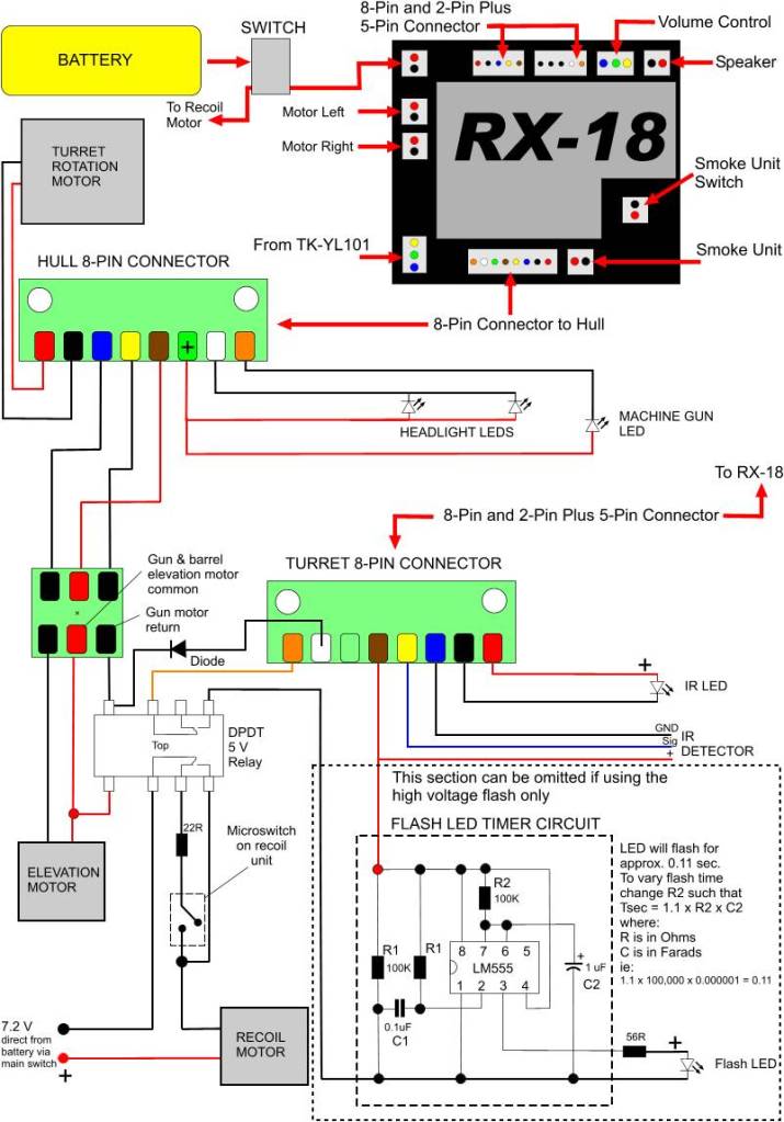

If unplugging 2 pin plug on 4/5 and you are still getting everything firing then it must be a neg/pos got mixed up and you are getting full power to everything all the time. Just do a visual trace and it might very well be a simple neg/pos mixed up at the two 8 pin connector board. The RX-18 should be good (since you swap it with another good one and it is doing the same thing). Just following the RX-18 diagram (I am sure you have it but just in case).
You are right though, the soldering on the two 8 pin connector boards looks less than impressive and not even up to the usual HL job.......
- RX18_Wiring.jpg (92.93 KiB) Viewed 1534 times
