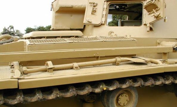

Next up! I've altered the ends of the lower hull spare track retaining bar and brackets. I've used source material from the web in order to do this. The reference photo i used can be found at- http://the.shadock.free.fr/Surviving_Panzer_III.pdf
Not quite sure how to do a 'link' but hopefully thats enough information!?
This photo shows the bar and bracket as it comes, (sorry about the picture)! Its the blurred bit! :problem:
I've started by removing the lug from the end of the retaining bar. (Attached to the front of the hull it acts as a guide). Then i've bent a piece of brass strip at a 90 degree angle. Placing the brass strip under the sprocket hub and tightening it holds the brass in position.
Then mark ready for cutting, filing etc...
The retaining bar at this point looks a little on the long side. So i removed the ends just behind the molded bolt heads. Then added some styrene rod.
A simple fix is to drill out the last spare track link.
Finally bring the elements together!
I've only glued the brackets to the bar at this point to aid painting!
