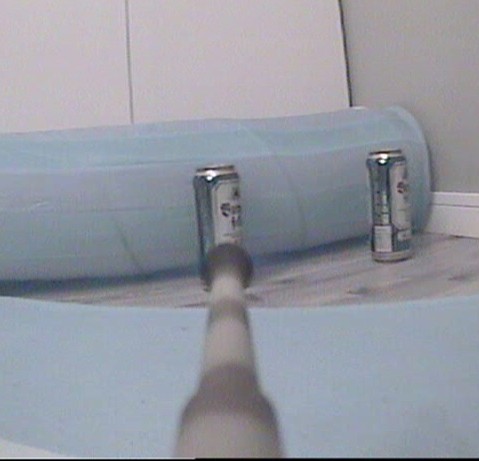

Maybe jerky is not the correct phrase, it is the fine tuning to get the right direction that is hard to get.
The rotation velocity seems to be constant and not proportional to the stick command. But for this, another and more advanced electronics may be needed.

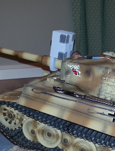

It is easy to see with the gunner cam that I can put on the barrel.
Gunner Cam
Gunner Cam
This will kill the can
