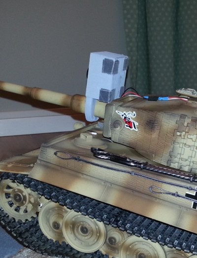

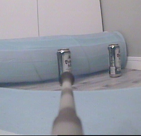

It is easy to see with the gunner cam that I can put on the barrel.
Gunner Cam
Gunner Cam
This will kill the can
