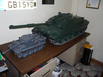

Here is one of two pics of Challenger 2 , 1/8 scale with my Tamiya Tiger 1, 1/16 scale.
Sydney
Posts: 26
Joined: Mon Jul 16, 2012 12:11 am
Re: Chunwai 1/8 Scale Challenger 2.
Post by Sydney »
I will try again, here is pic of My Challenger 2, 1/8 scale with my Tamiaya Tiger 1 , 1/16 scale

Wow, and it is all metal ? I would need to move to get one of those. Very impressive Sydney.

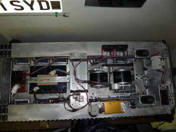

Here is picture of the guts,smoke generator, speed controls,sound module, Rx,voltage regulator,
fuse box and control panel, and 2x12volt 12 amp batteries.
The track tension is done outside on each front idler wheel with a bolt and locking nut type arrangement.
The four chain for drives can be adjusted with a hex nut.
The tracks have individual rubber track pads(Chunwai sent loads of track spares), these are fitted
by snapping them into a recess on each track link.

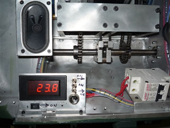

Picture of rear control panel.
Right to left; on off power switch #1
on off power switch #2
Smoke on off switch
sound on off switch
charger on off switch
voltage display
voltage display on off switch.
24 volt charger receptacle.
All these are accessible by two hatches that open when turrett and main body are fitted.
It was supplied with a really good charger and plug.
