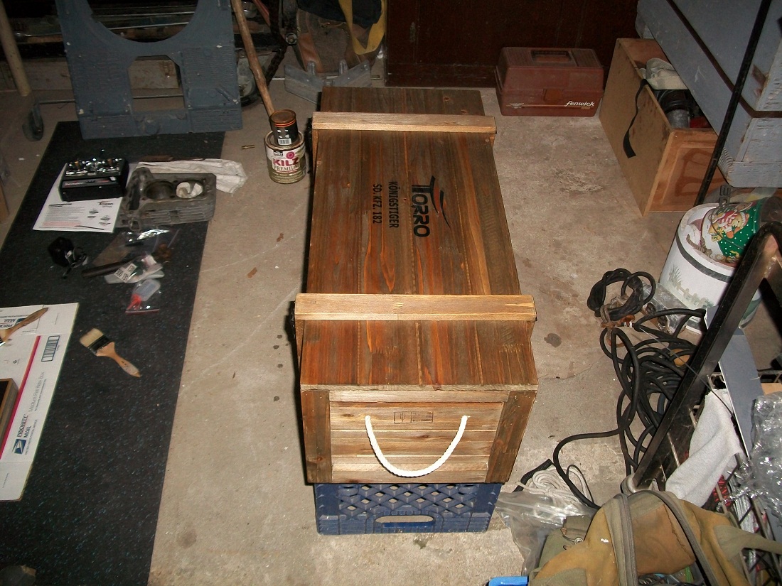

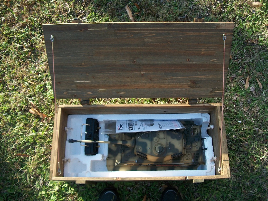

As PRELUDE i did not like the TORRO light colored pine or the fact that it is not sealed or stained. I used a clear polyurethane sealer and simply brushed it on,the stynciled lettering was aslo in need of some fine touch up but is a quality applied paint which never tried to smear or run when brushed over.

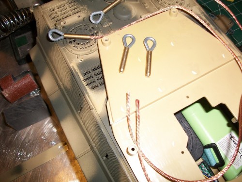

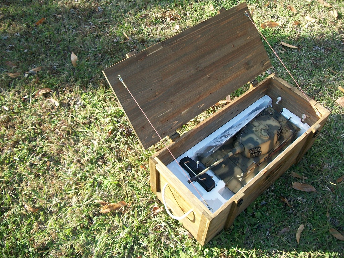

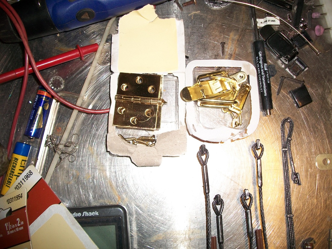

I have taken the nice copper tow cables and used them as lid supports for the crate.I think it is a nice touch and if the lid if opened to far will stress the hinges requiring something to control the movement.

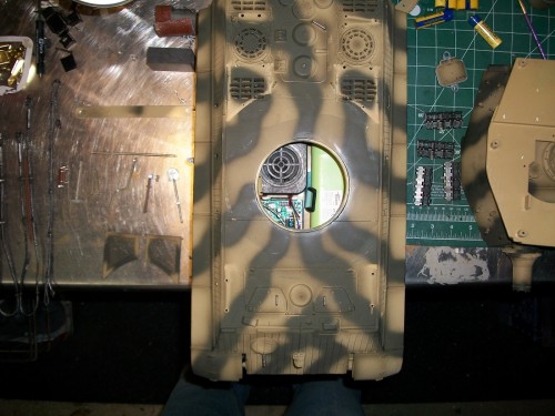

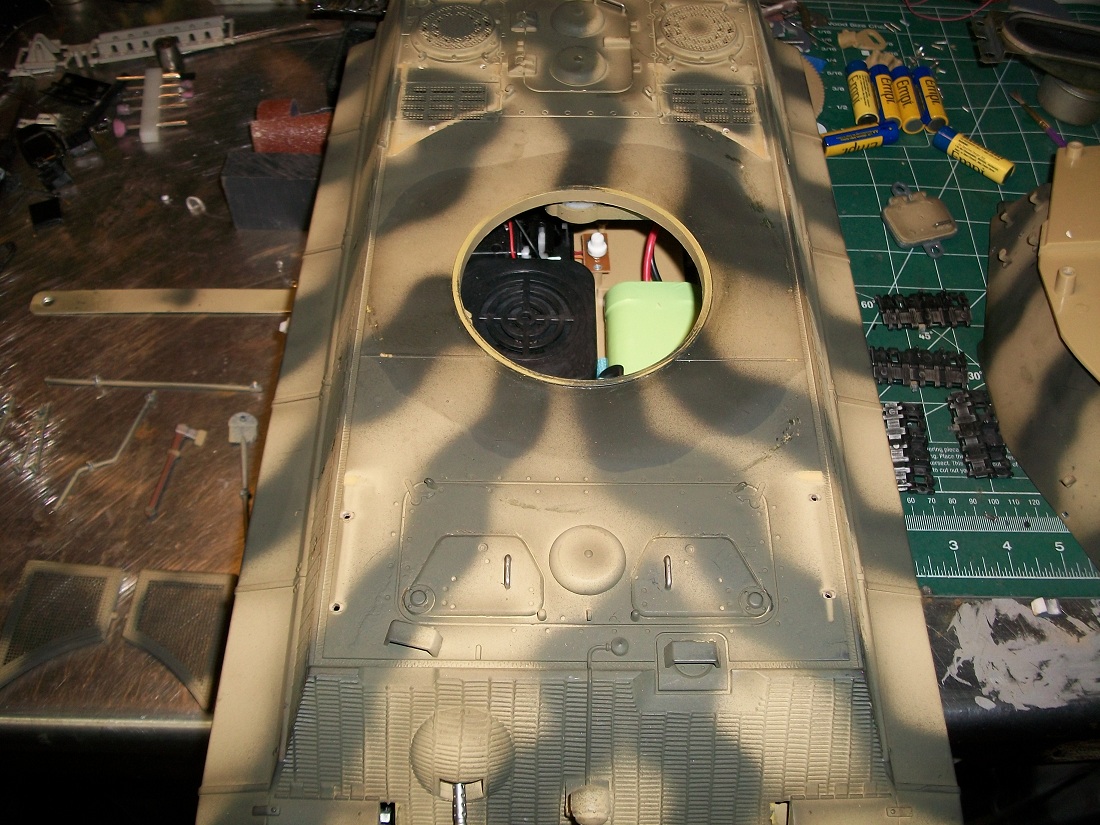

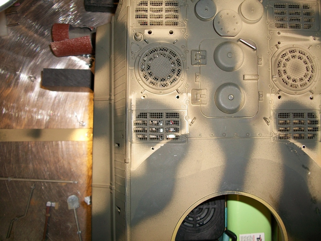

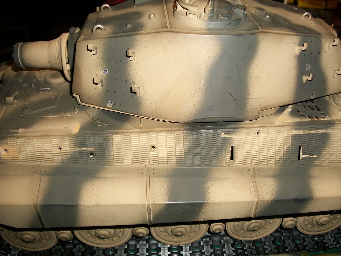

And so it begins,this tank has several issues with the appearance. This is the"Best Torro Pro Edition Henschel King Tiger" they had to offer.Seems the paintwork could be imporved on.
TORRO has been informed of the defects,and certainly it is up to them to address the issues.Perhaps they will seek to change the painting methods and paint type.The main issue being the amount of paint to thinner,and no primer was used anywhere on this tank. Torro has done much for our Hobby,they are certain to continue improving the products,it certainly has been eveident in the last few years.

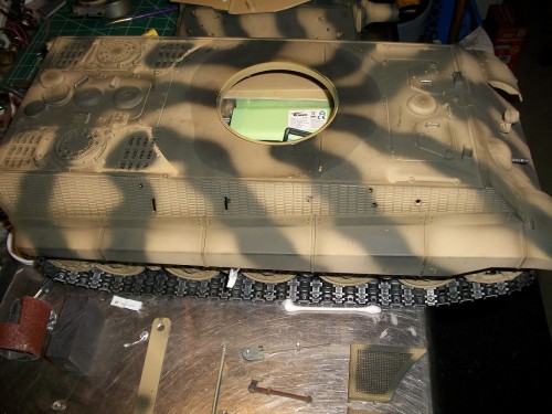

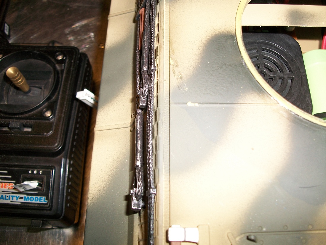

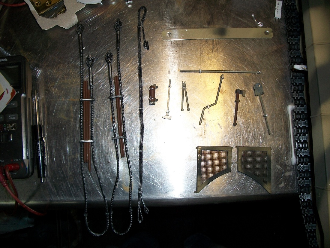

I had intended to just "FIX" some of the scratches,but this cannot be done without removing the tools,cables and other Hull mounted equipment.

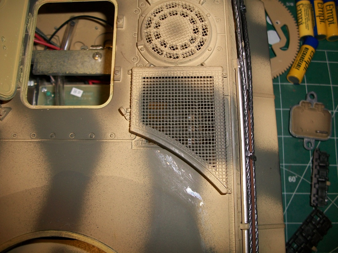

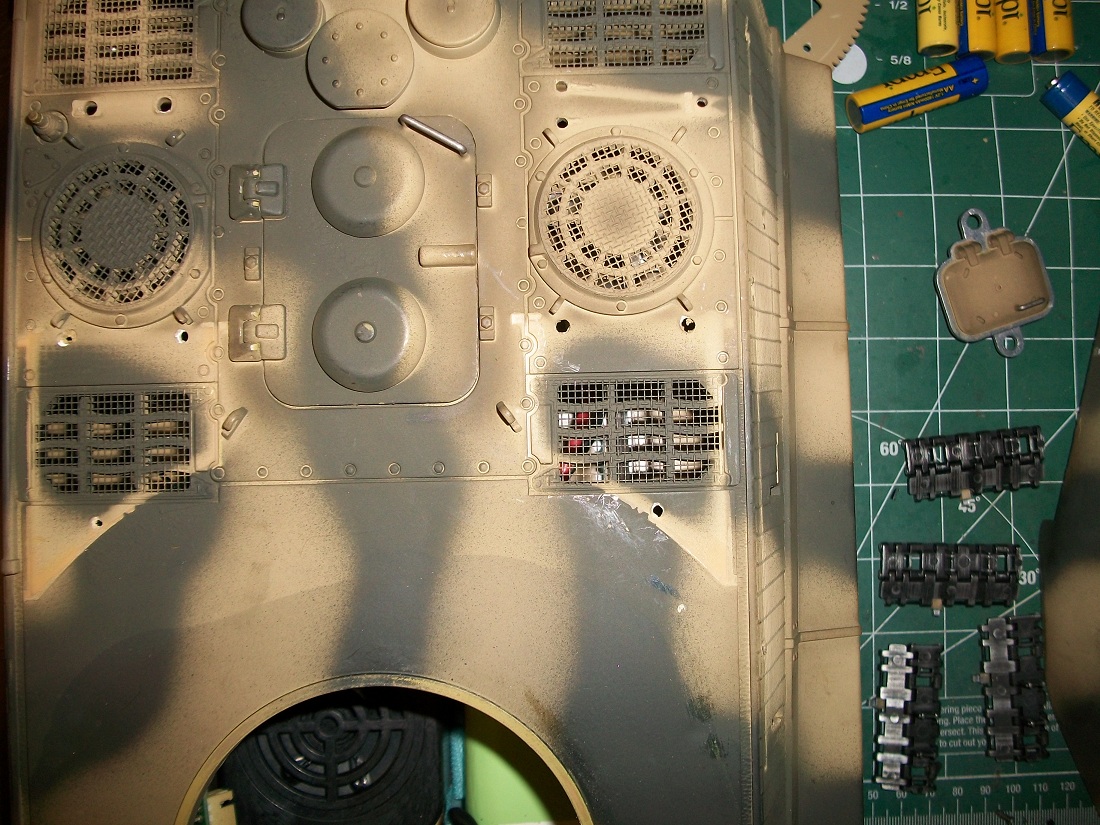

Also the vent covers are in the wrong place to allow Turret rotation. This will not do! The Hull cables are plastic which is a bit disappointing.Although all the tools,pry bar,fire extinguisher are metal. All were glued into place using stand off pegs and holes in the hull.

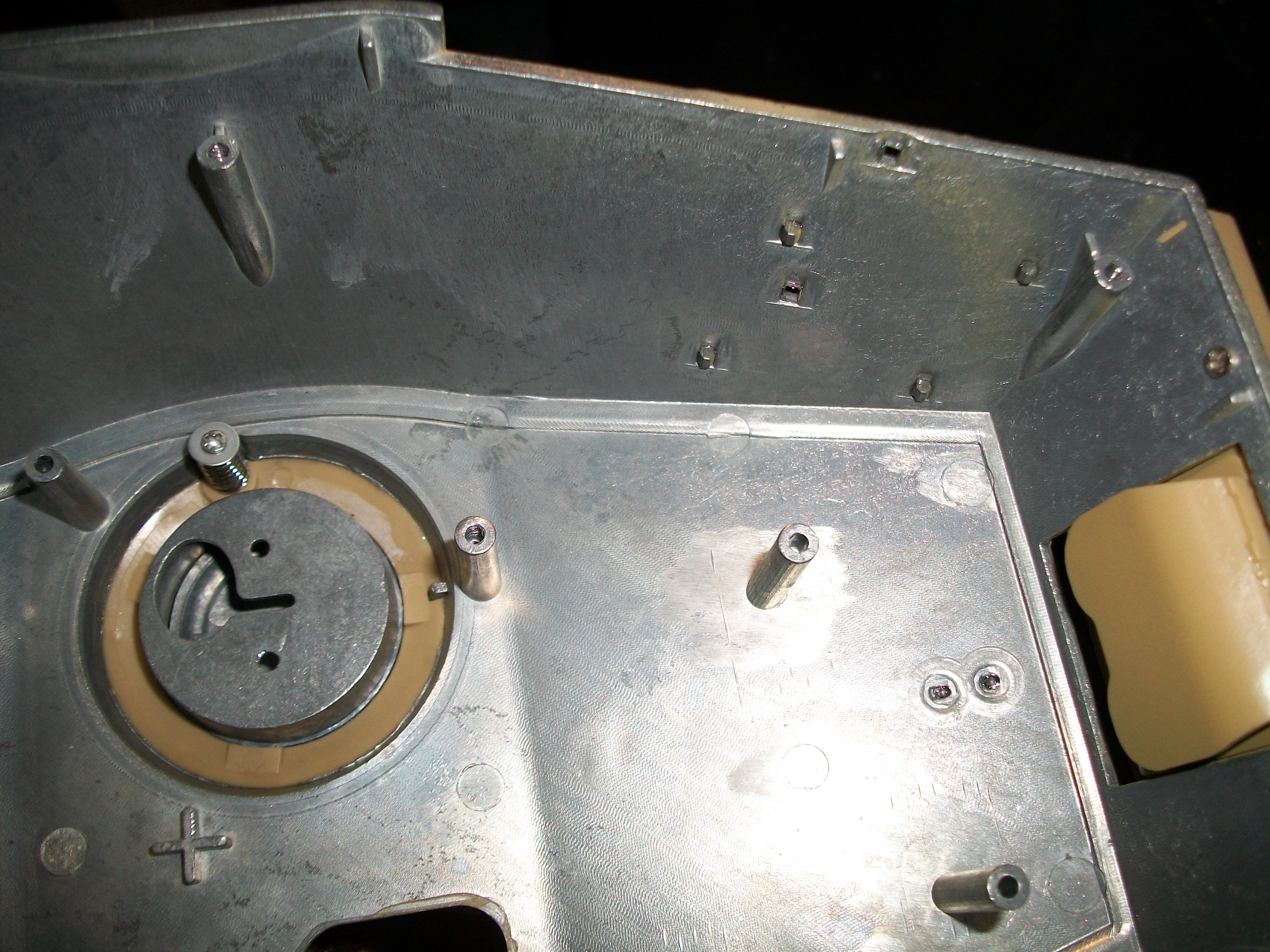

I used a round drum sanding bit and my dremel to sand down the inside standoff pegs flush,then a center punch and a screw driver Handel were used to tap not force these through the hull.The hull being laid on a piece of foam to support and protect.

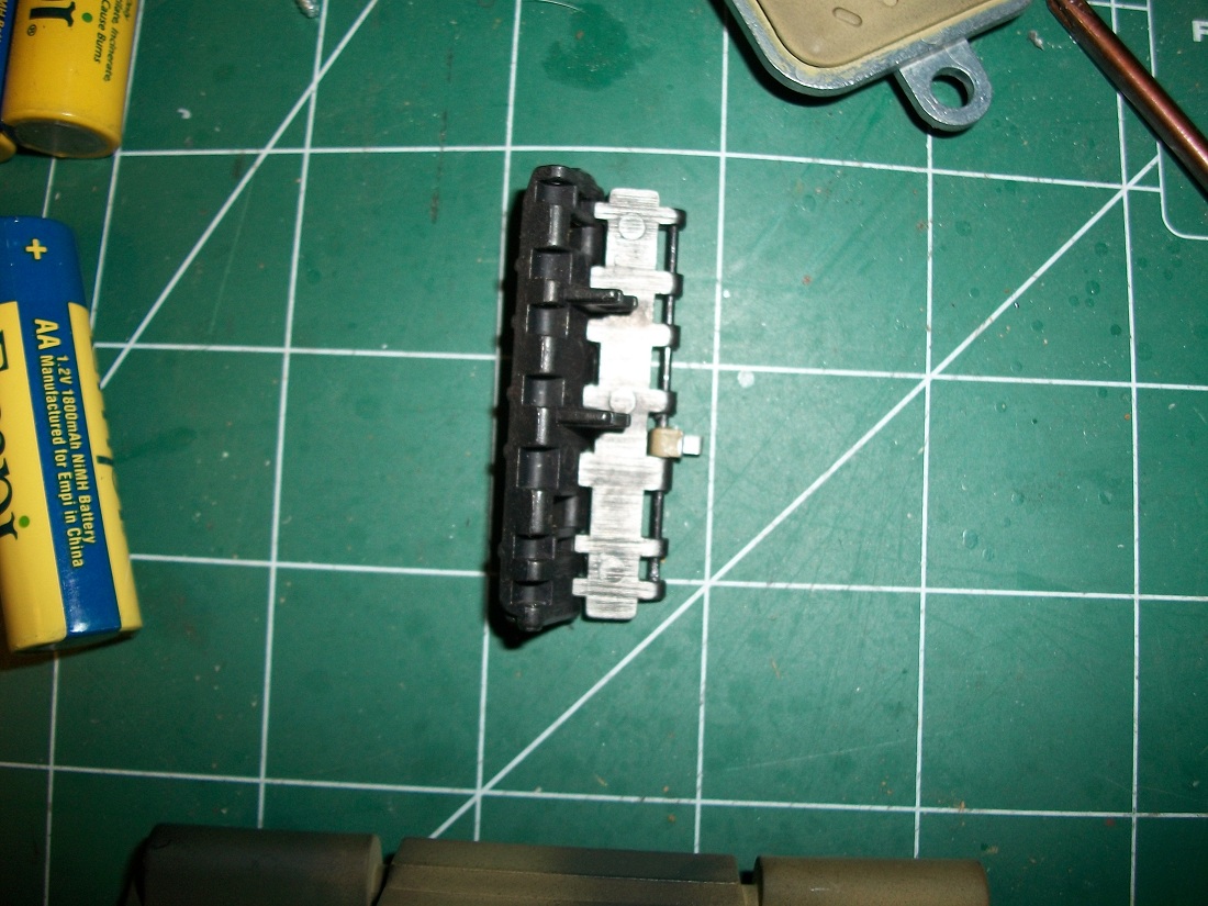

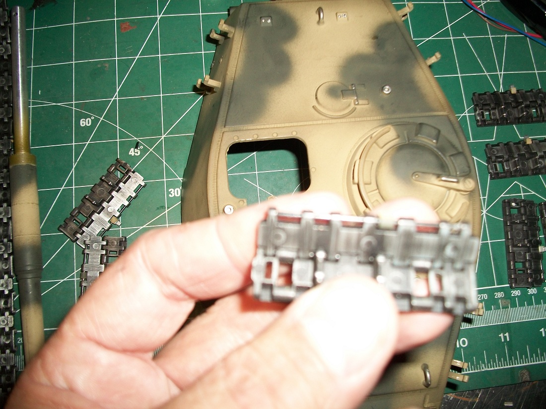

The spare track sections mentioned in the Show off post were removed by a single strike from the inner side of the Turret gun house with a punch,they popped right out allowing the tracks to be removed.Recall the pins which are glued into these sections and pass through a hole in the single lower track hanger preventing removal.
This method did not damage the tracks or hangers which even though metal would of certainly broke off long before the pins could be driven out.
All together this has taken 2 hours to disassemble,the recoil is still not working and will require further time to check with a meter and determine the cause. Well I did not want to go through this,but it is a fine tank and deserves to be of fine paint quality if I have the skill.
I shall clean and paint the hull and turret back to this original paint scheme,yet using methods I know to produce a fine result.

I will follow this thread very closely Blake! after having finished my Tiki project, it's the turn of my KöTi (the same model you have)
please, could you explain a bit this sentence?
"Also the vent covers are in the wrong place to allow Turret rotation. This will not do!"
my turret can turn freely the whole 360º (i moved the turn engine in order to be able to install a visaton FRS7 speaker with the biggest wooden box possible). The only issue i can see is that these grills do not let the gun barrel to be completely depressed...

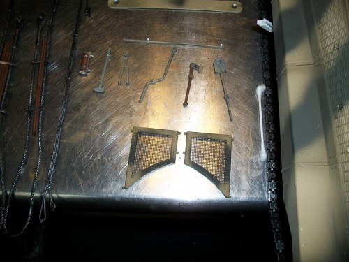

Re: Torro Pro-Edition Henschel King Tiger Rebuild
Notice the vent visible under the cover at the point where the cover starts to curve,the same curvature as the turret circumference.
Now notice in the second picture the outline left by the removed cover.the back edge of the cover should be flush with the back edge of the vent opening.
If moved into the correct position the bottom of the turret drags on the grill.One possible solution is to lower the cover.Another is to raise slightly the turret s rotation does not effect the cover.
That is my meaning by the sentence you posted,also note Kens Tamiya Porsche have the correct covers that extend under the turret bottom.Maybe Ken could post a picture?
