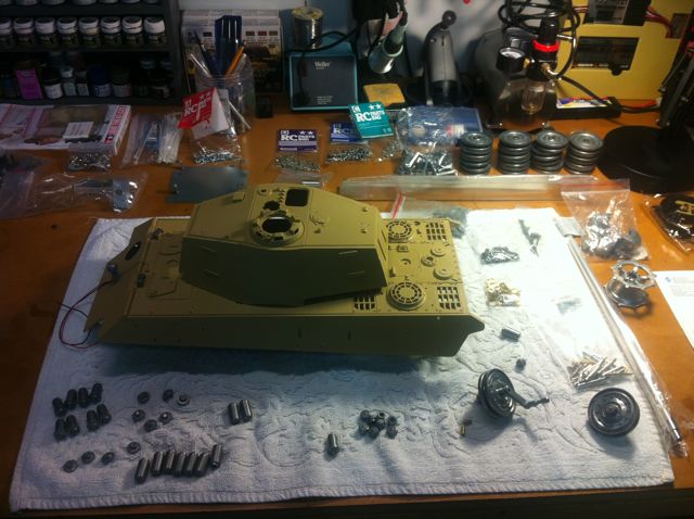

Well I've started...
Right now I have started building the lower hull which has pretty straight forward, so far the Tamiya kit has gone together very easily just as I would have expected.
For upgrade parts so far I have purchased metal road wheels and track, metal exhaust and smoker generator. I have also purchased metal tool set, full metal muzzle break, working headlight and photo etch kit for grill set. I'm getting some other items so please stay tuned....
I have finished ready "Tiger's in Combat II" about the history of s.SS PzAbt 501 and also New Vanguard's "Kingtiger Heavy Tank". Great resources on the unit and production history. I won't bore you with the details but these have been a great help, if you have any questions or information I've missed please let me know.
Please stay tuned.....
photo lower hull.jpg (60.07 KiB) Viewed 5140 times
upper hull.jpg (60.89 KiB) Viewed 5140 times

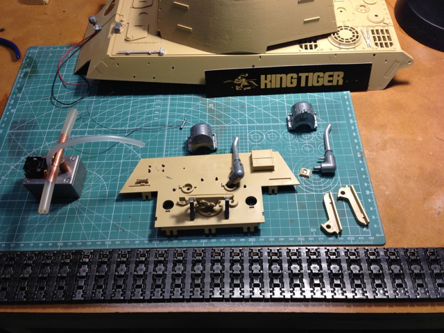

What type of smoke unit? Curious about that and how it fits into the hull,and the circuitry? Perhaps you could share that info?

One of my first big decision was how to install the "Battle System" in this Tamiya tank. The three options I have found are, 1. the standard way Tamiya has you do it, 2. Installing it in the cannon barrel (flash working also difficult if posssible) and 3. Drilling out the MG machine hole in the mallet larger to accommodate IR sender. I don't really like any of the options but have so far decided to install it the way Tamiya recommends. I don't like the look of it during battle but my tank mostly is on display and wanted to maintain the most accurate reproduction possible and we already add the receiver to the cupola for battle so I guess whats a little more.
Well I started working on the rear lower hull. The upgrade parts I'm going with are a set of full metal "C" clamps (waiting on), smoke unit and metal exhaust, metal mud flaps (waiting on), more detail metal jack rack and a working blue follow light. I'm getting ready to grid down and fill in all the holes not used on the rear hull. I still have to figure out how to wire in the front headlight and the rear follow light into the Tamiya system so any suggestion would be appreciated. The rear blue light is around 1.5 volts I think so I will have to reduce the voltage to that one.

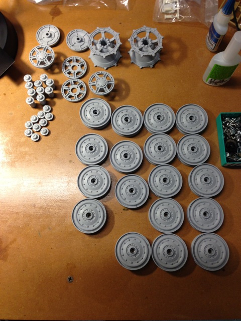

I'm also went with metal road wheels and track. I finished priming the lower hull with Tamiya metal primer and primed the road wheels with Tamiya metal primer first and the there Tamiya Fine primer. Right now I'm sanding off the numbers that were left of on the metal tracks during production and getting them ready for paint. Next day I'm airbrushing I will paint them. I'lll let you know my paint choices then. I'm going after the wet muddy look you would expect Europe in the winer. I will also paint the lower hull and road wheels, drive gears and idlers with Lifecolor RAL8012 Rotbraun. The German order that King Tigers produced after 31 Oct. 1944 were no longer to be painted a base coat of dark yellow but the camouflage was to be added directly to the red primer. The photo's I've looked at its hard to see what colors the wheels are for tanks in PzAbt. 501 at this time so I plan leaving the lower hull and road wheels and gears finished in this color in response that the general order.

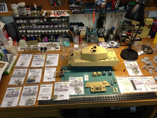

Upgrades, Upgrades, and more Upgrades
Sorry for no posts lately but with the holiday's approaching and figuring out what upgrades I wanted to do I haven't got much more work done on the model. I have just received a big order of parts from Germany so I have pretty much everything I need to build the model except for a few small items I'm still waiting on. I basically purchased the upgrade parts I thought would make the biggest impact in the appearance of the model. The only area I haven't decide to pursue in great depth is a lot of photo etch. I did get some for the engine exhaust because I feel it really adds a lot of detail for the engine, not that it doesn't add detail in other area but I had to draw the line somewhere.
So here are the additional upgrade parts I've added:
Metal Handholds
Metal Close Defense Weapon
Metal Sprocket Wheel Guides
Periscopes for all the hatches
Detailed Metal C-Hitch Set
Brass Lifting Arm for cannon
Resin Rear Panel Side Parts
Detailed MG34 Machine Gun and Anti Aircraft Mount
Reduction Gear Set for 3:1
Metal Antenna Base
Conical Steel Antenna
Working Commander Hatch
Metal Detail Set
Detailed Metal Tow Cable Holders
Coupler for Rear Panel Chassis Gap
Christmas came early, I excited to get working again and will probably be getting more serious about getting stuff done after Christmas.
