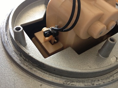

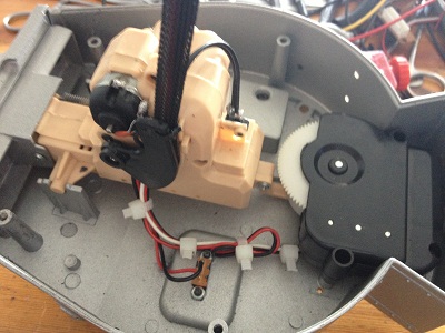

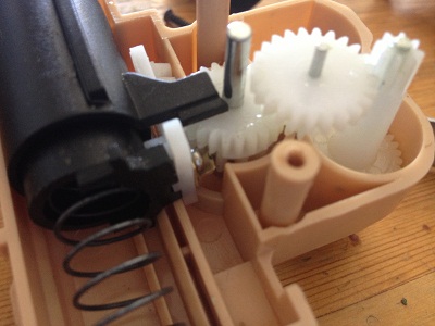

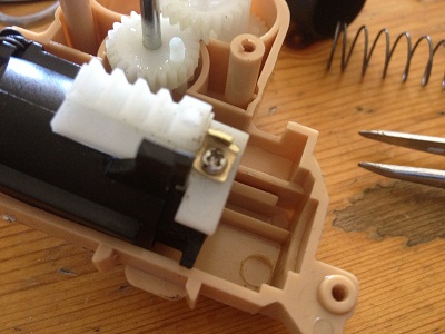

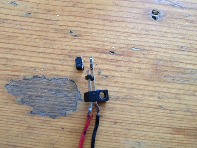

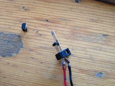

Hello I didnt like how the airsoft doesnt reload to firing position, I used the existing switch , trimmed off the front tab (pic1) then angled the front tab to make contact (pic2) i made a small bracket (pic3) to contact with the rear tab. make sure there is no fouling of gears(pic4) the airsoft cannon will stop at full cocked position (pic5) ready for firing instantly. :thumbup: I used the switch in the turret (pic6) for safety, as making it autoload it is hard wired. in summary the cannon is wired to Fire continuously and the micro switch breaks the contact right before , so it fires as soon as the lever is moved then automatically winds on for the next shot . I like this mod and hope it helps out Cheers
