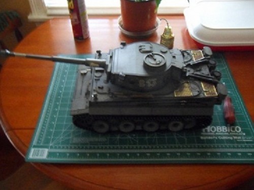

This may help,the link is the first painting and weathering post,some pictures may be missing but the thread has excellent advice from OZ as he trained me and Steiner on painting and weathering.
The first Tigers were in gray this changed mid 1943,But I started much like you with a basic gray color,some advice use Tamiya Paints as their water based and easy to use.Or any acrylics All the best.
My first tank Heng Long Tiger with Asiatam Lower hull and WSN Tiger early rubber lined road wheels
http://www.rctankwarfare.co.uk/forums/v ... 151&t=2429
