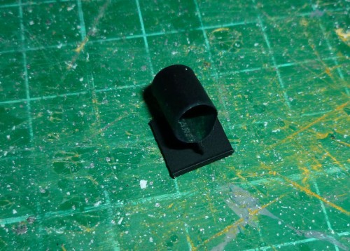

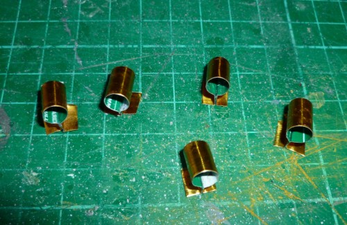

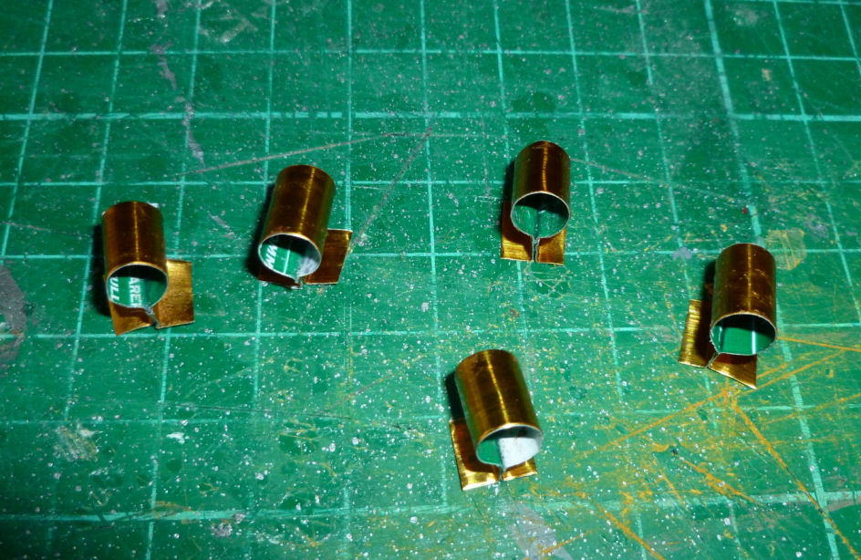

Heres a couple of pictures of work in progress on the s-mine launchers, made from a old tomato puree tube, and using a drill bit as a former.
Tony
Tony

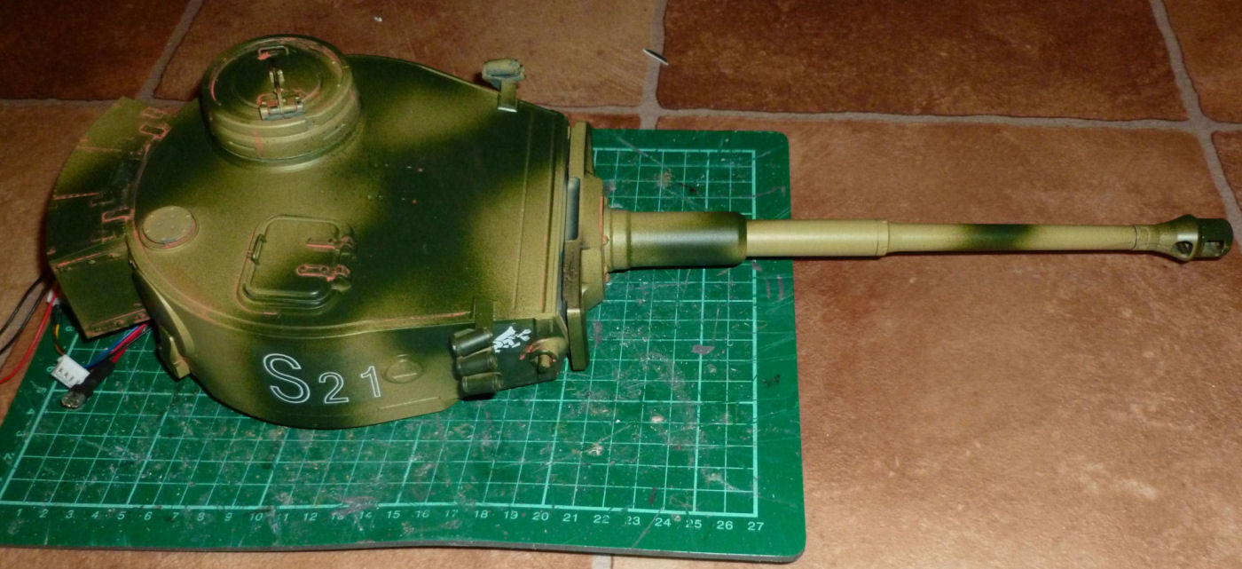

Here the turret, complete with recoil unit. Ive followed the book for the colour scheme - to me it looks better with two colors than three.

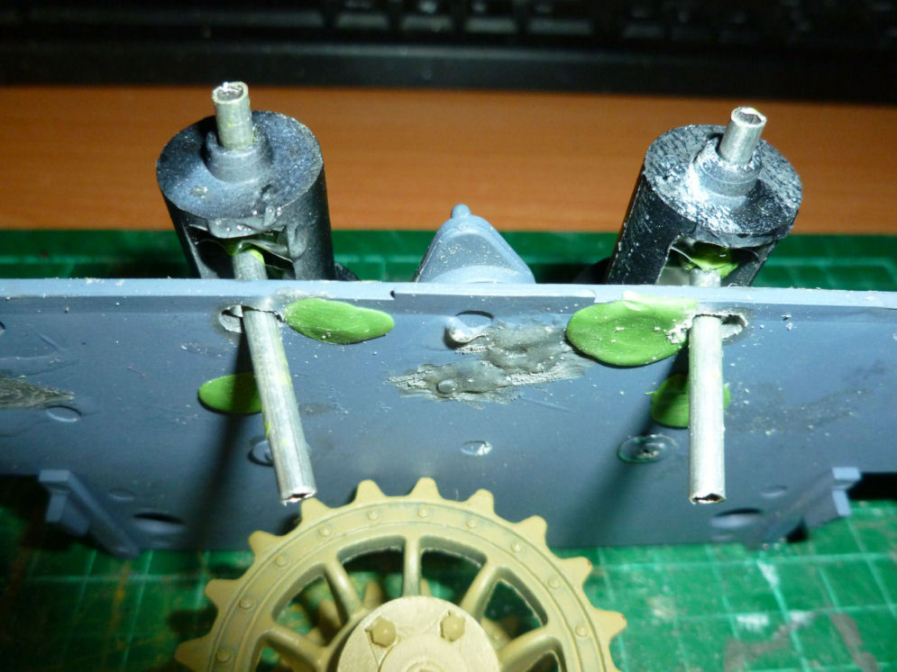

Time to tackle the exhausts.
the shields were not going to be used, so i snapped off the bottom screw point and fixed it into the stacks to act as an anchor point. After filling and sanding I got the exhausts to my liking. I elongated the top holes on the tank back panel then put about 120 degree bend in some aluminum pipe (so the smoke oil could run in), inserted it through the exhaust top hole and stuck it with a blob of milliput screwed the exhaust stack to the back plate using the anchor point I had created. While the putty was still pliable I adjusted the pipes position then poured in some glue, laid it on its back and let gravity and chemistry do its stuff.

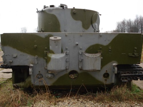

Ive noticed that the heng long armoured exhaust part isn't the right shape. Theirs are just round, where as the actual thing had a kind of point on it, so its time to dig out the milliput and start sculpting.......

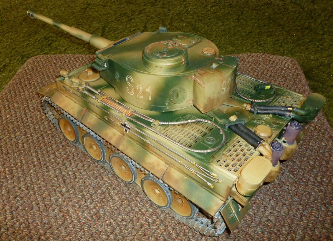

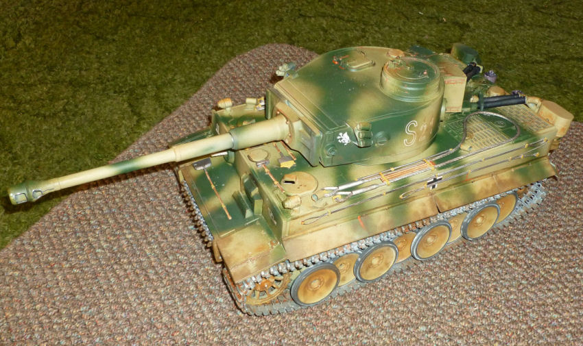

Finally its finished (well until I start making changes). I had a slight disaster when one of the turret wires caught in the gearbox, and I had to dismantle it and free it. I then build a gearbox guard to stop it happening again.
Well onto the finished thing. I opted for not much shipping, rusting or damage, as I figured the life expectancy of these things on the Eastern front was measures in days or weeks not months or years, so it wouldn't get much of a chance to corrode, before it was destroyed. Anyway hope you like it
Tony
Tony
