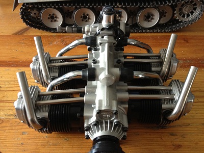

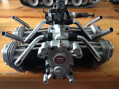

Hello, This is my stock O.S. FF320 4-stroke Nitro Engine. It is designed for Aircraft use and the carby and exhaust ports are on the bottom of the engine. I plan on buying 4 seperate heads and carbys off O.S. Engines single cylinder series as this will enable the intake/exhaust ports to be on top though 2 exhaust ports will point towards the front. I am going to run the engine breathers into the exhaust system so the lubricating oil will add more smoke
Pegasus Front.jpg (74.76 KiB) Viewed 1152 times
Pegasus Rear.jpg (72.23 KiB) Viewed 1152 times
