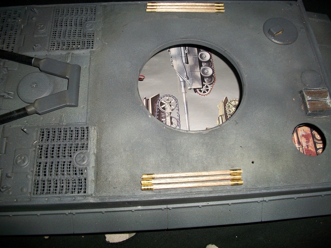

Hey Blake,
Oddly enough I was having the same issue as you just a day or so ago. These are the ones I made.
Material List
Evergreen Styrene #212 .080" (2.0mm)
Brass Tubing 3/32" (2.38mm)
Fine Metal Screws 1/16" (1.59mm)
Using the Hanes book and numerous ref pics, I made a single, a double and a triple cleaning rod, I roughly determined the length of my single rod (awkward
) to be approx 2 1/4" long. I gave each rod a light sanding with 80G sand paper to give it some grain texture. Then I cut a bunch of ends using the brass tubing at a 2mm length and slid them onto the ends. Next I prepared the screw ends using 3 small screws with the same thread and diameter. I counted up to the sixth thread and Dremelled off the top. Finally I bored out both ends and fixed the screw end onto the rod.
For the multi length rod, I just slid the brass tubing to a point of equal length in order to represent the seperate portions of the cleaning rods.
Hope this helps, got to go, Yankees Playing.
