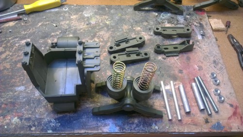

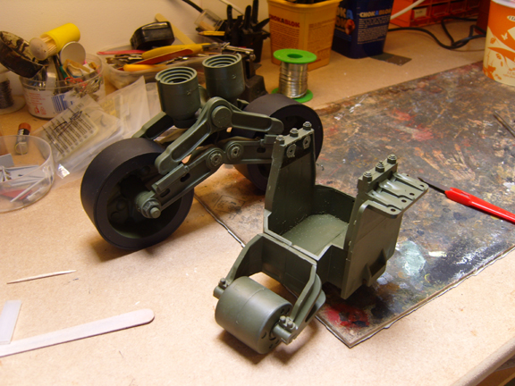

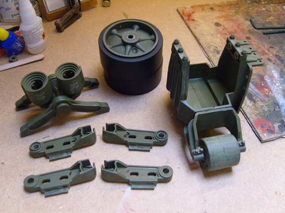

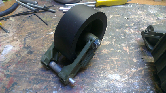

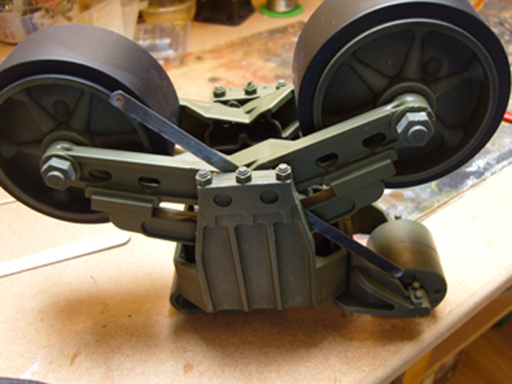

DOG

jrc
Posts: 387
Joined: Wed Aug 19, 2009 3:42 pm
Location: Ayrshire, Scotland
Re: DRAGON 1/6 SHERMAN
Post by jrc »
hi Dog
It's almost exactly like the mod to the !/16 Mato Sherman suspension but a lot easier as it bigger and not so fiddly :thumbup:

Post by DOG »
Hi all i have been working on m5 stuart for the last 4 weeks but will be starting on the sherman again soon i got casting number now i will try and get pictures over weekend
