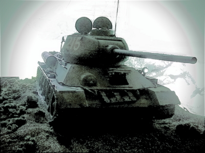

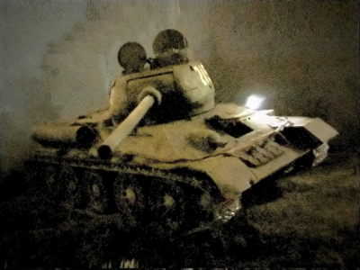

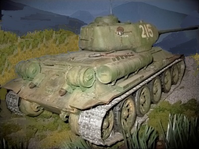

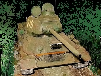

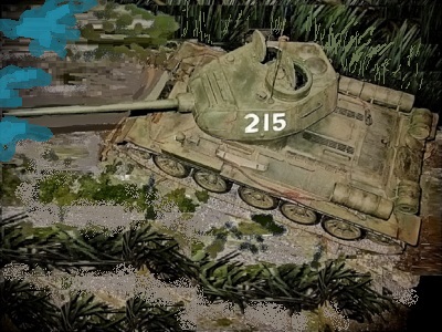

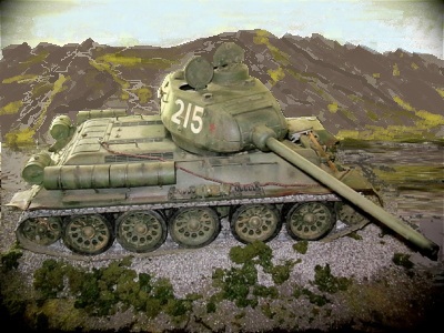

This is the first tank I changed to the heng long rx 18 along with moving the switches and battery charging wiring. It runs quite nicely but I had to add an extra lobe to the recoil motor disk in order to get it to recoil when the firing sound is heard on upstick. Still havent got the shot light in the barrel to work correctly. Did get rid of the green running light and replaced it with a white one. I also made all the crew hatches operational. I wish I could find some of the old dragon crew figures with the soft tankers helmets to complete the thing .

my tank sdded to the forground of a real north korean war photo

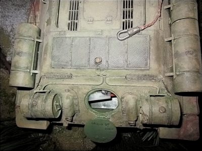

rear fuel tanks scratchbuilt. The tank I modelled did not have have them  but I like look with them on that rather plain rear end

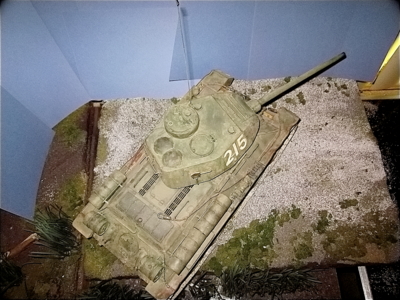

this is the dioama base I usrd for all the pictures except the one with my model added to a real korean war picture
