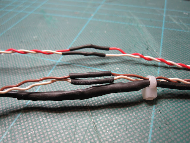

Bit of a cock up on the Battle System front.
When trying to test the system, I realised that the reciever unit wasn't making proper contact with the socket, as in my efforts to reduce its height, I'd cut out the sprung metal pins.
Luckily I have some "spare" battle systems as I bought a job lot some years ago. So I had to break up another unit to get a socket off the pcb.
This time I reduced the height by cutting away at the bottom leaving the pins intact so I could re-solder them to the pcb. Below is a pic of the refitted socket on the right, compared to a standard unit on the left.
Then fitted back into the cut down guide.
Now that I had a non-usable battle system, I decided to use the cables to extend my modified unit, as after being clipped around the turret they were quite short, making it difficult to plug them in

ANOTHER SETBACK
I was still having no luck testing the battle system, I knew all my joints were sound, so I perched the Sherman turret on top of another tank and plugged in the battle unit and all worked well.
So, coupled with the afore mentioned lighting problem, looks like I've got a duff MF unit.
Bought it quite some time ago and have modded the supply cables so I guess a refund is out of the question
Anyone got a cheap MF-03

ONE STEP FORWARD.......TWO STEPS BACK
Got my replacement MF-03 unit on Saturday.
Left it on the outside of the tank and connected everything to it, and powered it with another battery, (as the fitted units are linked and connected with Deans sockets, and I didn't want to cut the Tamiya socket off till I new it all worked)
Fired up, and my suspisions were confirmed, Battle System worked fine
Will now spend the next couple of evenings replacing the MF-03 units
