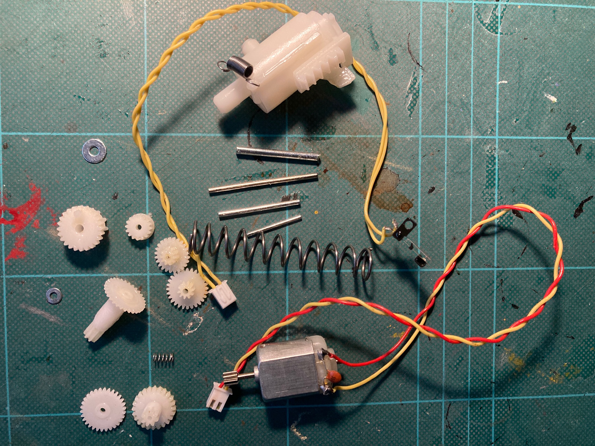

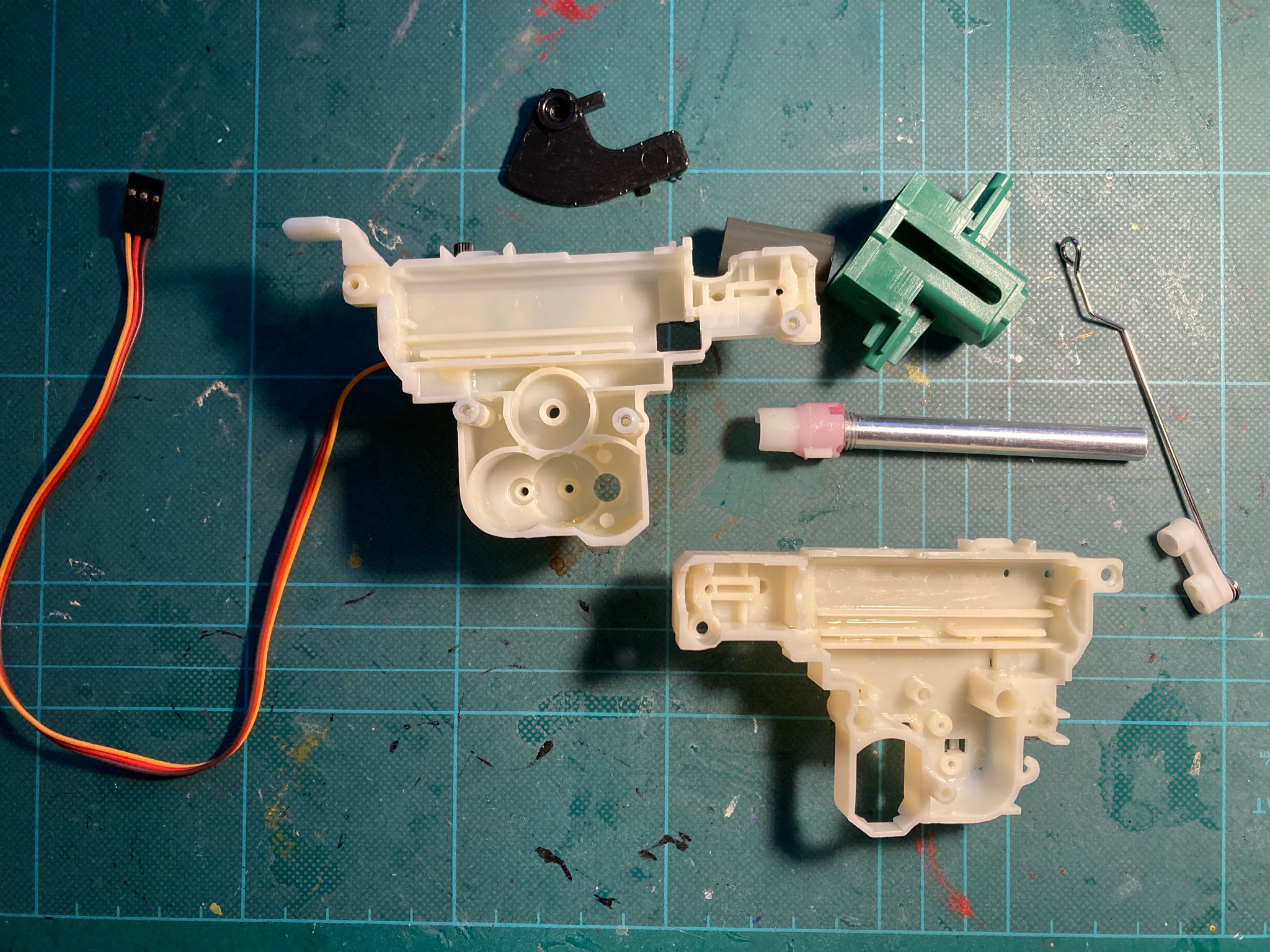

HAYA Centurion KIT. Out With The BB Mechanism.
I have chosen to have a "muzzle flash" in the gun barrel and so I need to find somewhere to thread the LED and the wires that power it up inside the barrel.
Fortunately I was able to ask Andrew at HAYA about this and he advised me to empty all the gears and springs (etc) out of the BB firing unit as I was not going to use any of it, and it would give me an ideal place for the wire and flash unit to enter the barrel.
I took the two halves of the BB firing unit apart and was quite surprised when a spring flew past my ear! I have never looked inside one of these BB units before, but I should have realised that there would be a reasonable sized spring inside it to catapult the BB out of the barrel when needed.
Everything came apart very easily and after I had wiped all (most) of the gear grease out of the unit, the two empty halves went back together easily enough.

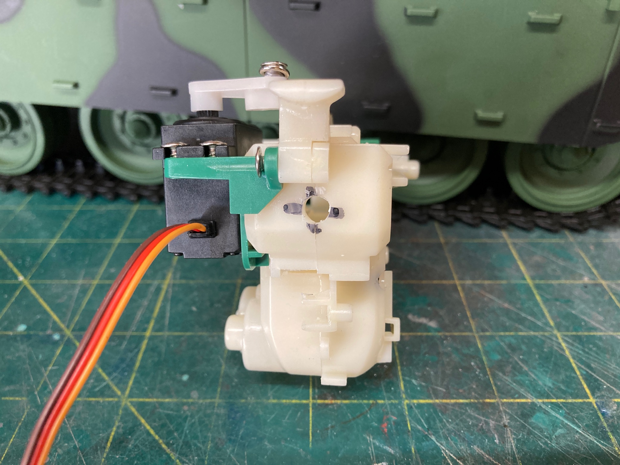

Andrew advised that a 5mm hole could be drilled in the end of the unit to give a good entry point for the gun flash bulb and wires, and that it could also be used for the gun smoke tubing - if I should decide to add a smoking barrel feature at a later date.
I took the advice to drill a 2 mm hole first and then followed it up with the 5mm drill afterwards. This was a nice easy job that only took a minute or so to complete with the recoil servo still mounted (I had previously fitted it and glued the mount to the side of the BB unit)!

- Empty BB unit rebuilt with Access Hole drilled - ready to be cleaned-up

- Keep these parts but not the black Bell Crank (not needed).
- 2858339E-05D8-47DF-9F78-AB23891E2D80.jpeg (978.1 KiB) Viewed 529 times
- None of these parts are needed

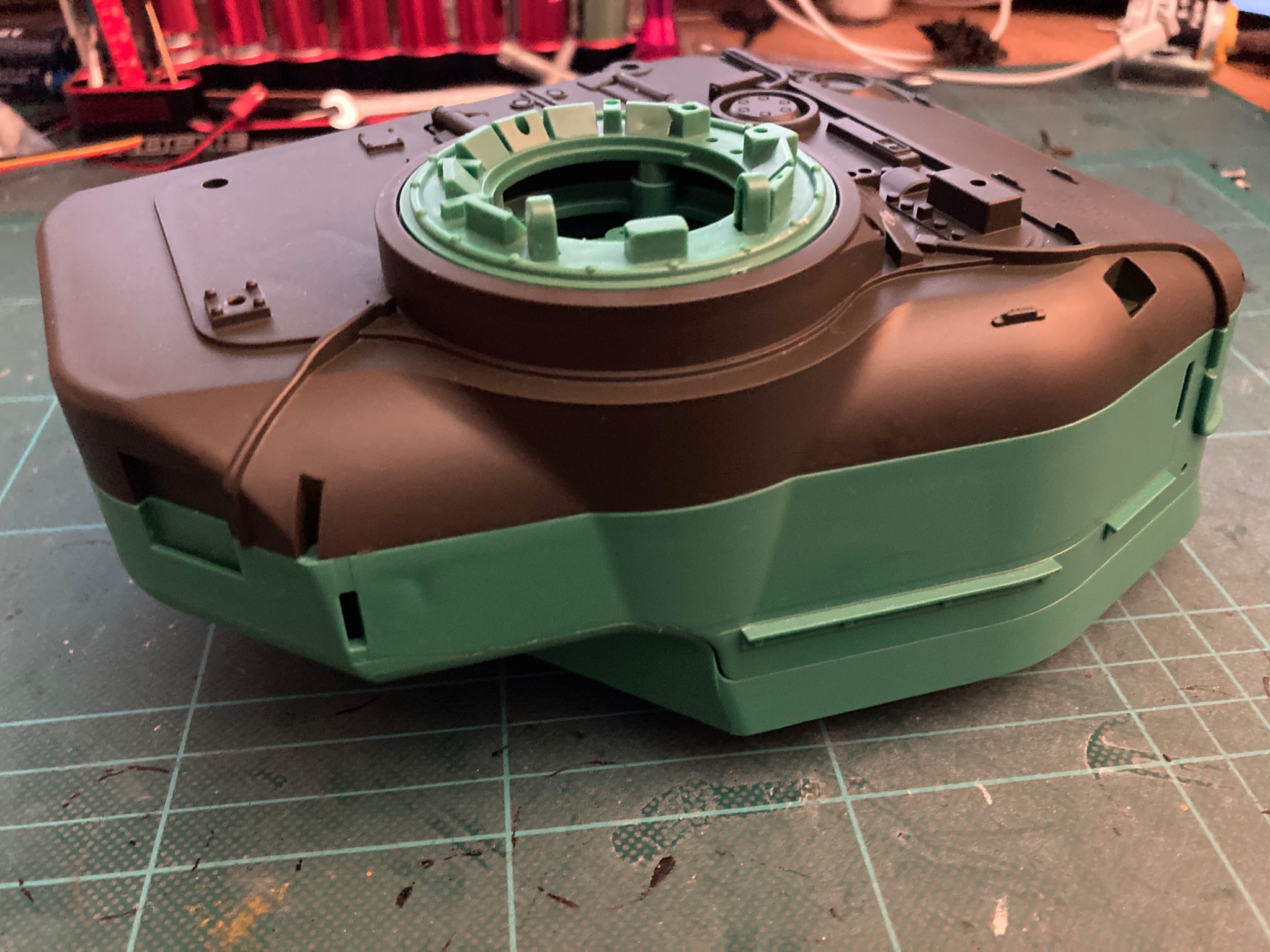

Another thing that I think I should do before fitting any electrical parts is to get some paint on the turret.
At the moment the bottom and central sections of the turret are still in the original loud plastic moulding colour of Kermit Green and the replacement Mk5 turret top came painted in Deep Bronze Green - so no part of the turret is painted in the Olive Drab that this tank will be finished in.
I will get these parts painted before fitting any more electrics..............

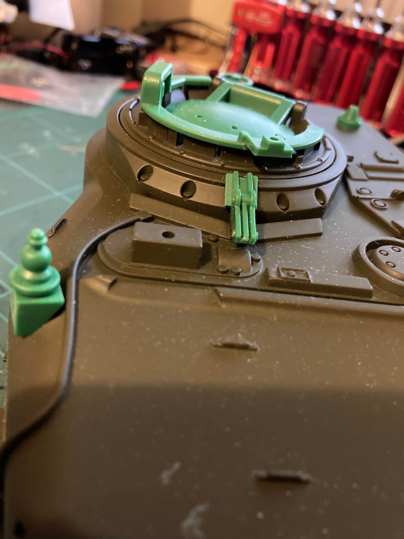

HAYA Centurion KIT. Vision Block(?)
I have sprayed the turret all over with Tamiya TS-5 Olive Drab, so it is now looking a little more "uniform" (no Kermit Green) so the small detail parts that fit on top of the turret stand-out like a sore thumb - because they are still Kermit Green coloured !
........but one of them is missing......
I think it is called a "vision block" ? It fits on top of the "brick" shaped block in front of the rotating cupola and it will have a locating pin on its underside to fit into the hole on the top surface of this "brick".

Re: Amateur Build. HAYA Centurion KIT
You are probably right but I just wondered if the hole was for the Turret MG mount, Just a thought

zooma: I keep all those nice little gears, springs, etc., that you show in the photo. I keep thinking that someday I will find them useful. Hence, my modeling area is also a junkyard.
