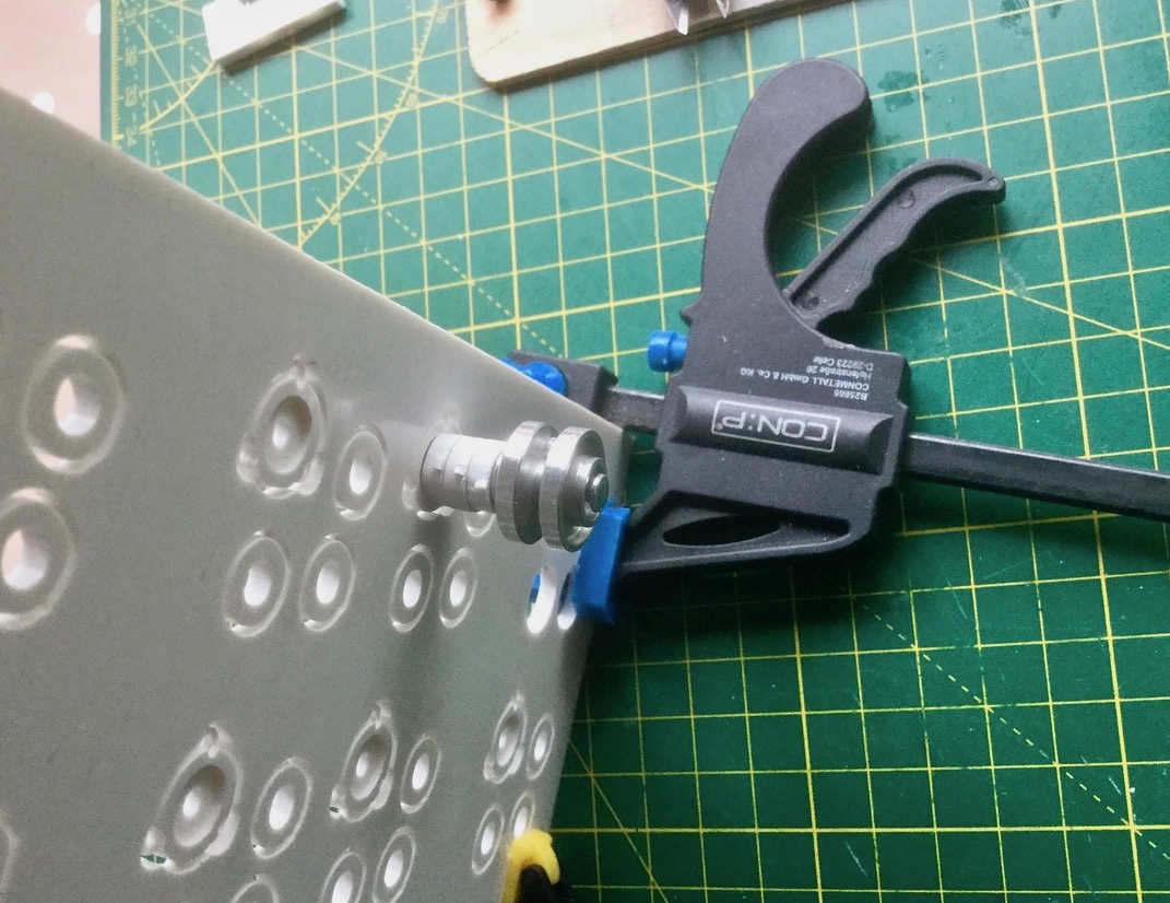

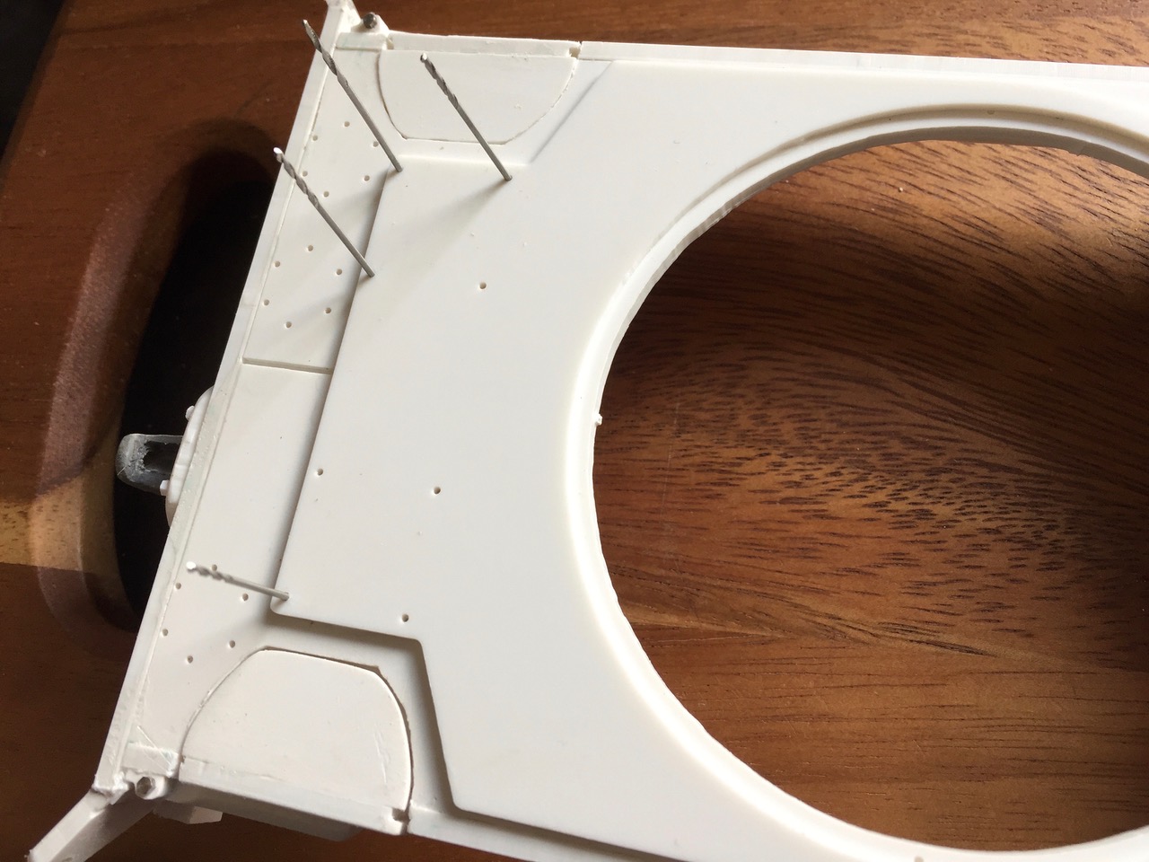

No...it's not acupuncture for armour. But these small drill bits can be used as a jig when fitted into the pre-formed bolt holes.
Acupuncture for model armour-or the Comet turret ring plate fitment.

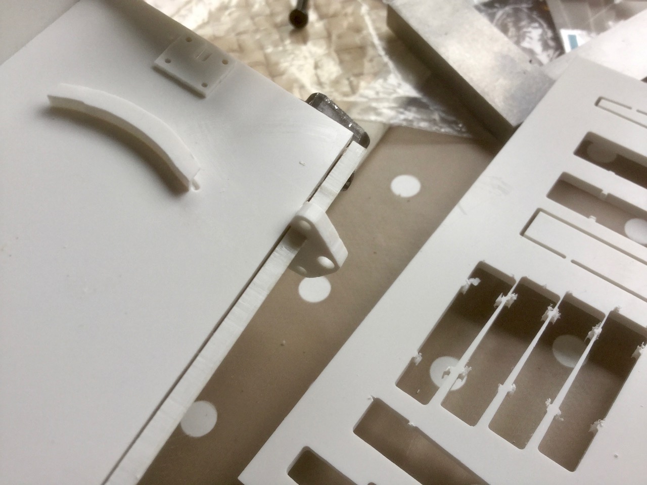

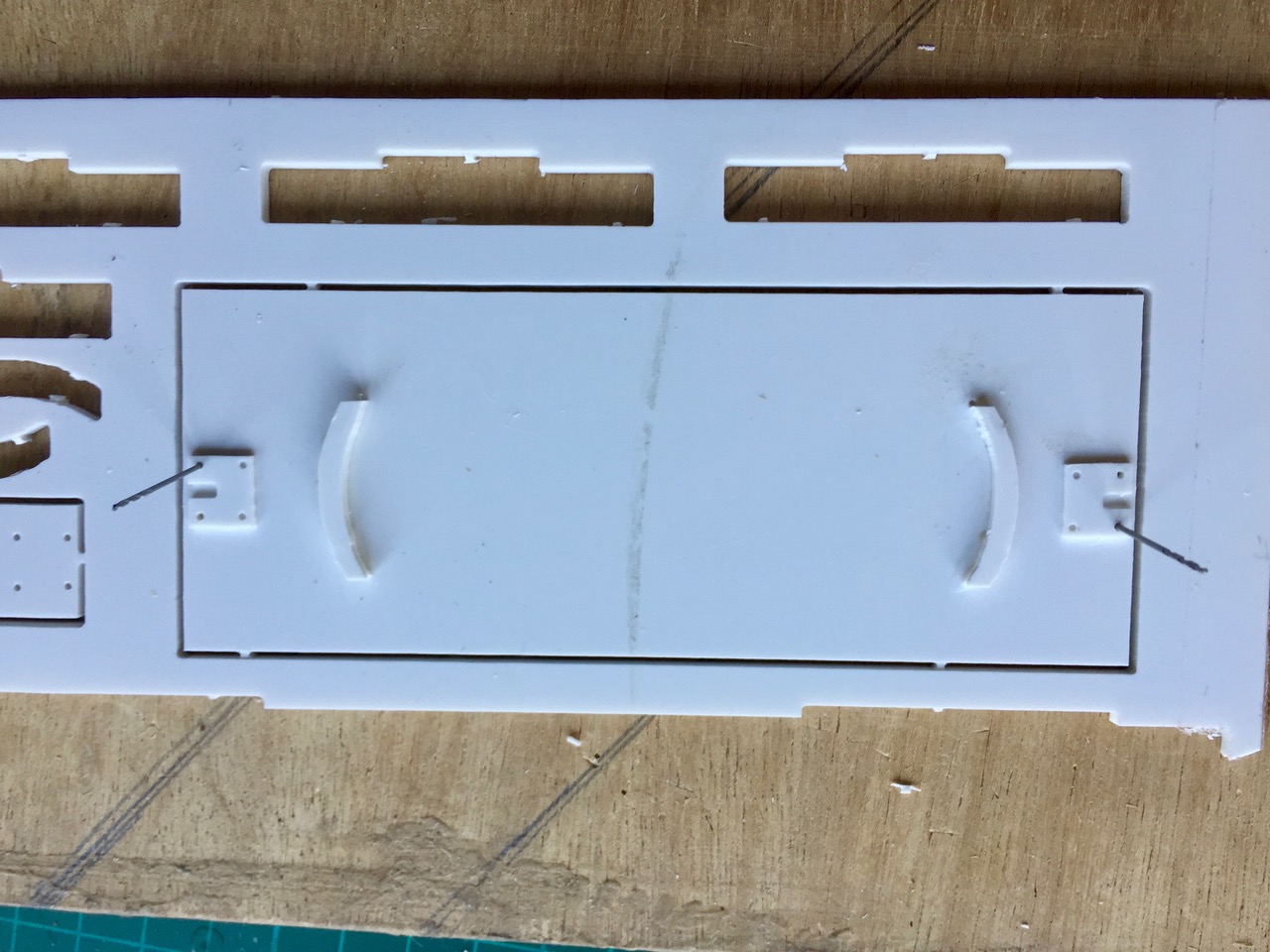

I also put some furnishings on the Glacis plate. It's easier to do when the plate is still attached to the plate sprue. What's more, I'm not going to fit it to the Lower Hull, until the Henntec unit has been fitted. Working on Henntec is a nightmare with the glacis plate in place. Fitting the headlights and headlight protectors is also a lot easier off-tank. :think:
Comet build glacis plate

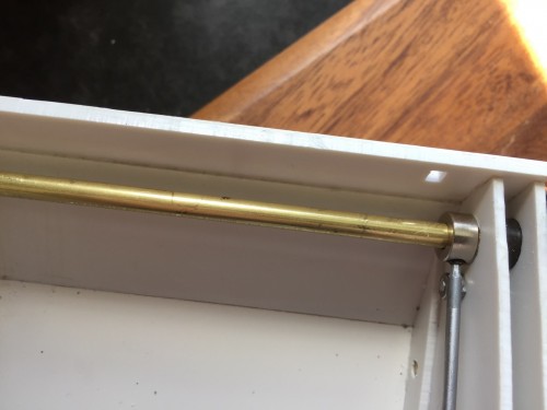

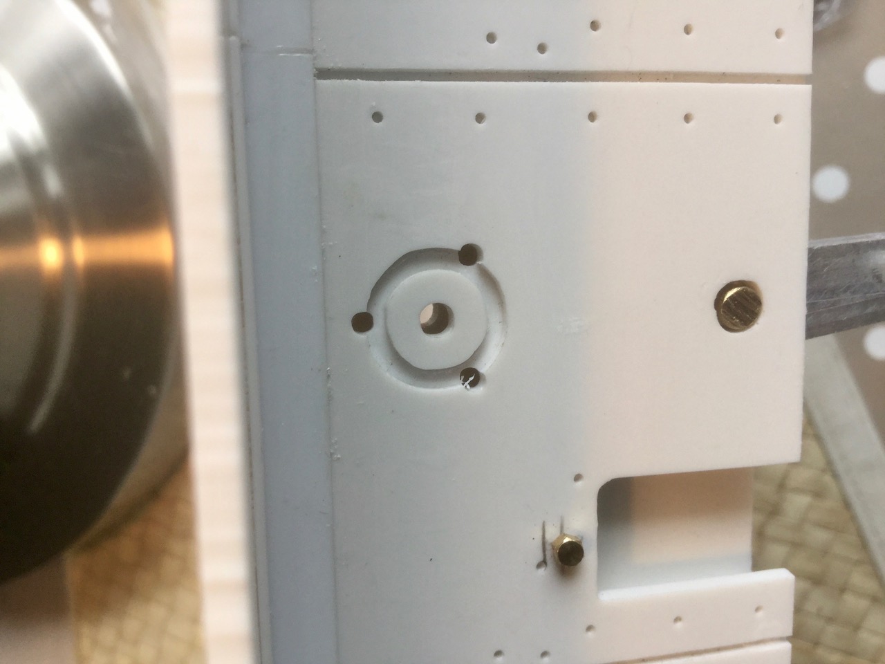

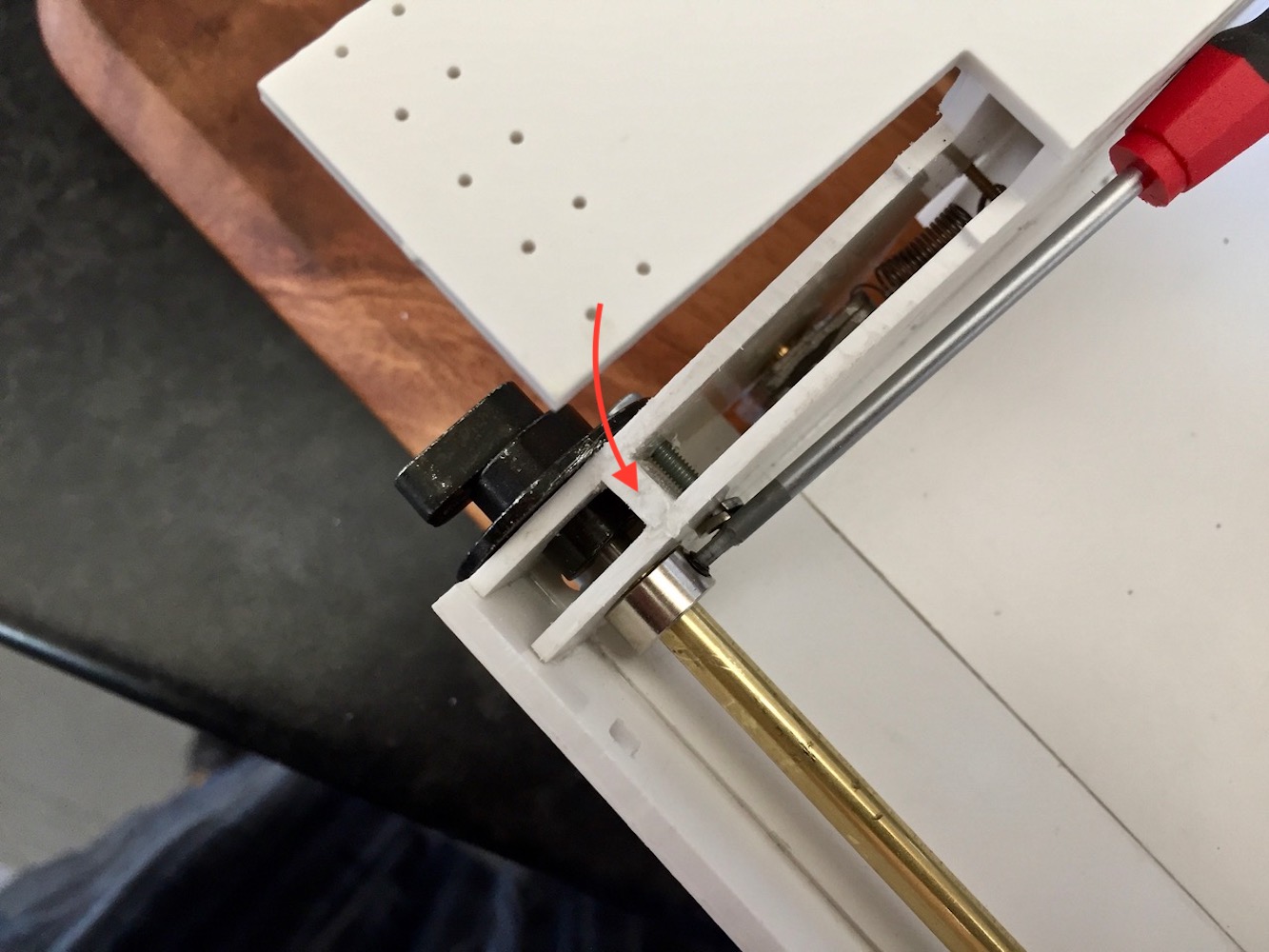

Fitting the Henntec unit seems to be the next logical step. The sooner the idlers and drive sprockets can be fitted, the better it is to see whether all the suspension components are going to align in the way they should. (The horns of the tracks should be able to travel in a straight line between the return rollers, idlers, and double roadwheels.)
Comet build- fitting Henntec track tensioner unit.
The holes in the lower front armour plate, were likely intended as access points for the grub screw in the steel locking ring. However, I found that there was not quite enough room in the sandwich of plates to accommodate the locking ring. For that reason, I left it located on the inside of the tank. I did, however, orient the grub screw so that it can be slackened or tightened after the glacis plate is bonded in place.
This is fairly necessary. :think:
I also had to trim the edge of the unit, so that it sits neatly along the line of the lower front armour plate
As this is going to be a fairly stressed part of the model when the tracks are fitted, I decided to bond in some supports (little bulkheads) between the plates in the sidewall, just in front of the retaining screw.
This also allowed me to tighten the nut and screw without deforming the plates. :thumbup:
Support added to side plates holding Henntec unit

A few updates. Here I've added the tow shackle brackets to the front armour plate. The Glacis plate is in place for appearance's sake, but won't be bonded on until the headlights and light protectors are fitted.
Click to ENLARGE...
Front tow shackle support brackets

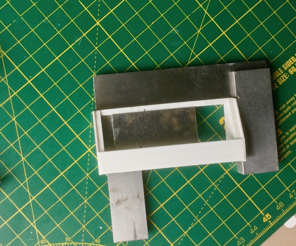

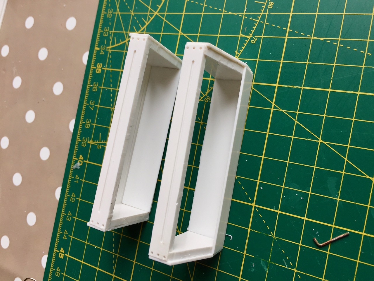

I also assembled the upper hull storage boxes. I intend to fit a back panel to the units so that when bonded to the lower hull, (concealed) screws can lock pass through into the upper hull, helping to lock the two together. More on that, later.
Assembly is fairly straightforward, so long as set squares are used:
Storage box assembly
If you look at CL's build instructions, the storage boxes shown are those for the Cromwell. These have raised ribs for strengthening the plate, on the lid and front; just like the real thing. However, storage boxes on
the Comet don't have these ribs, so it's not necessary to fill the preformed slots on the panels with 1mm styrene. I will just turn the lid over, to the smooth side, when fitting it. :|

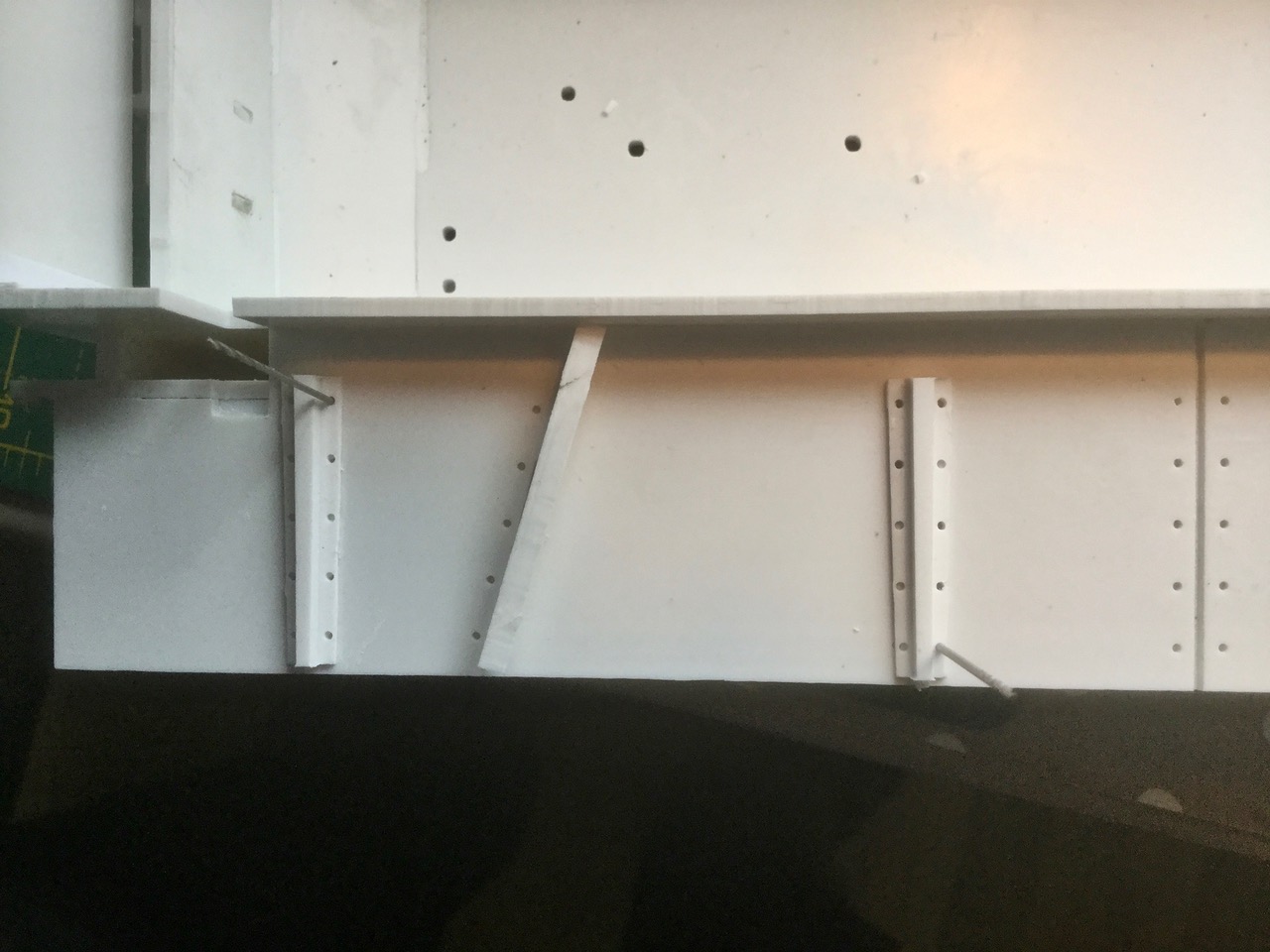

Time to fit the newly arrived mudguard support brackets.
Mudguard or Fender support brackets
and fitted:
Mudguard brackets in place

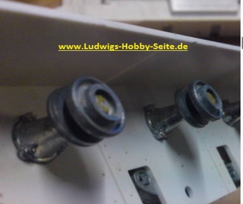

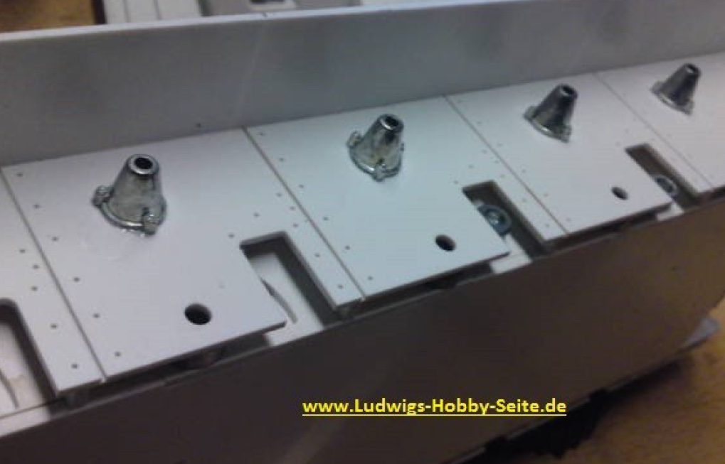

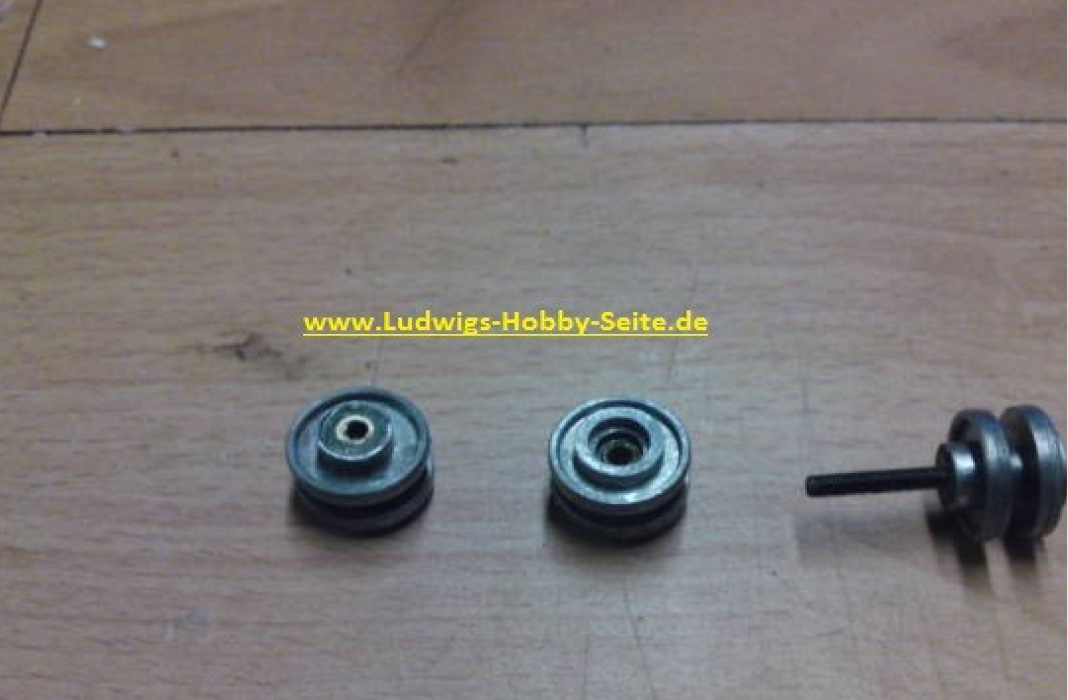

This one concerns the return rollers.
This is all you get on return rollers, as per CL's pdf:
Comet build- CL-Return rollers pic A
Comet build-CL-Rollers A.jpeg (93.46 KiB) Viewed 3065 times
Comet return rollers-CL-pic C.
And that's it: three pics, and no comment.

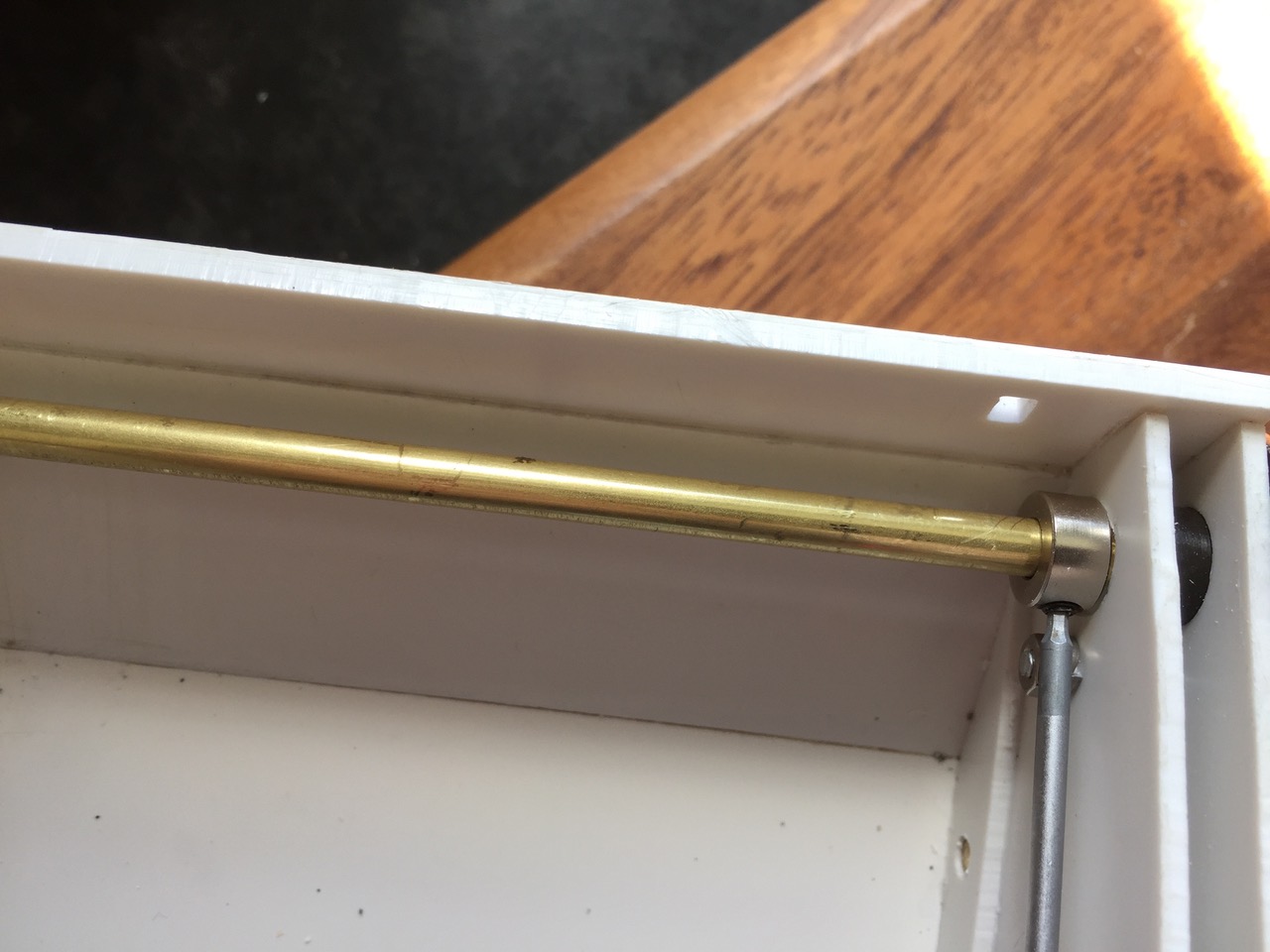

I'm guessing that the Pz 111 return roller mountings have been glued in place, because unless there's some locking arrangement (nuts and washers) immediately behind the outer hull wall, there's no other way of attaching the mounting. :eh: Why? Well, the standard axle supplied with the mounting isn't long enough to go through the roller (even starting from the midpoint of the roller, some 18mm from the outer plate), the mounting, two walls and a gap. Have a look at this:

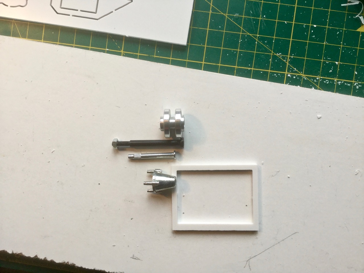

These are aligned as they would appear with the hull wall on the left. The polished steel axle is the standard one for Taigen and HL. It's long enough to go from the midpoint of the Roller (it's head is sandwiched
between the two halves of the roller), through the mounting, and one layer of styrene.
The black axle is from the Tiger 1 roadwheel suspension, and is long enough to pass through the roller; the mounting and the Comet's doubled- up sides. This is the one I'll be adapting for use.
The roller see here is a Schumo Pz IV type, and I may use it for the build. I'm waiting for a delivery of the Taigen Pz III type in the meantime. Should you chose to build the Comet with Pz III gear, do remember that you will need to order two sets of mountings, as the Pz 111 set only has 6 mounts, and this tank needs 8. :|
Return roller axles
Return roller axles

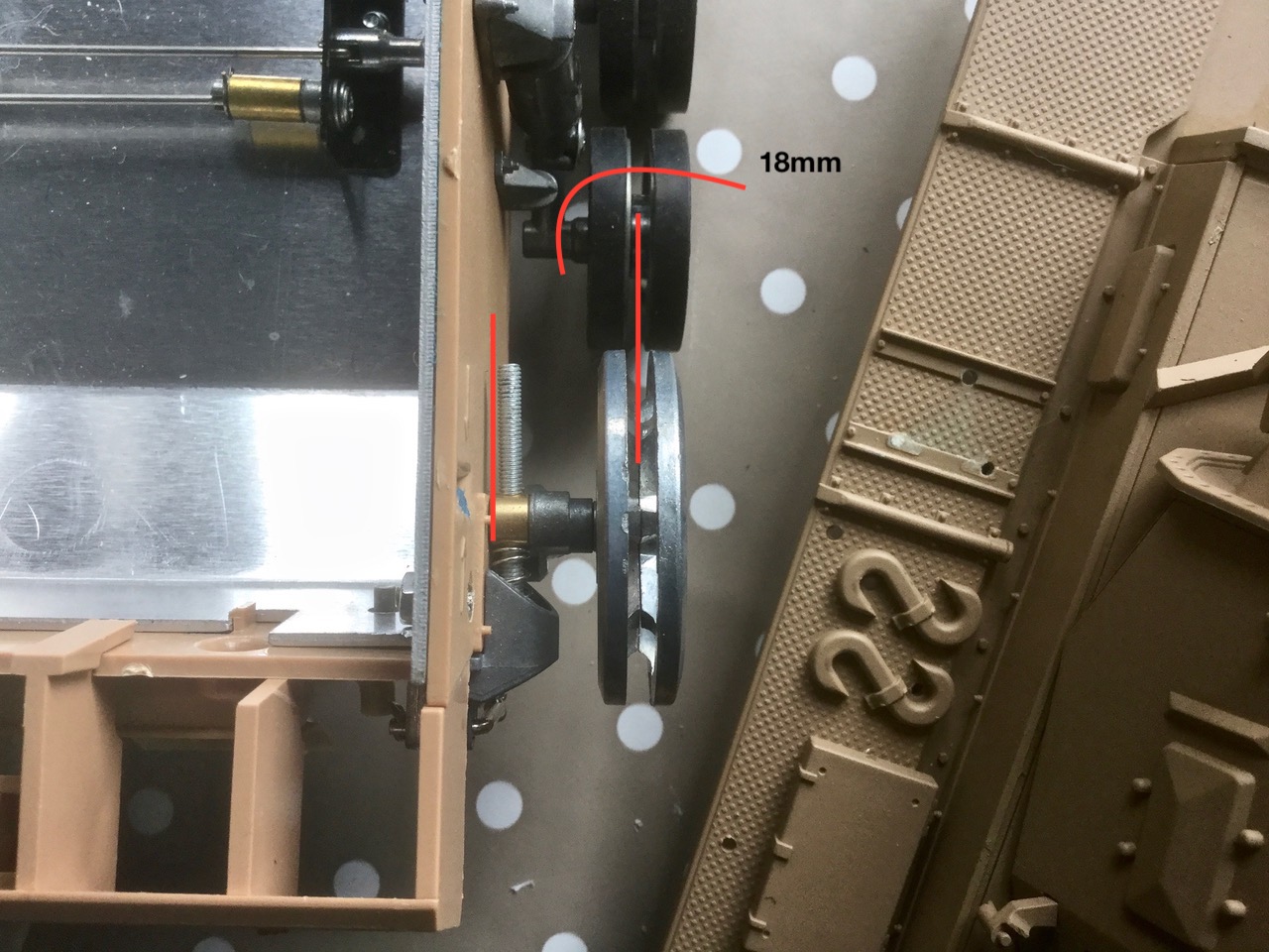

Re: Comet A34- Ludwig kit
Pz IV and Pz 111 mounting and rollers will probably cut the mustard here. The centre line running through the wheels, rollers, idlers, and drive sprockets is roughly at a distance of 18mm from the hull side, in both instances. Also
Whether Schumo, HL, or Taigen, the rollers and mounts combined seem to stick out by around 24mm. Anyway, we'll see when the bits arrive.
Panzer 111 suspension alignment

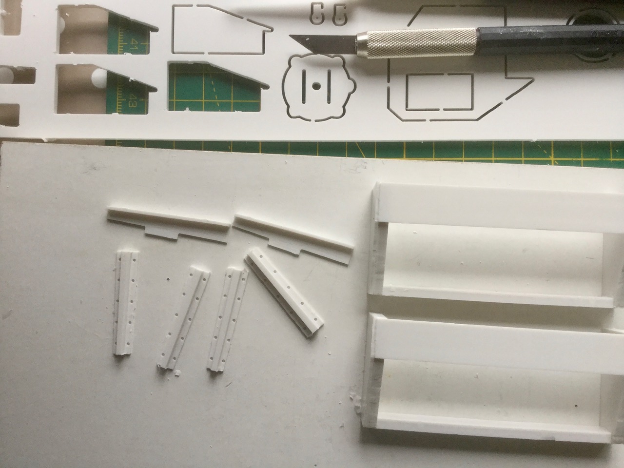

Do, I have a way of sorting this. But here's the conundrum, this sheet of parts arrived with the kit:
I've spent a good few hours wondering what the bits are for. :eh: Clearly, there are three (3mm thick) rings for each of the roller mounting base; but they make no appearance at all (guest or otherwise), in the Pdf build.
If they're meant to go between the two side panels- well, it's too late. Anyway, the base itself only duplicates the one that's already CNC cut into the hull wall:
Comet roller mounting position.
With the extra long Tiger 1 axle, I won't need to wonder what these bits are for. I'll just ignore them, as - apart from enlarging the hole in the mounting slightly to accommodate the greater diameter of the Tiger shaft, the arrangement I have in mind should work..
Speculating about it a bit more, I'm guessing that the three rings could be bonded together, to make an alternative budget roller support mounting. Something like this:
Alternate roller mounting?
In any event, as I've already said I'm going to bypass this conundrum :thumbup:

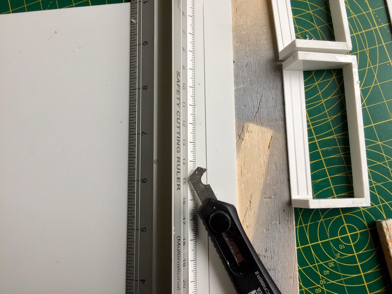

Back to the storage boxes. I got on with (carefully) cutting out some backing pieces for the units. Drilling through these, into the upper hull sides, will provide a discrete means of fixing upper and lower hulls together.
A couple of self- tappers will then provide a firm attachment, and fairly quick separation, when needed. There are no off-the-shelf quick release mechanisms for the Comet. :|
Comet build-backing pieces for storage units
The two tools involved: the Tamiya cutting tool, and the Safety cutting ruler I find invaluable- even though they were inexpensive. The ruler has kept the gore out of scratch building, and allows one to slice away with confidence :D
Comet build-Storage box backs
