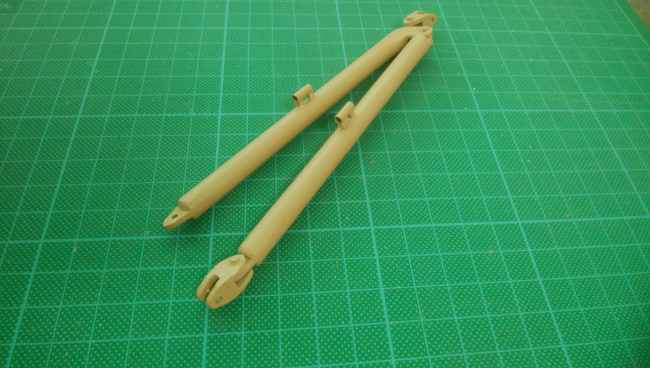

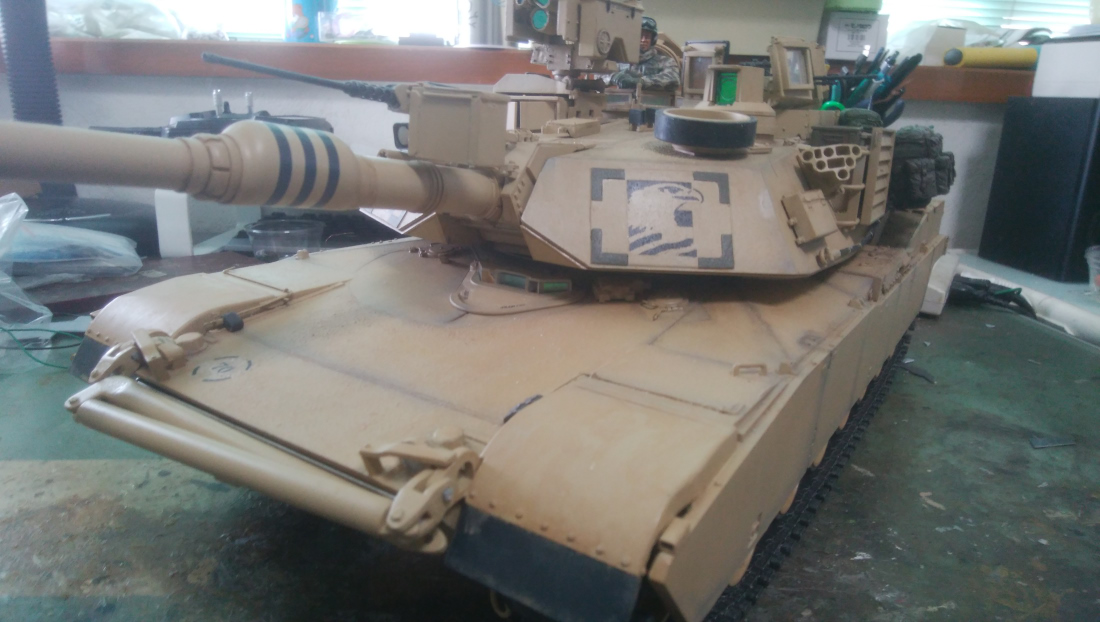

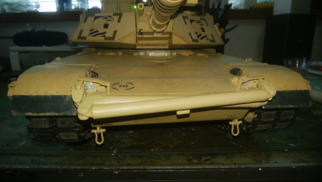

I made a tow bar to be installed in front of the M1 Abrams. Tow ropes are a staple in WWII tanks, but tow bar seems to be common in modern tanks.
This was made from WAVE's 8mm? plastic pipe and plastic plate laminate. The adapter is attached to the tow bar. Some real tanks have tow bar and some do not, but I added it because I thought it would look better as a model with the tow bar.

I agree the Tow Bar looks great hanging from the front and adds a level of interest to the forward hull.

Barry, thanks for your comment. As you say, I also felt that adding the Tow Bar would make the tank forward hull look much better.

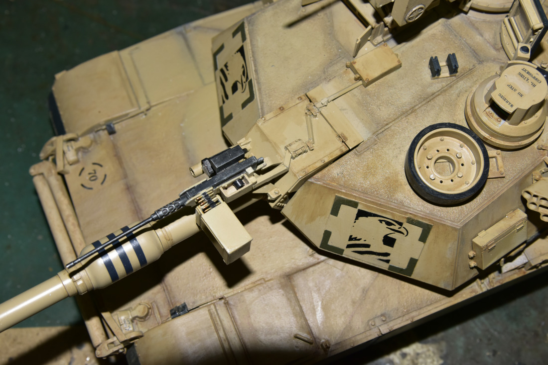

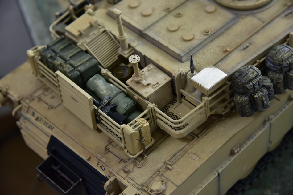

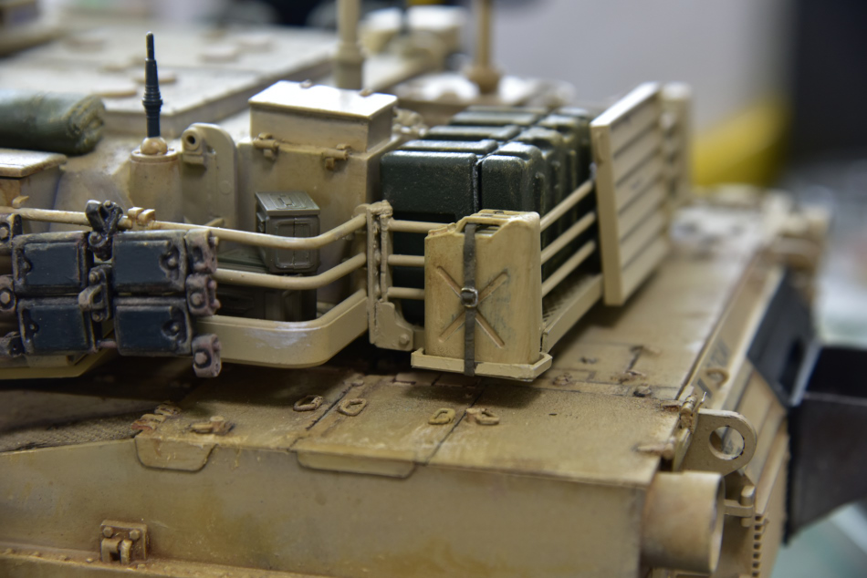

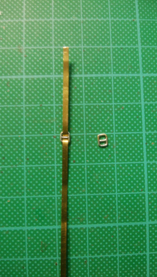

I made a belt to fasten and fix jerry cans. You can see model works of tanks in which ammo boxes, luggage, jerry cans, etc. are randomly placed in the bustle rack or on the turret, but in the case of real tanks, it is obvious that these will jump out when tank starts to run. I've heard that real tank crews take great care in arranging or securing their luggage so that it doesn't fall off, hinder sensors or their field of view. It seems natural because these can affect their lives during actual combat.

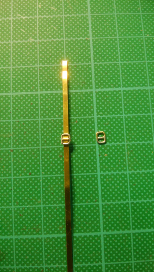

I bent the brass wire into a rectangle and soldered one brass wire across the center of the rectangle to make a buckle for the band. The band material can be anything that is strip-shaped and flexible, but I used a brass band plate this time. With this method, you can easily make the binding band and buckle in a shape that looks good, although it does not have a length adjustment function like the real one. If the belt material is more flexible, such as cloth or paper, this buckle can allow for length adjustment. A fixed band for jerry cans. I also put a band on the blanket and small arms.

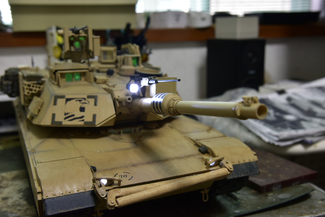

The searchlight attached to the anti-sniper/objective MG can be turned on with an LED. I used a thin enameled wire to wire the LED and routed it through the cable duct between the MG and the turret. The headlights and blackout headlights can also be switched.

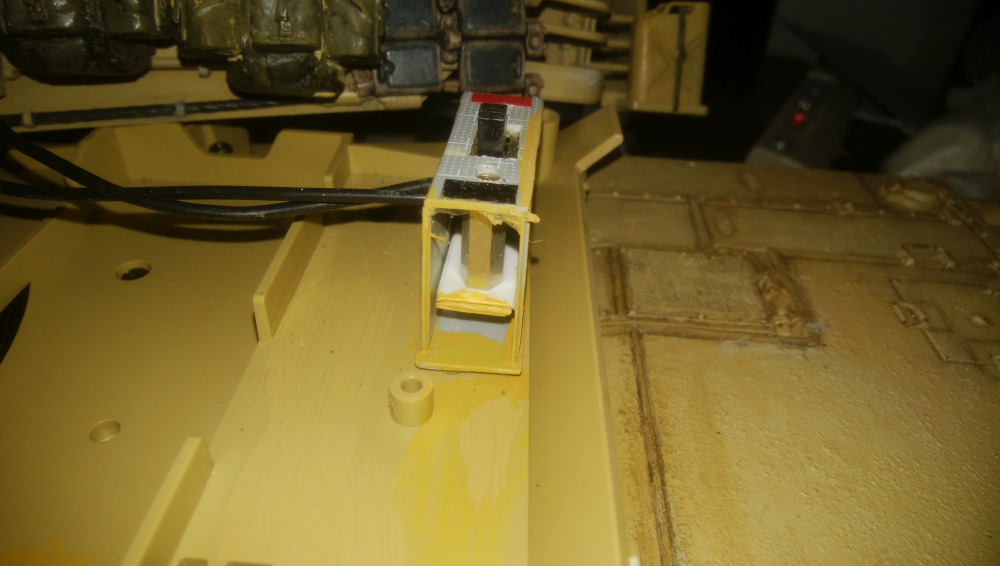

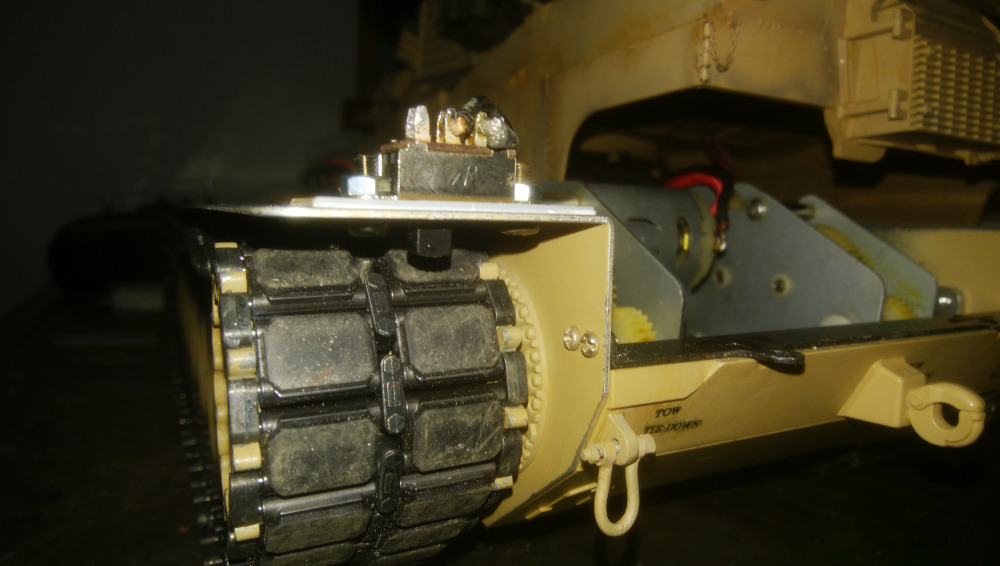

Main switch position change

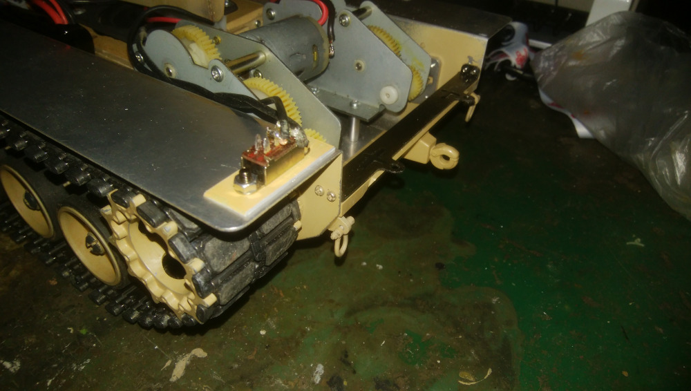

I installed the main switch of this M1A2 model under the blow-off panel of the turret like TAMIYA's full operation RC model.
However, in order to install the slip ring for turning the 360° turret, it is advantageous to install the battery and main switch in the under hull. The main switch should be installed in a location that is inconspicuous from the outside. When the main switch is installed at the bottom of the tank like the HengLong tank, I have to lift the tank every time I switch it on and off.
When I installed the main switch on the rear upper part of the rear drive sprocket wheel, it was hidden behind the side skirt and the switch was invisible, but within easy reach of my fingers.? I made a rectangular hole for the switch in the relevant part of the under hull and fixed it with a screw. The switch is completely invisible when the upper hull is installed. But my fingers can easily reach the switch.
