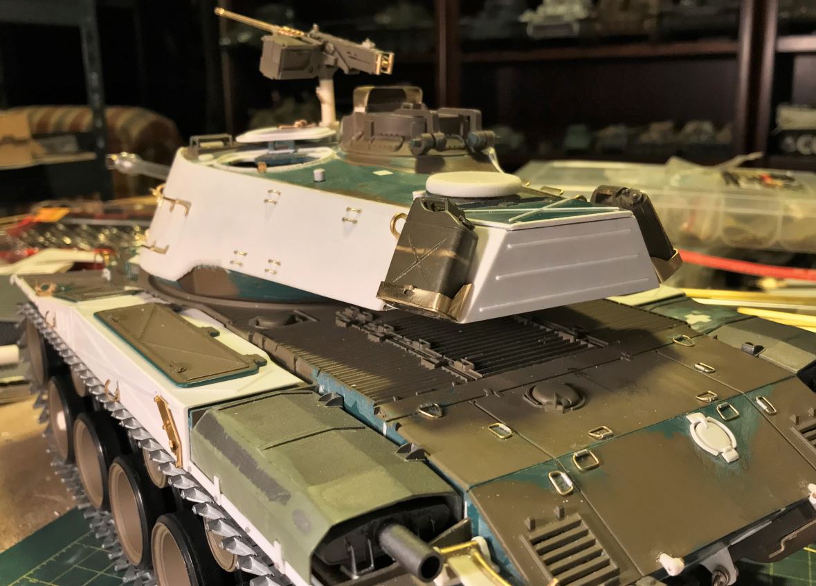

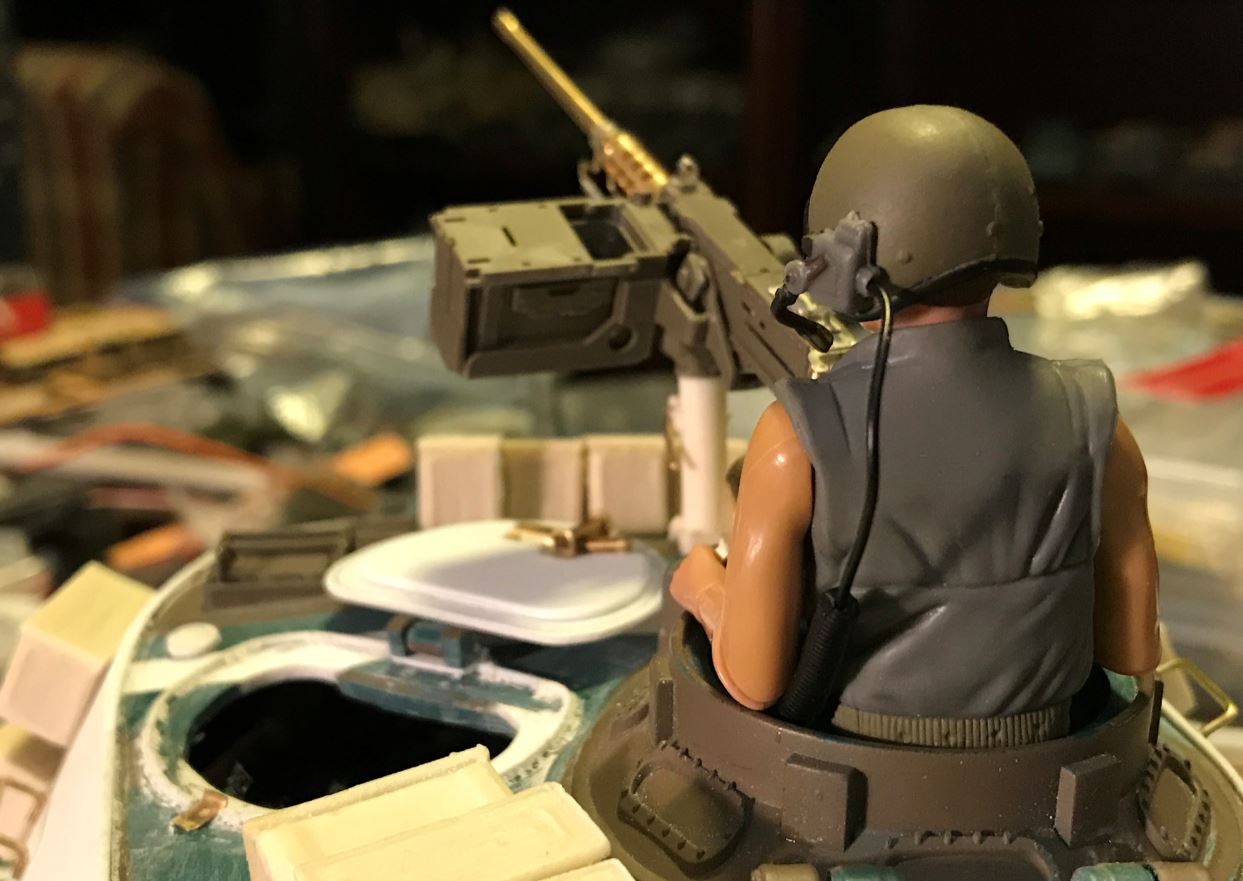

HERMAN BIX wrote:As its quite a "sticky-uppy" accessory, is it robust enough to take the odd snag or bang in case of bad driving !!?
Its the same M2 as on the Tamiya M26 Pershing. The brass barrel makes it barrel heavy, that could play depending on the speed, but the Nick Aguilar resin mount is solid enough. I see no issues.

HERMAN BIX wrote:.
Herman,
That was my concern and why I used the solid metal copy sold by AFV Model on my Abrams. After seeing how well the Aber set dresses up the plastic Tamiya M2 I my consider using one on the Commander's gun station but will stick with the solid metal version for the one mounted out over the main gun.
The Tamiya plastic receiver sure would be easier to modify to the current M48 version used on the Abrams tank. :clap:

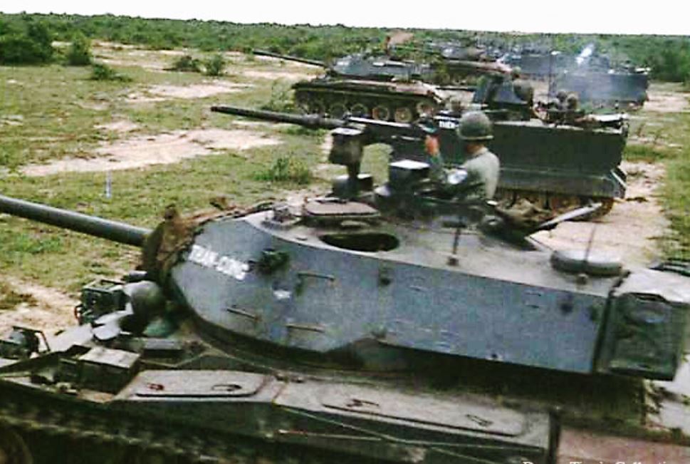

Ammo boxes are often piled up on the front glacis and on top of the turret.

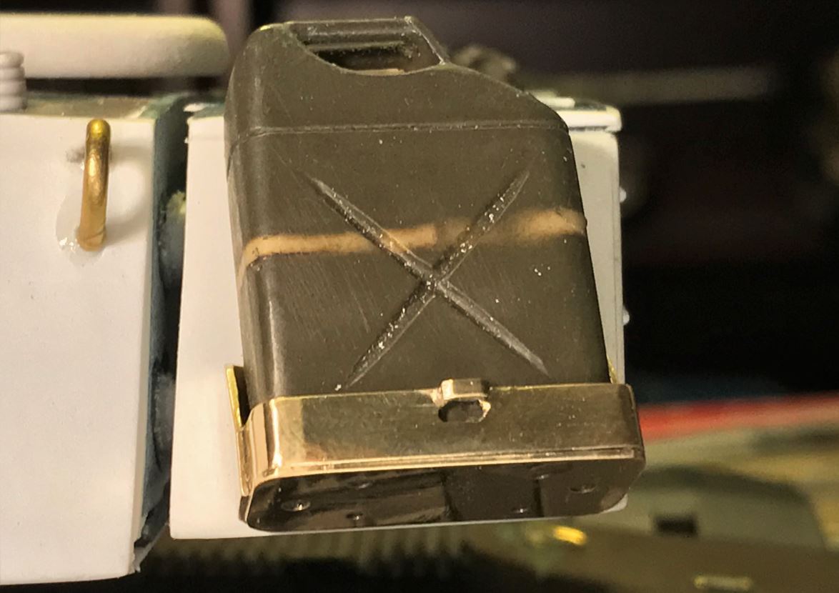

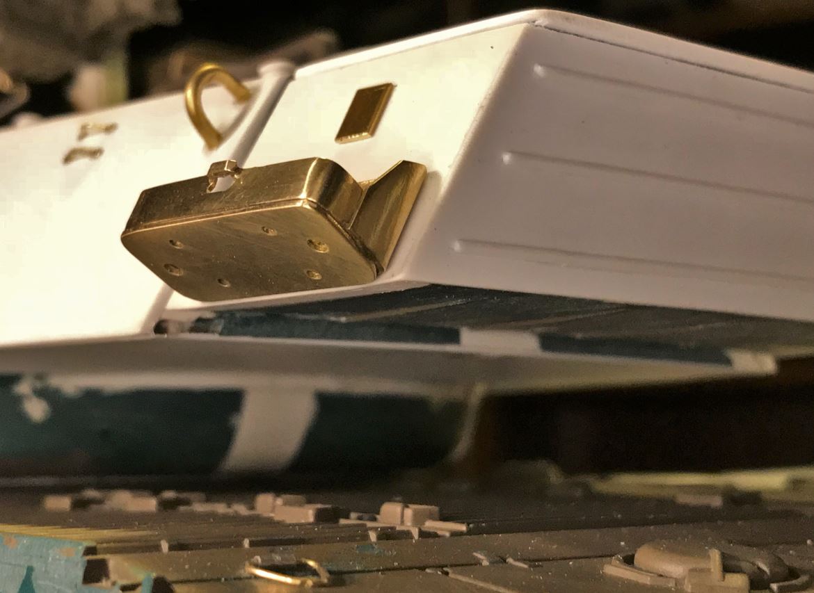

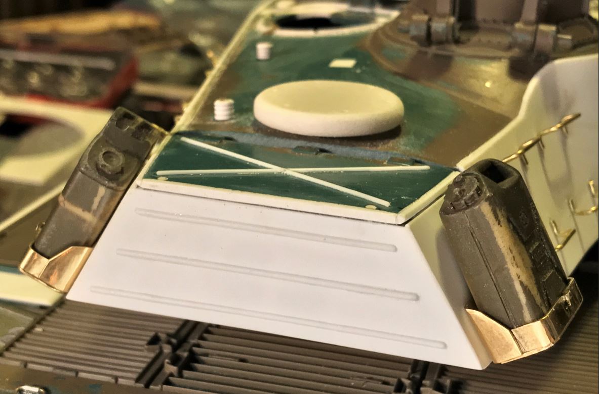

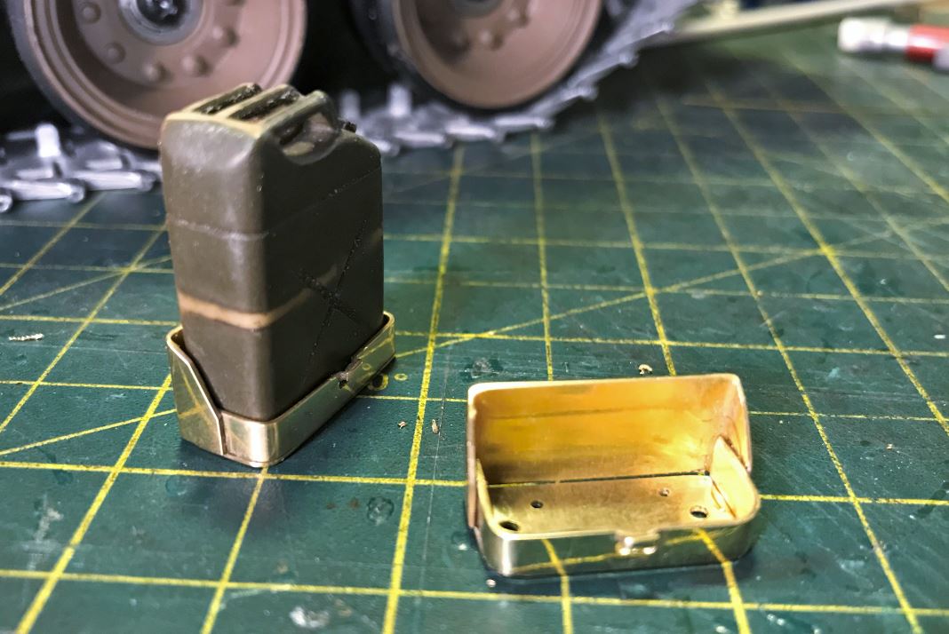

Continuing with the turret, this post is for the water can racks at the rear of the turret.

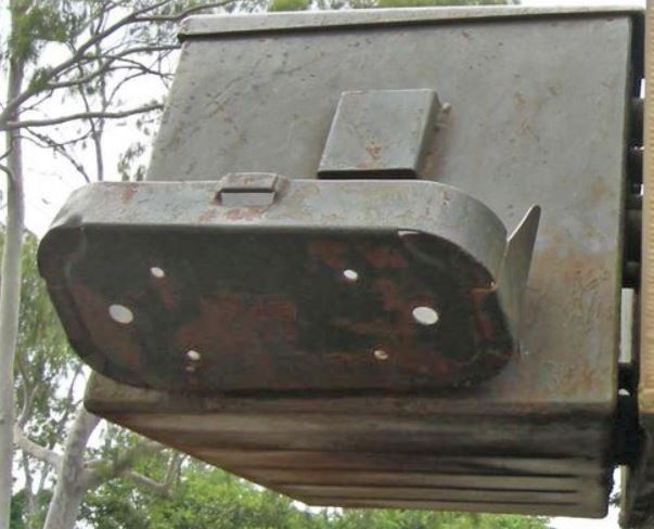

This is the rack that need to be replicated. It is not easy because the hole and the raised holder for the strap is important. Looking at this, I knew this would be the complicated part of the build.
M41A3 1/16 RC turret detailing
The Heng Long parts are accurate in shape but the details are not that great. The issue is that once you start detailing a model, it is important to be consistent. I do not like cutting corners by using some parts that are not at the same level as the others next to it. It would not look good. You either super detail it all, or you don't.

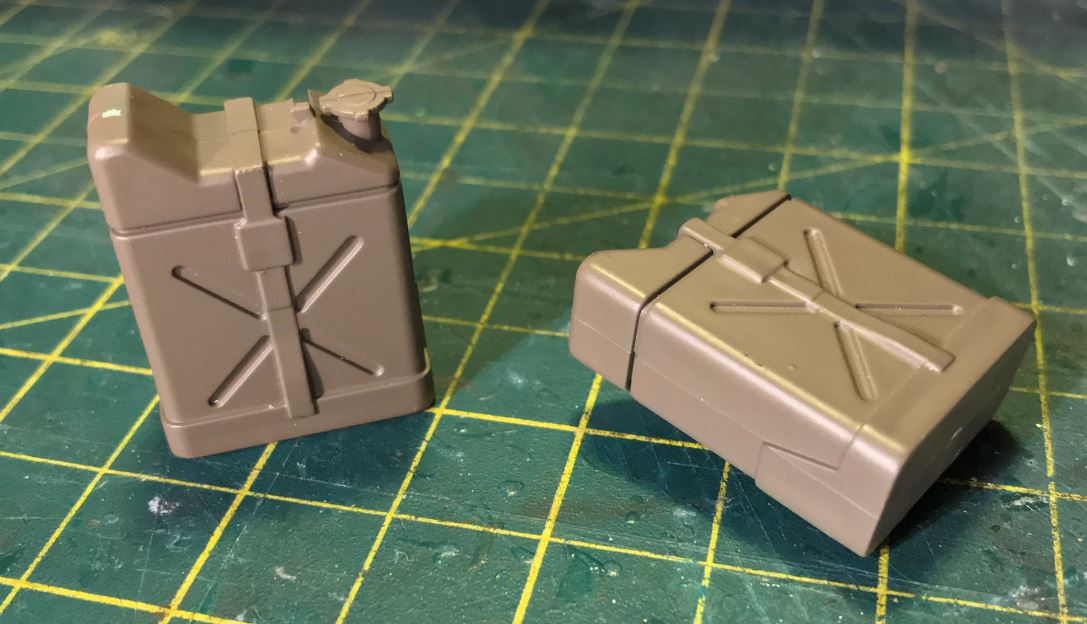

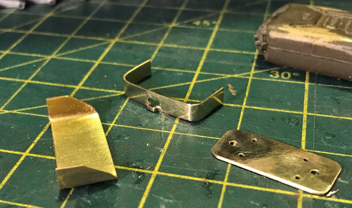

After some analysis, the main components are created in brass because of the rounded features of each corners. I will be using Verlinden Jerrycans that are leftover from the M113 build. But any standalone US jerrycans will do.
Parts are assembled with superglue. The hole for the strap was done with a 1mm drill bit right in the middle, then drilling sideways horizontally on both sides to make it wider. And then I tried my best to make it look good using the drill bit and some pliers, and a small strip of brass glued on top, then sanded and polished. Not easy...
The strap holding the jerrycans in place will be added only after painting. Not sure yet what kind of material I will use.
It took about 90 minutes per rack to build and I am satisfied with the results. After painting and with the strap in place, they should look very good.

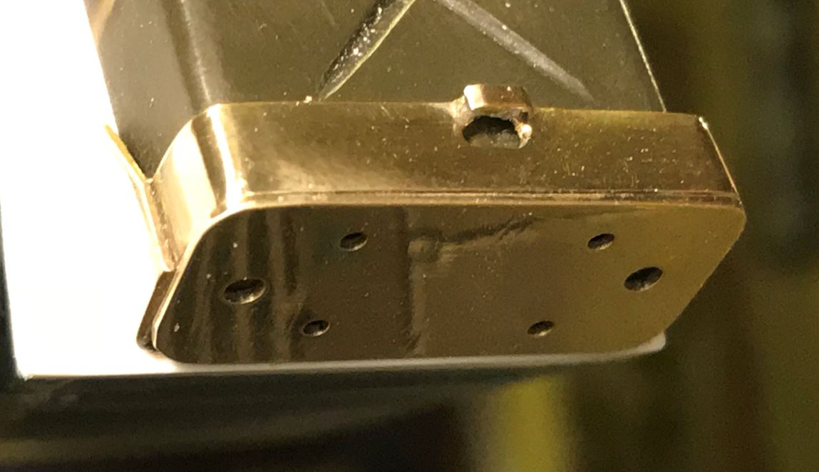

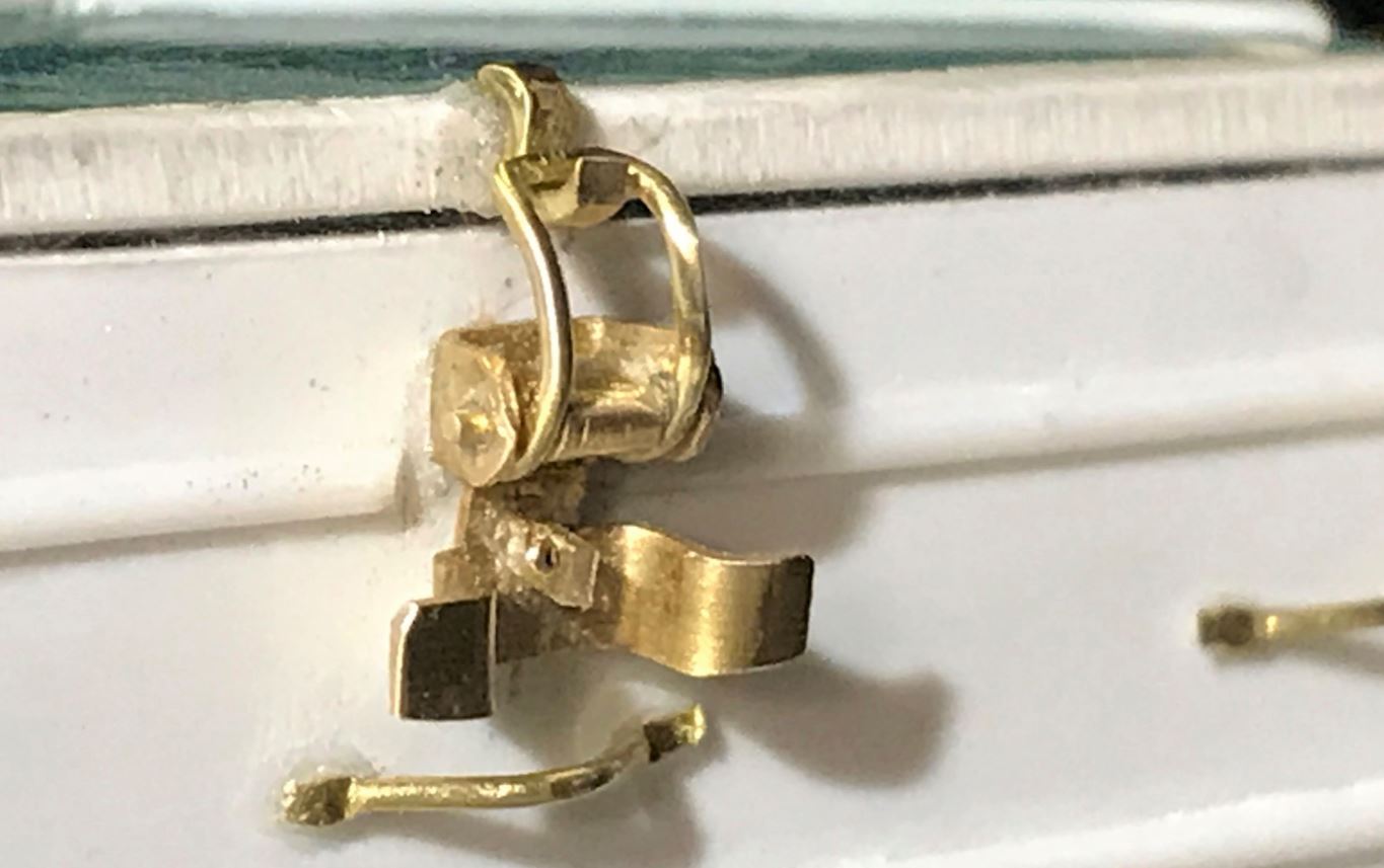

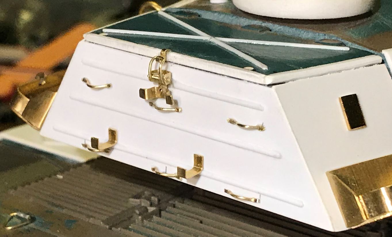

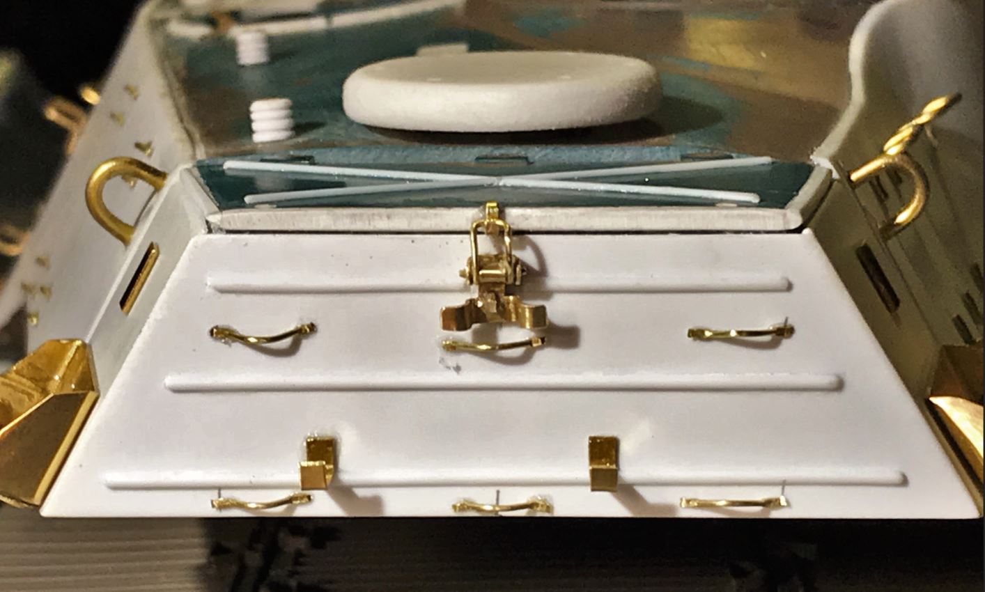

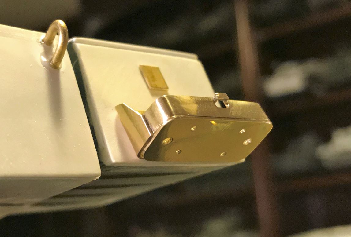

Hi, I am getting close to the end of construction.
Below is the rear of the turret bin, with closing latch, tie downs and two brackets. The latch was created the best I could from the pictures I have seen. I am not really happy with it but it's so small, it needs a close up like the ones below to notice any inaccuracies.

I have never seen an M41 with the M2 tripod stored in the back on those 2 brackets in the middle. Other than being of use maybe if the tank becomes disabled... I do not understand why it was planned for an MG tripod to be provided to tank crews. In any cases, the ARVN crews did not care for it.
M41A3 Heng Long 1/16 upgrades

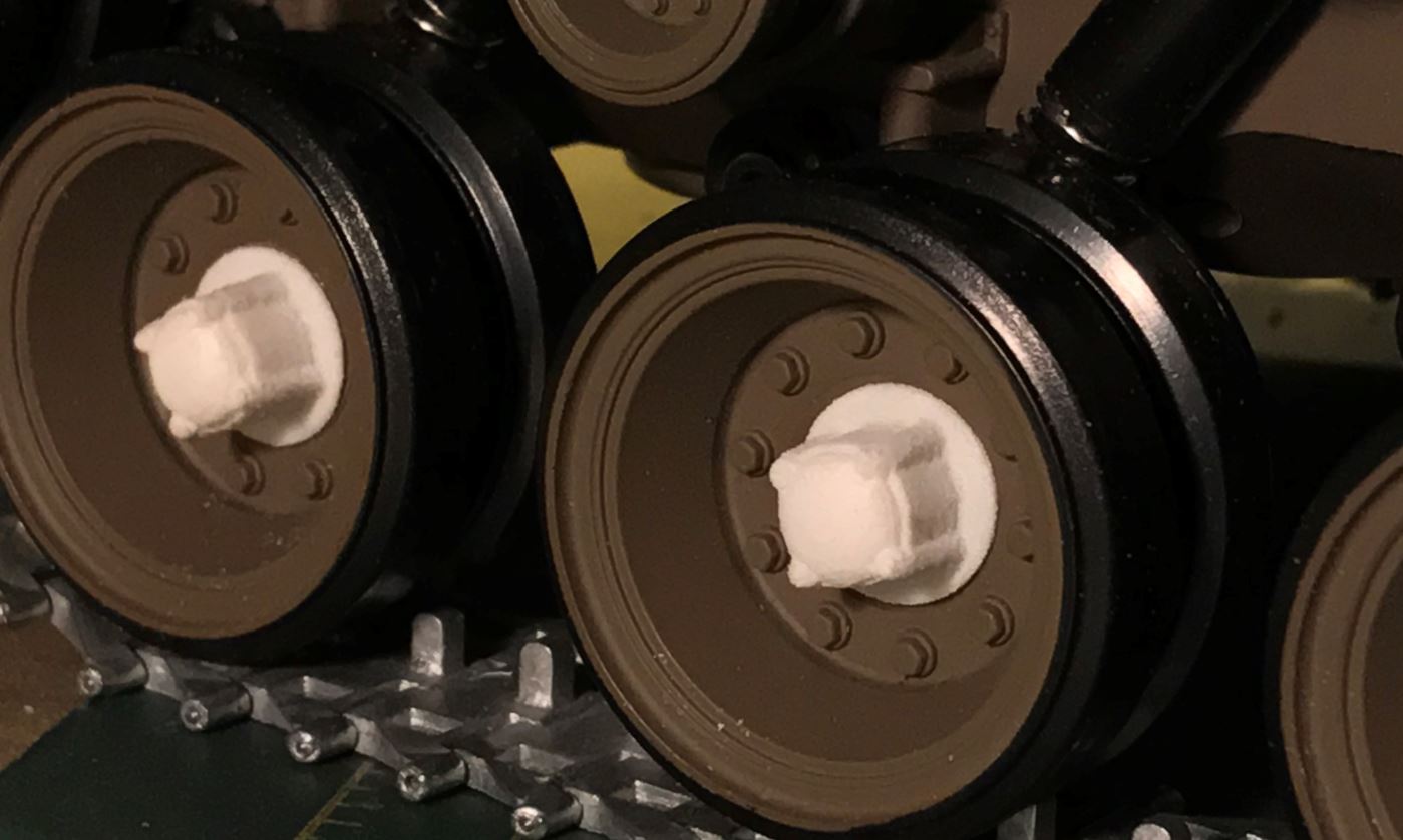

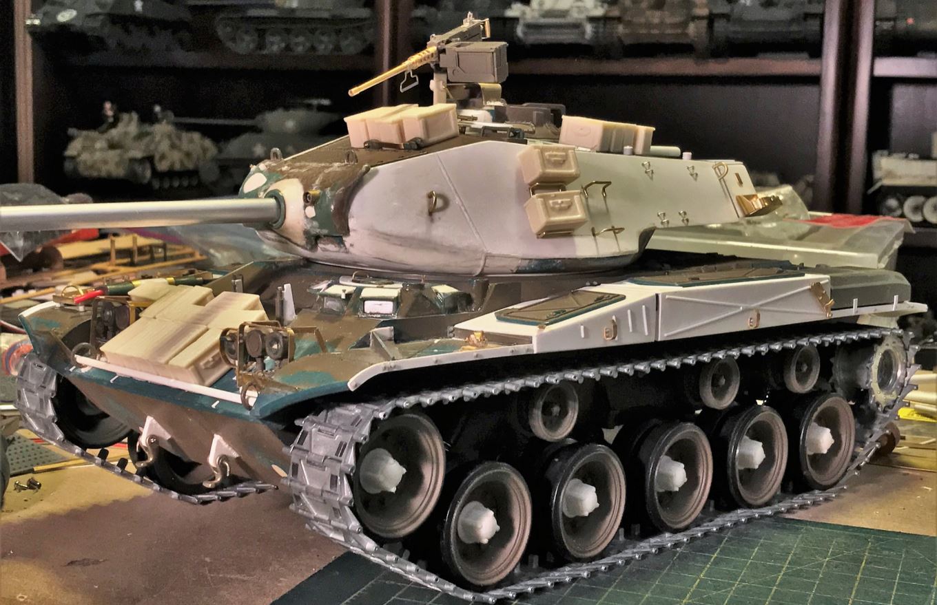

There is nothing I dislike like sanding 3D printed parts, specially on road wheel hubs with no flat areas. It is difficult to do a good sanding job on these Shapeways parts. Although they accurately show the hub with the 4 pins of the M41 instead of the 6 pins of the M26, the texture might not look good after painting. In any cases, I still have the plastic M26 hub in reserve in case they look better in the end.
Shapeways road wheel hubs are installed on the tank. They required a lot of preparations and modifications because of my road wheel arrangement with the ball bearings.

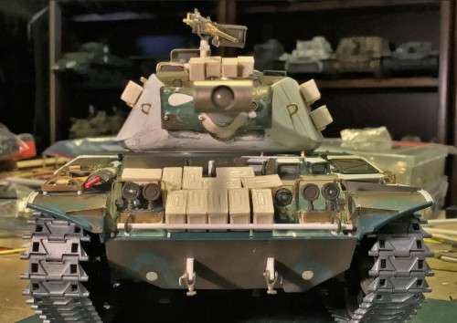

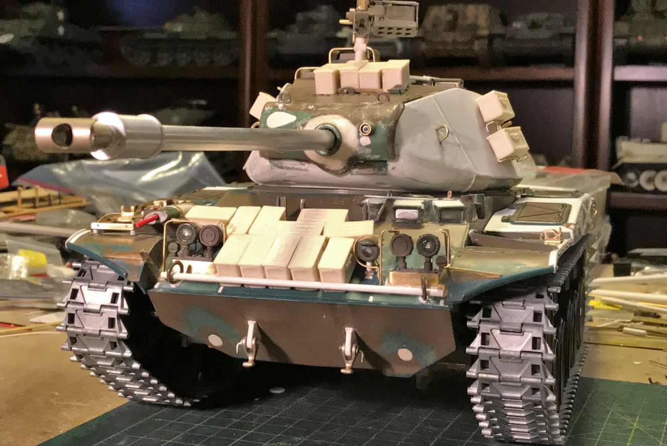

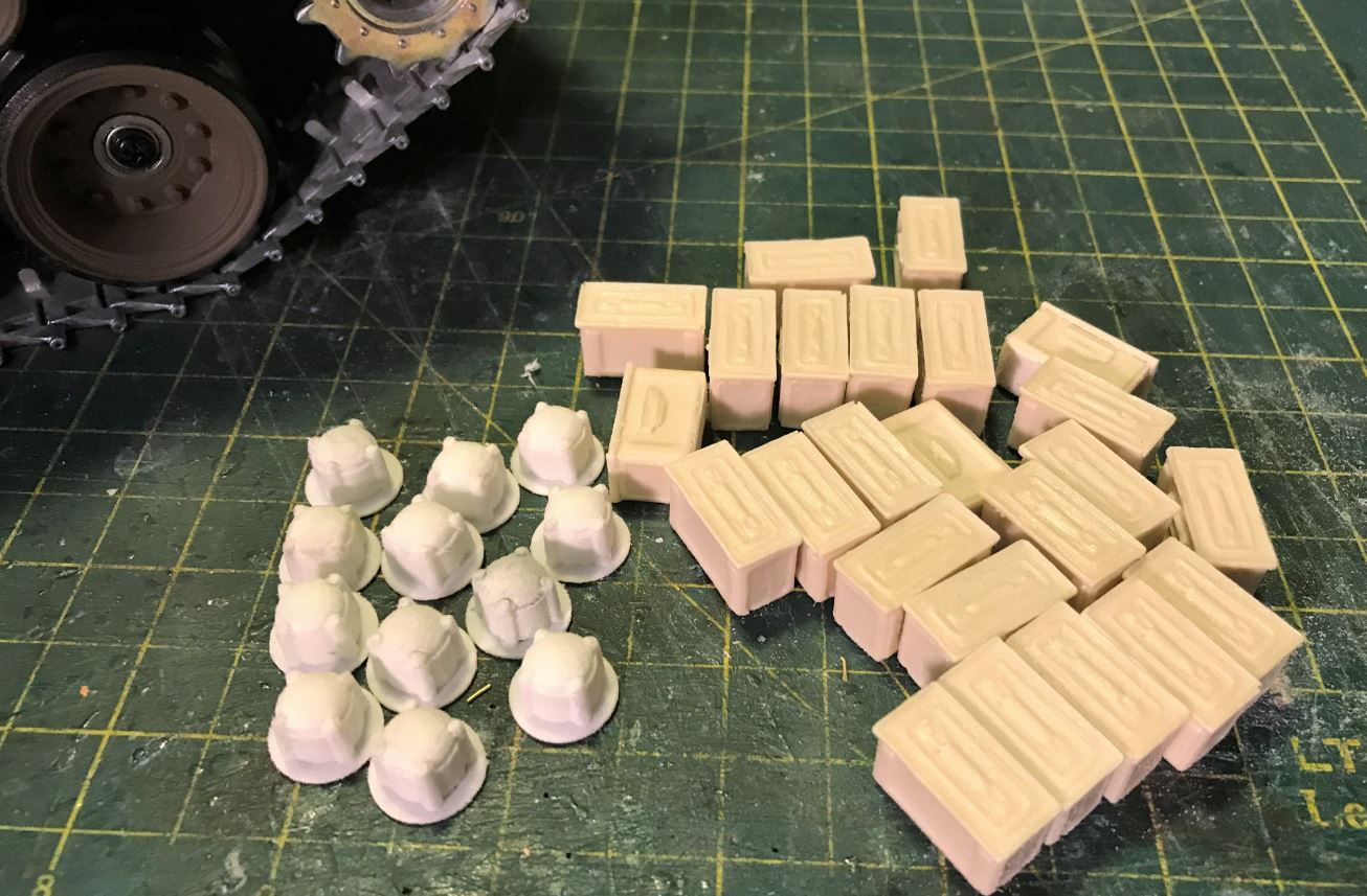

As shown in earlier post, ARVN crews loaded their tanks with a lot of M2 MG ammo boxes on the front glacis and around the turret. I purchased 24 ammo boxes from ebay seller Dioramaparts from Germany. Although these resin boxes are of a lower quality than Live Resin, they are much cheaper. As they are to pile up, all the fine details would have been lost anyway on more expensive brands. Not glued in place yet, they are shown here to represent their positions after painting.
Here I am testing the look and feel of a unmodified 1/18 figure on the M41. The Vietnamese people are much smaller than Caucasians. You really can't put an Asian head on top of a 1/16 scale 6 feet muscular body to represent an ARVN soldier. It just does not work, trust me. However, the body of smaller 21st Century (Ultimate Soldier) 1/18 Vietnam figures are a good base for major modifications into ARVN tank crew and infantry. You will not recognize the original figures once I am done with them, specially the infantry riders.
Next step is to go around the vehicle, do a final review and add any missing details. I noticed quite a few brackets that are required. After that, the painting and weathering phases will start.
