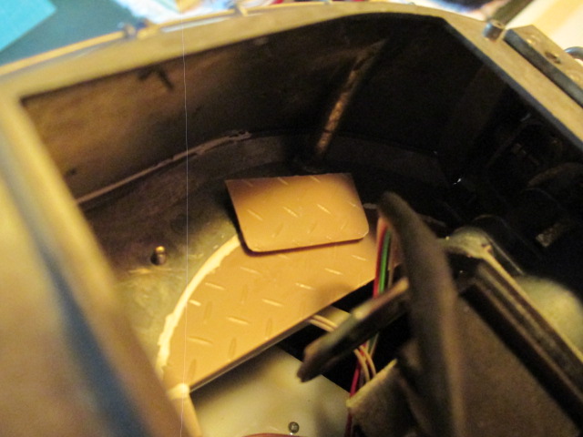

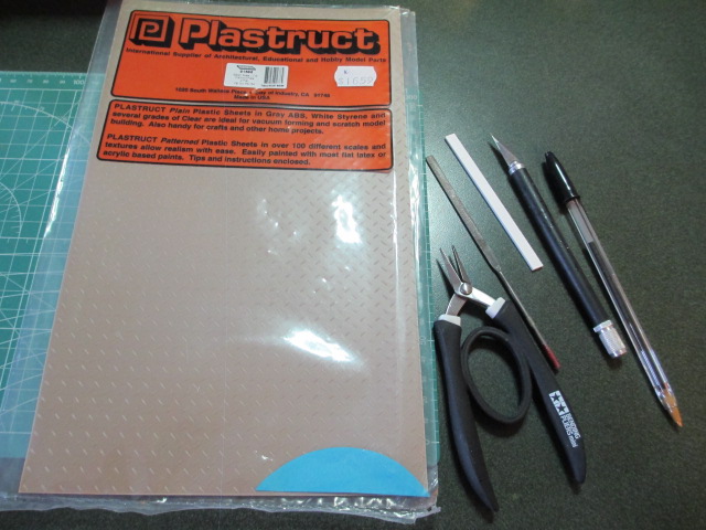

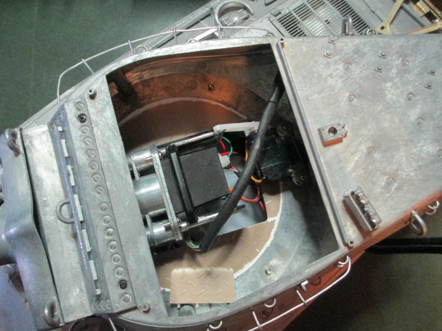

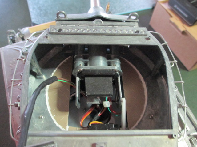

Quiet Sunday and aside from catching up to what the weather scuppered yesterday, I had an hour to myself to stand up and work on the M36B1. I wanted to continue inside the turret so I did a quick paper pattern and used an Exacto to cut out two large and one fitment piece of the Plastruct diamond plate. This stuff is great! A simple scoring cut with the Exacto and it breaks clean along the line. It is 1/16 scale already so not overly thick either. The pieces were a drop in and secured with the Loc-Tite Ultragel I favor using. After that, I did a weld bead along the edges using the tubed milliput I got from over there. More tomorrow. Pics:
Diamond treadplate installed and weld beaded.
Plastruct, tools and a paper pattern make something slightly dreaded into an hours worth of fun!

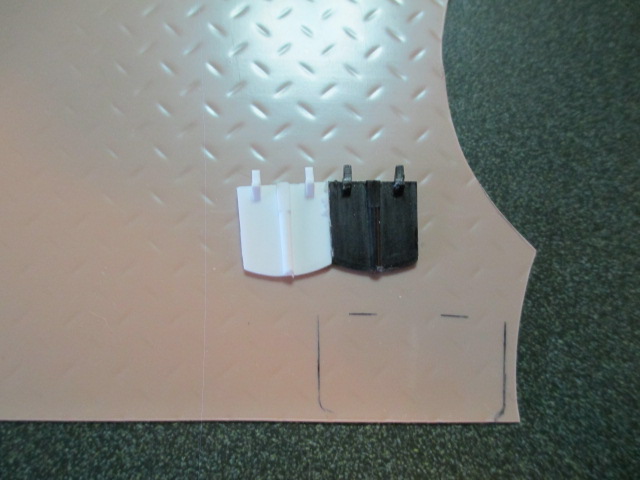

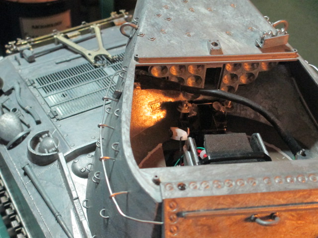

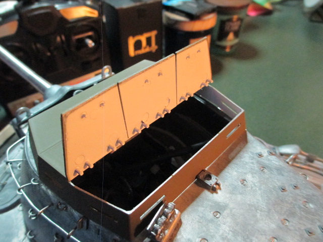

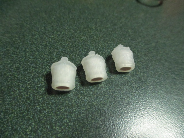

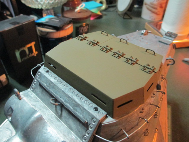

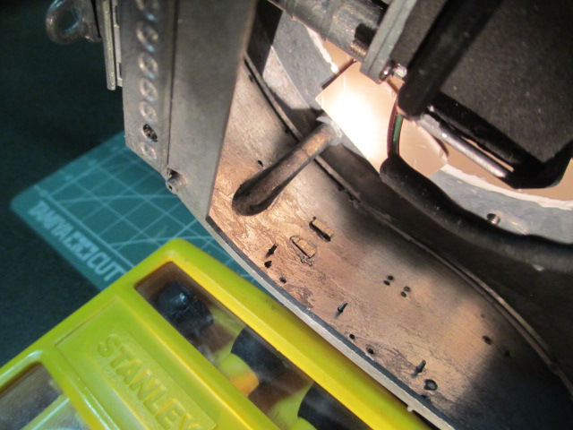

Carl, I think that you will be pleased with the diamond plate. It's much easier to work with than the brass type. Lots of rain tonight so a good time to go back to the M36B1. I'm still working on the turret interior and it will take some time. I'm waiting on pieces to arrive and will have to build up some mounts and equipment from scratch to even finish my truncated version of the interior. Tonight, I did a little painting just to start getting used to the idea of what will be required on this TD. Pics:
Interior of the armor casemate sprayed in M.M.s Flat White.  I took some liberty here as to the color of the interior.  Could have been bare steel for all the pics show.
Tamiya grey primer and a couple of coats of the excellent Model Masters Olive Drab
The canteen mount over by the binocular case location
The two canteen plate mounts over by the fire extinguisher location
Shapeways WWII US canteens filled with milliput and set aside to cure.
Another angle showing the short rise of the piece.
Another angle showing the short rise of the piece..JPG (97.39 KiB) Viewed 3368 times
Footplate completed
Footplate completed
My version of a base for the extra 'kick out' piece of diamond plate under the fire extinguisher.
My version of a base for the extra 'kick out' piece of diamond plate under the fire extinguisher..JPG (84.84 KiB) Viewed 3368 times

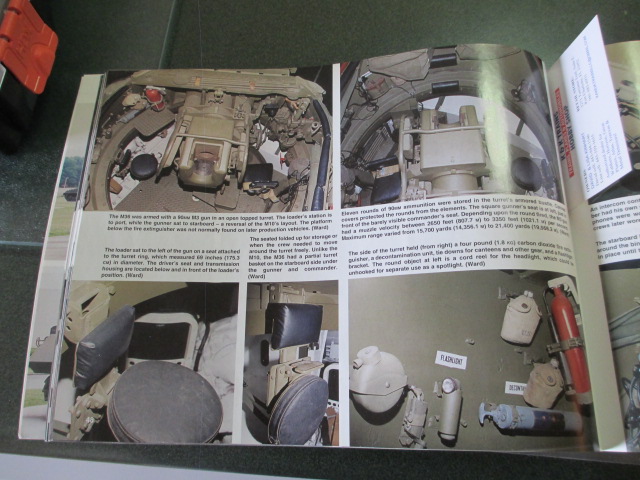

A page from the 'Walk Around' book giving a good view of some of the M36 type turret equipment and setup.

Carl, thank you, sir! Your own excellent work inspires me to be a better modeler. Herman, truer words were neer' spoken my Friend. It was cool to see the difference between the main gun in the M10 ( which I will have to do as well ) and the gun in the M36 type turret. Tom, you are the gold standard in this sort of thing. I have a spare turret for the M36 and considered trying to cut out the floor of one and make a short, partial basket of the type that the M36B1 used to add a little auth. but all the wires in the lower and the brittle metal that MATO used made me back away from it. I will do the turret wall equipment and mounts and see what can be done with the elevation servo.
