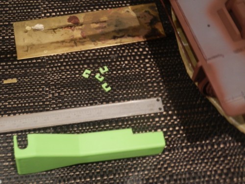

I got a little progress done on the tow cable front mounts, found a bit of plastic material on a floor sweeping machine the wife never uses........it has a close thickness & was very maleable under the knife. I figured as its never used it wont be missed.
I am yet to trim them and fit the brass caps, but they will have the right effect. Im buggered on those bloody wing nuts though !
They are just to small for me to get right.
I have a plan for the track towing cables though, to cut the kit cables from the mounts, and dress them, I have picture hanging wire that will work a treat. I plan to place the mounts, thread the cable through once painted grey and then use some 1mm I.D. aluminium tube as the crimp section behind the eye. Ive done a dry run on the crimp and its spot on.

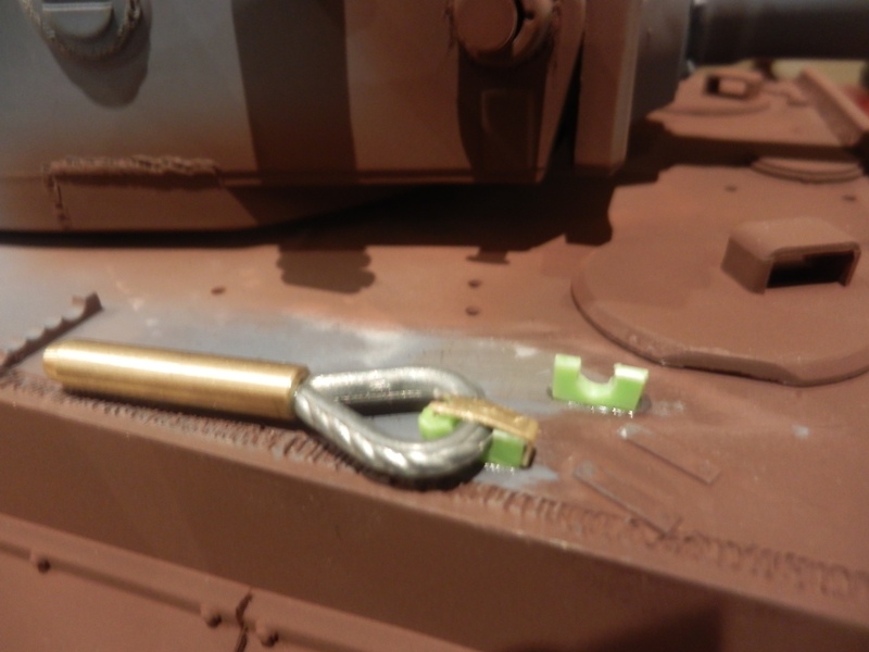

Give ya the news, Im not sure whats harder.............making them, or taking the damn pictures
Made the brass strip 'keepers' for the top of the tow eye mounts, and used a paperclip heated & melted through the wing nut end via a slot carefully filed into the end of the keeper.
Im happey enough with the overall effect, but the nuts ...................

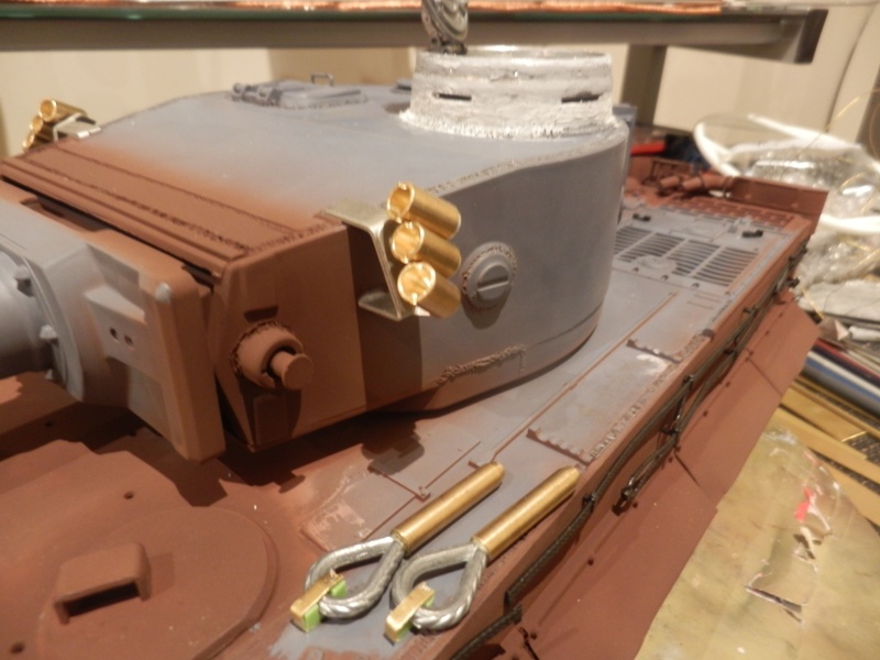

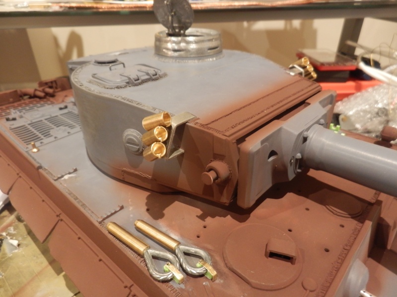

Cemented and coated the metal cupola to cover the joint. Was careful to align the hatch angle correctly with the vision slot facing forward and the hatch cover at the '8 oclock position.
Got the last of the tow eye mount bracket tops on and now am deciding on wingnut manufacture !!

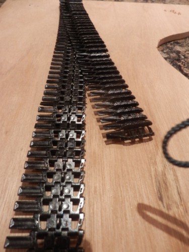

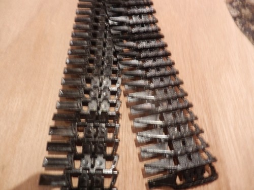

The good stuff from Canada. They cost me (
)but I reckon well worth the investment. Winterketten . 2 sets. Project 3 and 4 are simmering
