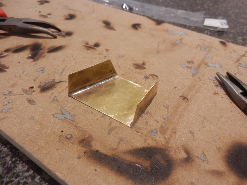

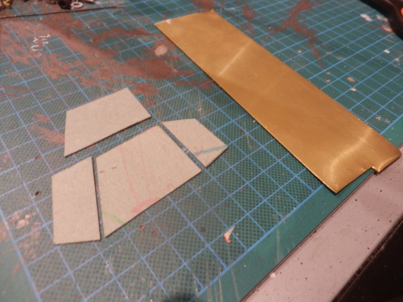

For no good reason, I decided to make a stowage box..............out of brass, because
Made up cardboard templates, and traced them on brass sheet.
Using a good pair of scissors, cut the shapes out to suit & trimmed/ground where necessary.

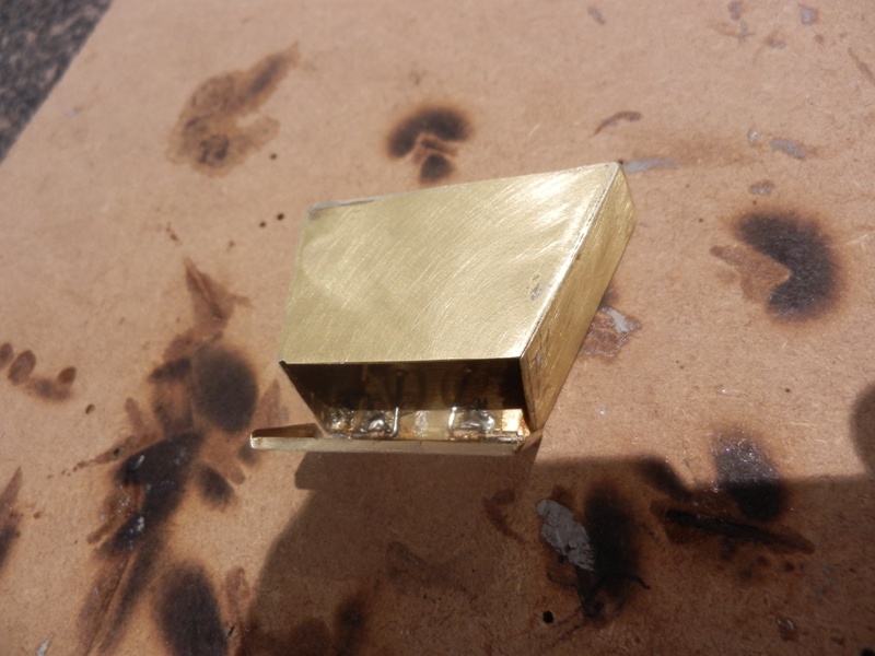

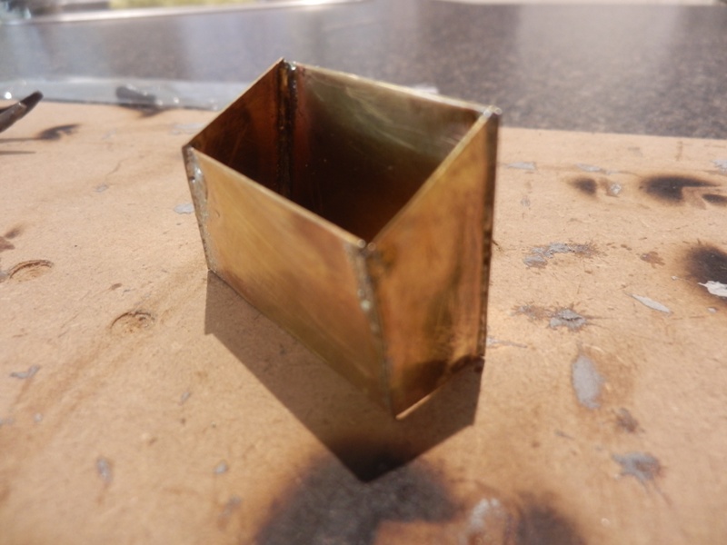

Got out the indispensable solder paste & set to it.
Finished with a file & sand paper.
Used small brass tube & dress making pins to hinge the lid, and Bob's ya trans-gender Aunty

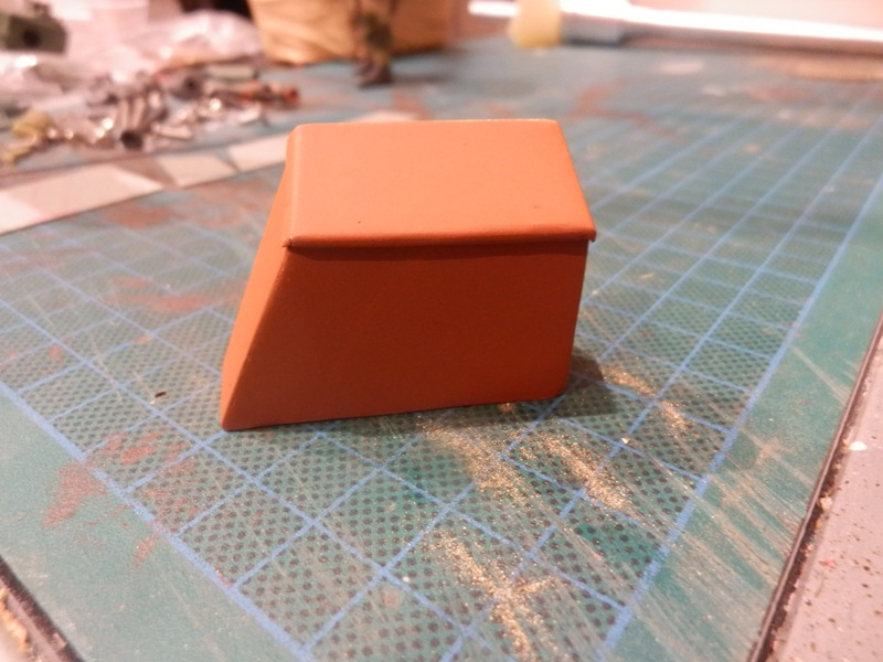

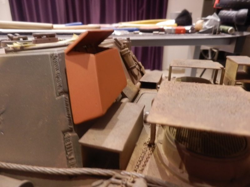

Hmm, now its primed, still need to get the green on it, as this happens to be the colour patch in that spot where it will mount.
So more minor weathering and dusting in to do.
Have no idea why I hinged the lid as I have nothing to put in it
