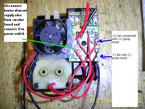

tanker I am stumped. The only real explaination would be the smoker port is fired on your Panzer IV RX-18. I suppose you can swap the RX-18s from your KV-1 to the Panzer IV and see if that works but that doesn't make much sense either really. The only other difference would be the batteries between your KV-1 and Panzer IV.

hi michaelc switched the rx 18s over & it worked so it seems like the smoker port on pzr1v rx18 board is fried , didnt know that could happen & leave everything ealse working , thanks,ps batteries on bouth tanks are the same .tanker 242 ,your a clever guy .

Glad can be of help and actually have a reasonable explanation. It could have been fried during all the fussing around with the fan etc. I never asked the smoke master whether there is any chance of overloading the smoker circuit with the fan and the additional demand on the pump motor from the added workload.I know that there is resistors for the motor but don't know if you need a set for the fan too. I have been tapping directly form the RX-18 but maybe we should tap from the resistors before the pump motor ?

good idear to ask strmnd54 wonder what he will advise ? allthough my kv1 produces smoke like the one on his first post now . so got to send order in for new rx18 now .tanker242.

What creates an overload capable of frying the transistor driving the smoke unit on the RX-18, is the heater element...
On my tanks, I always disconnect the power to the heater from the smoke unit board; and connect it to the power switch...
When I turn the switch "ON" , I wait 1 minute to let the smoke build-up in the unit before starting the tank. This way, I get a big puff of smoke when the pump&fan start ... :) :)

:wave: ki guys got my new rx 18 fitted in pzr1v & smoker is now working ok as is the fan ,am now just waiting for late road wheels for tiger 1 to arrive :thumbup:
