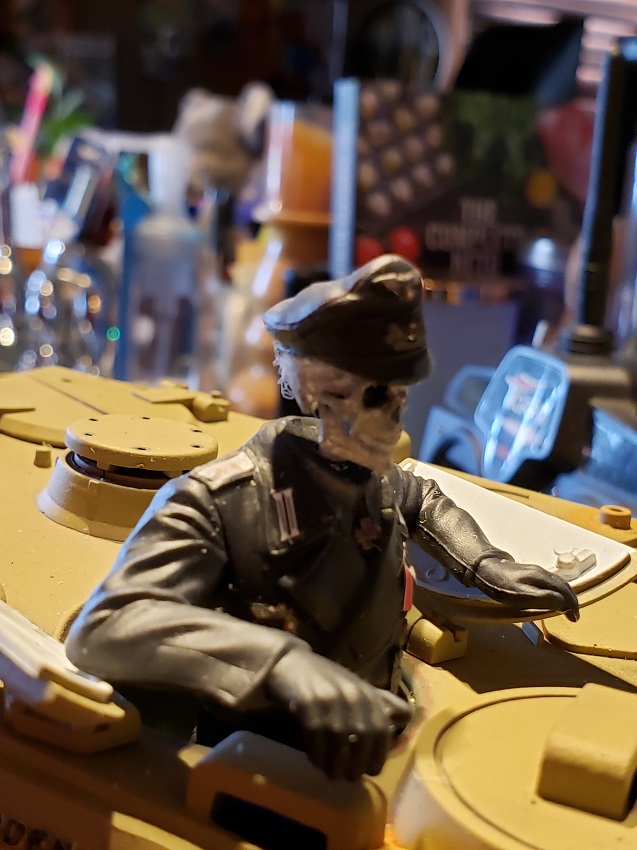

Good Morning,
Erik Von Norden Approves!
Hard to get a clear shot of this guy ...almost like he is not all there.jpg (156.07 KiB) Viewed 781 times
