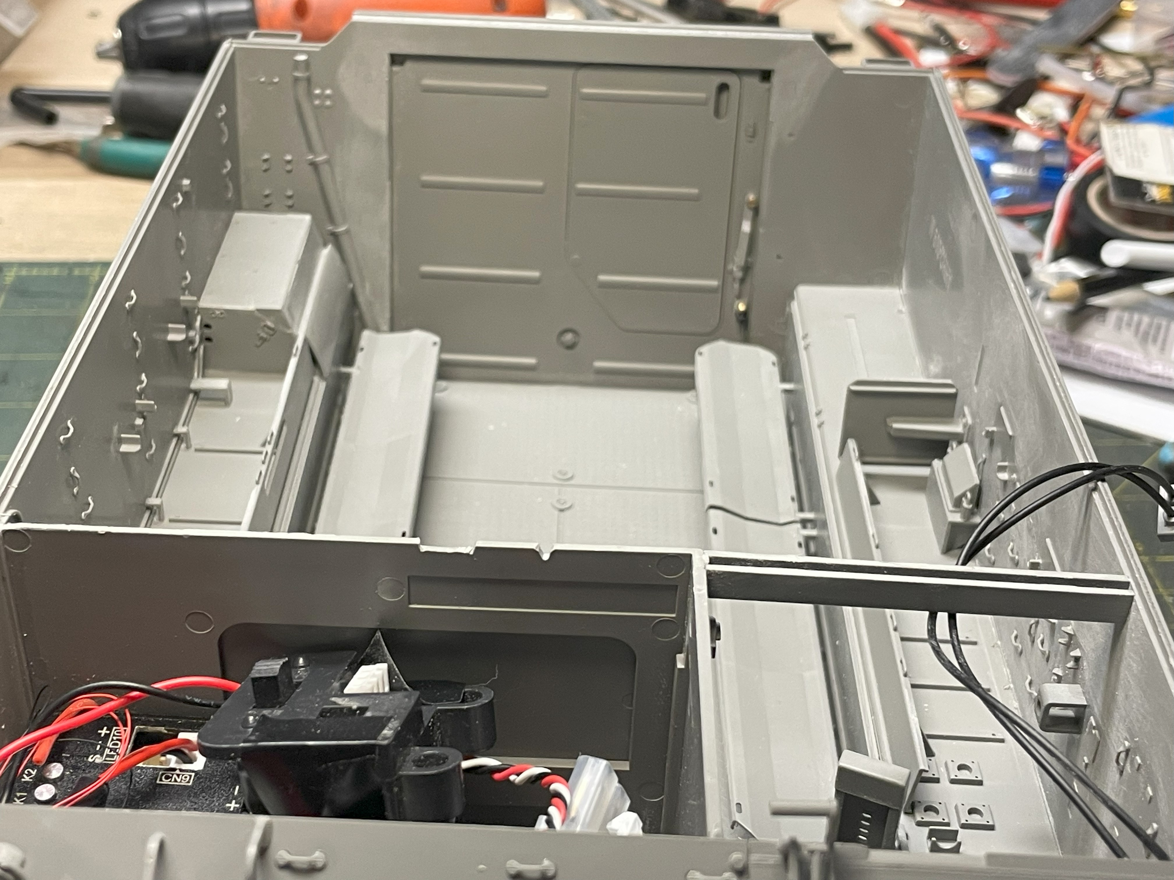

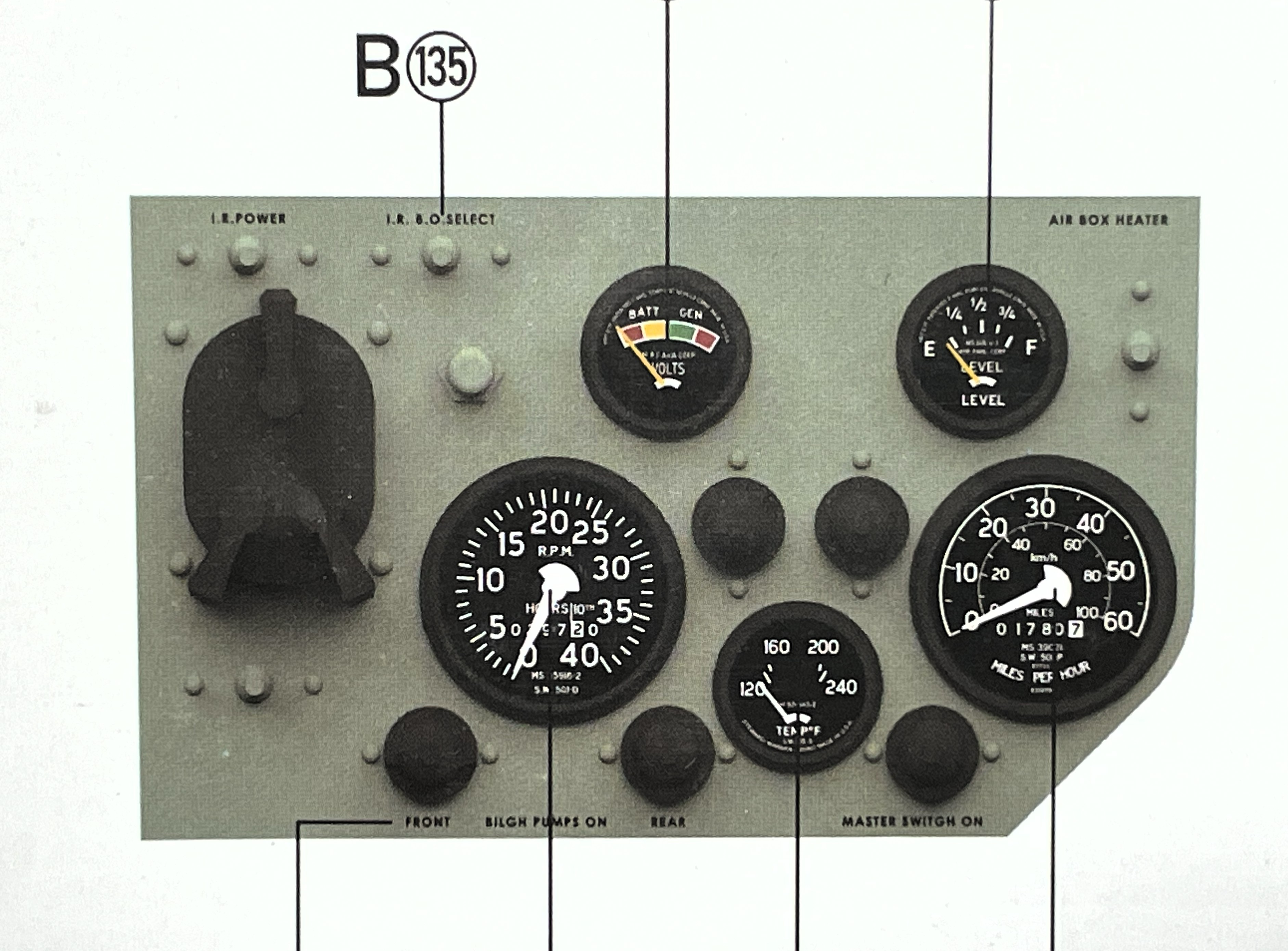

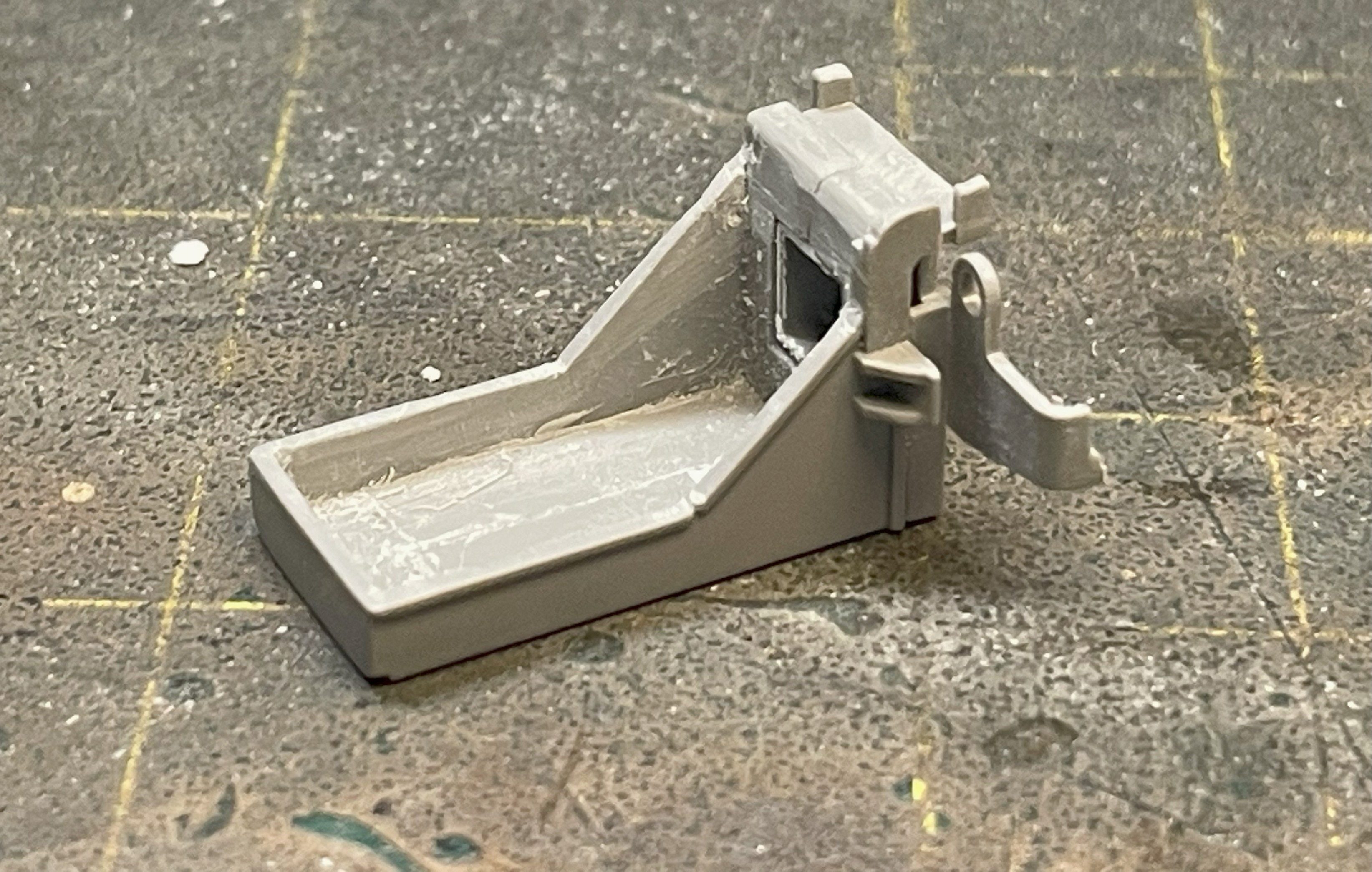

The instrument panel attached to the roof should also only be installed after painting and decals are put on.

The inside of the model is left mostly empty in preparation for painting. Shelf, seats and everything that cannot be easily painted with Interior green must be left out at this time. Otherwise, it will be very difficult to paint under the shelfs, seats and to put on the micro decals.

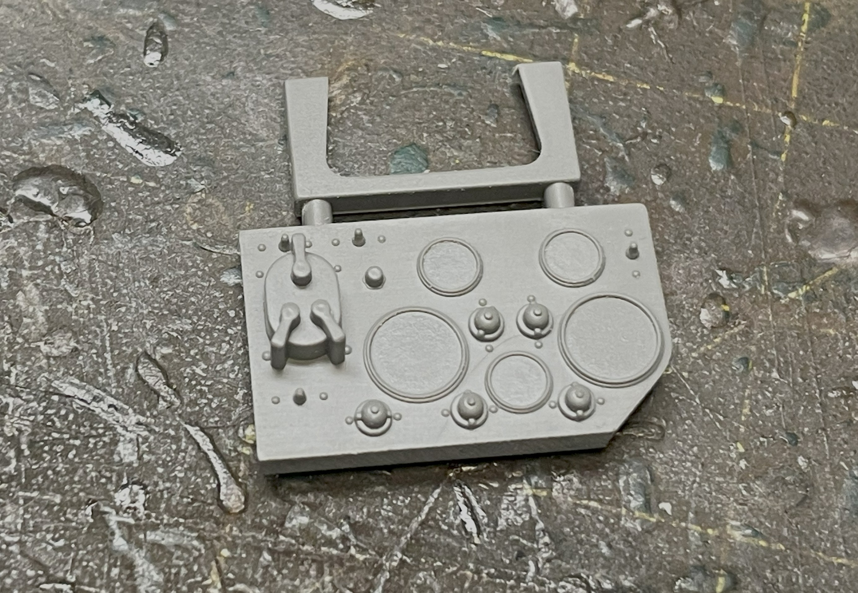

Even the driver's right wall has a lot of stuff going on. It is better to leave the driver's seat out of the picture until the end. There is no rush to install these.

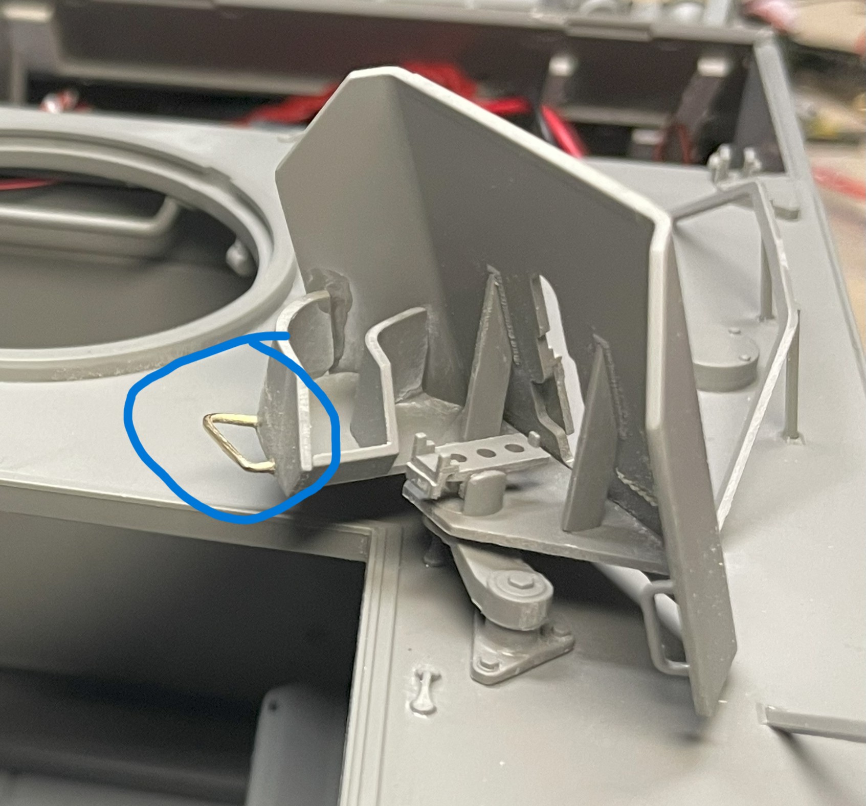

I replaced the plastic handle by brass wire on the M-60 mount. They break too easily.

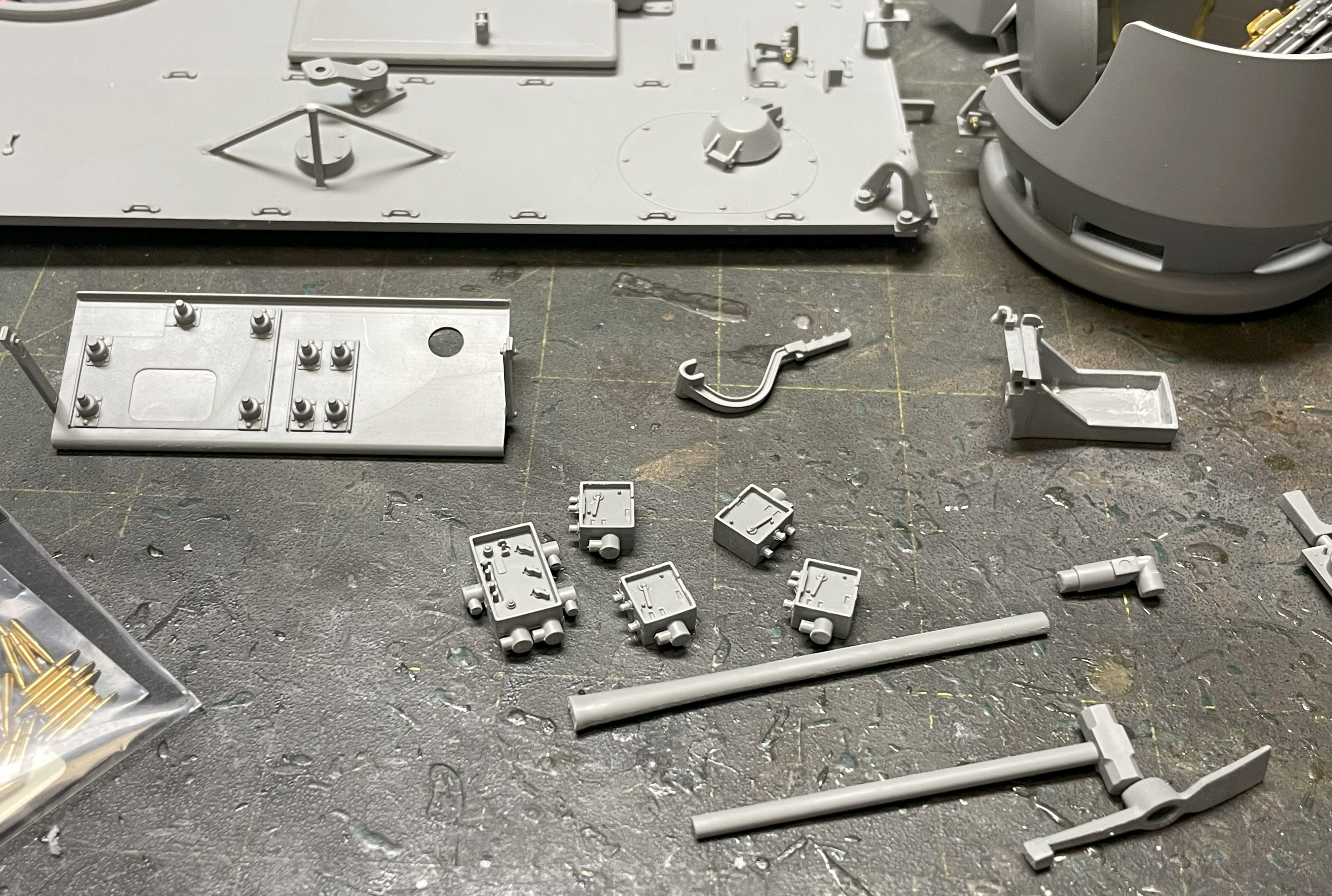

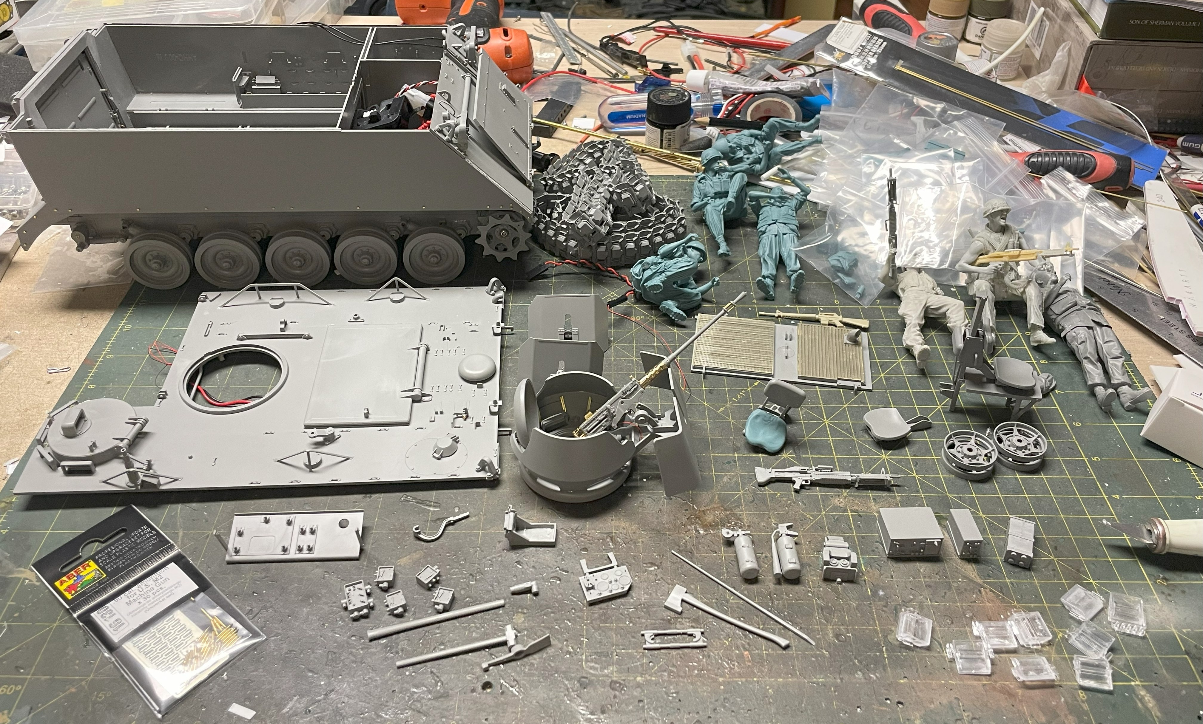

This is all the stuff kept separate in preparation for painting.
1/16 RC M-113A1 ACAV - Converting the Takom/Andy's HHQ  kit to RC

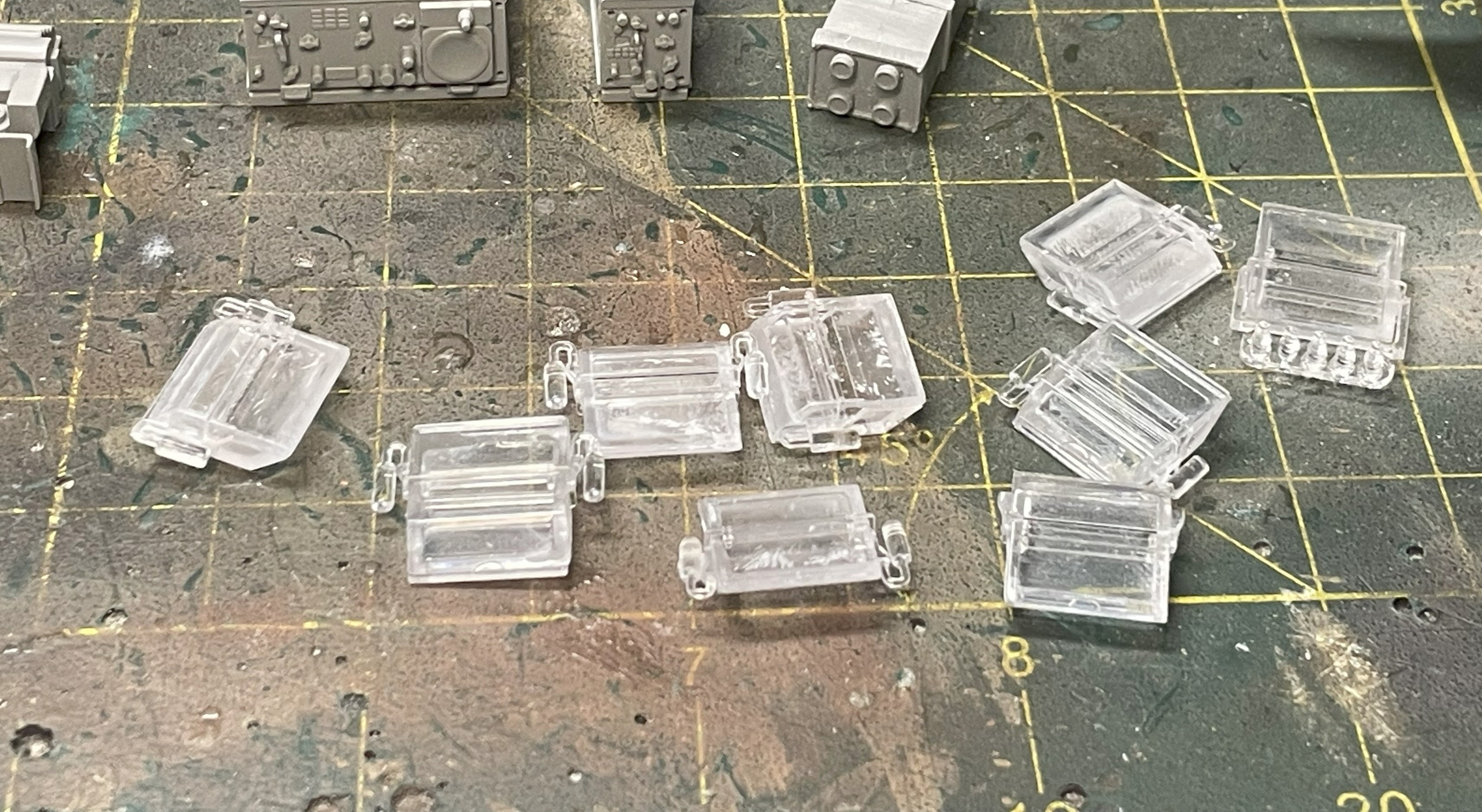

Shelf, tools, comm boxes, etc

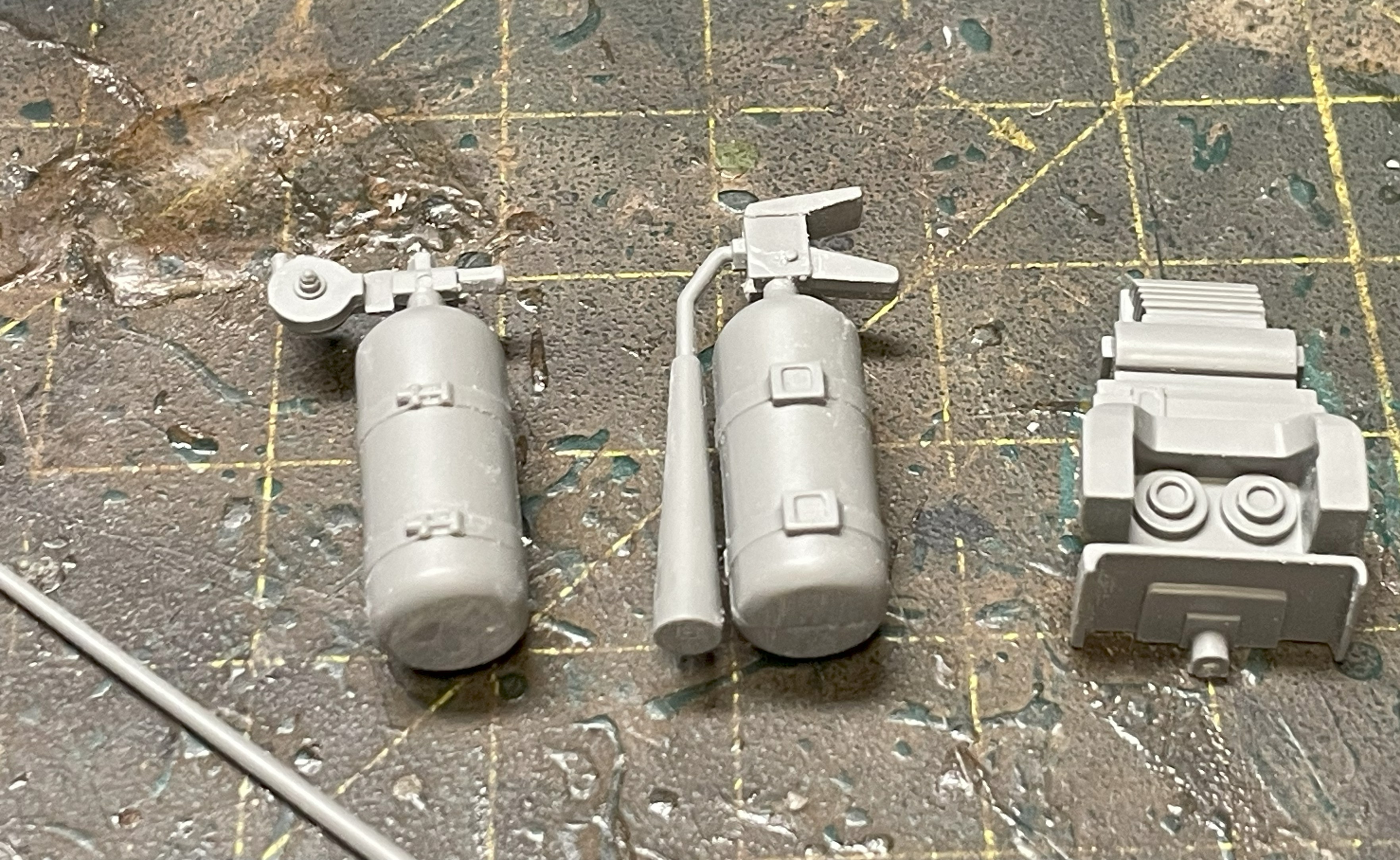

Extinguishers, infra red sight.

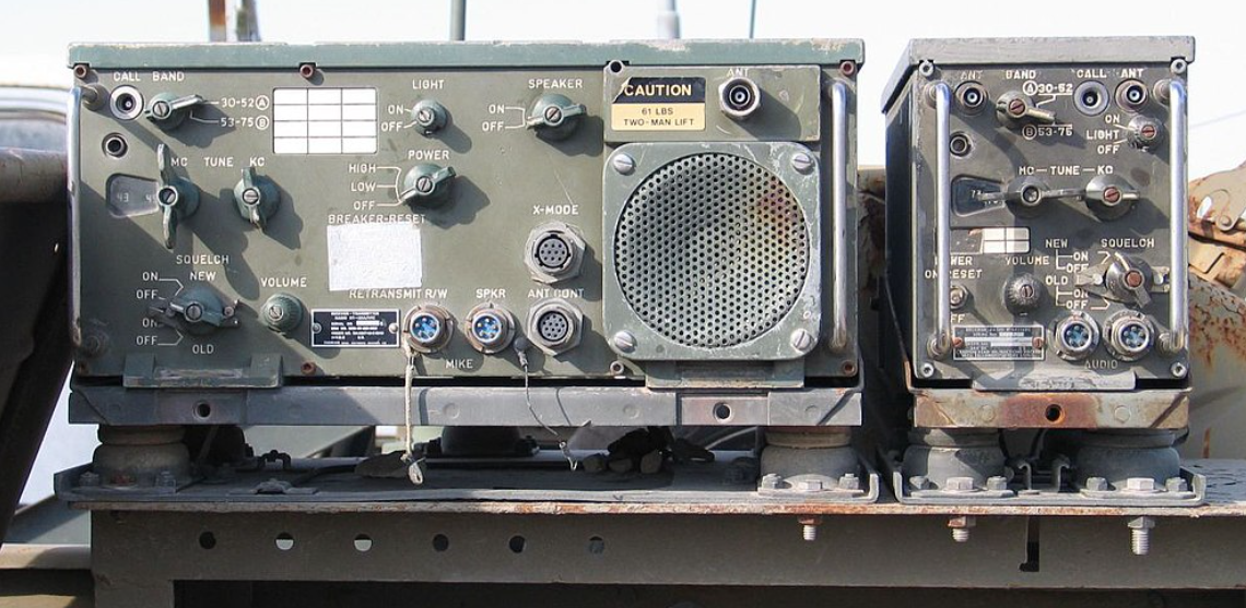

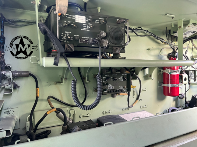

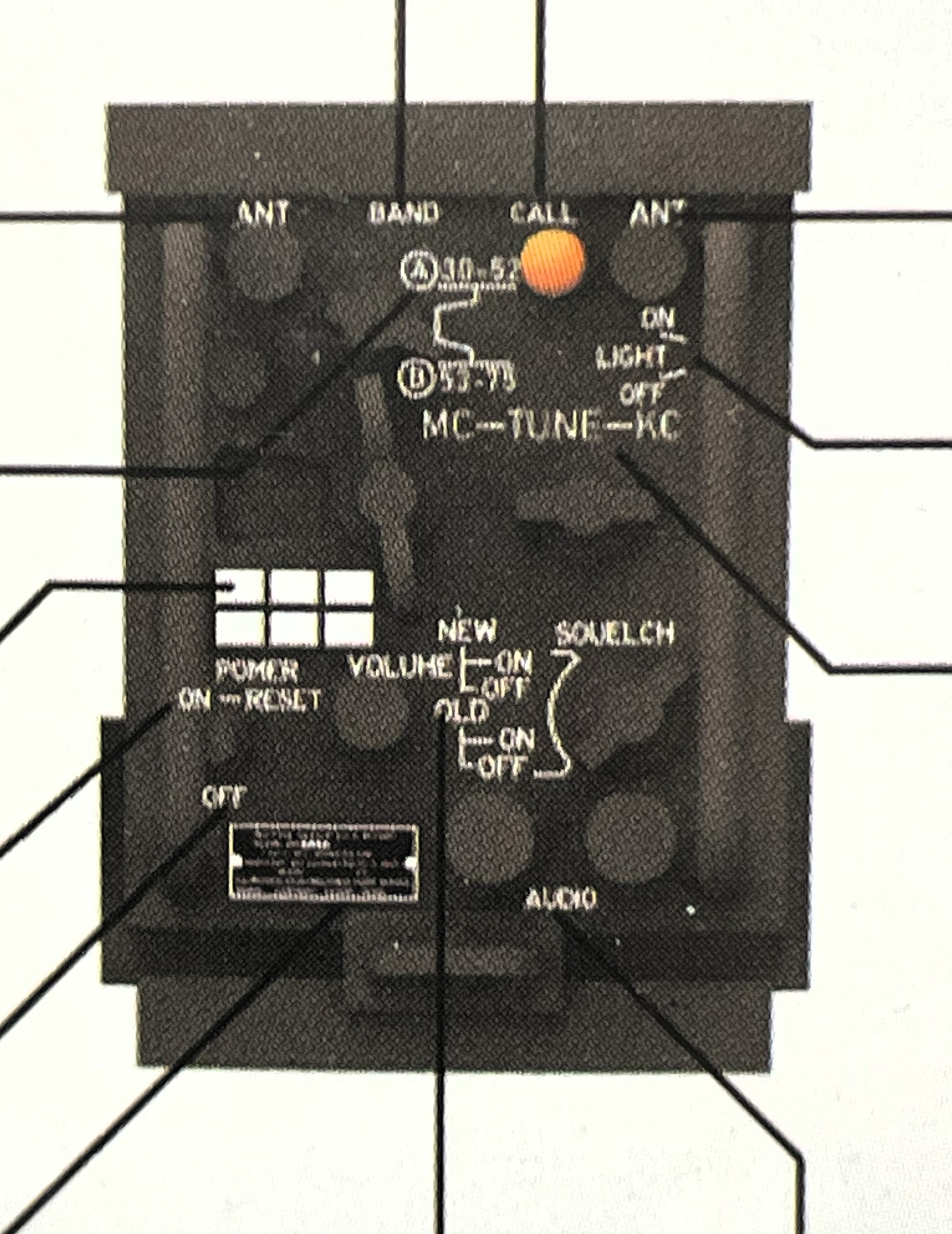

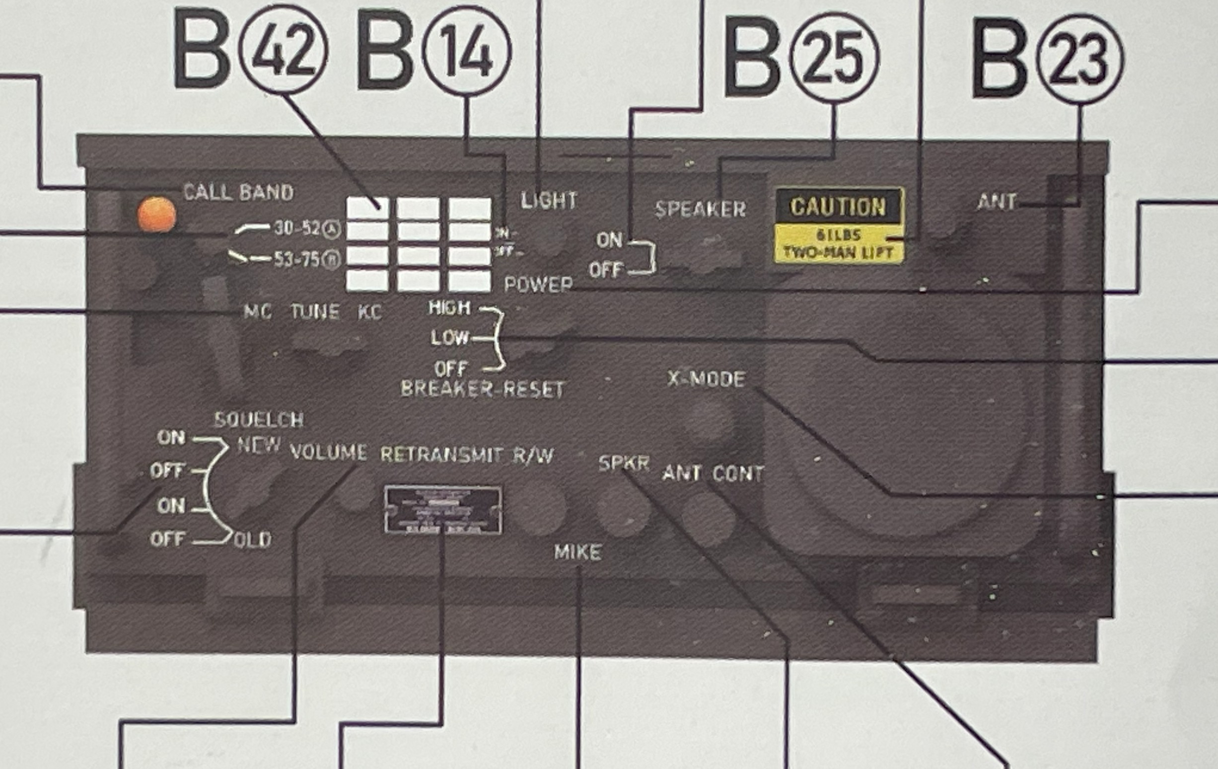

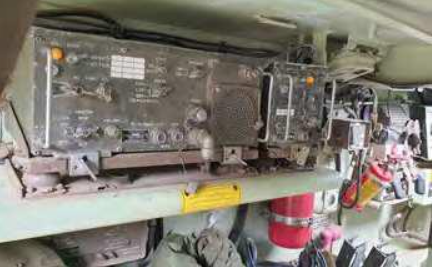

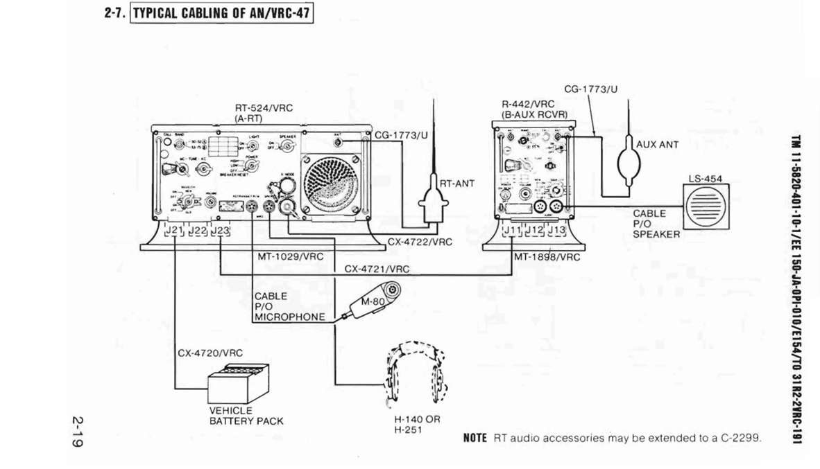

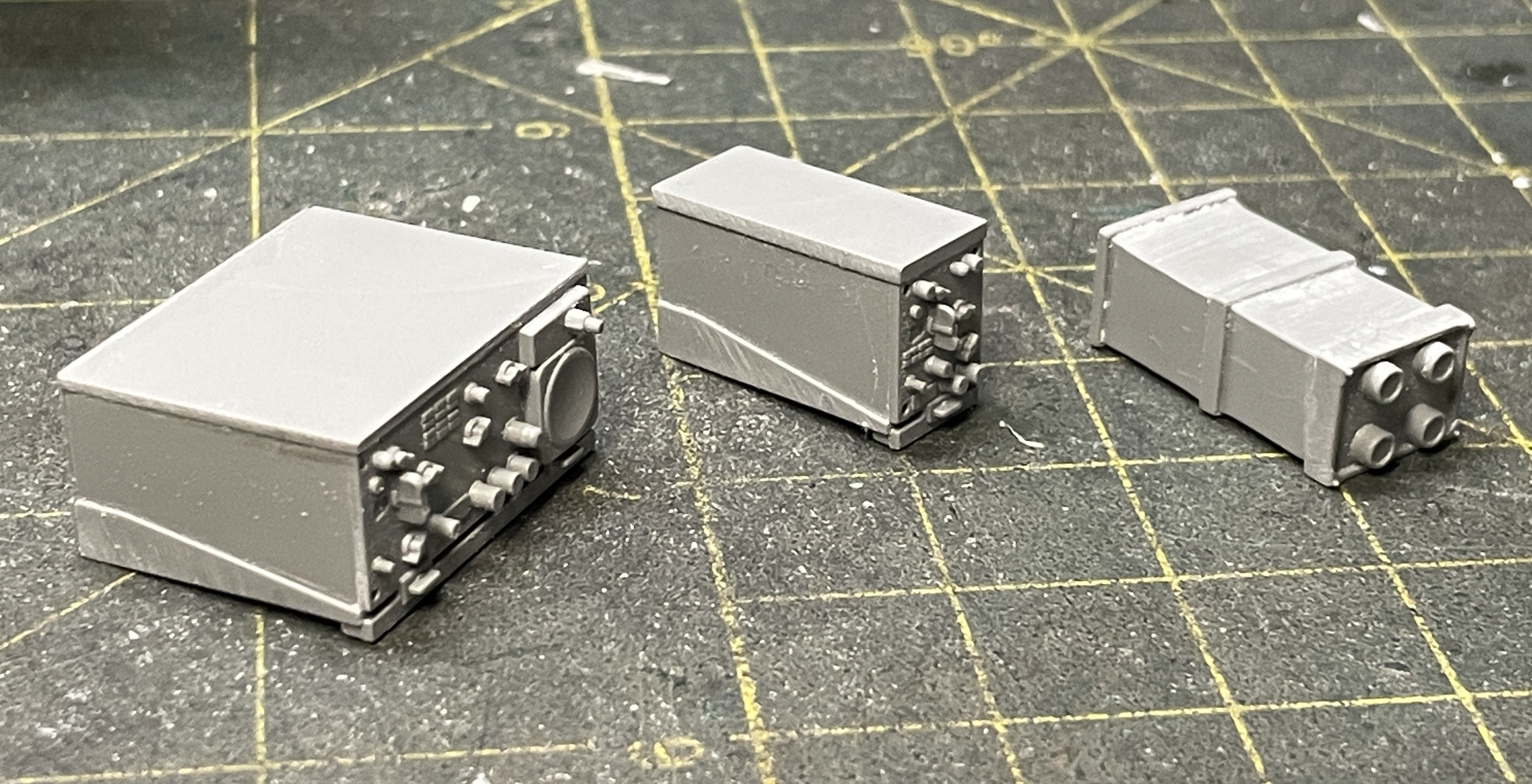

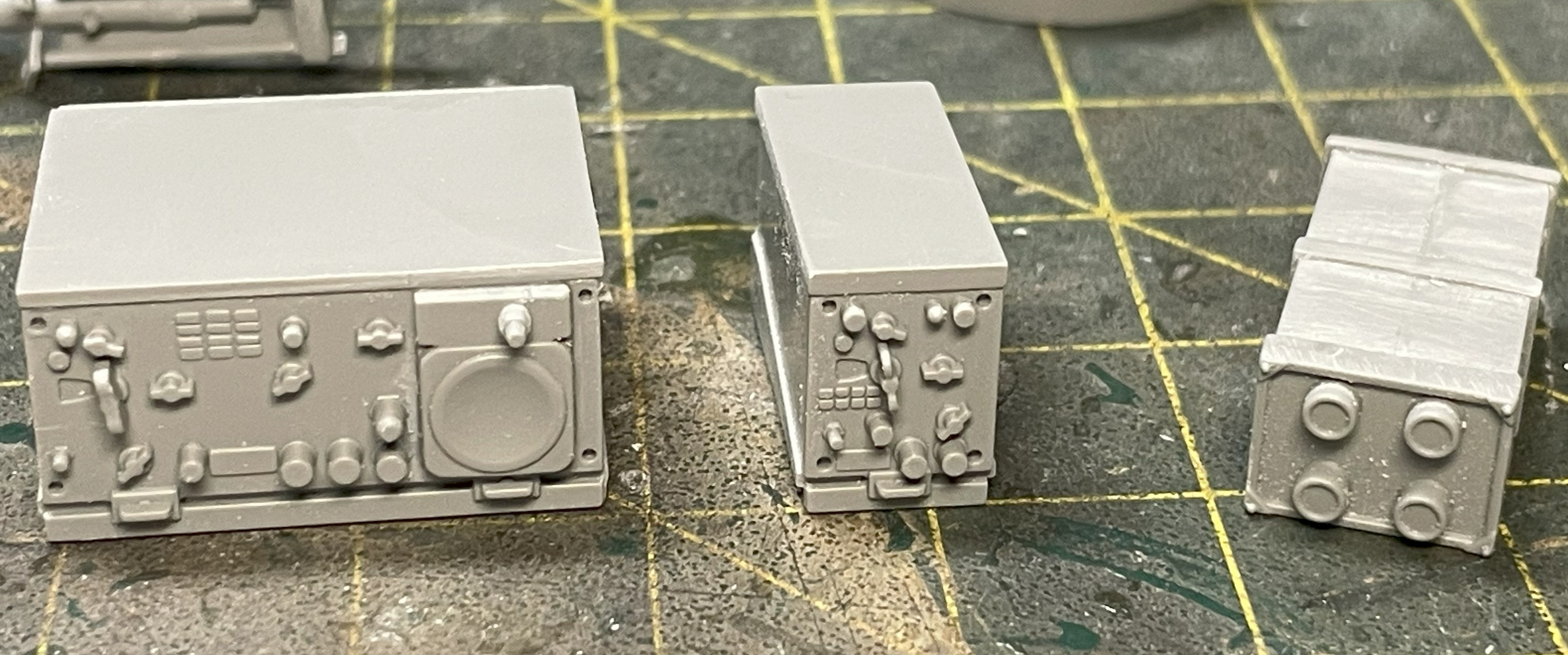

This is an AN/VRC 47 radio consisting of RT-524 receiver-transmitter (left) and R-442 receiver (middle). The box on the left was included in the interior part sprue but there are no mention of it in the instructions, and i have not found any information as to what it could be. It does not seems to be part of the radio. If someone knows what it is, please let us know.
I have not installed the side handles yet as they might be in the way of installing the decals, and are in a different color.

Looks like the radio should be green with silver handles, from wear or otherwise.
Creating the radio will require some study, proper tools and mental preparation.

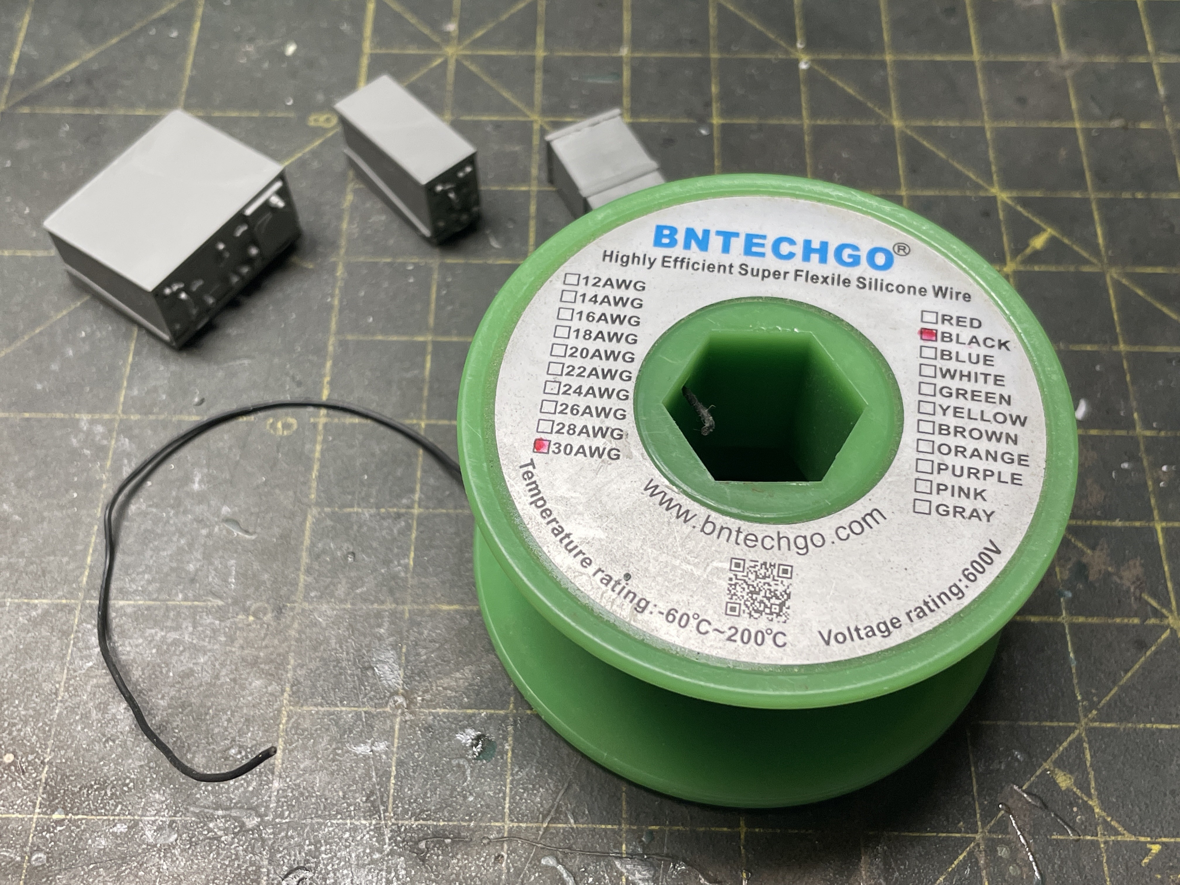

I am glad i have removed all the molded on wires. Painting these would have been difficult and not sure it would have looked good.
This is what i will be using to recreate all the internal wires. I have another set with a smaller caliber. As these are already black and will be installed after painting, i will not need to paint most wires.

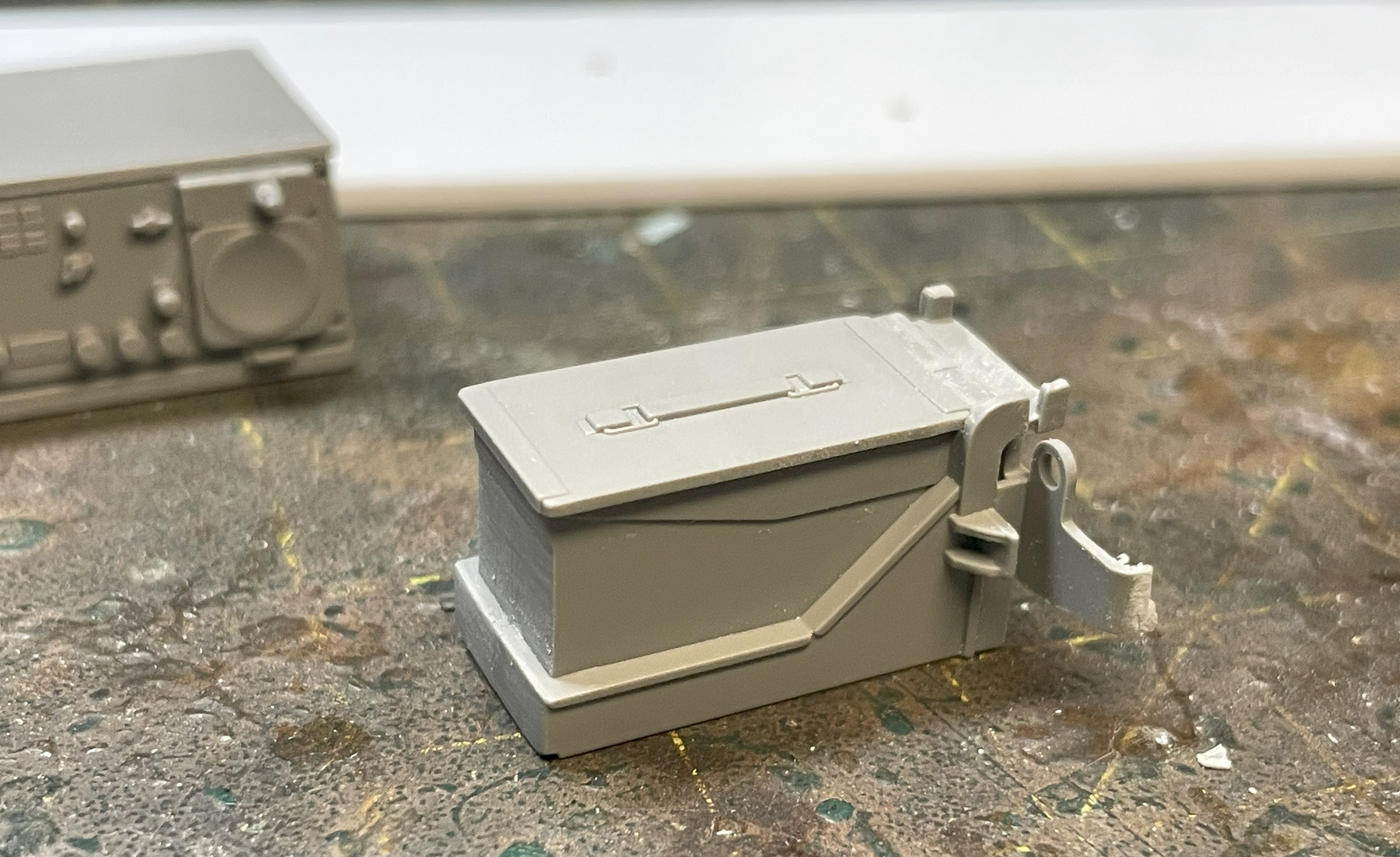

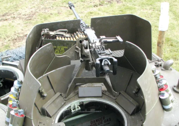

This is how the M2 ammo box should look like when ready to fire. The Jason Studio provides an open ammo box with links.
This is a big weakness of the Takom model. They have provided a closed ammo box, and molded with the mount. This is absolutely disappointing for a model issued in 2024. It would have been molded separately.
We have to carve the ammo box out of the mount...
Until i have the Jason ammo box in my hand and can see how to integrate it with the mount, i will wait to do any more carving.

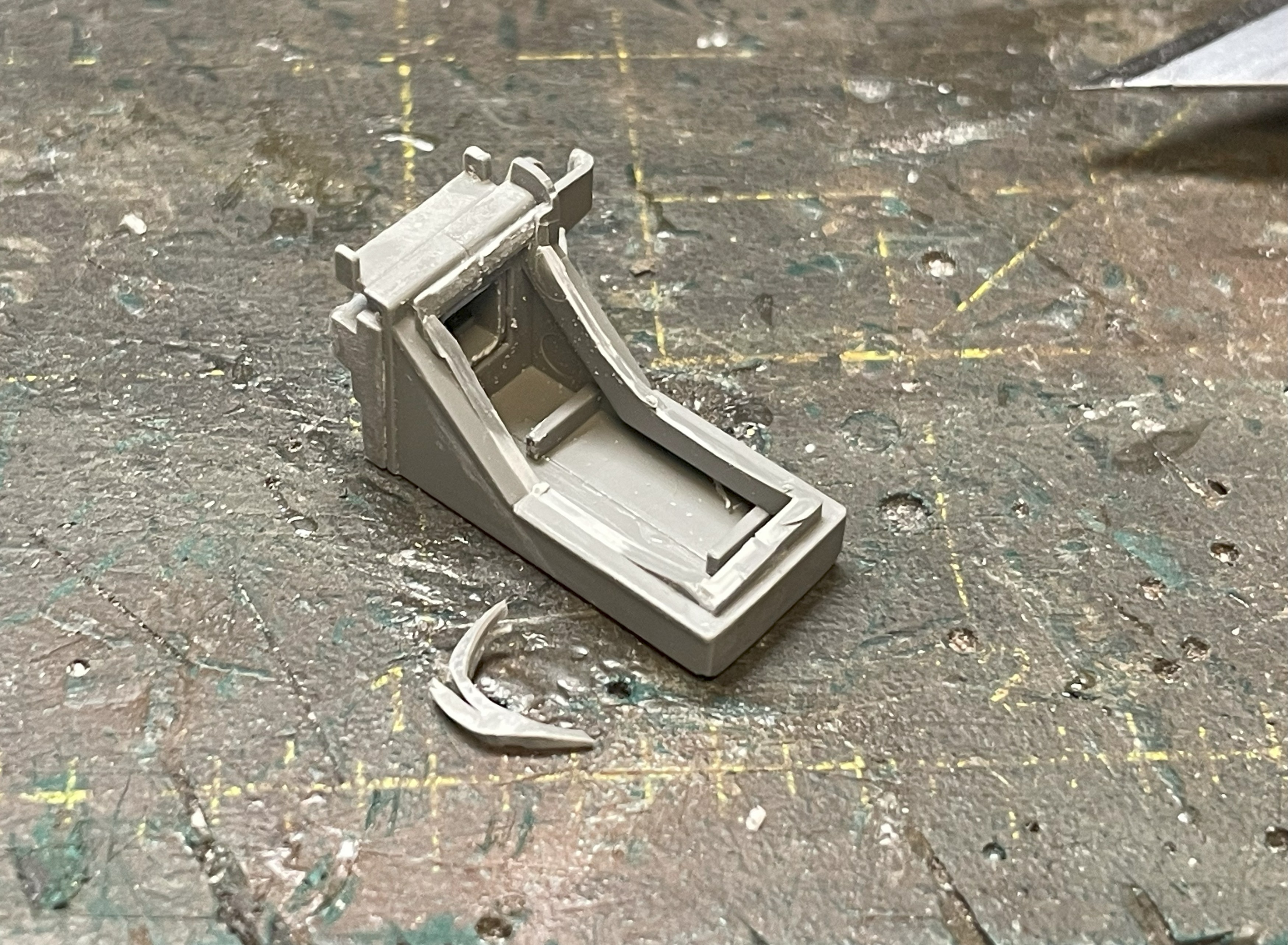

The Takom periscope came in two parts. I would have preferred that they were molded in a single part. The glue created issues on the visors.

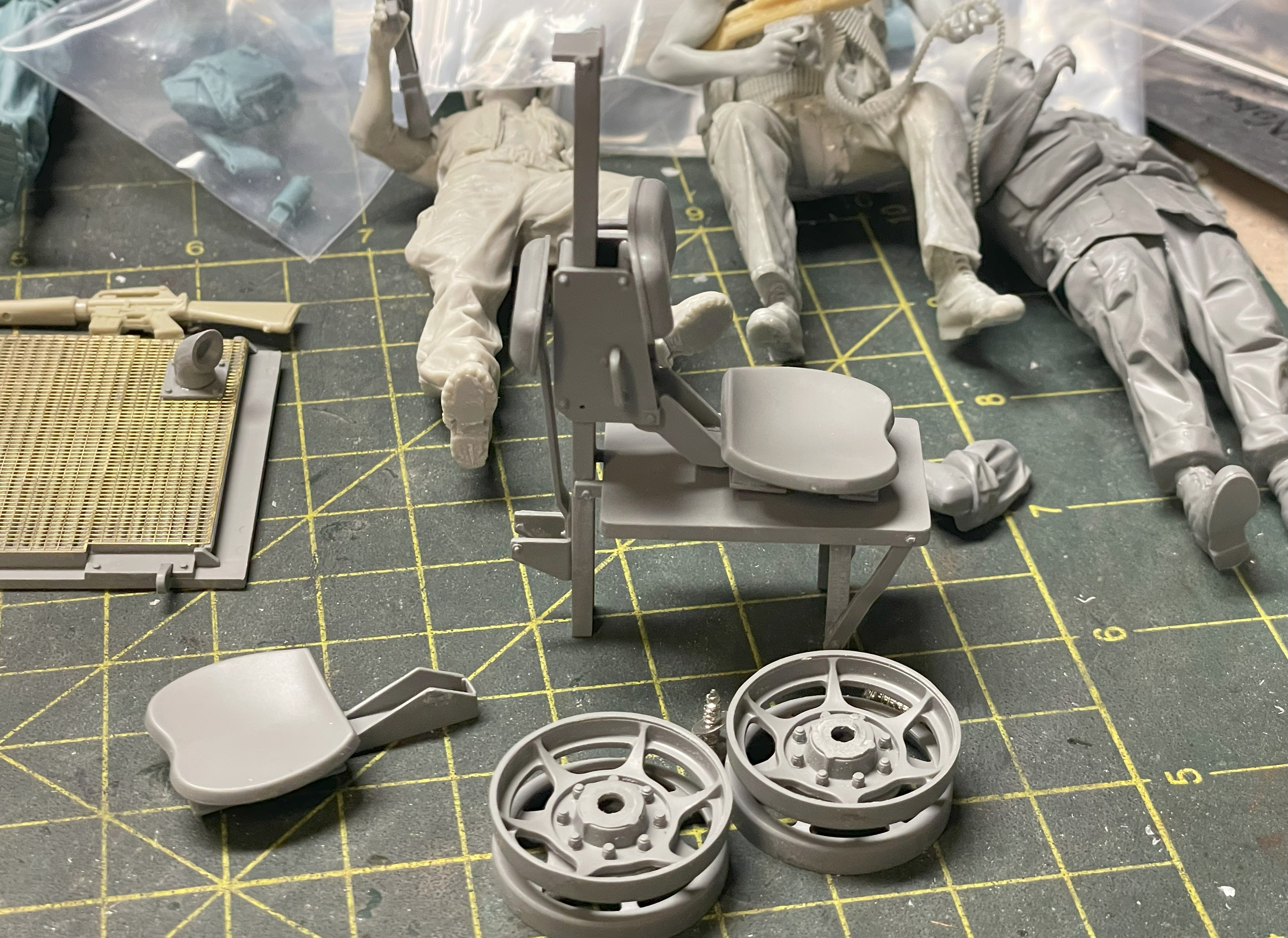

The central seat module will eventually only be glued to the floor, after painting.

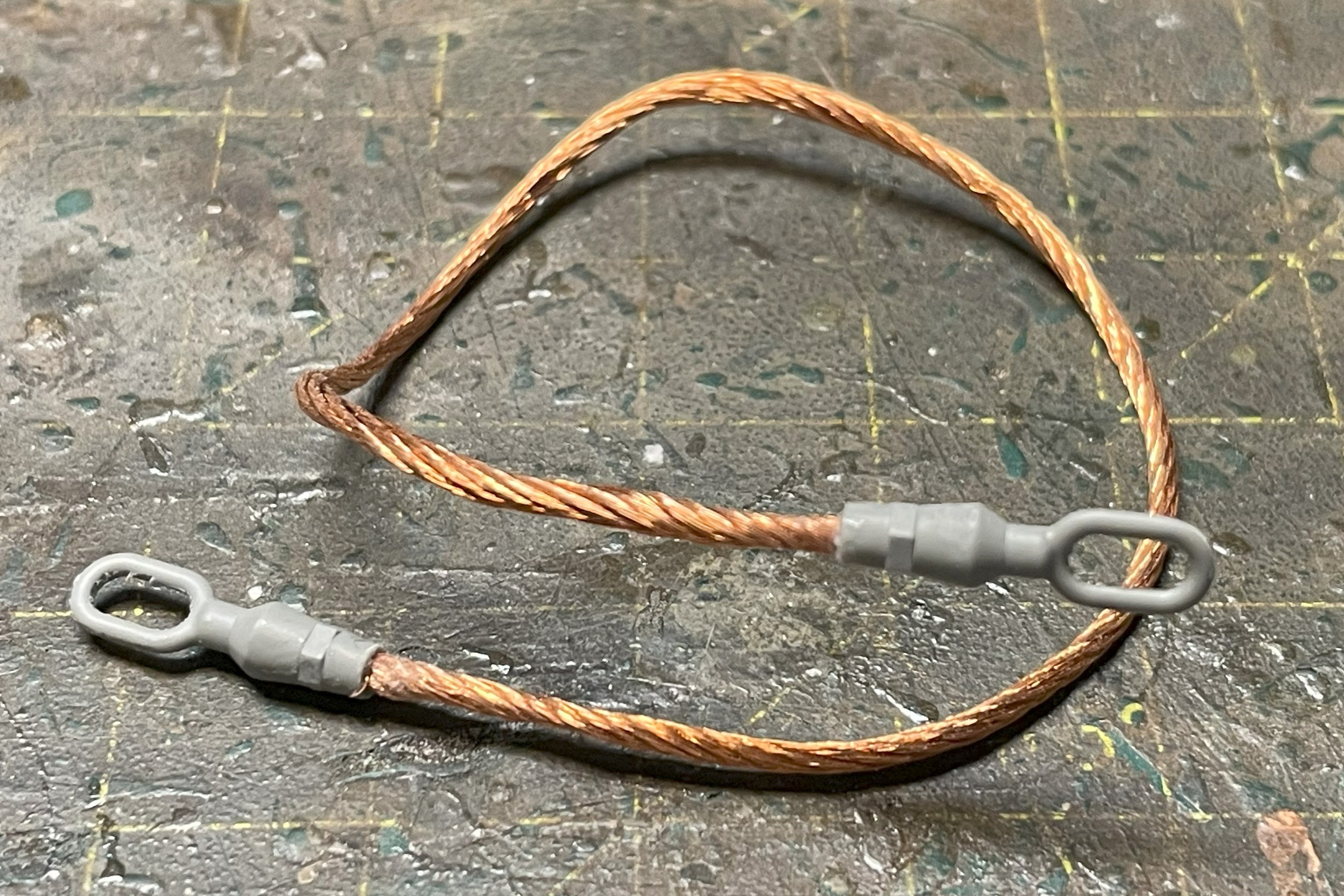

The tow cable.

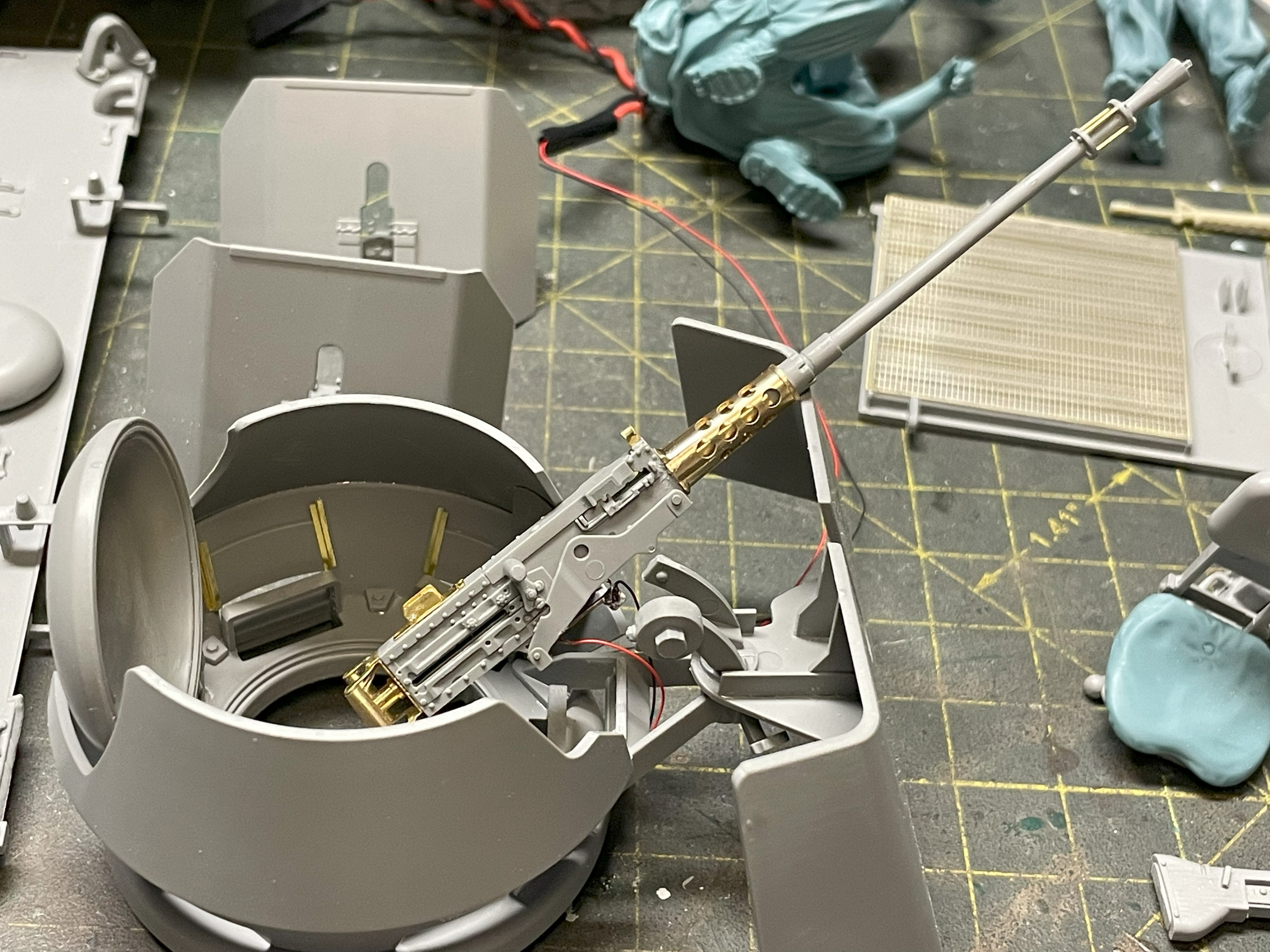

The Browning M2 can be separated from the mount, which will make painting easier.

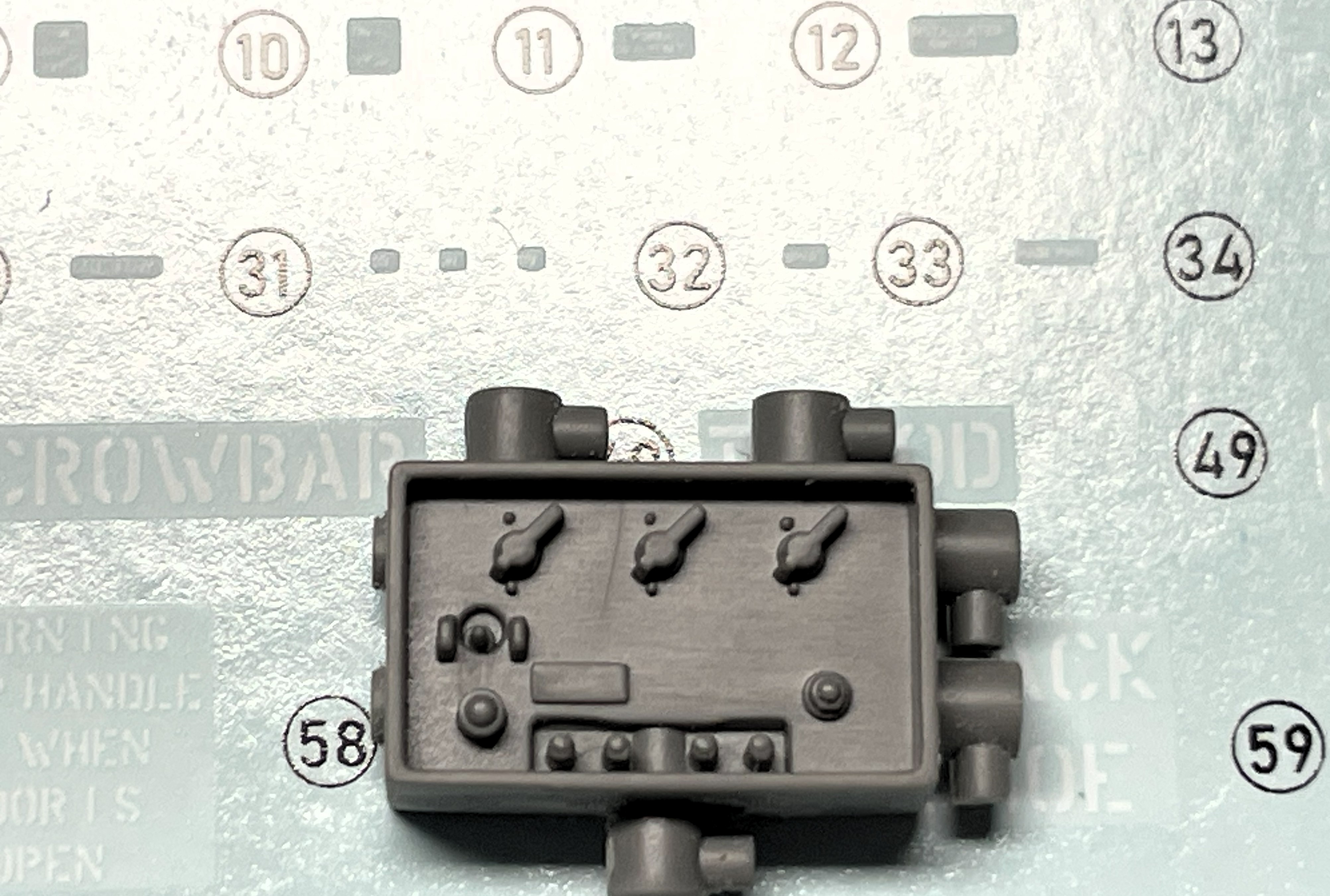

This is the dreaded decal sheet for all the accessories, interior and other areas.

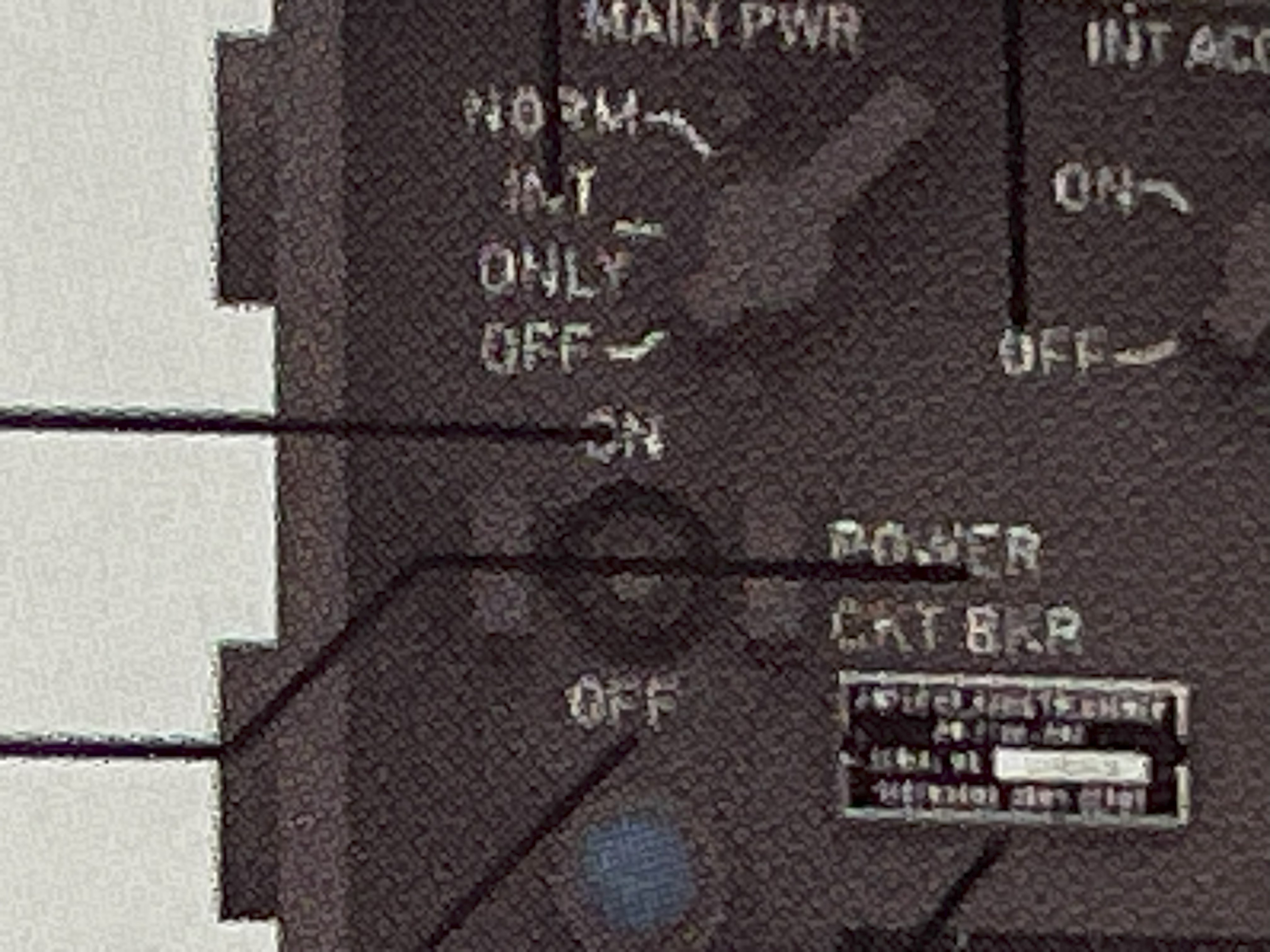

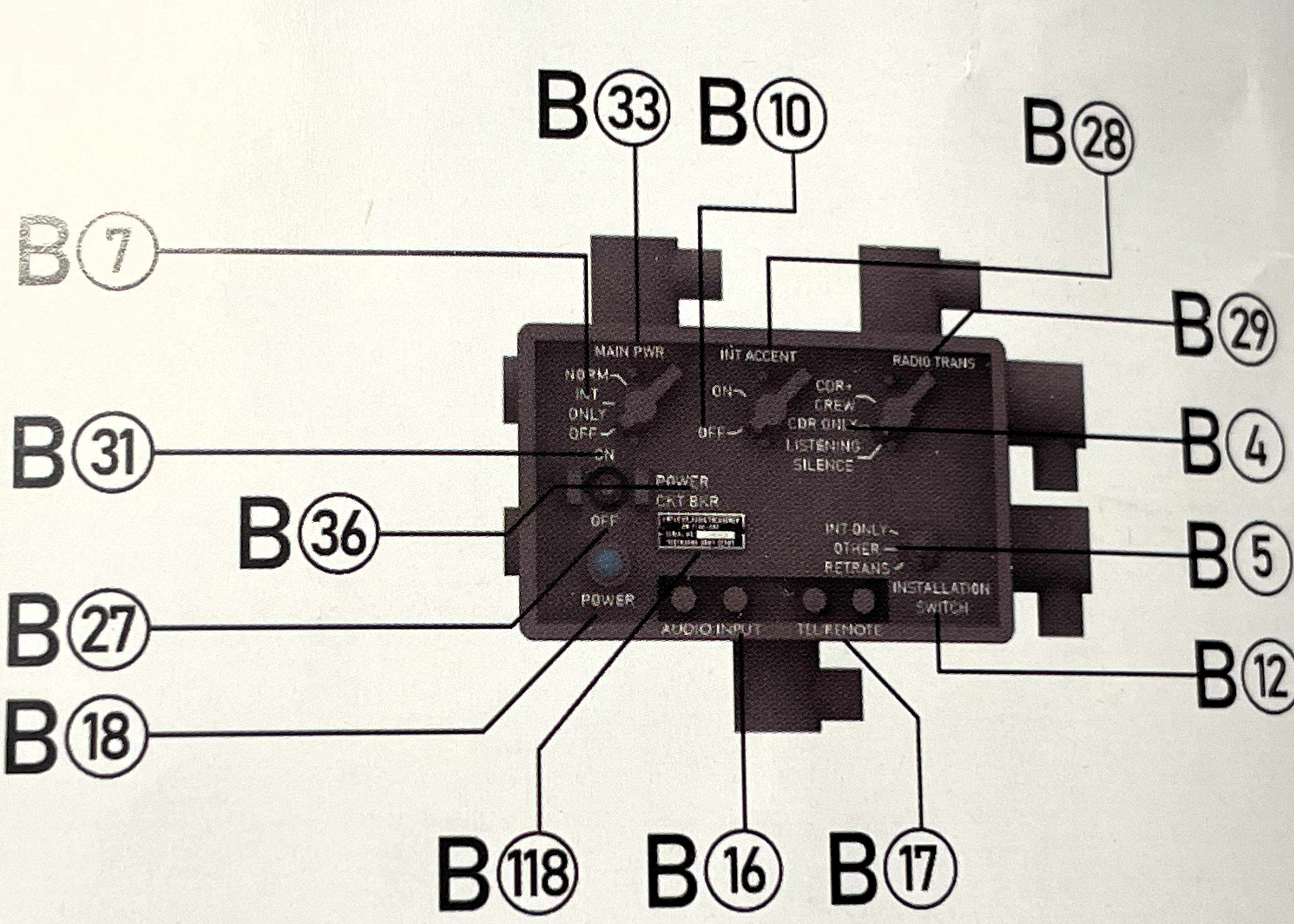

Even the switch boxes have decals for them. This is great that Takom provided the opportunity to super detail them. I am not sure yet about the % of success we can get with these but it is worth a try, with tools, magnifier, patience, mental conditioning and some encouragements.

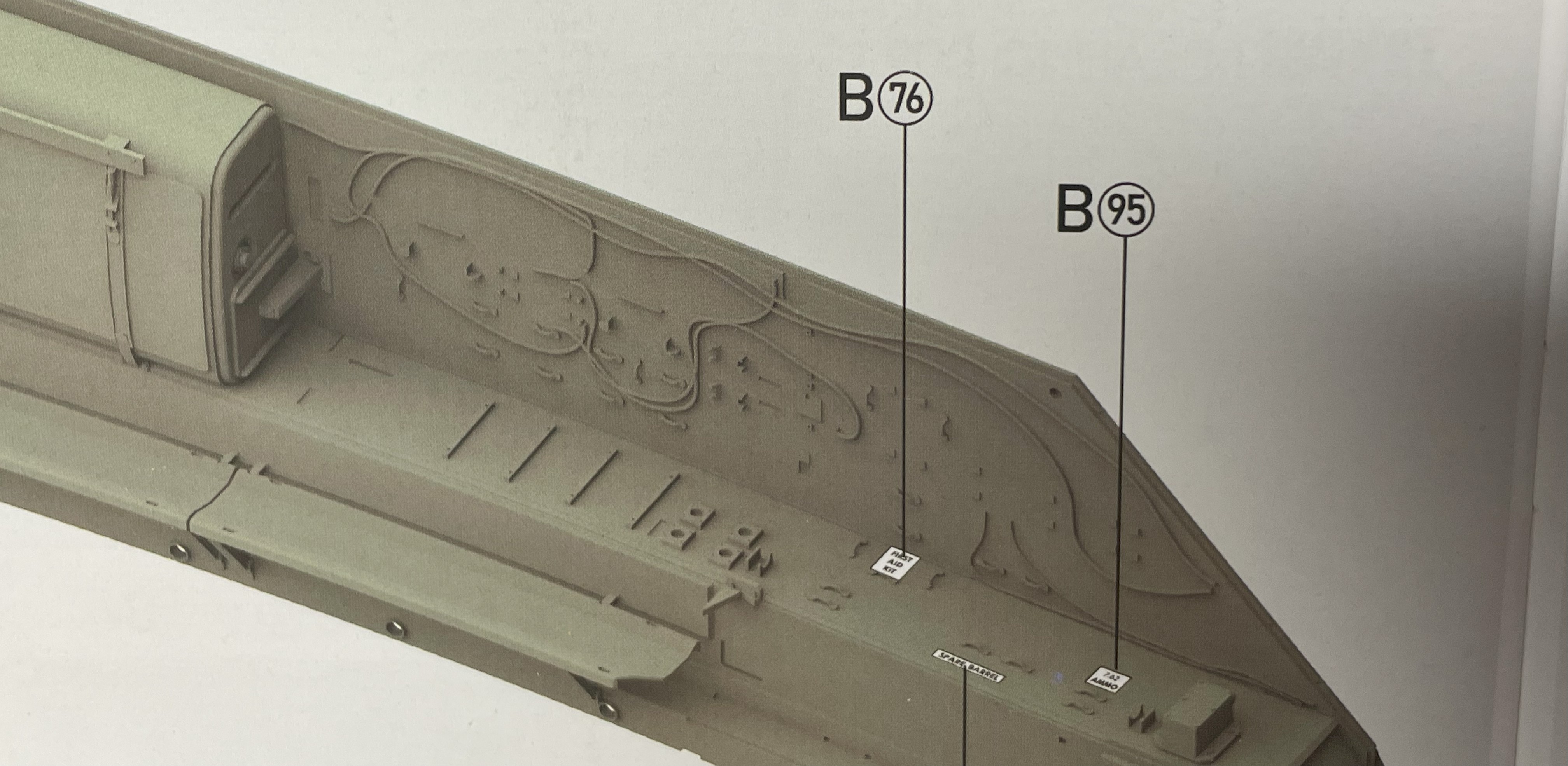

For example, check out where number 31 should be applied as per previous picture. It looks like the decals are well formed so applying these might actually be possible, for those who can see them of course... I know none of this stuff is actually essential so i will do it for the fun of it.

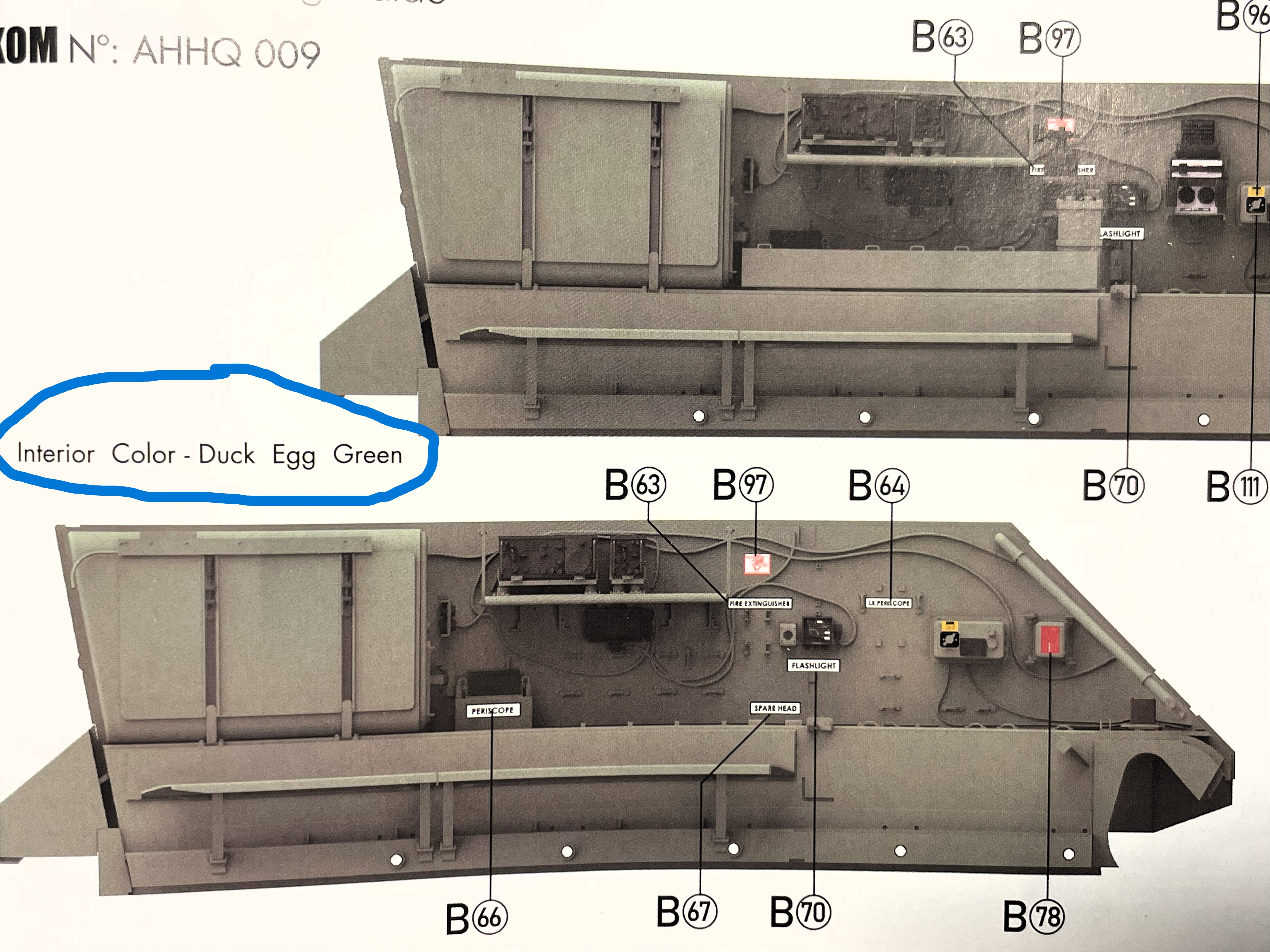

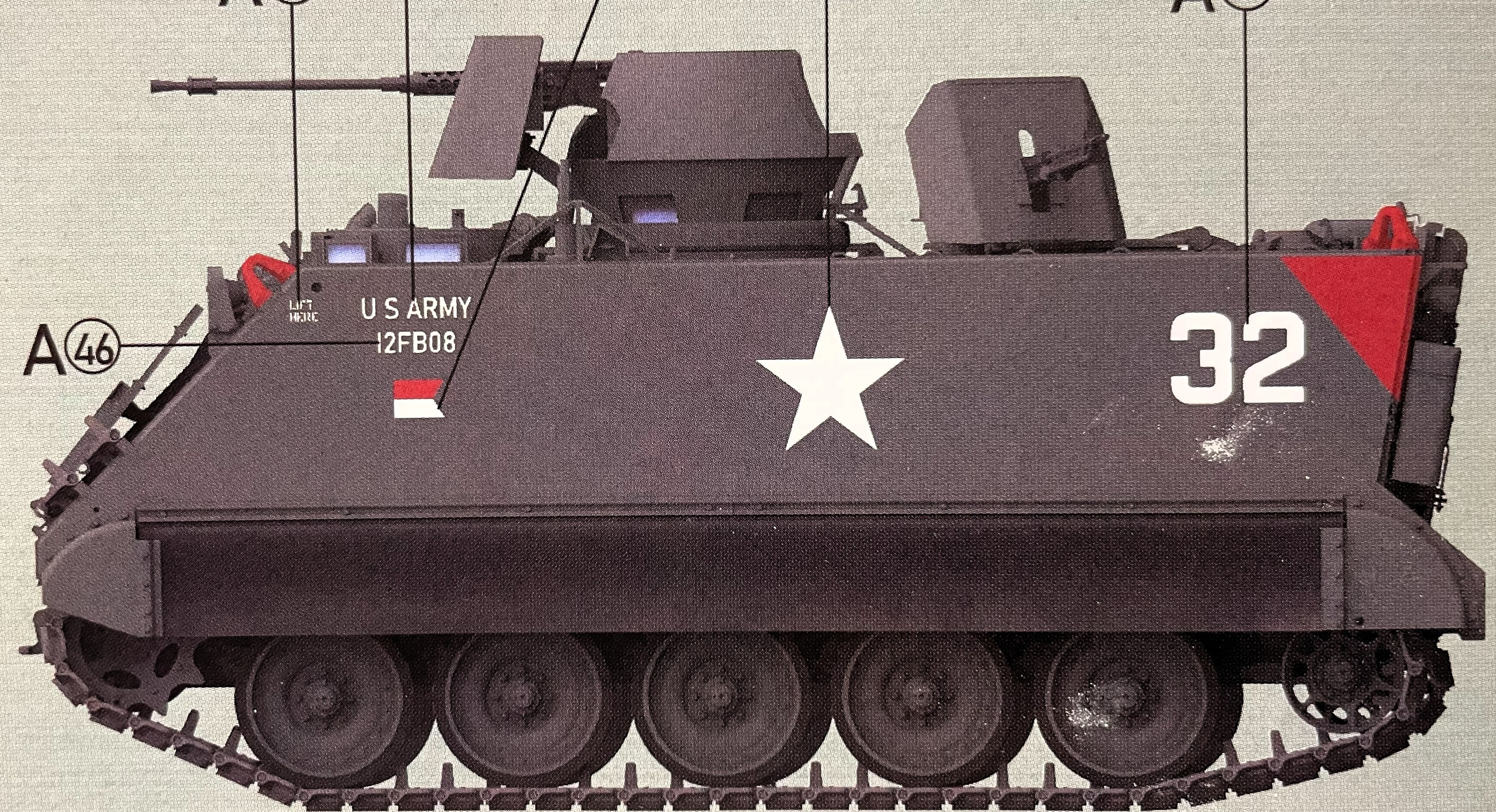

The painting instructions are incomplete. There are no legend for paint colors and the whole thing is suspicious. This is more a decal application instruction sheet. Takom is providing a view as to how they should be painted, but with no technical details, other than "Olive Drab". We know there are a lot of Olive drabs...
It also looks wrong. For example, according to these painting instructions, the radio should be black or something close to it, but we can see in a previous post that it should be in a specific green color.
"Duck Egg Green" is an uncommon name... usually called "Interior green" as provided by AK, MIG and others. There seems to be a lot of variations of that color for navy, airplanes and AFV. Got to be careful.

"Just having fun with it." Gimme a break! :/ That's probably what Michelangelo di Lodovico Buonarroti Simoni said, too. Louis, you are astounding! :thumbup:
"Duck Egg Green" is certainly a new one on me. (Maybe there are quacks in the model paint world.) "Interior Green" is, as you note, what it's usually called. I also know that "Zinc Chromate" is similar, but usually darker. And, as you point out, these are about as easy to identify and replicate accurately as "Olive Drab."
Re: 1/16 RC M-113A1 ACAV - Converting the Takom/Andy's HHQ kit to RC
Doc,
To my big surprise, there is actually a recognized Duck Egg Green color, but it has variations and its giving me problems.
