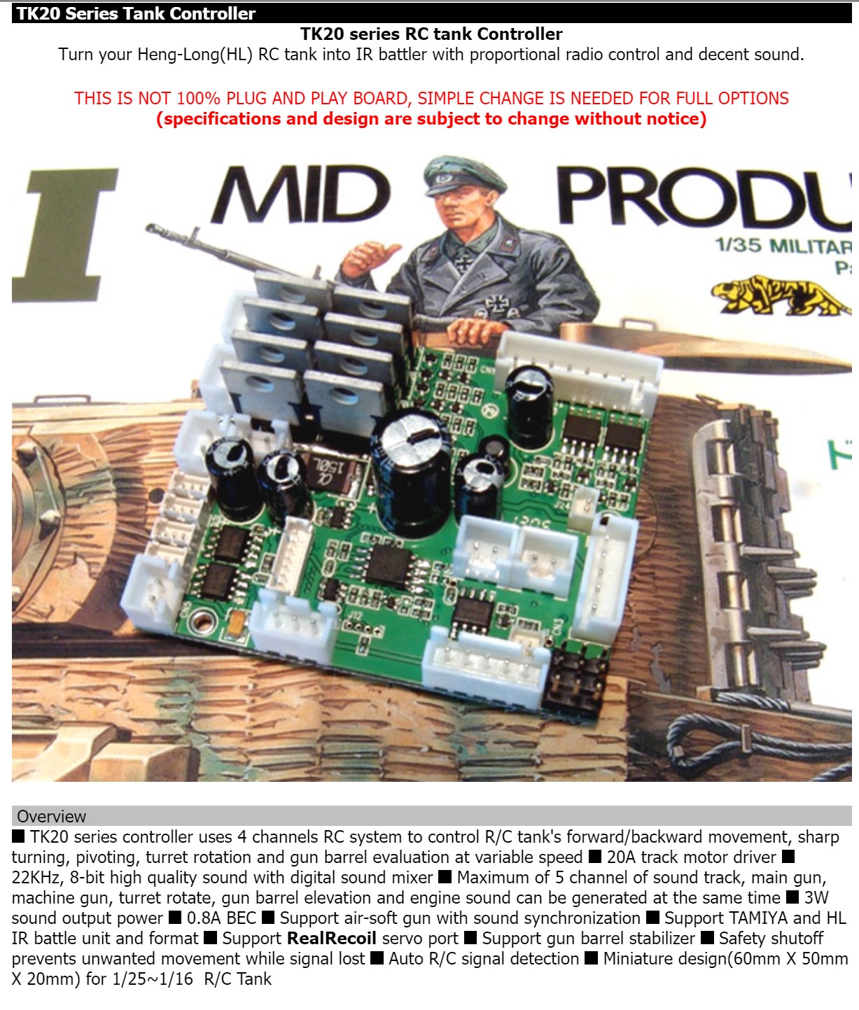

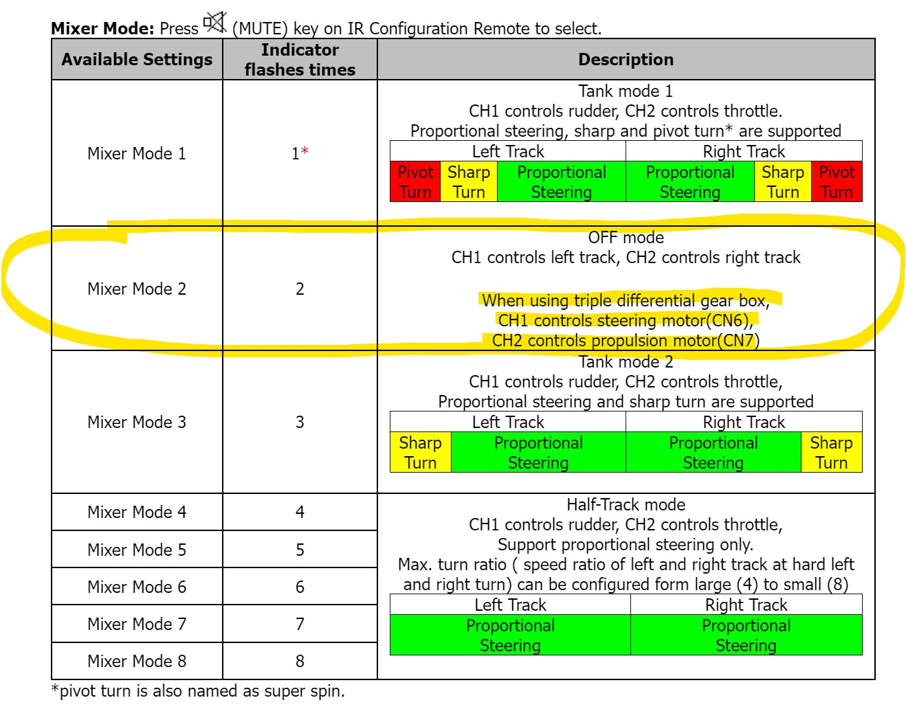

TK24 is half that size. Looks to be a TK60. It's also not a TK80 because the TK80 doesn't have the extra heat sink below the motor MOSFETS. Since you have stuff plugged into channels 1-4, it looks like it is running the PWM and not the SBUS version. SBUS would be using port J7. Without the remote and the IR receiver cable, you cannot change the Clark board to operate the Dual Current Heng Long gearbox correctly.
You would need to set this setting for the PWM version:

Jofaur86 wrote: Sun Oct 13, 2024 3:29 pm :'( Hello, personally, I don't see much difference between our friend's card and the TK 24 T1, but not being a Clark specialist, I wouldn't add anything morev :haha:
Because the post you referenced and the pic you referenced were of a TK60. The TK20 series, all of them...are square like the TK40 and TK50 boards. I own a TK60, some TK80s, some TK40s, and a bunch of TK50s. Only the TK60 and TK80 have the larger board footprint. The "T1" you are referring to is just the sound set from the Tiger I. I took the pic of the TK60 directly from the Clark website. You pulled your TK24 information from a 3rd party Youtube video. This is a TK24 pic taken from the Clark website as the TK20 series are all the same size:

That is a radio that is correct for a Clark board. He needs the Sony TV remote control to program the board that I posted earlier in the thread.
