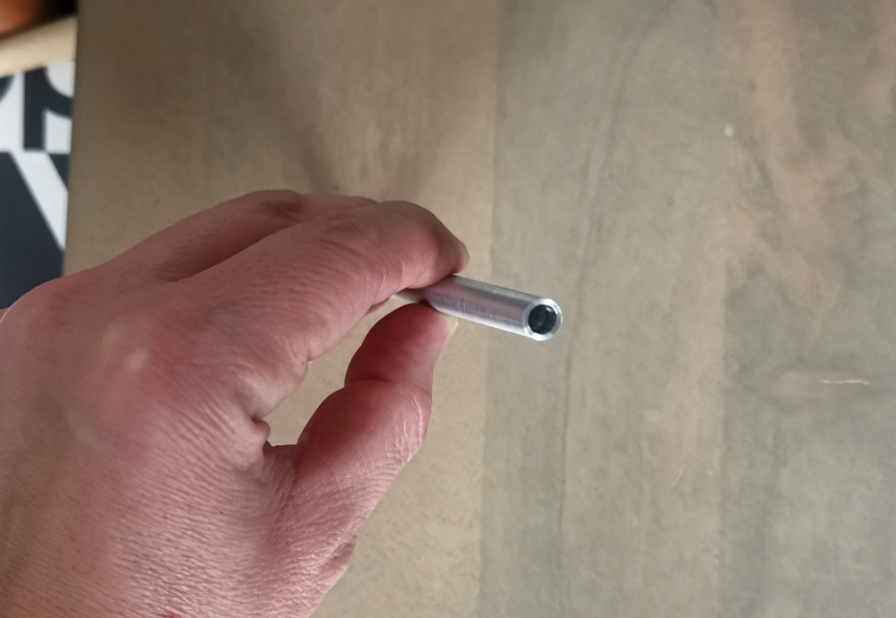

I worked on the gun barrel, the last big step of this build.
As I told you earlier, I did a 3D printed attempt but it warped after a few days. I suspect I did not UV cure it evenly. I tried to reshape it with a heat gun but it did not work too well haha.

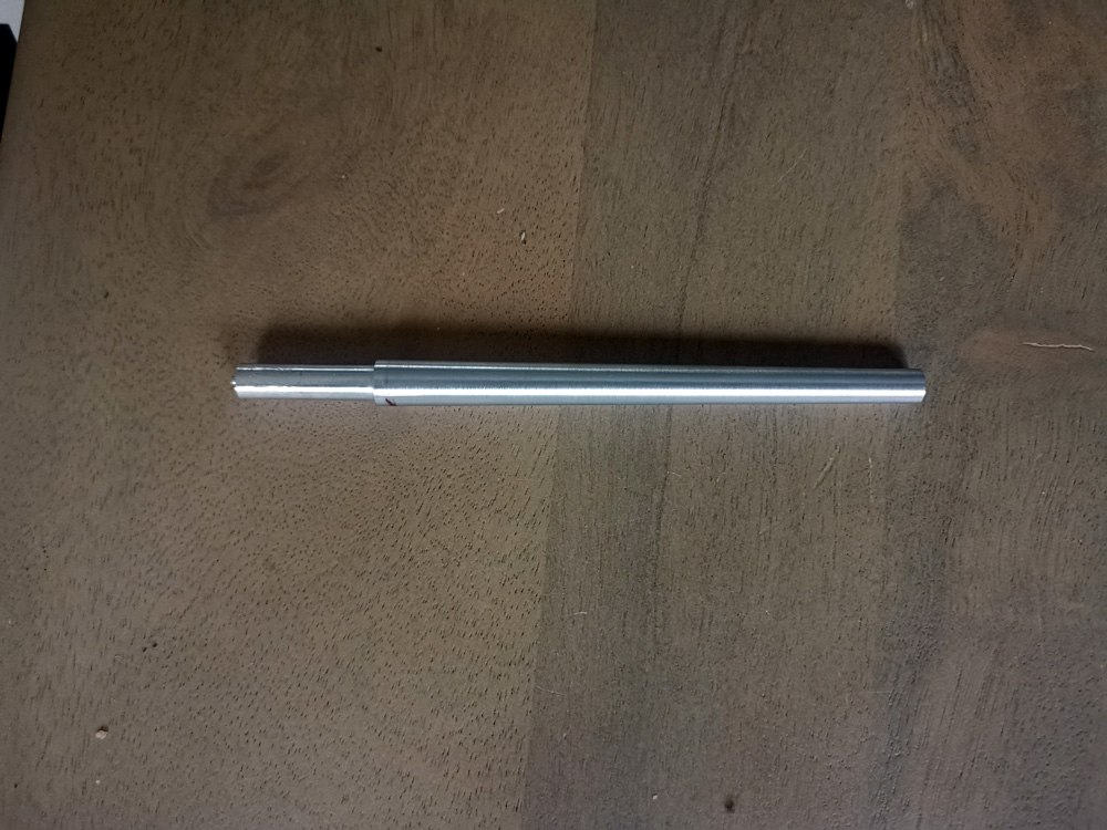

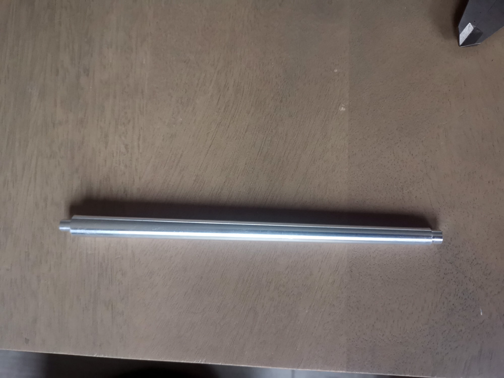

I had an aluminium barrel leftover from my Easy 8 build, the idea was to convert it from a 76mm to a 75mm by shorten it and reduce the diameter. And also drilling it as it was solid.

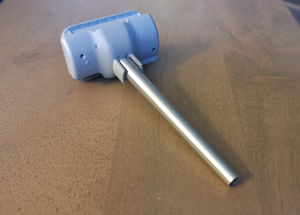

Was a bit affraid to do it but that work and the hole is not that much off center ! Almost perfectly centered. I did not drill it all the way through as my drill bit was not long enough and I could not hold the barrel in the lathe the other way.
The original barrel :
After machining :
Hole is not that bad :
Attached to the M34A1 mount :
And a comparison with the original HL 105 barrel which is not quite right but I guess they had to make it work for the 6mm BB :

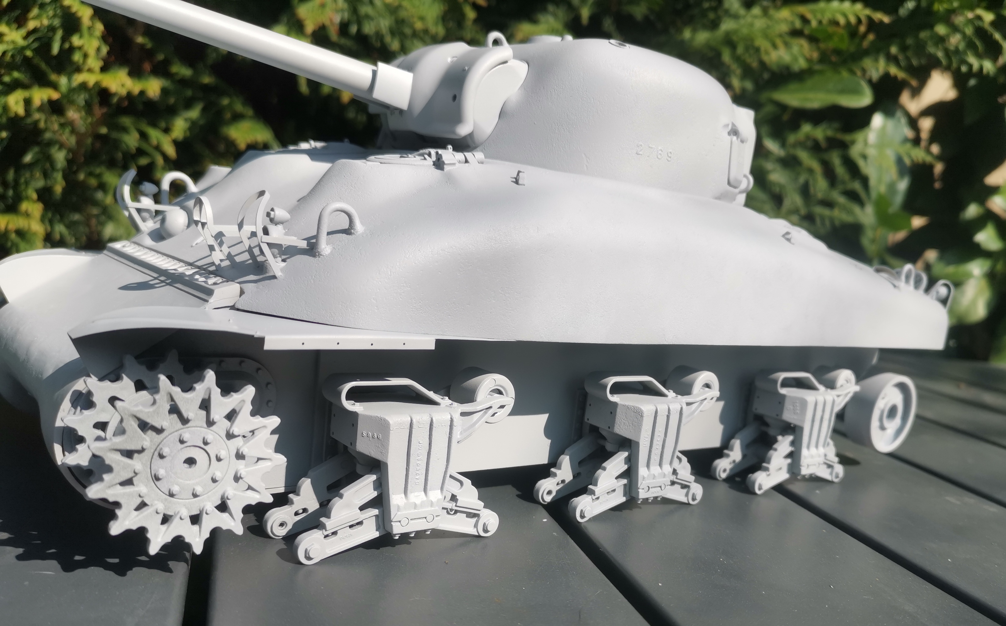

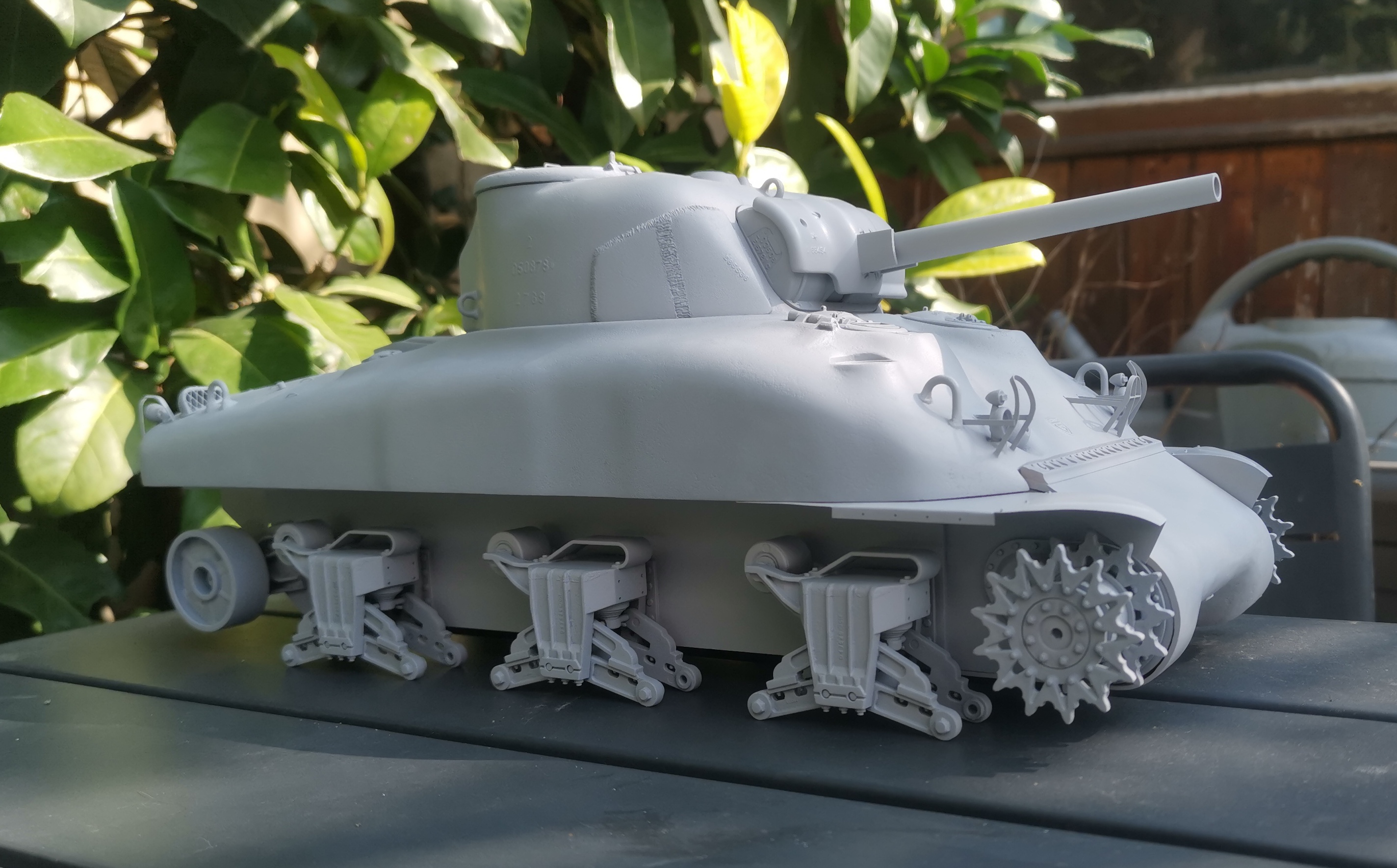

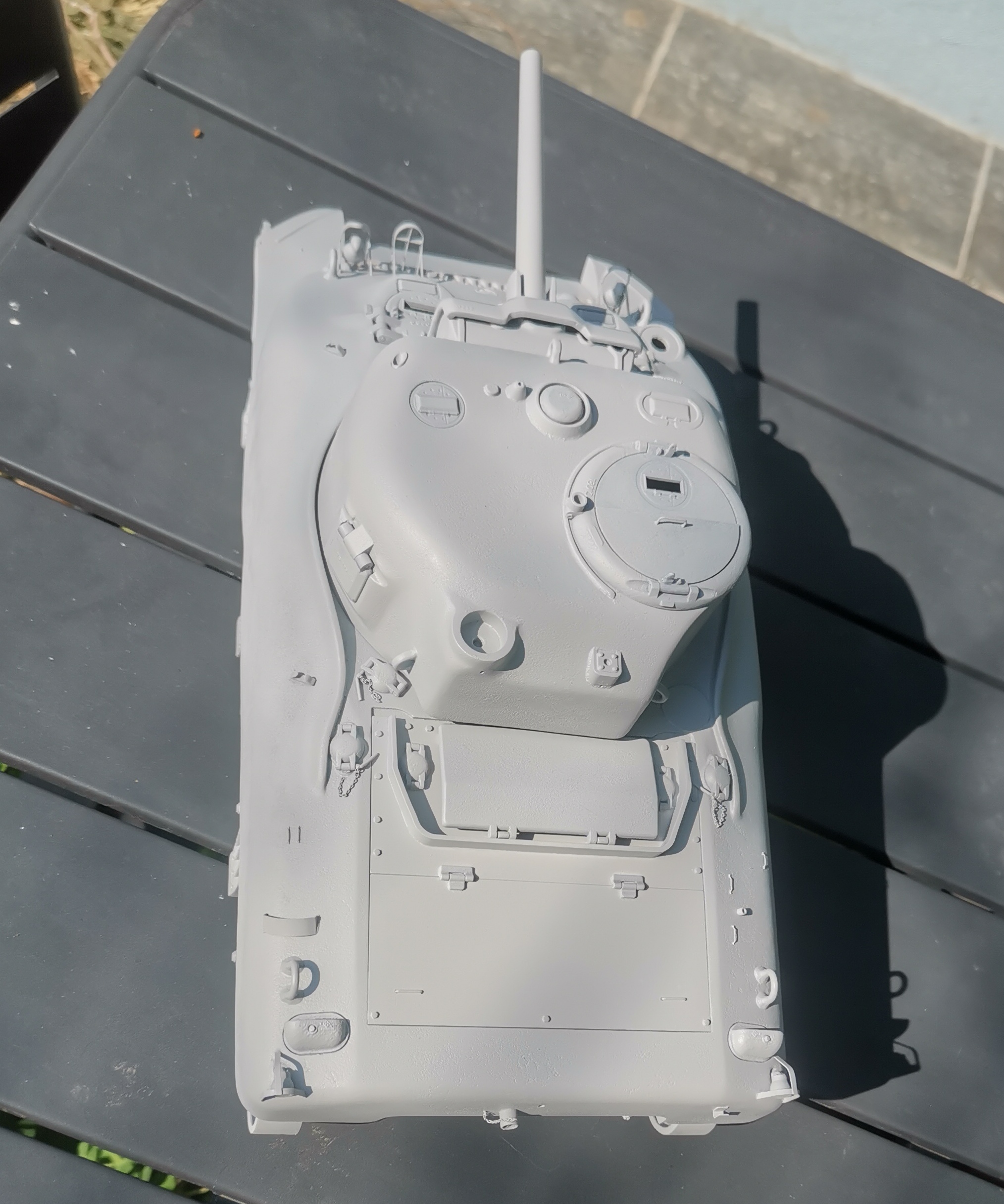

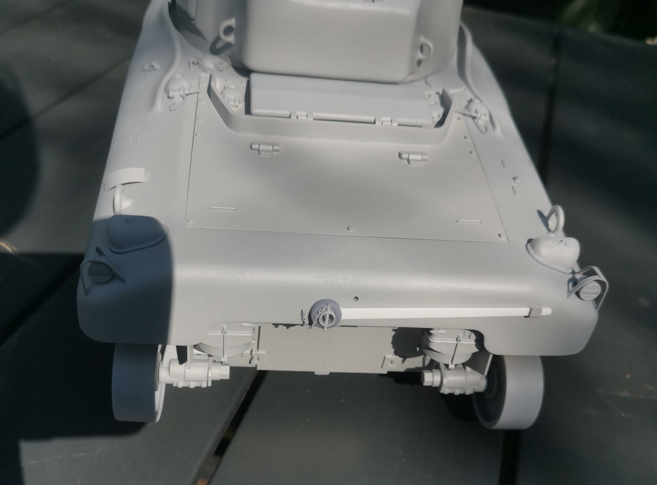

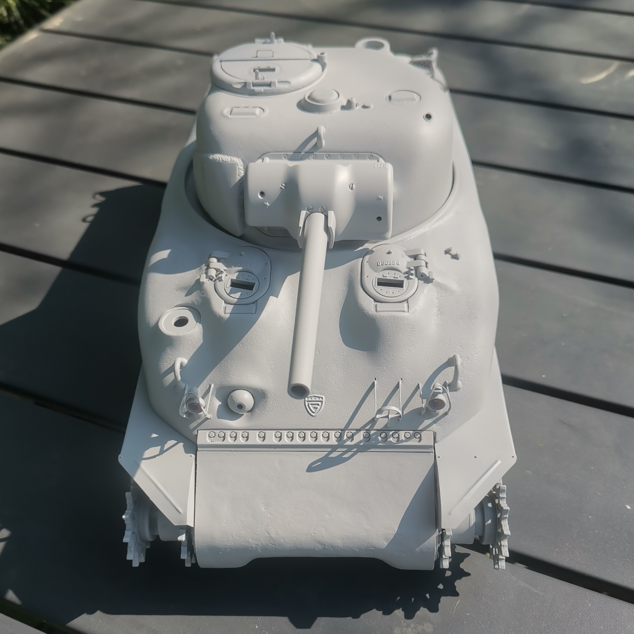

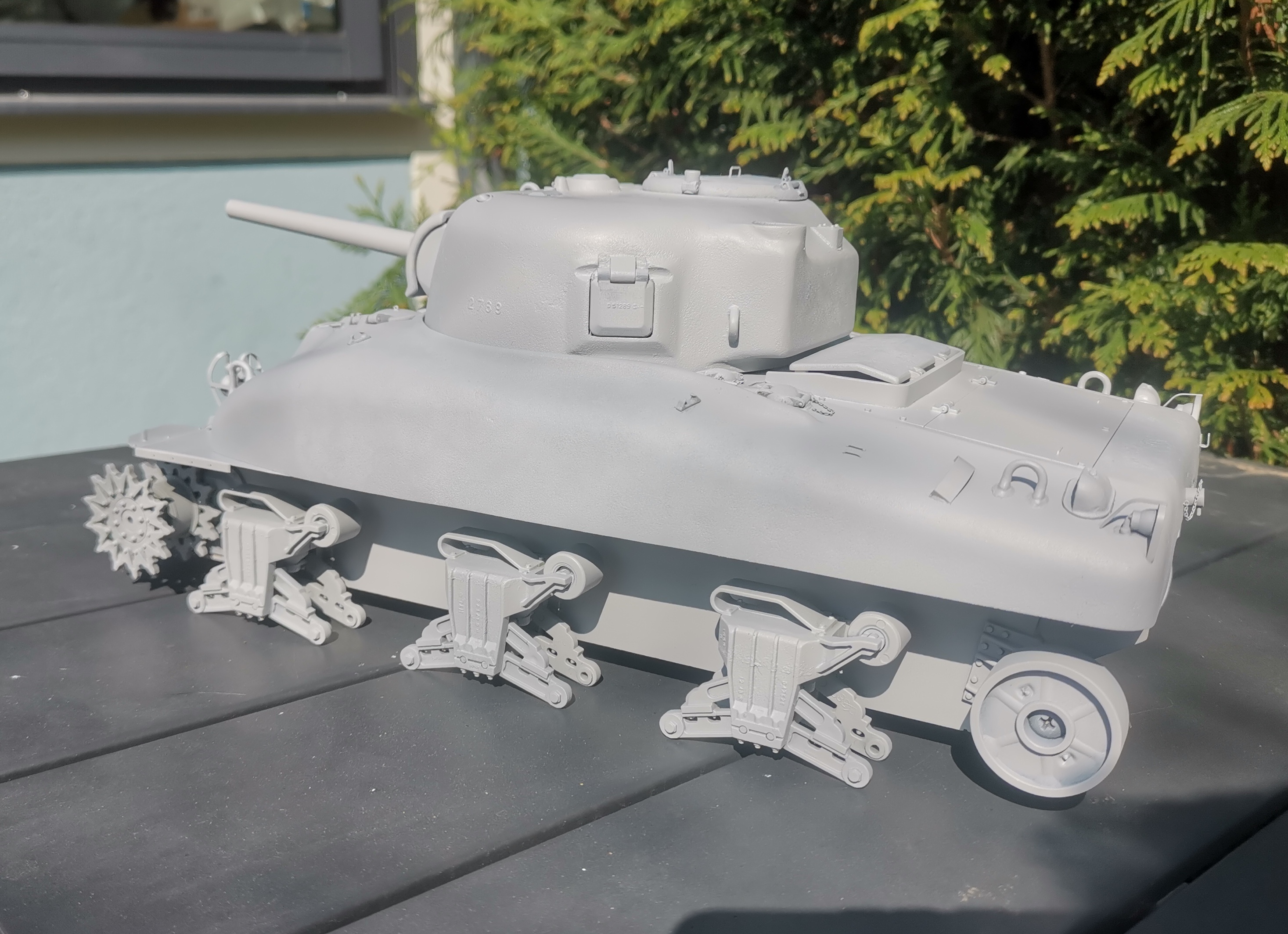

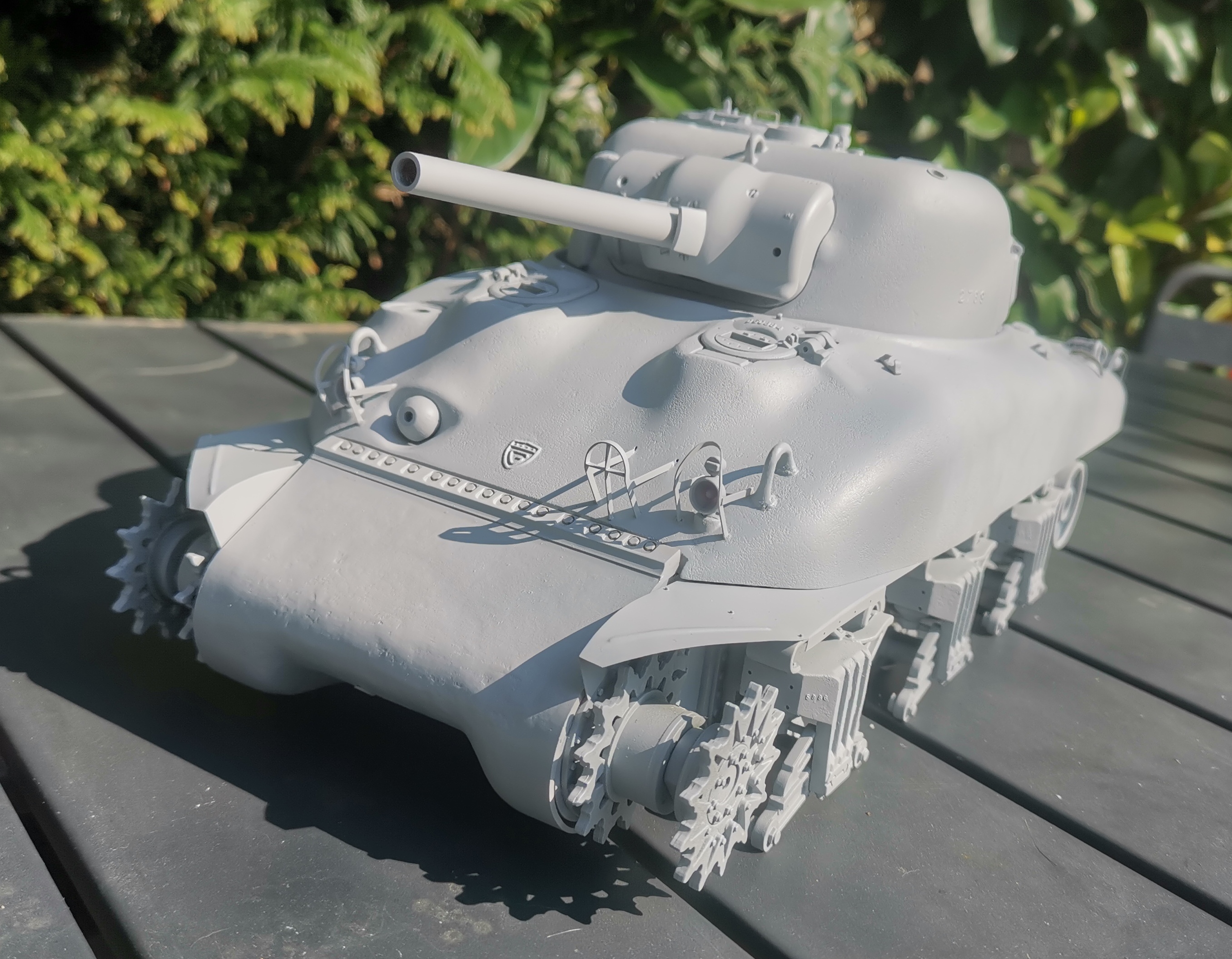

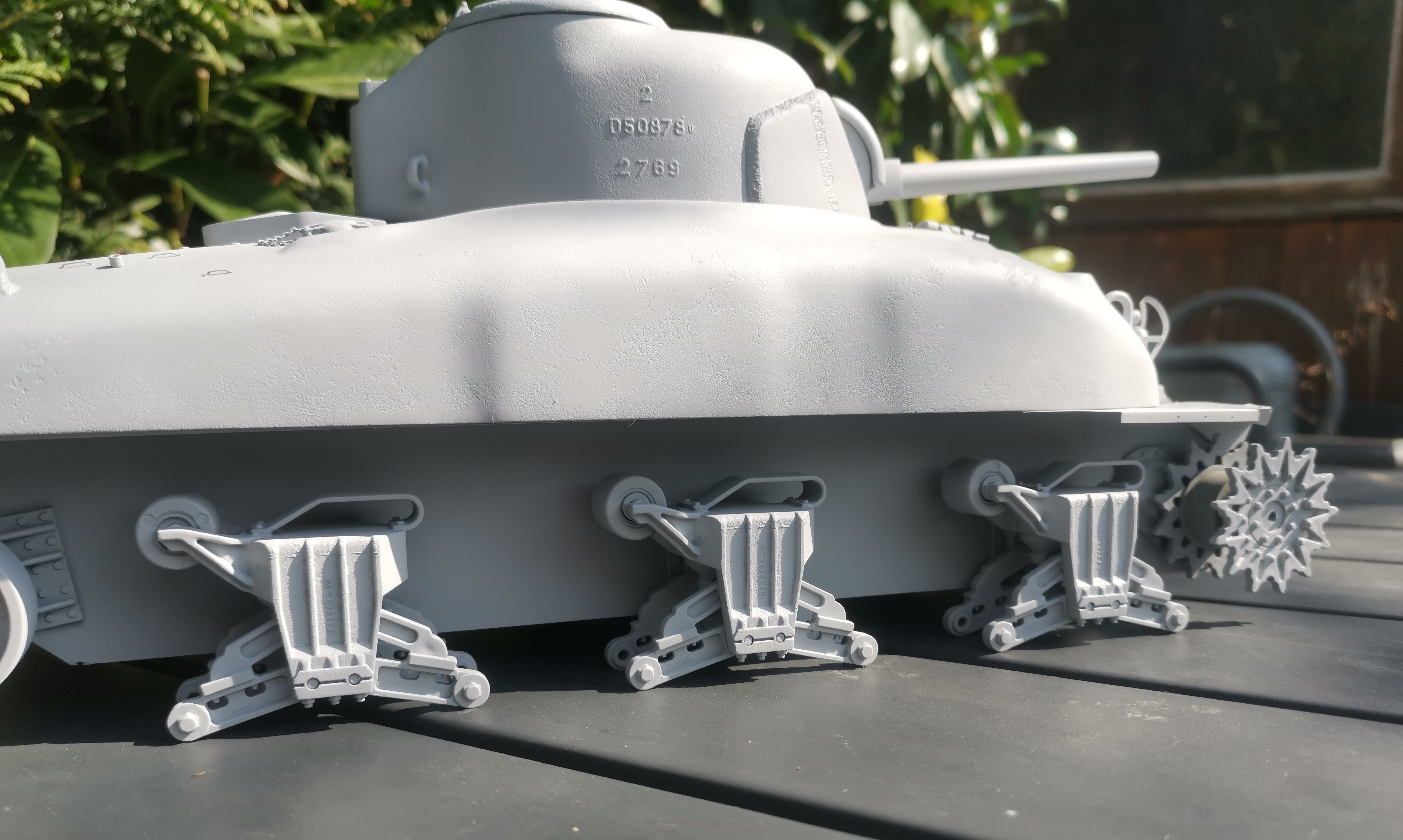

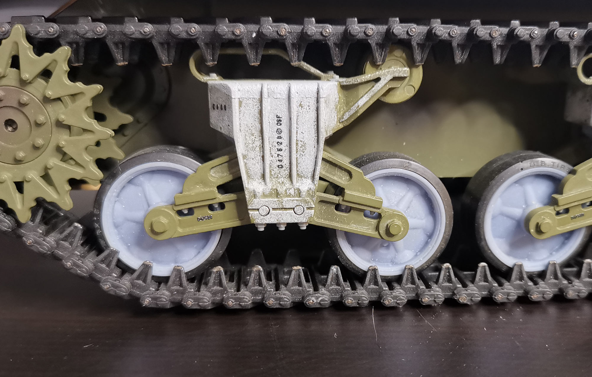

Hey guys, I have been 4 months without access to my workshop and we had big house work done so I was not able to work on my models as much as I would have wished. The good thing is that, in addition to my shop where I have all my tools (3D printers, CNC mill, manual mill, lathe), I now have an additionnal room for my office and my small hobby jobs.

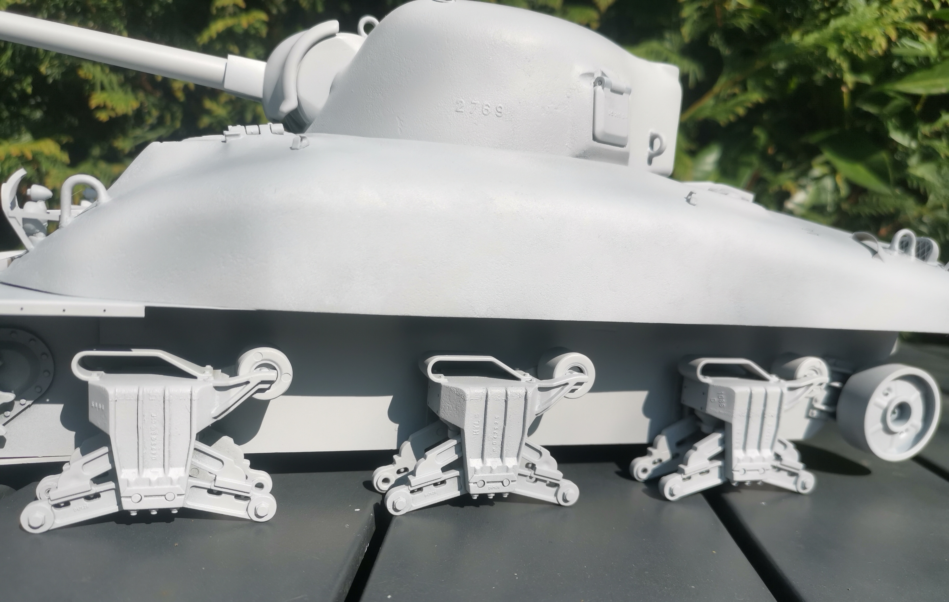

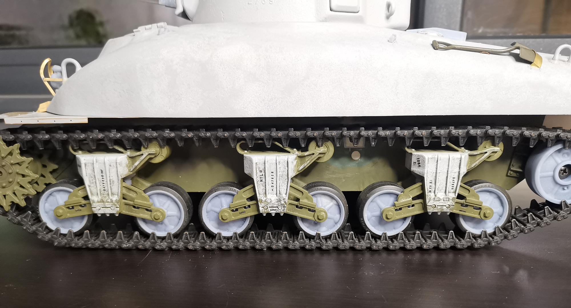

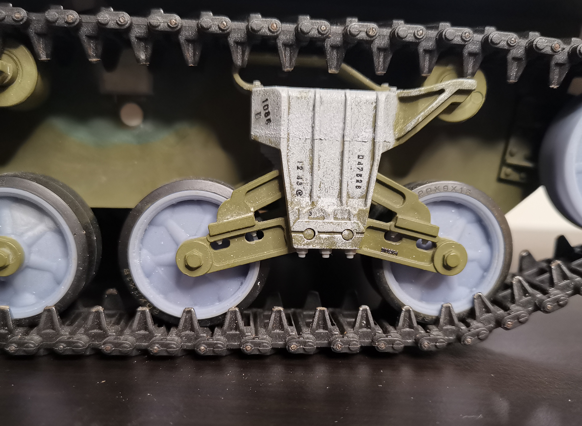

So a small update on the M4A1, the 1/16 Archer resin casting foundry marks were too big for the VVSS bogies, so I bought the 1/35 ones. They are maybe a tad too small but they do the job.
I tried to vary the manufacturers and matched their own casting style (they did not cast the part the same way that's why the mold line is different from a manufacturer to another, like for the turret).
Each figure and symbol was cut and applied separately. I did not always use the right foundry mark because it was just not on the decal sheet, but they are so small (1.2mm) no one would notice !

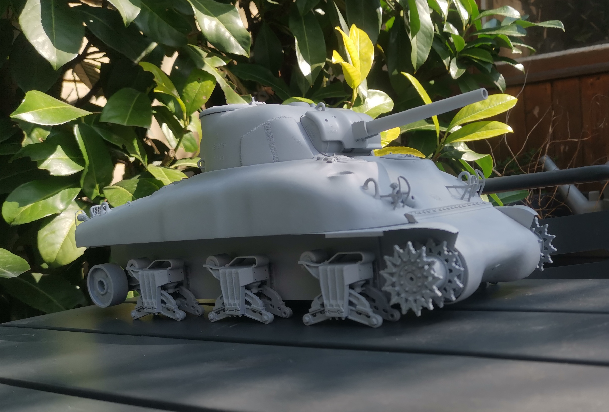

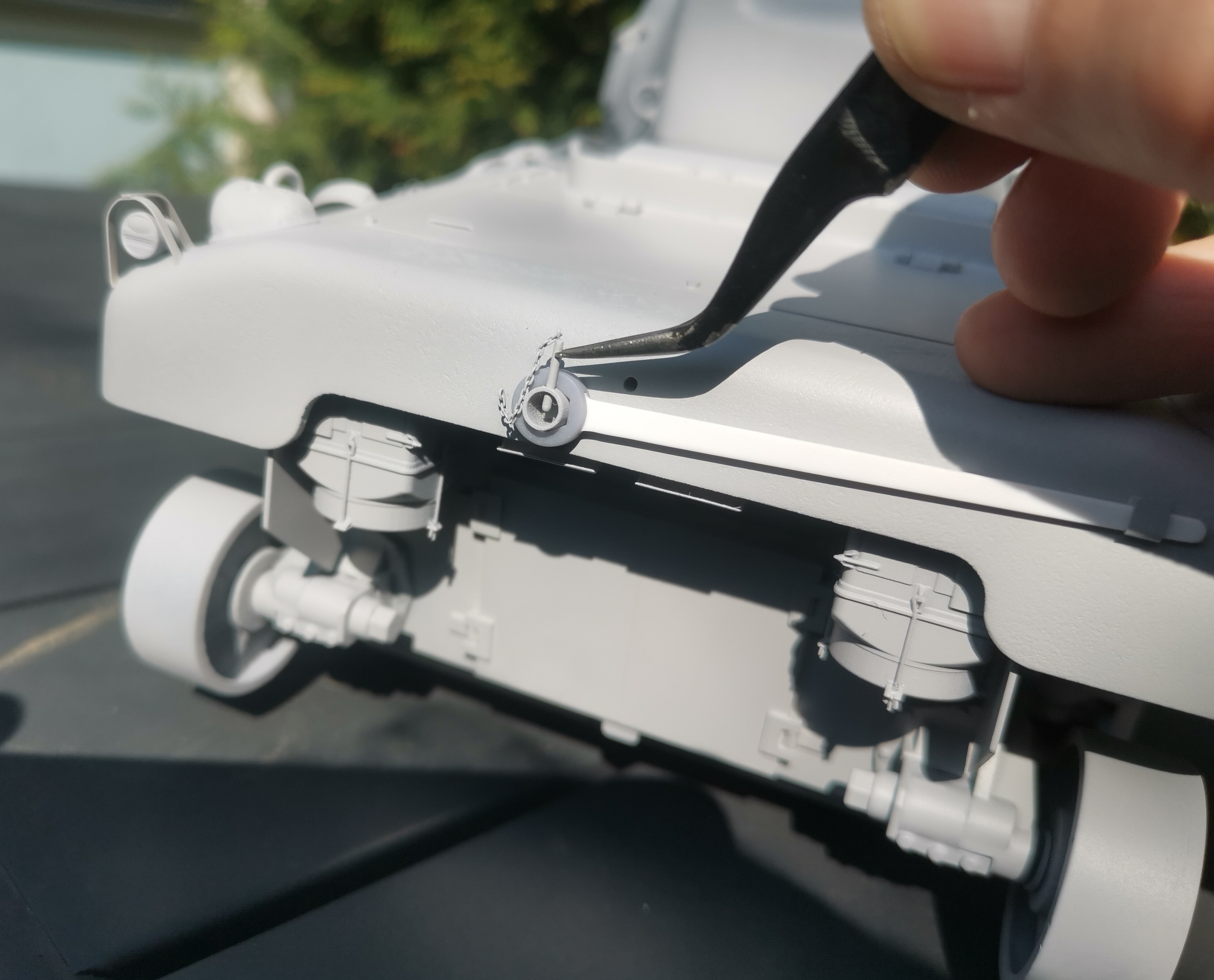

I found on Aliexpress some really tiny metal chains. They are cheap and great! They have a kind of black coat and some links are stuck but you can "break" the paint by moving the link back and forth.
Since I took these pictures I installed Mato idler to adjust the track tension.
