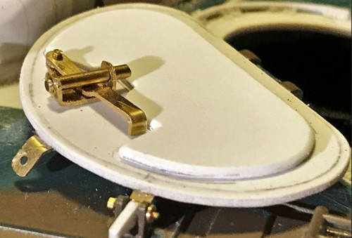

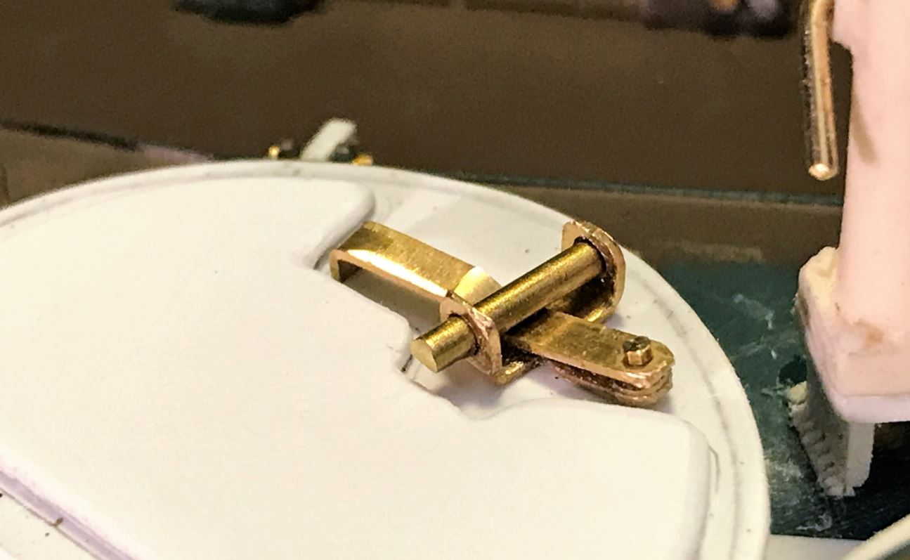

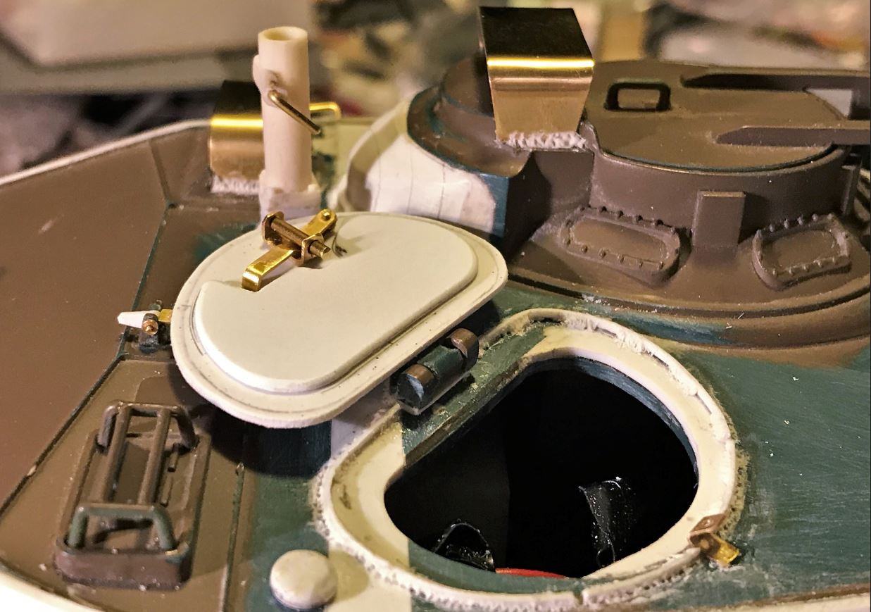

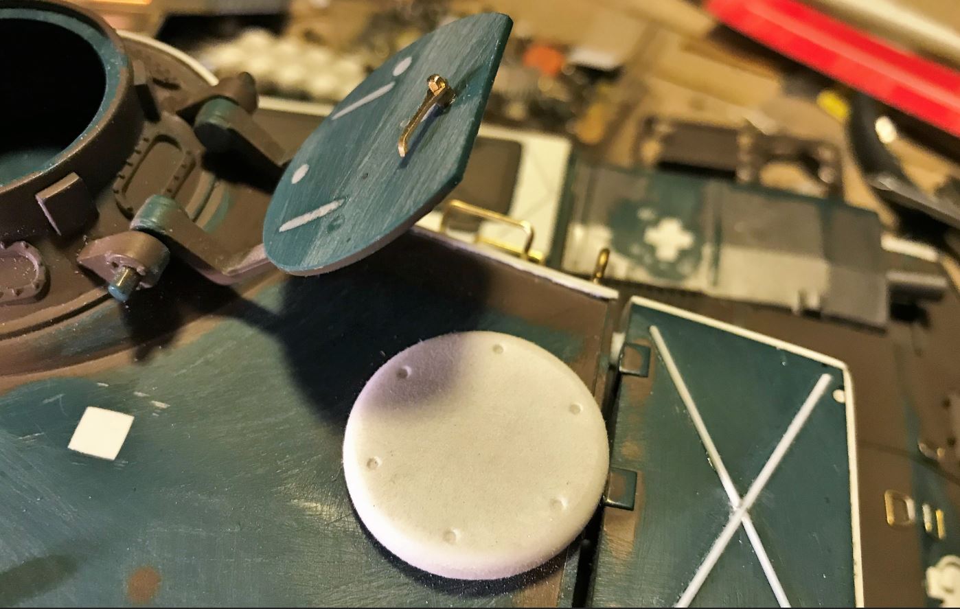

Finishing touch on the loader's hatch. This hatch requires a lot of reference study to get it close to the real thing. I redid the latch for the lock used to lock the tank when the crew is away, it was not at the required angle. Also added the little flat strip that connects to the hatch holder at the front so it needs to be positioned correctly. Heng Long did not... The Heng Long hatch holder part was reused but detailed with a M0.6 bolt and movable latch.
Heng Long M-41A3 Walker Bulldog turret detailing and fixing

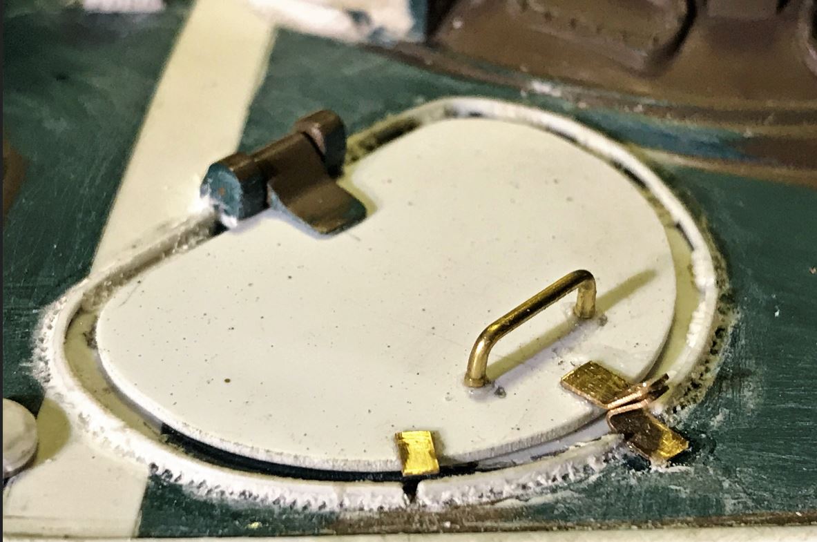

As there will be a tank crew, the loader's hatch will be displayed open so the closing mechanism had to be detailed a bit. I did the head rest but the complex rubber seal around the hatch seen on pictures would have been too difficult to replicate. I have to pick my battles in order not to be stucked on secondary details.

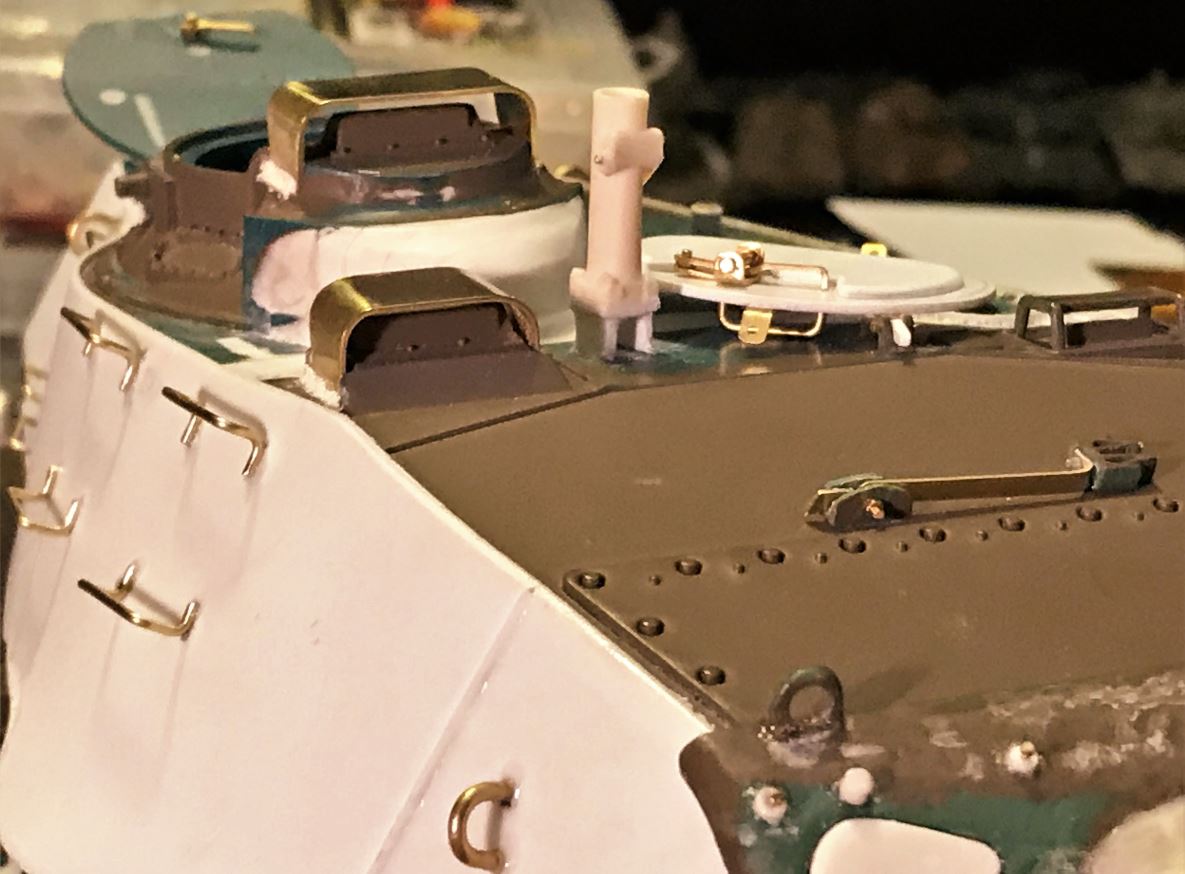

The machine gun mount on late M41s is on the left of the commander's cupola. There is no longer another mount at the back. The resin mount is a Nick Aguilar Sherman M2 MG mount that I modified to have the right type of attachment to the M41 turret. I also redid the handle in 1mm brass rod.
I redid in brass the armored shield for the periscopes. The Heng Long parts were not too bad but the front one had a hole on the right side to make room for the MG mount that was previously on the right of the cupola, and it was also way too high. So, I decided to replace it. In order to show consistent construction, I also did the one in the back with the same process.

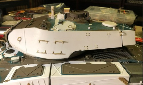

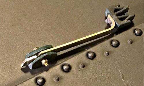

All the side brackets were redone in 1mm brass for the large ones, 0.5mm for the small ones. There are various mounting arrangement for these. Early M41s seems to be a simple rod connecting strait to the turret. For later versions, they are reinforced with legs going parallel with the turret. Then I saw some picture where the legs are all facing down, or facing each other like I build them here.
Also notice the new position of the MG gun barrel holder at the front.

Notice the locking mechanism on the commander's hatch. It is the only detail seen on the interior of this hatch.

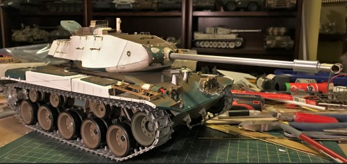

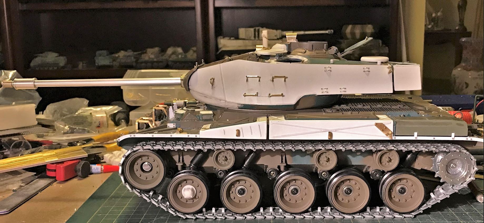

The model as it stands today.
The provided M26 road wheels coming with the model are too wide for the M41. I will analyse if they could be reduced by a few mm.

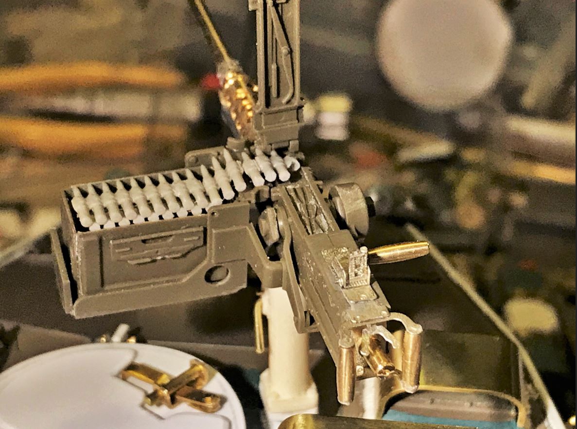

Here is the M2 .50 Cal Machine gun.
After the disappointing use of the metal AFV-Model M2 MG on the M-113A2 build, I decided to go back to the Tamiya/Aber combination for best results. I remember that the first time I build one many years ago, I only installed the brass barrel and sleeve on the Tamiya kit, discarding all the photo-etching stuff that I was not comfortable with, thinking people must be totally mad to create and offer such a kit. On later ones, I used a few etched items, mainly for curiosity because the Tamiya parts are totally acceptable. This time, I wanted a challenge and I decided I was going all the way and use every etched parts, no matter how long it took. After all, it is a good puzzle to build and I am paying for it, so let's not see it as a burden. Let's have some fun instead and try to avoid the main pitfalls that discouraged me in the past.

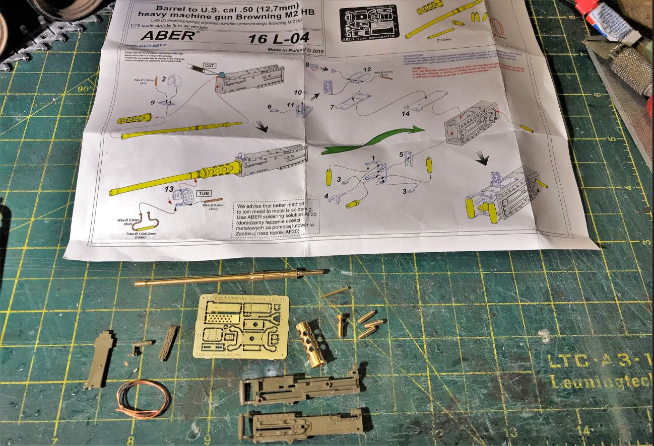

These are the main parts for the MG build, it is a small project on its own. It is my last Tamiya M2 I had in store, I will need to find more if I can find a supplier. The ABER set is the 16 L-04. Now, clean up your desk and make sure all parts are secured. If one of those small Aber parts jumps in the air or rolls on the floor, it is guaranteed you will never see it again. To see the parts in the first place, I have to put on 2 pairs of glasses on top of each other because this stuff is really small.

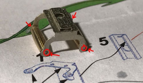

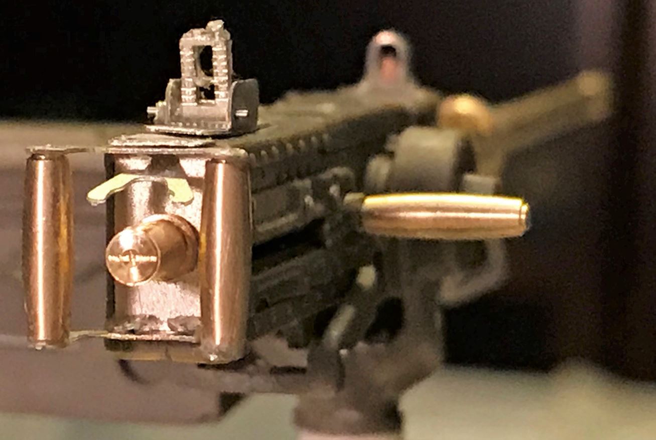

Pitfall number one are the two handles at the back which always gave me issues making them strait and keep them in place. I decided to drill holes on the braces so that the small pin at both ends of each handle have a deeper slot to fall into. Problem resolved, it went really well.

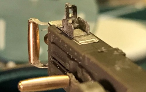

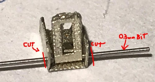

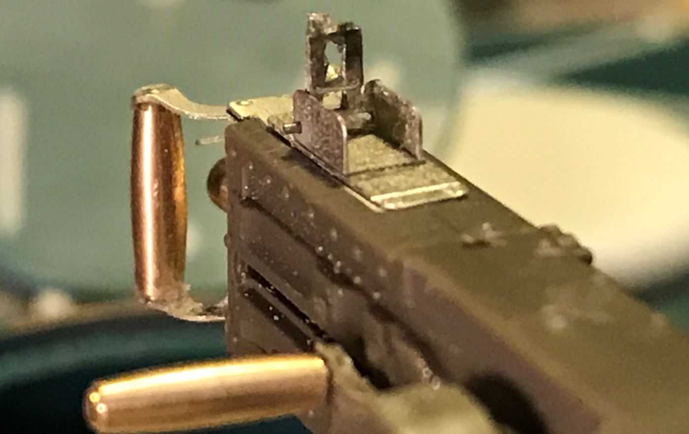

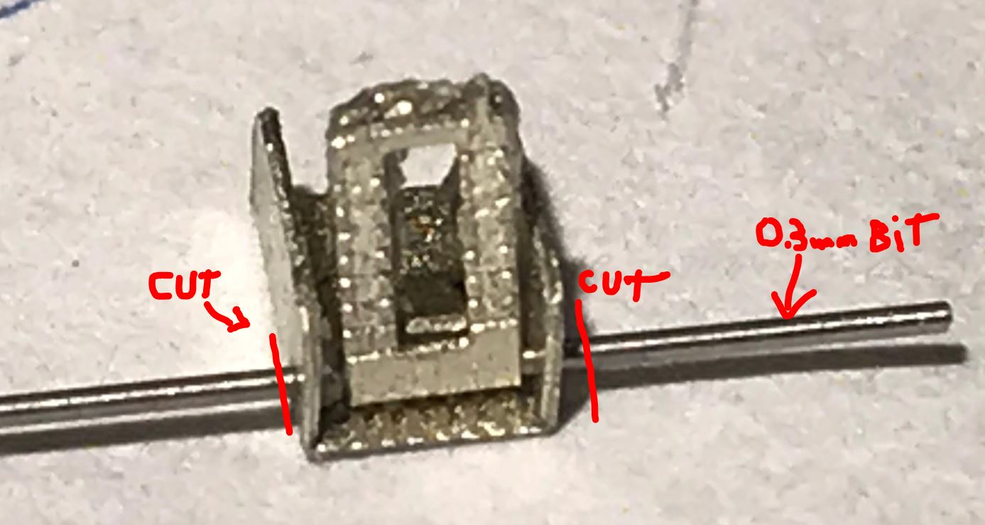

Pitfall number 2, the dreaded sight, it is so tiny. The required 0.3mm wire is not provided to anchor the flexible sight onto the mount. Instead of scavenging the house for some kind of wire of the right small size, I decided to sacrifice my 0.3mm micro bit. It is solid and the etched sight just solidly wraps around it and is then superglued in place. Both ends of the micro-bit are then cut. This time, it took me 2 minutes instead of 1 hour. I ordered ten 0,3mm micro-bits replacement from China for $2 with free shipping... so there is no point looking for more options.

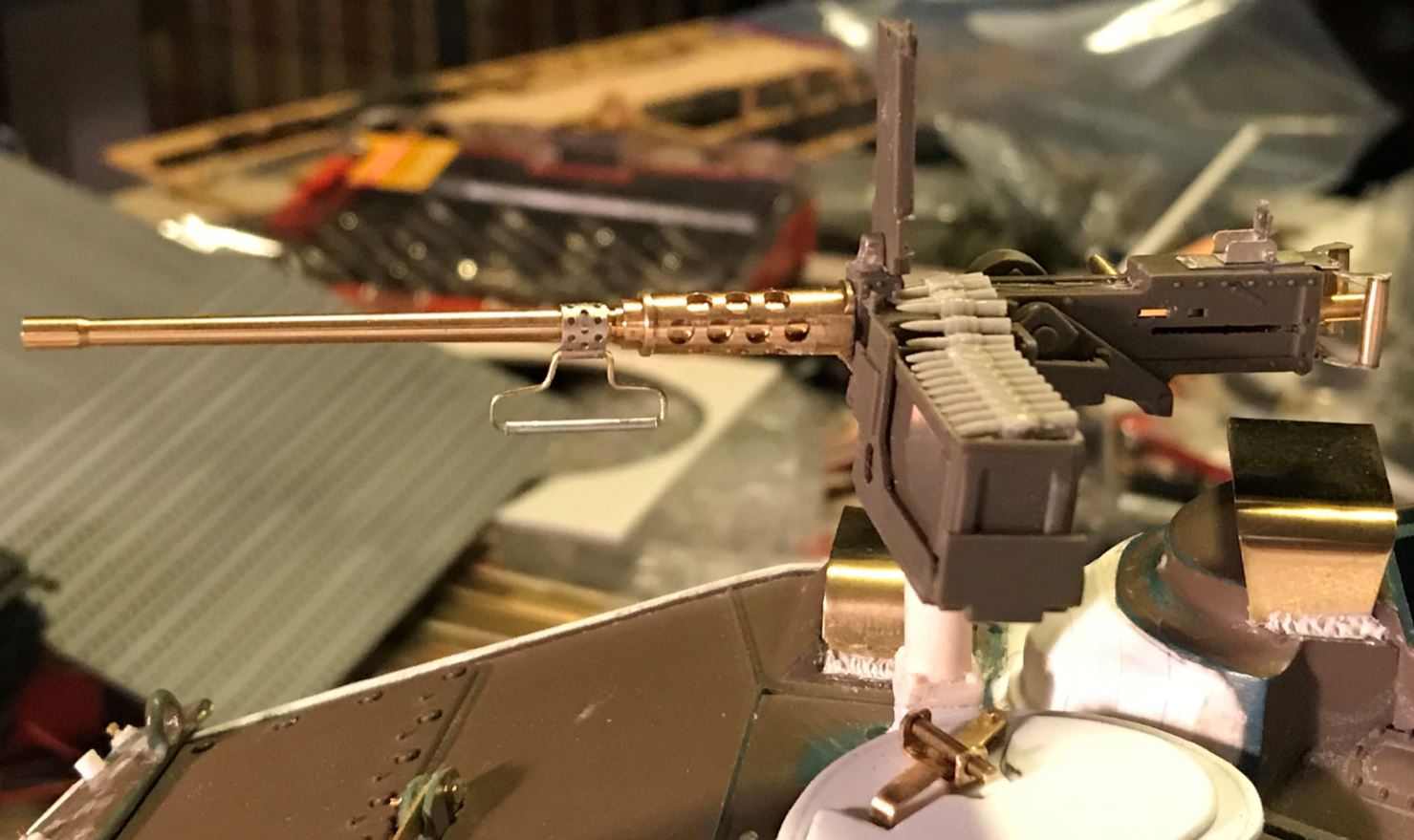

Overall view of the model. The Tamiya ammo loading mechanism should not be glued so that you have the option of presenting the gun being loaded. It makes it more interesting. The 0.50 ammo rounds are from Live Resin .

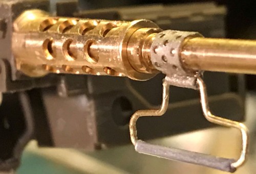

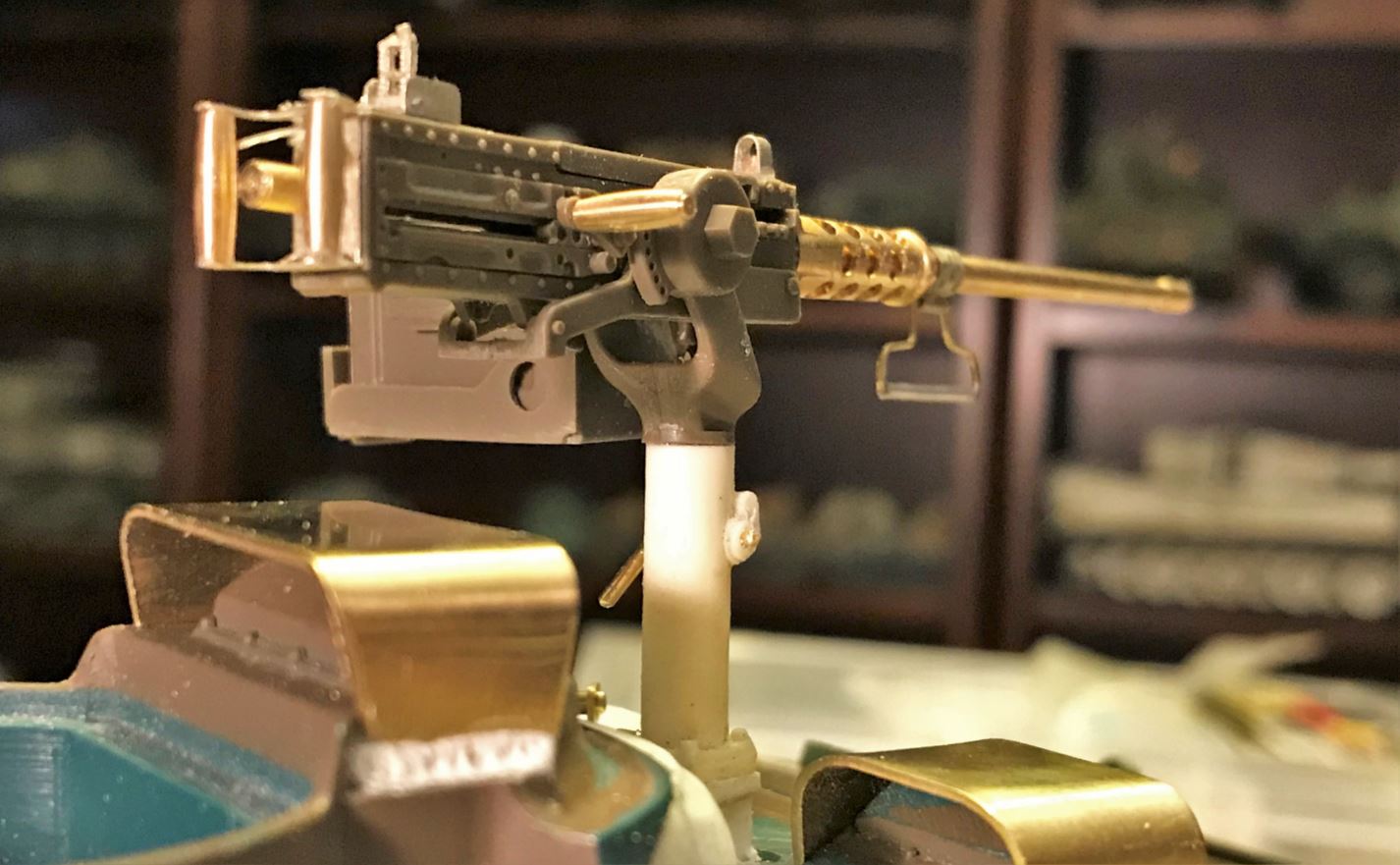

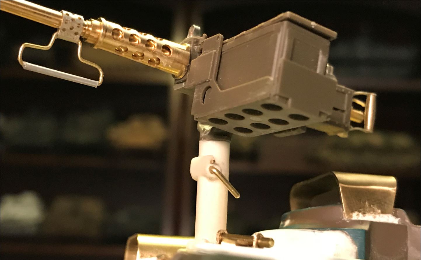

Pitfall number 3 is the barrel handle. Instead of using the flexible wire provided by Aber, I decided to use more rigid 0.5mm brass rod from K&S. It was much simpler this time. It was a lot more easier to wrap the thin etched strip around the brass rod, and then wrap it again around the barrel.

The machine gun back sight looks good and can be raised or lowered. The front sight is a challenge to make... you just need to take your time and do and undo it until you are satisfied. The 0.3mm bit can become handy again in making the pin in the middle of the front sight. I used a sanded down brass 0.5mm rod section because the front sight was done before the rear sight solution was designed.

It is a nice addition to the M41. Although the Heng Long MG is acceptable and looks ok, the details on the Tamiya/Aber combinations provides extra satisfaction to the demanding modeller.

Overall, it took about 3 hours to build this little gem. With the right mind set, it can be done. It is a good challenge, can be fun to build, and it brought a lot of satisfaction having done something I did not do before, I mean, all the way.
