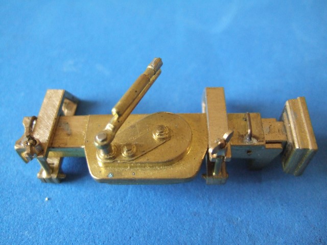

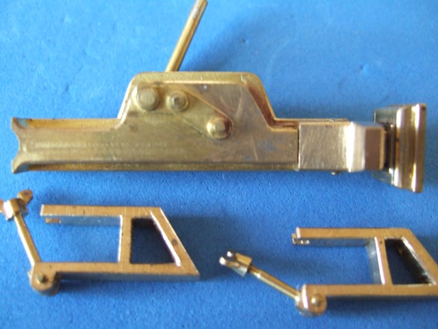

Having a big project like this one, all those many parts not to mention that I had to make some parts three times till I was happy with them.
To mind comes the tank jack which needed three attempts. I will post some pictures of it.

The tank parts.
144 (Small).JPG (84.42 KiB) Viewed 6122 times
walter
Posts: 567
Location: Geelong Australia
Re: Scratch build Tiger 2 Part 1
Post by walter »
another view
145 (Small).JPG (83.77 KiB) Viewed 6121 times
walter
Posts: 567
Post by walter »
and another
148 (Small).JPG (82.6 KiB) Viewed 6121 times
walter
Posts: 567
Post by walter »
Jack complete.
135 (Small).JPG (74.51 KiB) Viewed 6121 times

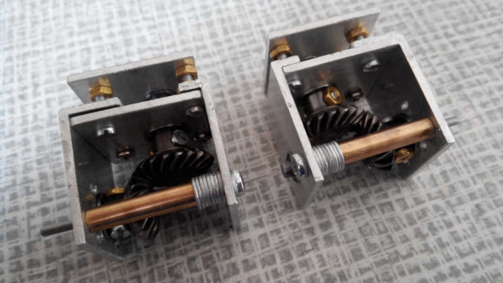

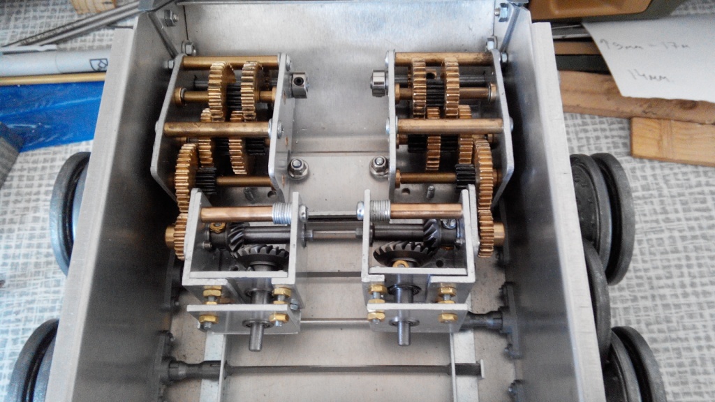

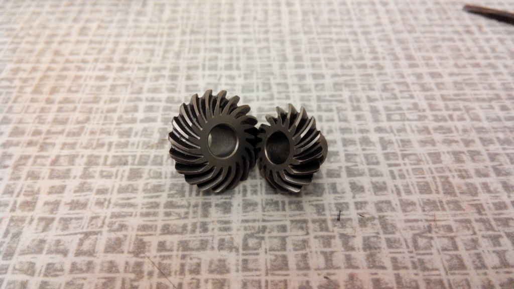

I was going to adopt the gear boxes that I had an looked for ready made gears.
Shaft, gear sizes number of teeth and modul became a problem.
Also the wear factor on small bevel gears is not so good.
All up Mick it is a mine field.But there is always a way,just finding it.
Kostyanchik
Posts: 63
Joined: Wed Dec 13, 2017 3:37 pm
Location: Russia, Moscow
Post by Kostyanchik »
Son of a gun-ner wrote:I'm thinking like this.
Making an adaptor to turn the motors 90 degrees between the gearboxes.
Using two bevel gears the same size wouldn't change the final gear ratio much. And wouldn't change it at all if they had the same number of teeth as the pinion. Although, having a bigger bevel gear on the pinion shaft than the one on the motor shaft would raise the final gear ratio at the sprocket, giving lower speed and higher torque.
And therefore raising the adaptability of standard gear boxes.
Also, you never know, if this idea worked, people may want to buy them from you ;)
I hope my sketches make sense.
Mick.
I did a similar design, it is not reliable. The speed of the motors is very high, the bevel gears are not designed for such high speeds. We must first reduce the speed, and then apply torque to the conical gear.
Later I refused this design.
using translator

Hi Mick a very good sketch and a very good idea. Finding the right gears it could work.
There mite be hope yet.
Thanks again .
Walter
walter
Posts: 567
Post by walter »
Kosyanchik has displayed a very good design and execution.
The one problem in tanks is there is not much space inside. By adding that extra length plus the motors would need some room.
