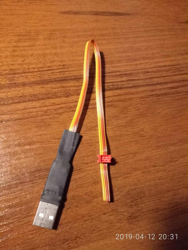

??????? ??????? ????? . ??? ???????????? ???? - ??????????? ?? Benedini. ??? ?????????? ?????? ? TBS Mini. ??? ??? ???????? ? Dasmikro. ??????? ?????? - ENG \ ??????????\ ??????? ?????- VCC \??????\ . ??? ?????????? ??? ?? ? RX . ?????? ? Dasmikro 3 ??????? ?? ??????. ????? ?????? ??????????? ? ???????

MISHA 55 wrote:Good day . Here is the original cord - programmer from Benedini. It was preobreten with TBS Mini. How to grow it with Dasmikro. Extreme right - ENG \ brown \ extreme left - VCC \ yellow \. How to determine where TX and RX. Why Dasmikro has 3 wires on a cord. What wire is missing and why?

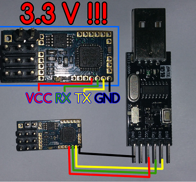

Hi Misha, I remit you for the third time to the diagram posted at the very beginning of the thread.
In case you did not understand it because like us, you are using google translate, I put the diagram here for you.
Again, for what it costs, (less than two euros free shipping) you should get a FTDI programmer from ebay /aliexpress / your favourite chinesse source, and wire it following the picture.
If for some reason you dont want to build your own programmer cable, you can still use the original benedini programmer. If you remove the heatshrink tube you will probarbly see were goes each wire. Im pretty sure the usb plug has the name of the connectors written. I guess the conection is exactly the same as the benedini mini.
Again if you take a look at the picture I uploaded you can see it has 4 wires. But only 3 are needed. The one you can discard is the VCC as long as you have the board connected to a battery. If you dont want to connect the dasmikro to a battery, you have to wire the VCC too.
Hope it helps.

I just use the three wires on the right hand side, no need for VCC. As long as the FDTI board is connected to the esc/rx via the Y lead and the power is on, the board is powered without a battery.
Rad_Schuhart
Posts: 2089
Re: Dasmikro (TBS Benedini clone)
Post by Rad_Schuhart »
wibblywobbly wrote:I just use the three wires on the right hand side, no need for VCC. As long as the FDTI board is connected to the esc/rx via the Y lead and the power is on, the board is powered without a battery.
Well, that is what I mean, if you dont use the VCC wire is because the Dasmikro is powered from somewhere, usually a BEC from an ESC, which are connected to a battery
The dasmikro should not be powered with more than 5 volts or it will be destroyed.
The FTDI usb does not need an extra power source, just the USB is enough.

Hi. Do not buy the dasmikro programmer, because it does not work. It comes with fake chips that your computer will probably not recognice, and also comes bad wired.
The USB FTDI board I am telling you is less than 2 euros free shipping aliexpress.
The reason of spending 2 euros in that board instead of manipulating the benedini mini cable, is the risk of damaging it. If you damage the original cable and then you buy another one, it will be about 40 bucks when you add shipping.
If you damage the ftdi board (which is very unlikely to happen) it will be only two euros.
