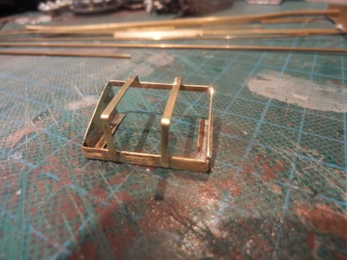

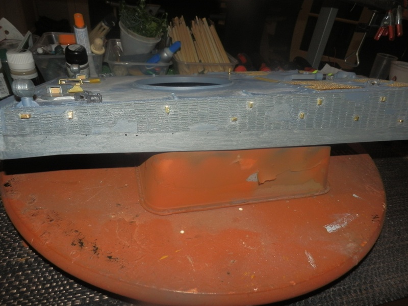

Decided to create a tool box mount for the left rear hull plate, as if the tools normally sent to field with one of these has been removed & sent away to a combat unit from Fallingbostel training school.
Began with cutting a section of flat brass sheet into the site panels.
Then used angle for the support arms.
Solder pasted them together for both side profiles.
Another section of angle to join the halves and a flat bar across the rear.
Now I did get a bit flash & began making the retaining straps actually function, but I had the epiphany after winging myself with a razor saw cutting hinge tube and soon pulled the pin on that frivolity !!!
I just want a representative tool box mount that can look ok & stand up to a bit of bashing .
Just short of working retaining straps!

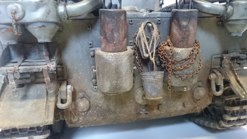

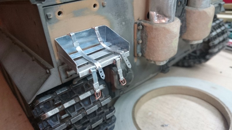

Now, that's the ticket! Those "little things" really make a big difference, don't they? Lovely work and as always, Mr. Bix, nicely conceived and executed. Here's a similar take on the idea:

Your tool box holder is a magical effort mate.
I actually thought I had to stop on mine before it got to detailed !
This thing is going to be a rough-n-tumble unit so excessive detail will get a pizzling.
I have some aluminium strip that I cut into straps like yours but I pulled up and made simple brass ones that represent rather than replicate before I went too far !

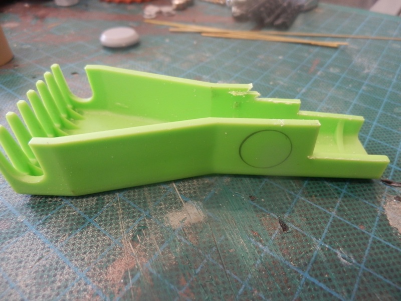

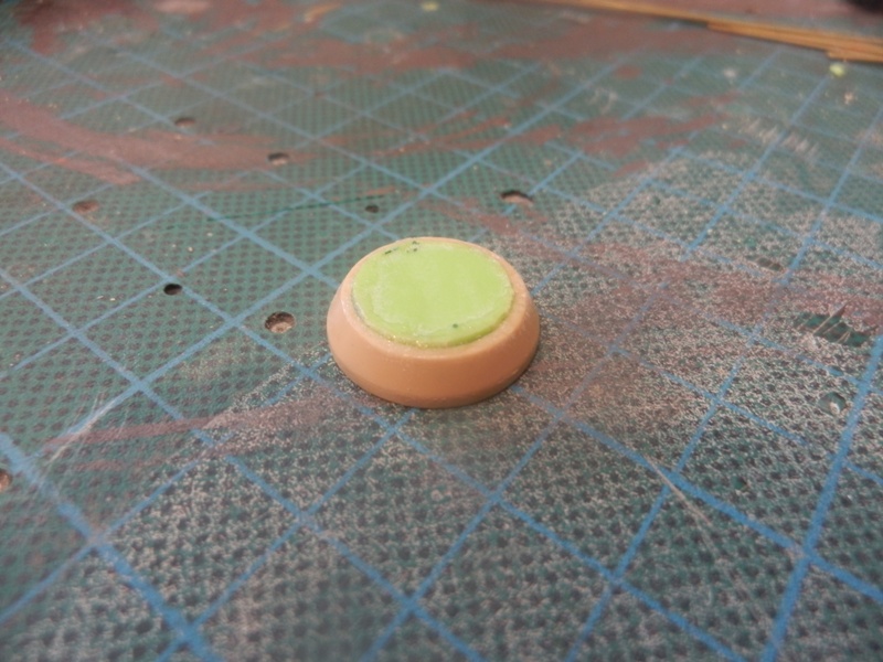

I got the track towing cable retainers onto the hull side(which will remain empty) and then set about making a drivers roof vent which is missing(and hiding in plain sight as I completely overlooked it! :{ )

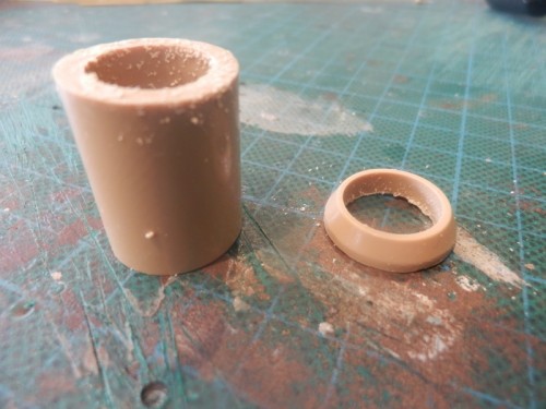

Believe it or not, a Tiger mantlet barrel tube is exactly right to make the vent !
Sliced the tapered section off and sanded it to look about right.

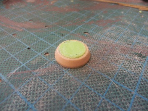

Used a couple of bits of plastic floor sweeper handle cover to fill the hole and close in the vent.
Gel super glue to retain the infill sections & Daphne's ya transgender uncle !!
I just need to sand the top of it to conceal the joint.
