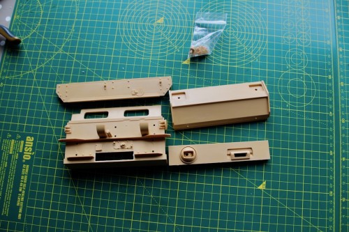

To my utter astonishment, this little bundle of Tamiya bits has just winged its way from Hawaii, in a time that would put Amazon deliveries to shame (those from 'Luxembourg', or 'via' Luxembourg in theory..more like)..
So, that's all the way from the middle of the Pacific, to one of the remotest parts of Scotland almost as quick as Royal Mail's 'snail mail' small parcel service. Captain Cook would have been most impressed..
Tamiya panels from Hawaii...
I can only reiterate my gratitude to Mike (Sassgrunt) for taking the trouble to seek these hard-to-buy parts out, and mail them to me. :clap: The packaging was incredibly neat too, almost equal to Apple's standards :thumbup: Perhaps we should have a star system for rewarding forum members for the best solution to problems, the Thread of the Month, or just for simple acts of kindness. Anyway, Many thanks, Mike...donor of the Month :clap: :thumbup: There must be a modelling Knighthood out there waiting :lolno:

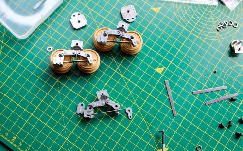

If you want a decent Pz IV, then I'd advise you to buy Tamiya's suspension for it, whether your kit is from Trumpeter, Taigen, Heng Long...or even.. er..Tamiya :lolno: Put simply, it's precisely engineered, and fabricated out of good quality materials.
Look at these examples:
This is what a suspension bogey looks like after the spring has been secured by a 3mm grub screw, and some thread locker (Tamiya type). The next stage is to lift the assembly onto two road wheels, ensuring that the 'D' profiles of the stub axles
engage with the 'D' shapes in the rocker arms. The two cover plates are screwed in place to prevent unwanted dislocation under stress (and I know all about that 8O :haha: )
Tamiya suspension basic layout
and here's the bogey ready for fitting ..
Clean cut fittings..Tamiya Pz IV bogey
I really like the fact the the axles in the road wheels have two bearings per wheel, and that the shaft is locked to the bogey by matching flats machined on the spindles. The woeful Taigen kit has nothing like it...
and..no..Shaun, I'm not in receipt of a backhander, nor gratuity, nor greased palm, from Mr Tamiya San for making complimentary observations about his suspension systems! Don't forget how disappointed I was with the insubstantial, nay flimsy even, feel of the
KT Turret and upper hull :|
