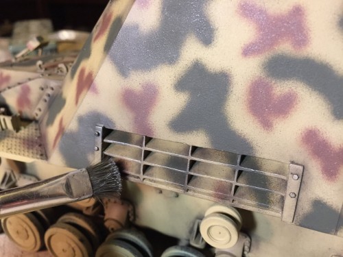

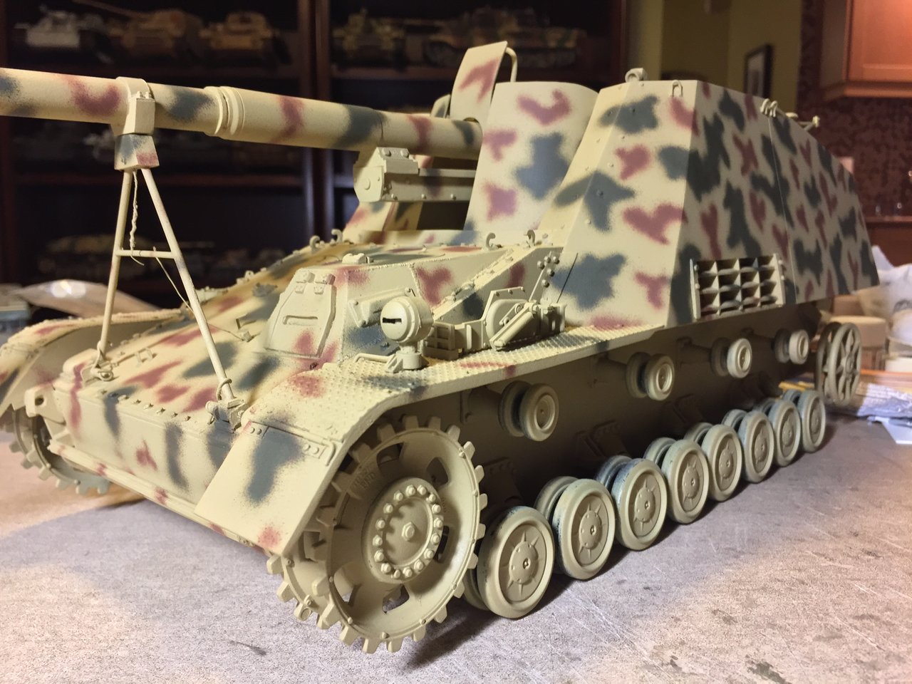

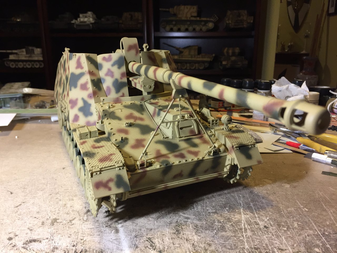

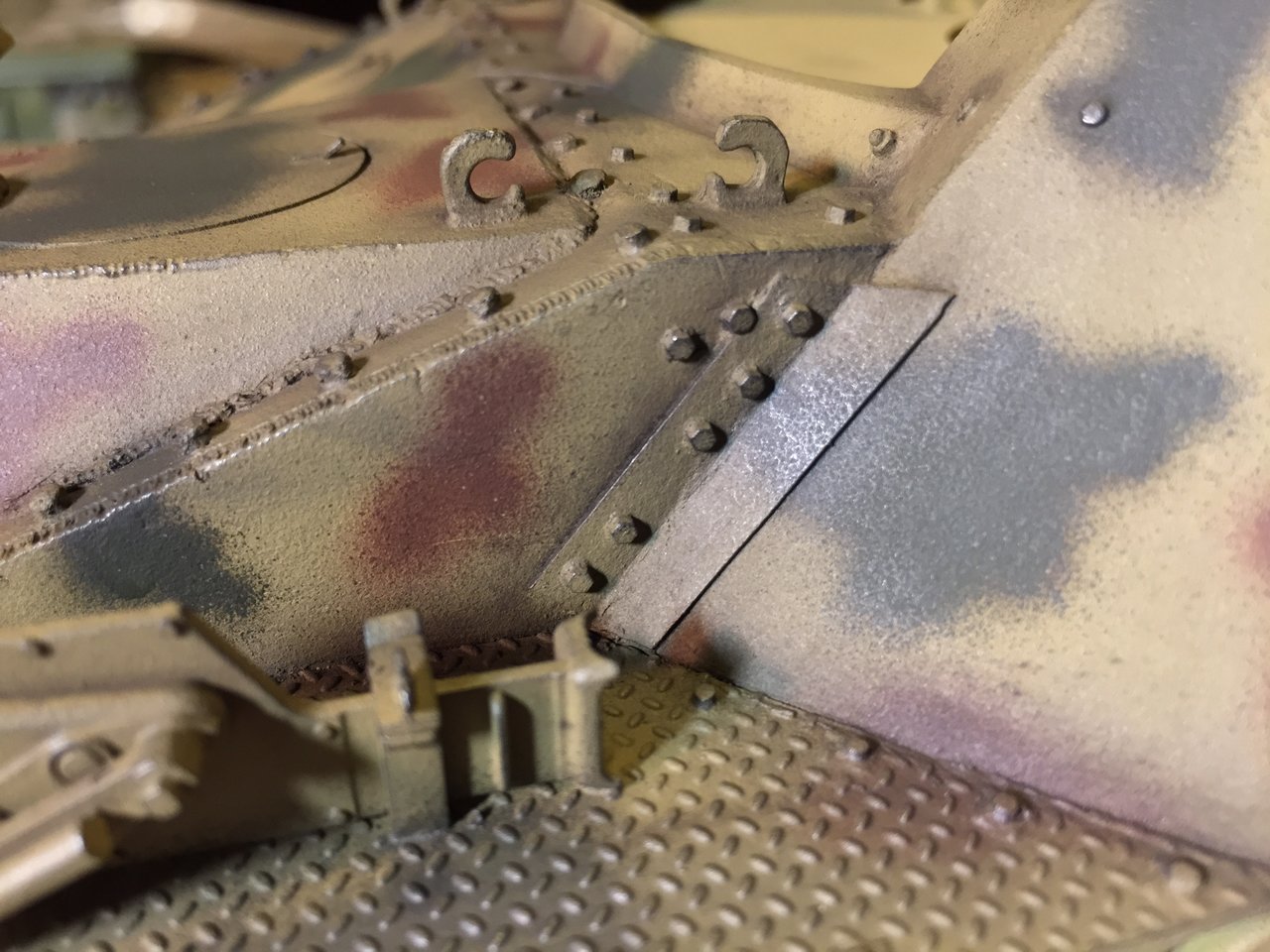

As you can imagine, I am in the middle of a big painting and finishing operation. Here is a situation report.
In these 2 pictures, I have given the camouflage to the model. From the wartime pictures and references, Nashorn crews seemed to have been given a lot of liberty in the attempt to disrupt the main lines of their boxy tank, some with more success than others. I have chosen a style that is different than my other German tanks. At one point, things need some variations.

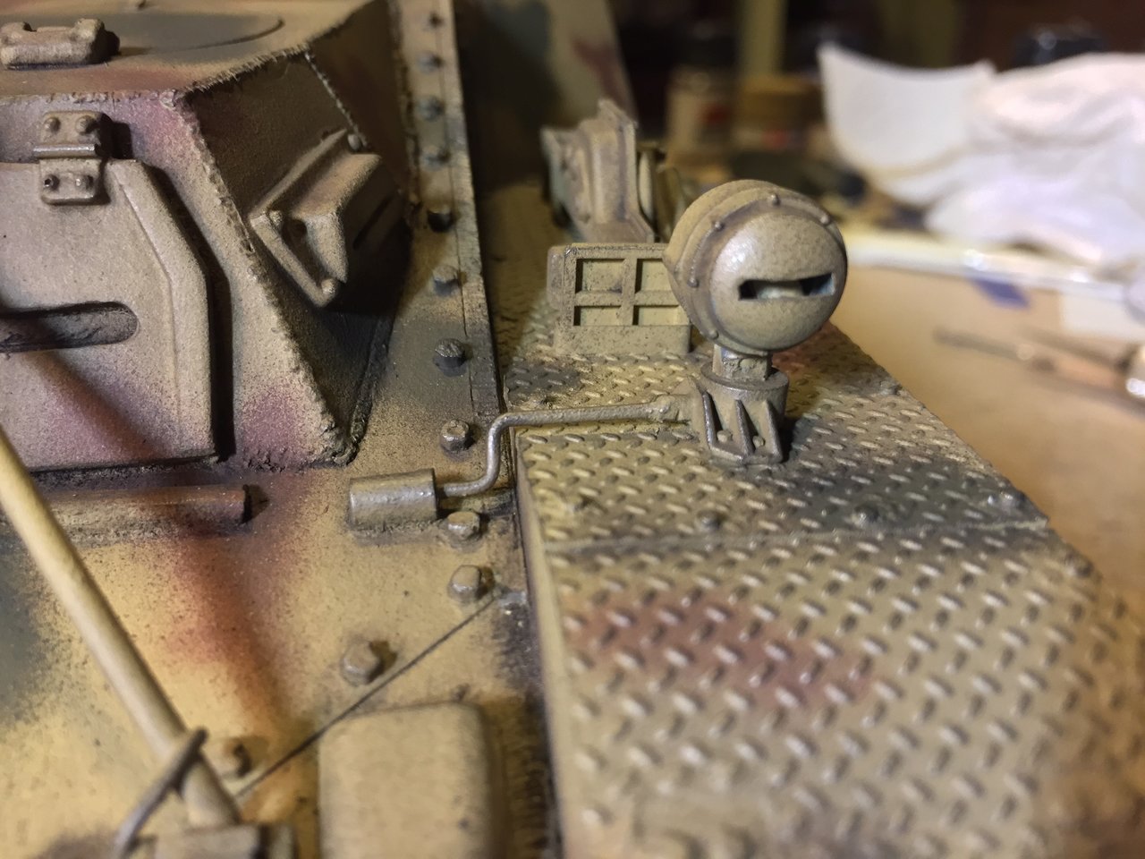

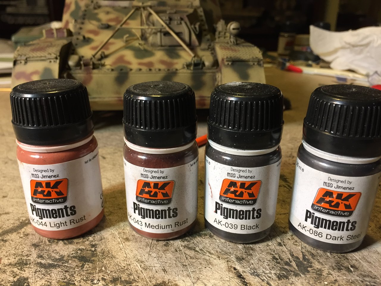

After painting the main components, the next step is to put on the dry pigments. In my view, these are the best things that happened to modelling in the past decade. I will use 4 colors; Black, Dark Steel, Mid and light rust. These work for me.

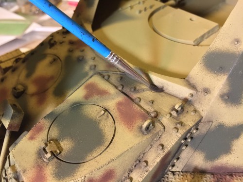

Using a hard brush, my first step is to drop and gently brush some black pigments in every corners, cracks, whatever is lower than something next to it. Got to do this everywhere.

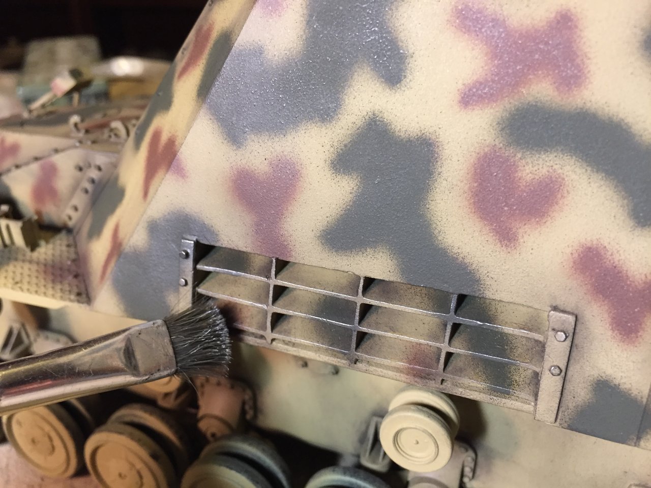

Using a wide bush, the next step is to brush the tank with Dark Steel pigment, all over, with a focus on raised areas. It gives the tank that metal look that I personally like to see.
Do you remember how the air vents used to look like ?
I am satisfied with the results so far. I find it interesting to see what 10 minutes of Dark steel dry brushing can do to the look of a tank.
Next to do is the gun and fighting compartment interior, then the lower hull. I still have a lot to do.
Regards, Louis

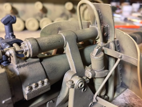

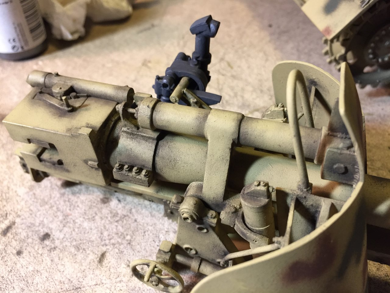

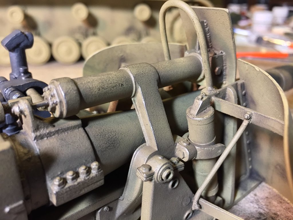

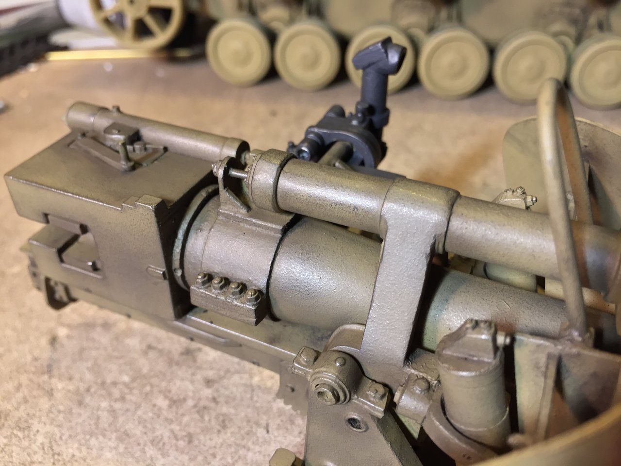

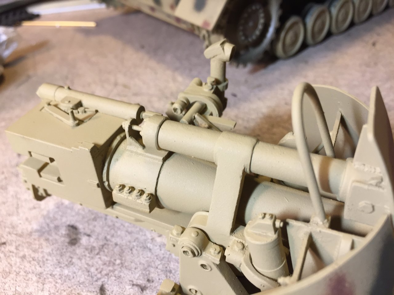

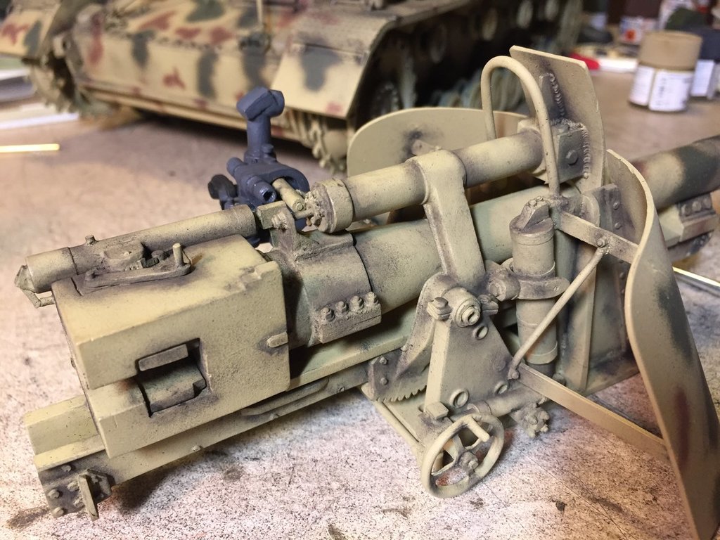

The gun has been done.

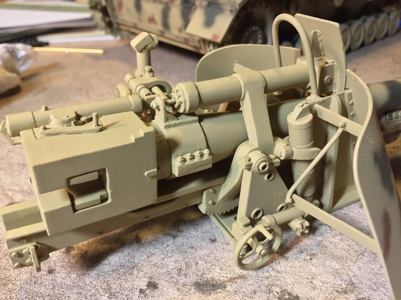

In the 2 pictures below, a basic coat of Dark Yellow acrylic has been applied. It is not weathered and does not look very good with close up pictures, well not good to my taste.

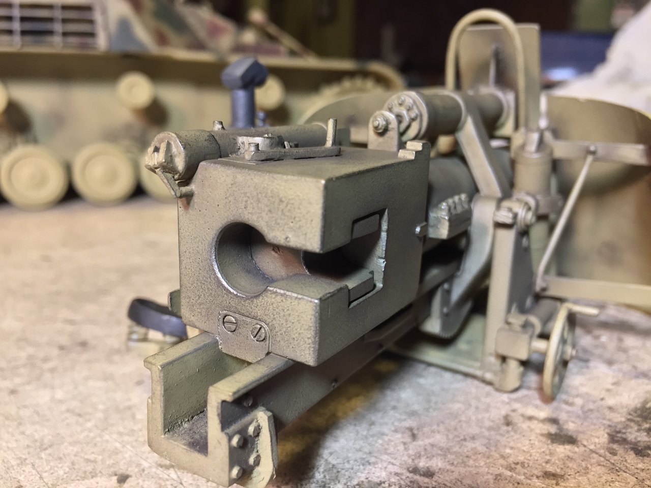

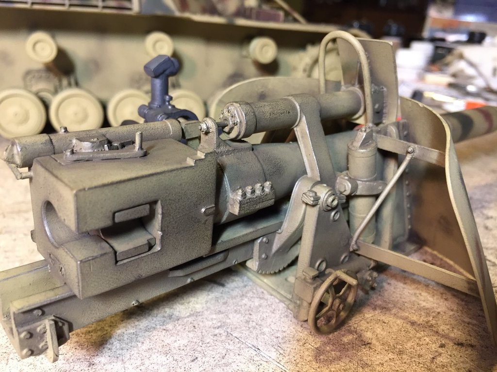

In the following 2 pictures, some black pigments were applied to lower and joint areas, but not good looking either.
Now, the gun has been dry brushed with Dark steel pigments which blends the black and steel pigments with the acrylic paint. I think it give the model some history, a worn and mean look, some depth and brings out the details. Overall, the pigment job took 45 minutes and only requires basic skills, which is my case regarding painting.
Regards, Louis
Regards, Louis
Re: Juckenburg Nashorn
I have to say the combined effect is astonishing. You were right, the black pigments alone weren't giving the convincing look. But the steel works out fine and makes it look right.
