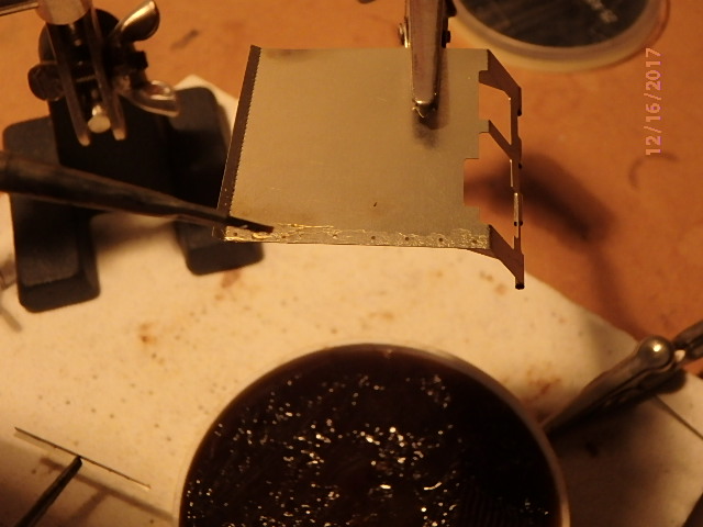

Hi Guys,...Hope yawl have a Merry Christmas and Santa brings you some nice toys!!! :thumbup:
This next entry is rear ABER rear fender assembly....Might be a bit dry and monotonous for some, :crazy: but for me, the more details the better ;)
My soldering is kind of on the sloppy side and needs some fine tuning, but I will work on it.
Bottom fender braces
Tanks a lot,
Burger_Patrol1
Brea, CA. USA ;D

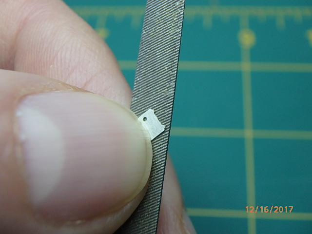

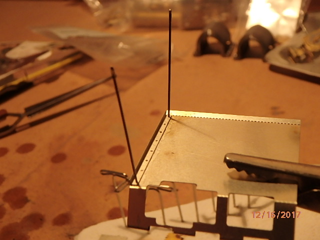

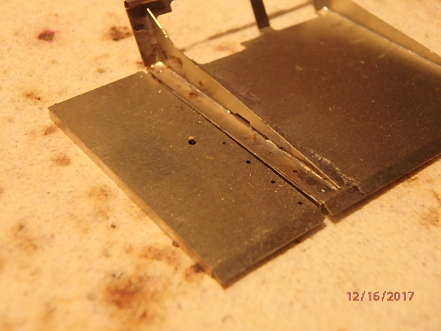

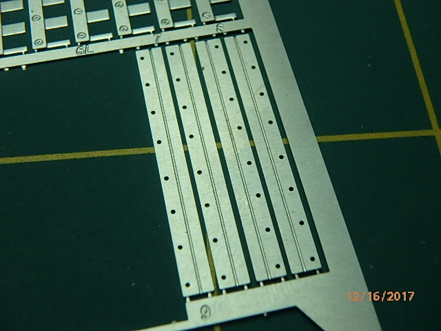

File down sprue flashing smooth.

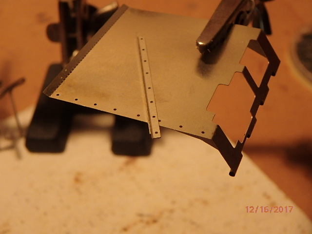

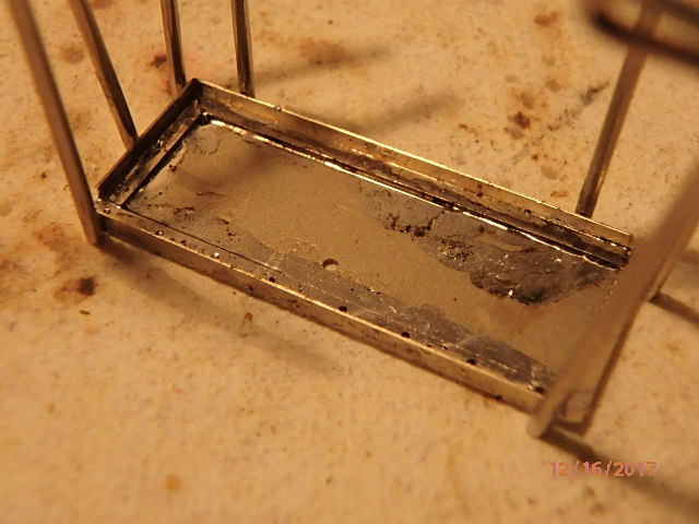

Bending supports on brake
Repeat bending
Repeat bending
Ready to solder in place

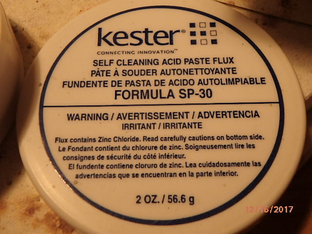

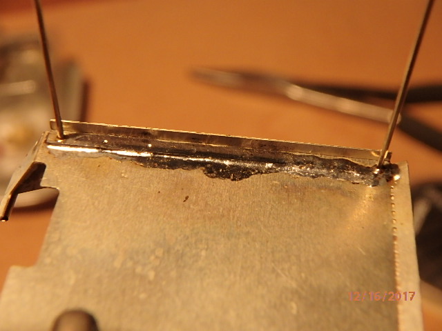

Lester self cleaning acid flux
Flux where solder joint is to be.

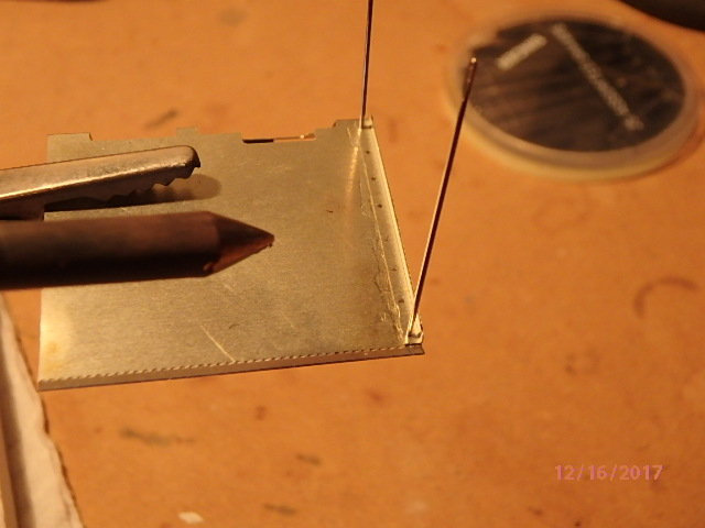

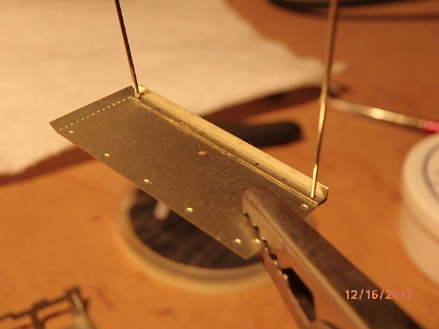

Pinned in place
Pinned in place
Rear mud guard extension supports

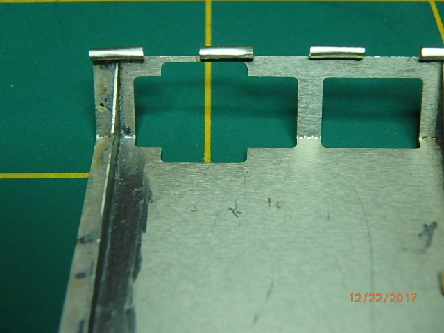

Ready for Hinges to be installed

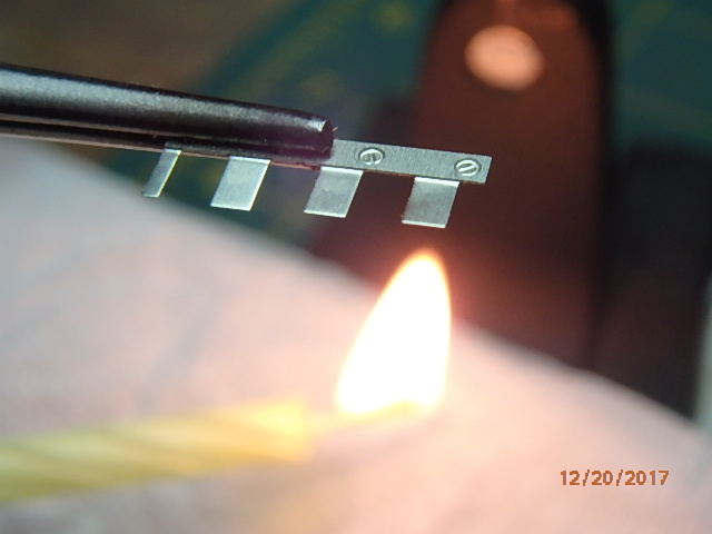

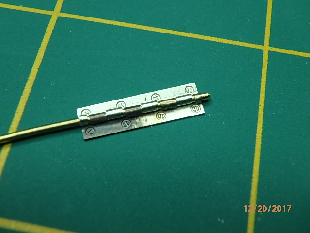

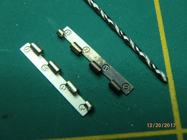

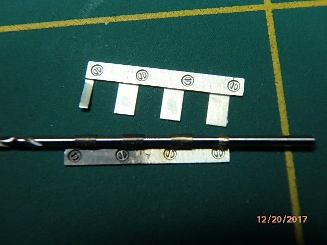

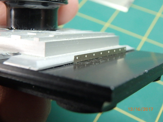

Time for hinge rolling.
Anneal and heal!!!
Anneal and heal!!!

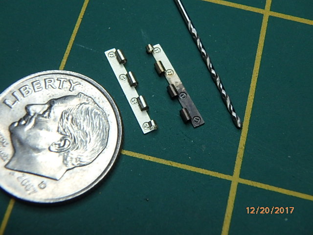

Roll on micro drill bit
Scale sized
Scale sized

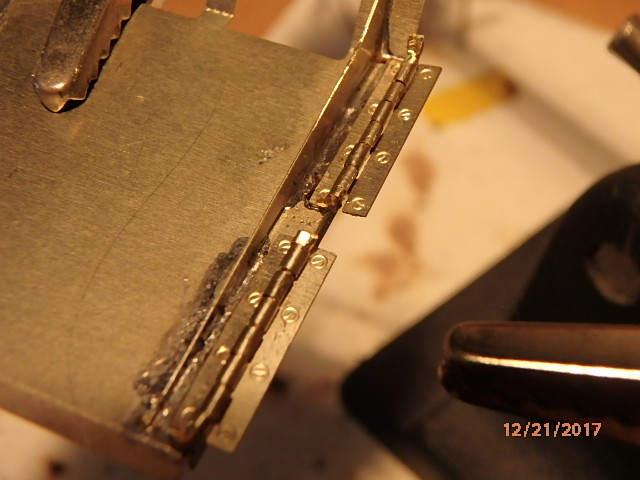

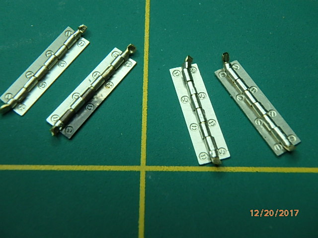

Brass rod for hinges
Perfect fit
Perfect fit
X 4
X 4

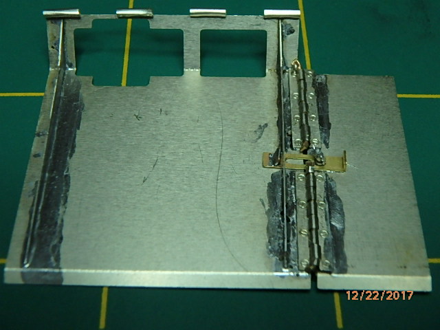

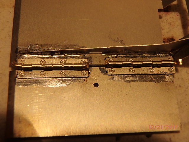

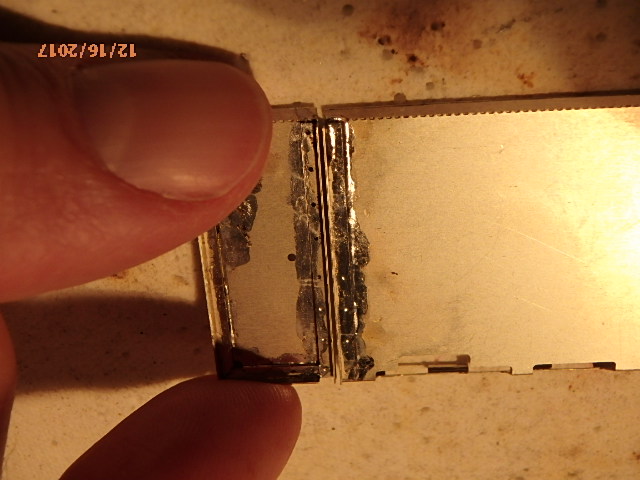

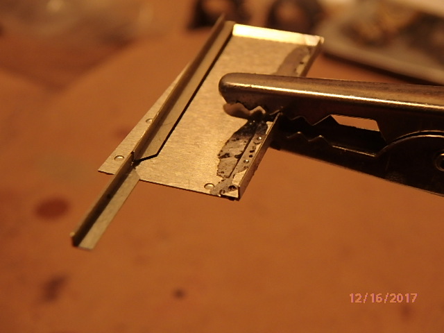

Soldering hinges on main rear mud guard
Mate side extension on hinges.

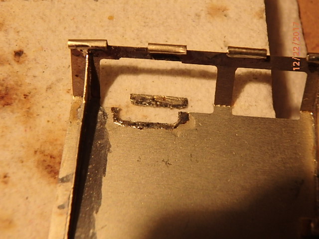

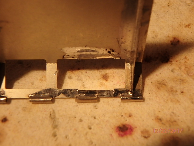

In my Haste to get mud guards fabbed up,... I over looked that this is an earlier Tiger 1 Mud guard. :( Since Im trying to make a late version Tiger 1,... I had two choices...Order the right ones and start over or customize these so they look close. I opted to modify these, so I didn't have to spend the extra money and start over. I saw on Amazon, one guy has these late version mud guards listed at $99 american. 8O Thats highway robbery!!!! :crazy: So onward to modifying....
Notice upper and lower notches in Mud guard. Should be just a rectangle for later versions.
ABER Late mud guard kit. Notice Notch differences.
LATE FENDER KIT.jpg (36.8 KiB) Viewed 3738 times
Cut a piece of brass sprue and shaped to fit in notched area.
There, ....now its a later model mud guard...LoL
I will also have to modify the attachment of the fender to the rear hull when the time comes to install...

Are you using an iron or a torch for soldering? I know quite a few members here swear by solder paste, but if you're applying flux are you using solder off a reel?
