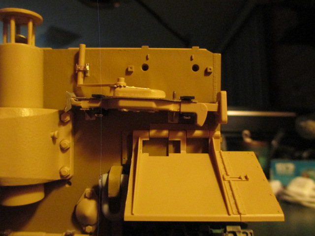

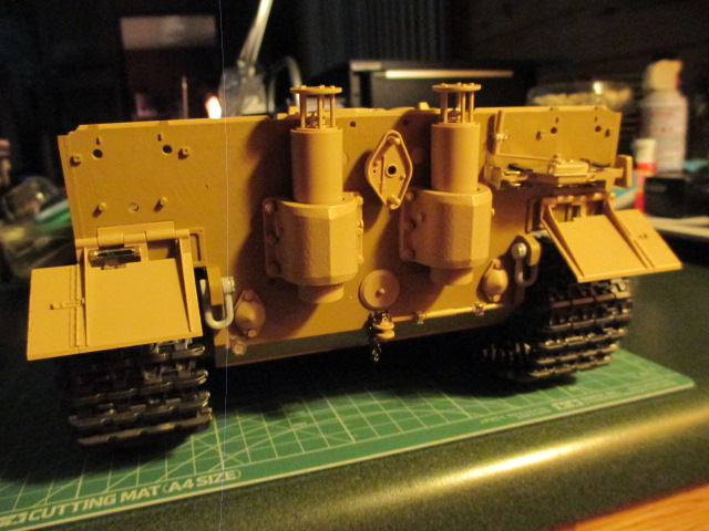

Continued from Above:
- Note the ABER mounts for the Jack are in place.
- Note the ABER mounts for the Jack are in place..JPG (92.56 KiB) Viewed 3901 times
