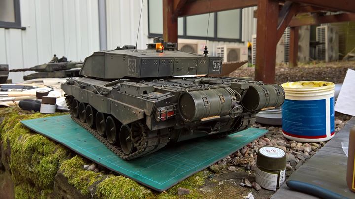

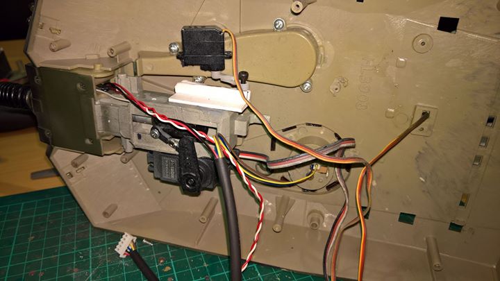

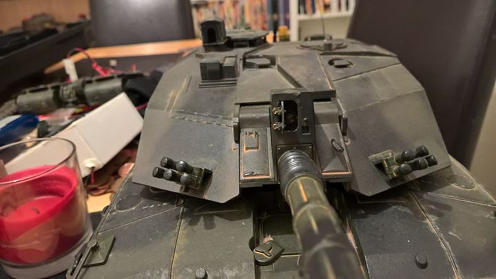

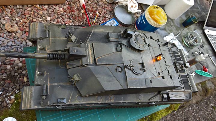

Well been a while since I posted! Saved some money to upgrade the challenger, so first job was to mount the IR bulb in the tog and hinge the door here are the results-
As you can see full servo control of turret and added warning beacon too turret so wiring jungle in there!

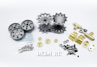

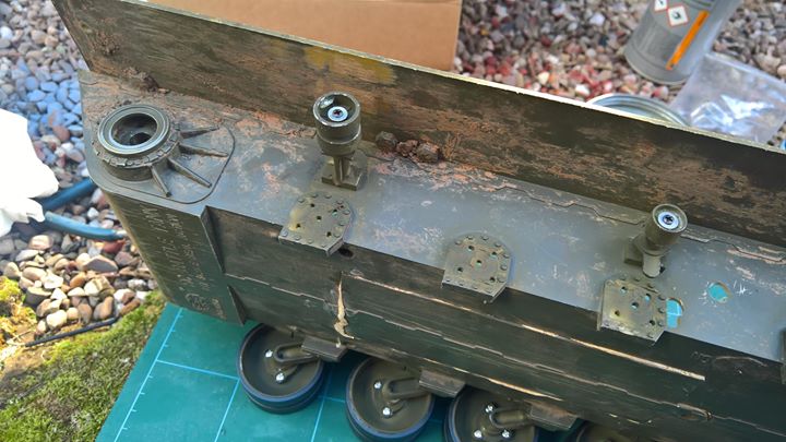

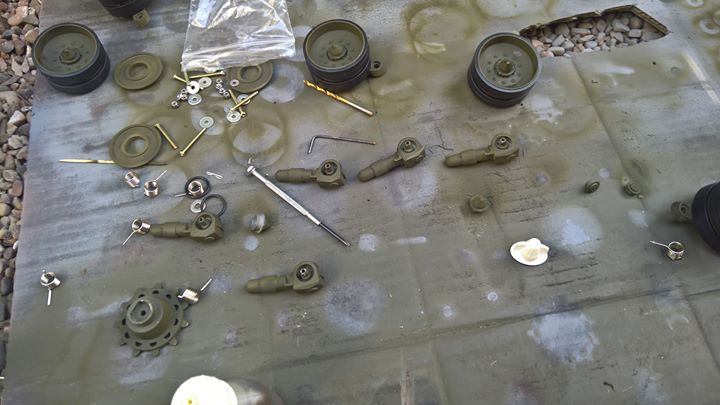

Next was time to fit metal road wheels, sprockets, idlers and return rollers I had ordered from forgebear, these are actually DKLM ones and proved to be more time consuming to fit than I anticipated! But they are quality items. First off strip off the old wheels, suspension etc
You have to snap off the old plastic hydrogas assemblies and grind off the little stump of plastic left, also shaping them off leaves the mounting pins left in some and some bits still glued on so you have to bring the area flat and re drill the holes-
The time for a base coat of grey primer and then Tamiya olive drab

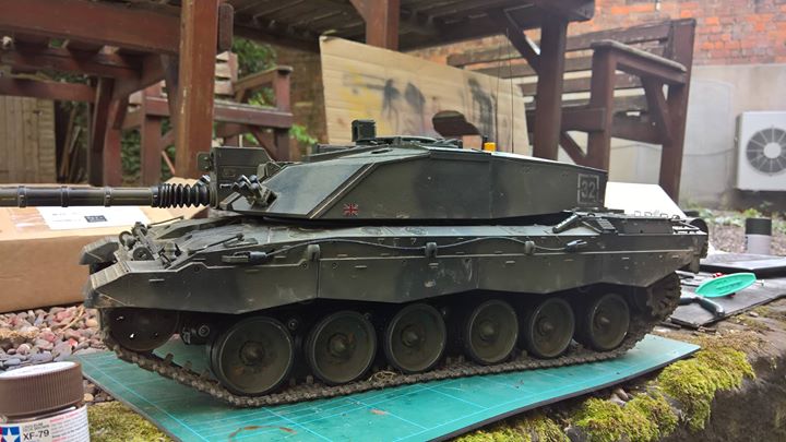

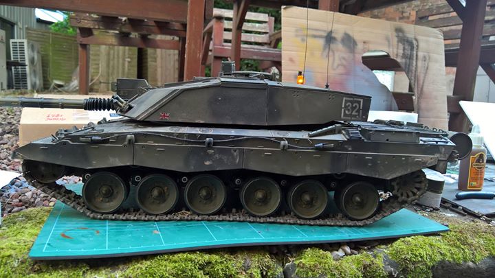

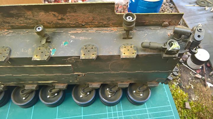

So here's the results, sorry no photos of assembly of the suspension as was busy building! One thing to note is the drive sprockets will need drilling out for taigen gearboxes, the tank now runs alot smoother, just waiting for my mato metal tracks now!
Just got to filter and weather now, then metal tracks and whatever else comes to mind!
