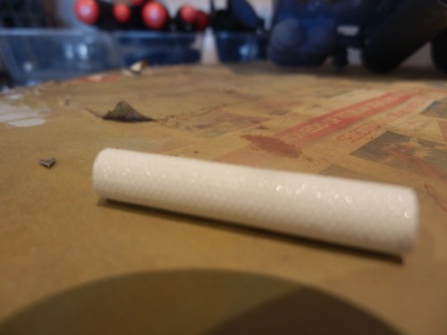

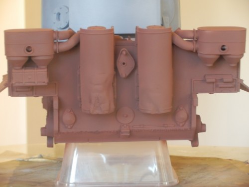

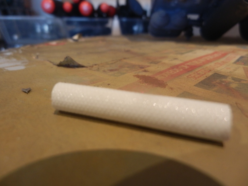

I tried another picture of the air intake ducting 'stuff'. Its fibreglass, woven, and as flexible as rubber. I have enough stuff to do TEN tiger air intakes and all for the princely sum of $6 bucks .

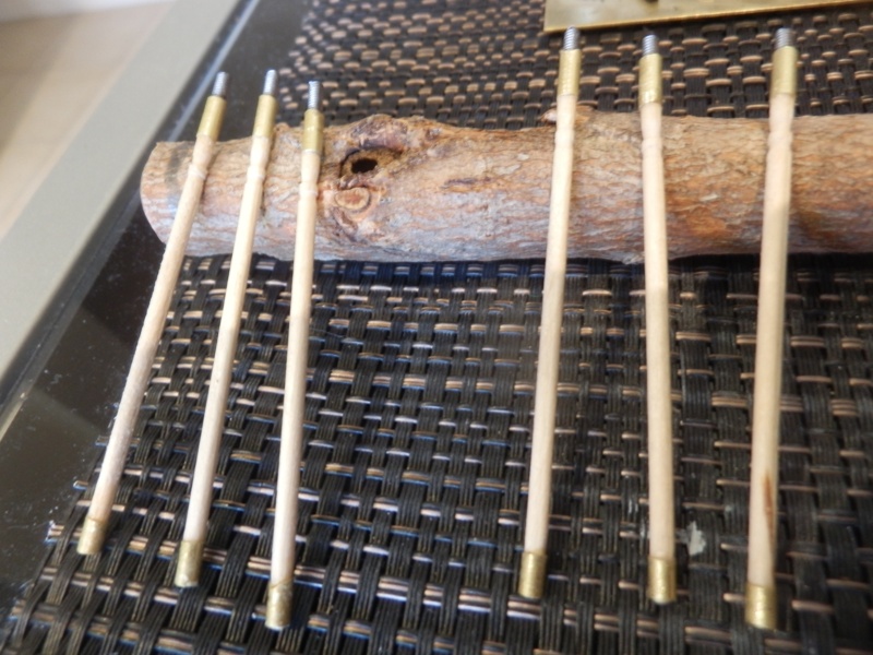

The barrel cleaning sections took a long time for so little tangible gain, but I am very happy with the final product. Best thing is they can go on the deck last, and be stained using good quality fence stain.

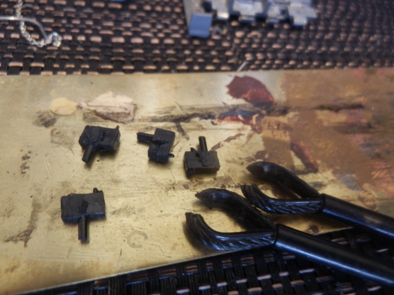

The tow cable clamps were a bit more involved than hoped, but after trimming the fat off the stqck cable mounting mouldings, drilling a hole and splitting them, they will do for the loops on the engine grilles. The eyes of the cables will be of a different system.........again not sure on how, but some form of representative clamp will need to be made.

Cable clamps for the loop over the grilles
Barrel cleaning sections - just - why ??

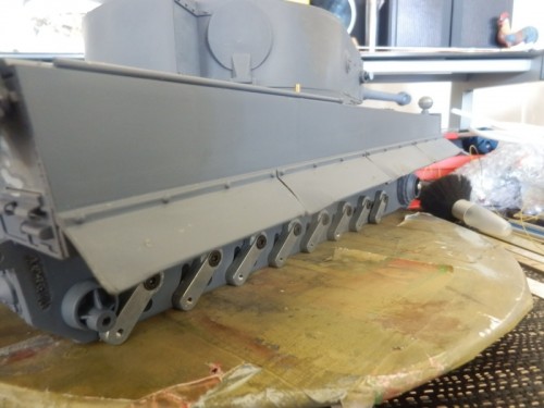

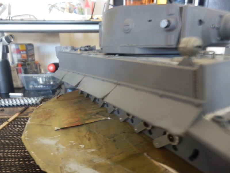

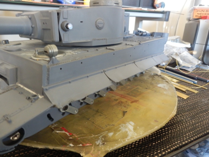

A bit more forward momentum today. Tried to match the wrinkled mud guard as visible in the subject picture. Used ole Jamies' brulee burner and gently formed the deflections with a piece of round wood. came out ok, used a bit of free lance interpretation on the off-picture side.

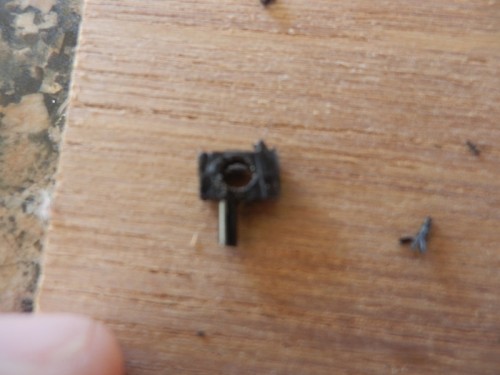

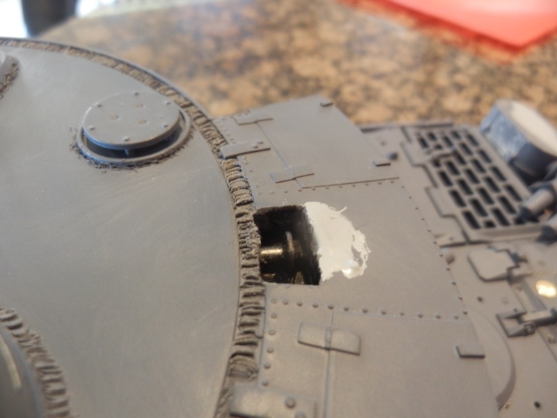

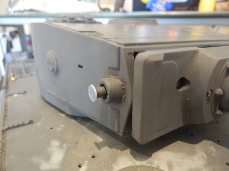

Decided I wanted the third lifting point on the turret inside the stowage bin centre..............(sigh) really should have done that while it was all apart. :/ But, I didnt and now it was harder.
Chain drilled the moulded patch that fills the gap & gently removed the leftovers. Of course the turret mechanism is under this, so caution was exercised !
Used a flat head nail with the shank cut on a sharp angle. Heated the sharp end with the burner until it glowed. Gently angled it into the cavity with offset long nose pliers and melted it through the turret wall just under the roof plate.
It was held in place & blown until I was close to hyperventilating, it took really well & apart from a small nick out of the 'bin' edge which can be fixed with putty & sandpaper, its a ticked off detail.

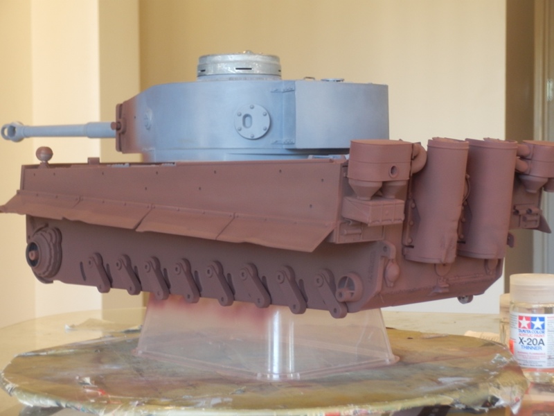

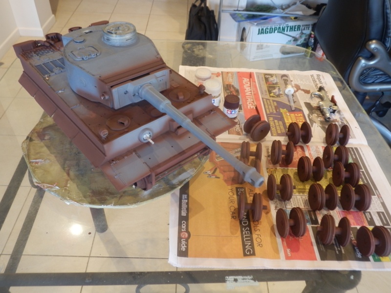

Got a bit more done late today. Its ANZAC day here so I was off out for half the day paying respects to the fallen folks that gifted myself & family a future. A mix of sombre & pride, with the burden of knowing I will see the next one in on the very spot that began the legacy ,on the centenary . No chance that one will pass without tears.
The Royal couple of Cambridge made an unplanned attendance at a Dawn Service, which added to the significance of the 99th Anniversary.

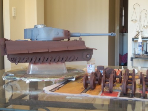

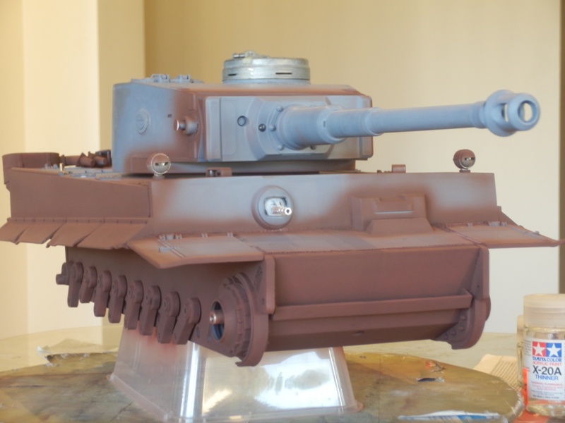

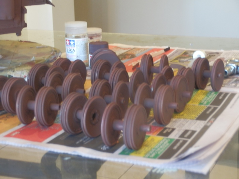

Hooked into the roadwheel set. Got the rubber tyres off & calmly thought to myself how quick & easy it will be to paint wheels(unlike the Jagd that had the tyres handpainted)............... :lolno: ...............they took longer , and used way more paint than I anticipated. I pre-sanded the sections of the discs that will face outwards and wiped all the production contamination off.
Used a very heavily thinned Tamiya hull red XF-9 to cover the roadwheels and lower hull.
I really think the kit German Grey was not a good undercoat for the red oxide primer despite all the sanding. But I wanted a thin coat so as not to cover any detail or predjudice the top coat.
I must give credit where it is due, thsese Tigers take a lot of covering. Far more than a Jagdpanther, and the nooks & crannies take a lot of time, paint & patience to avoid missing. More paint than I had in stock as it turns out. :O
You guys that produce such inspiring Tiger builds with accurate camo patterns need a huge rap............ :clap: :clap: :clap: :clap:
The shops are open again tomorrow, so im off to get more pots of XF-9.
I used the last mist of paint to cover the turret lifting points on the mantlet sides to see how they looked, much better with paint.
These will stay.
