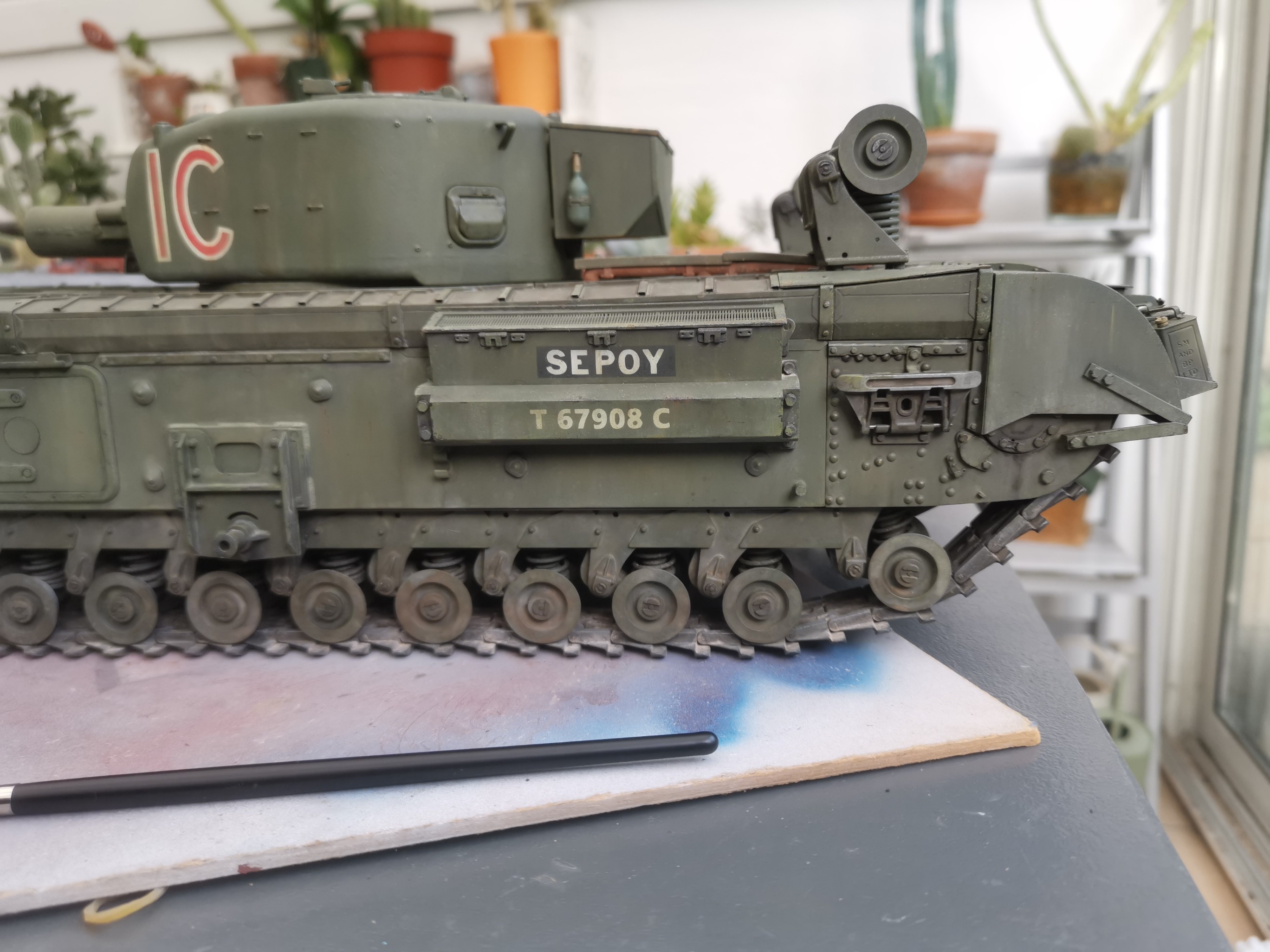

Thank you guys for the comment!
I think I'm not totally done with the weathering as I'm not really pleased with it...
And I'm not done at all with this build as I have started that...

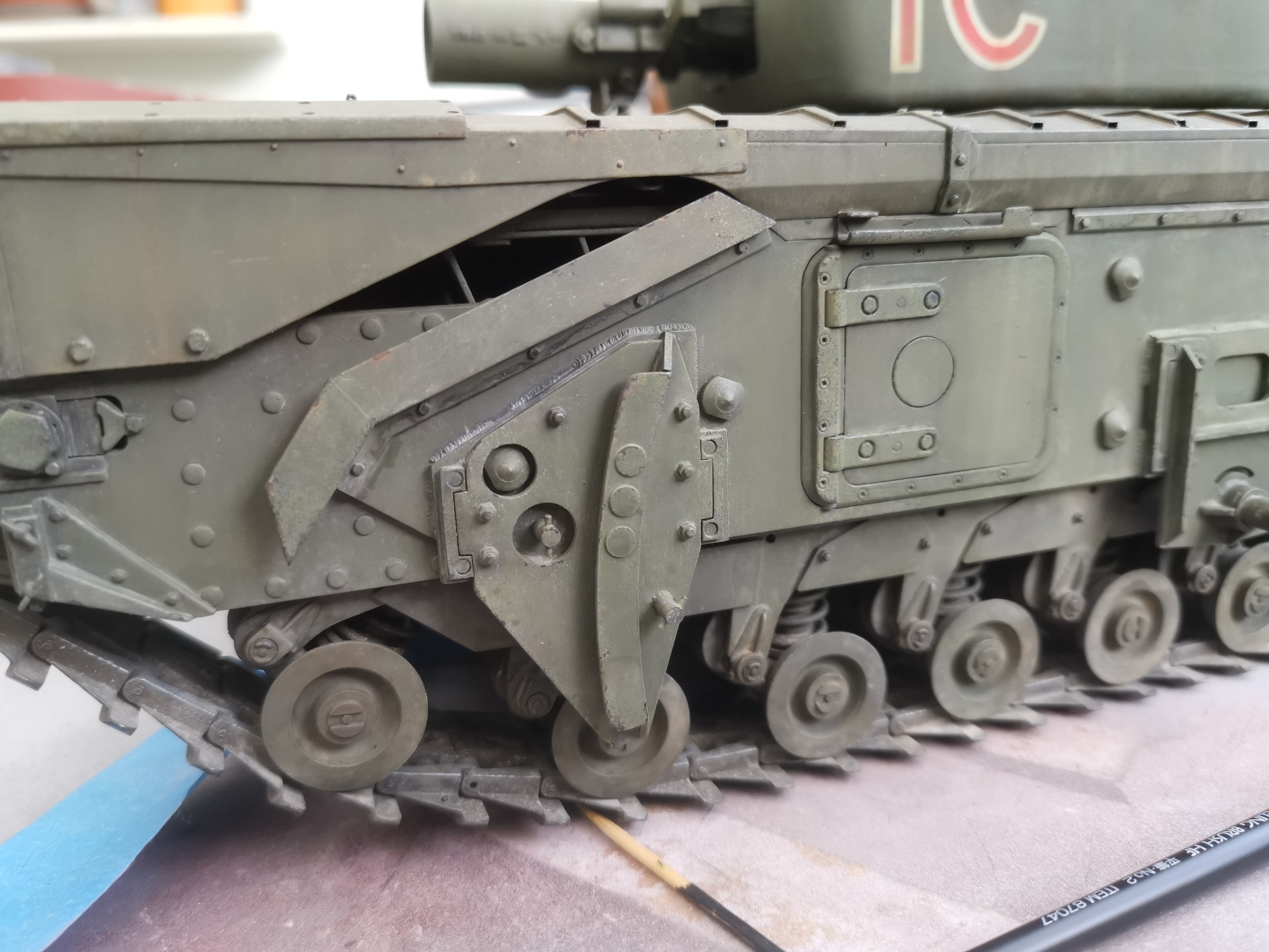

Haha yeah nice one! Not every tank has to be a mess! 😁

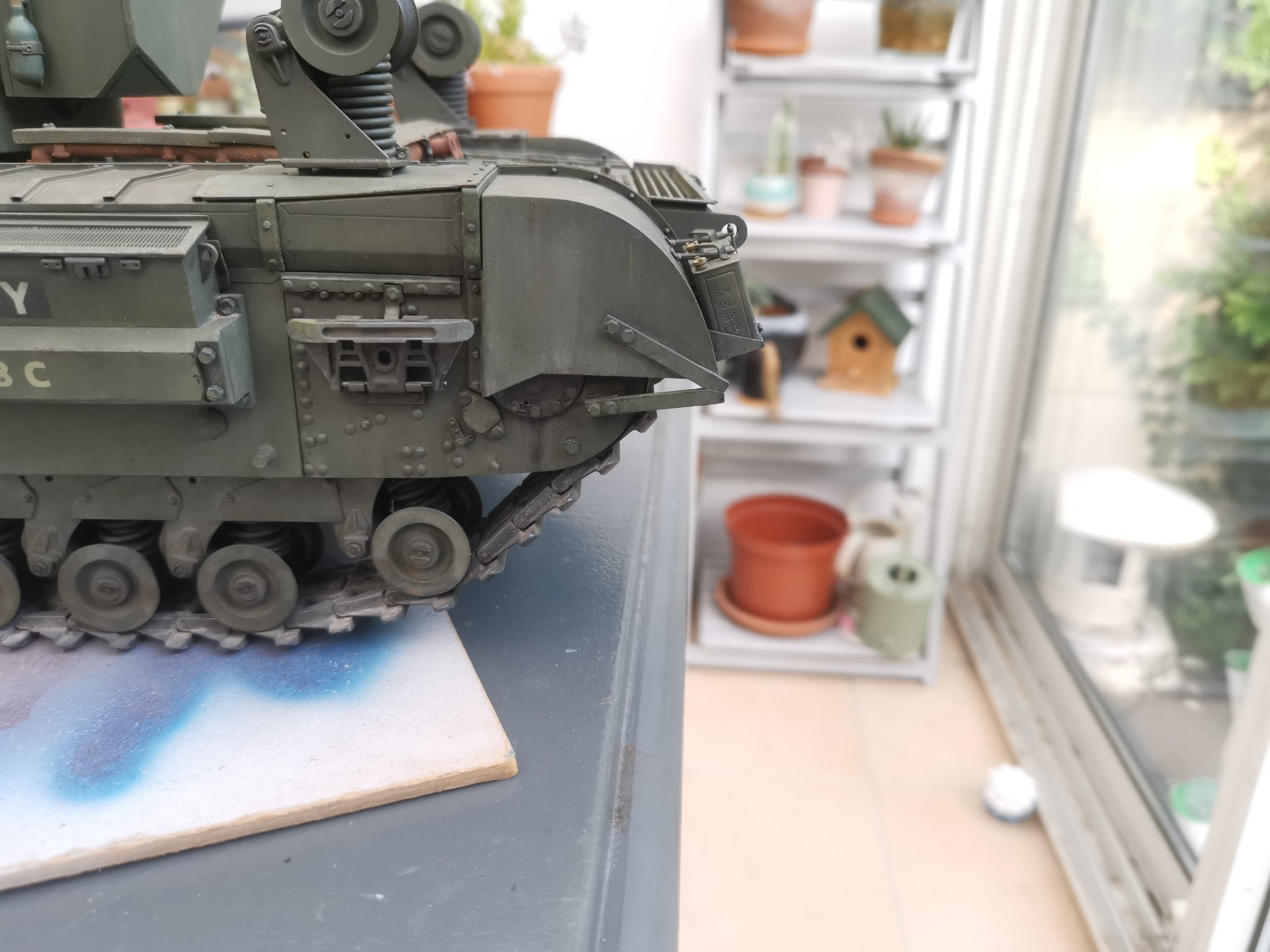

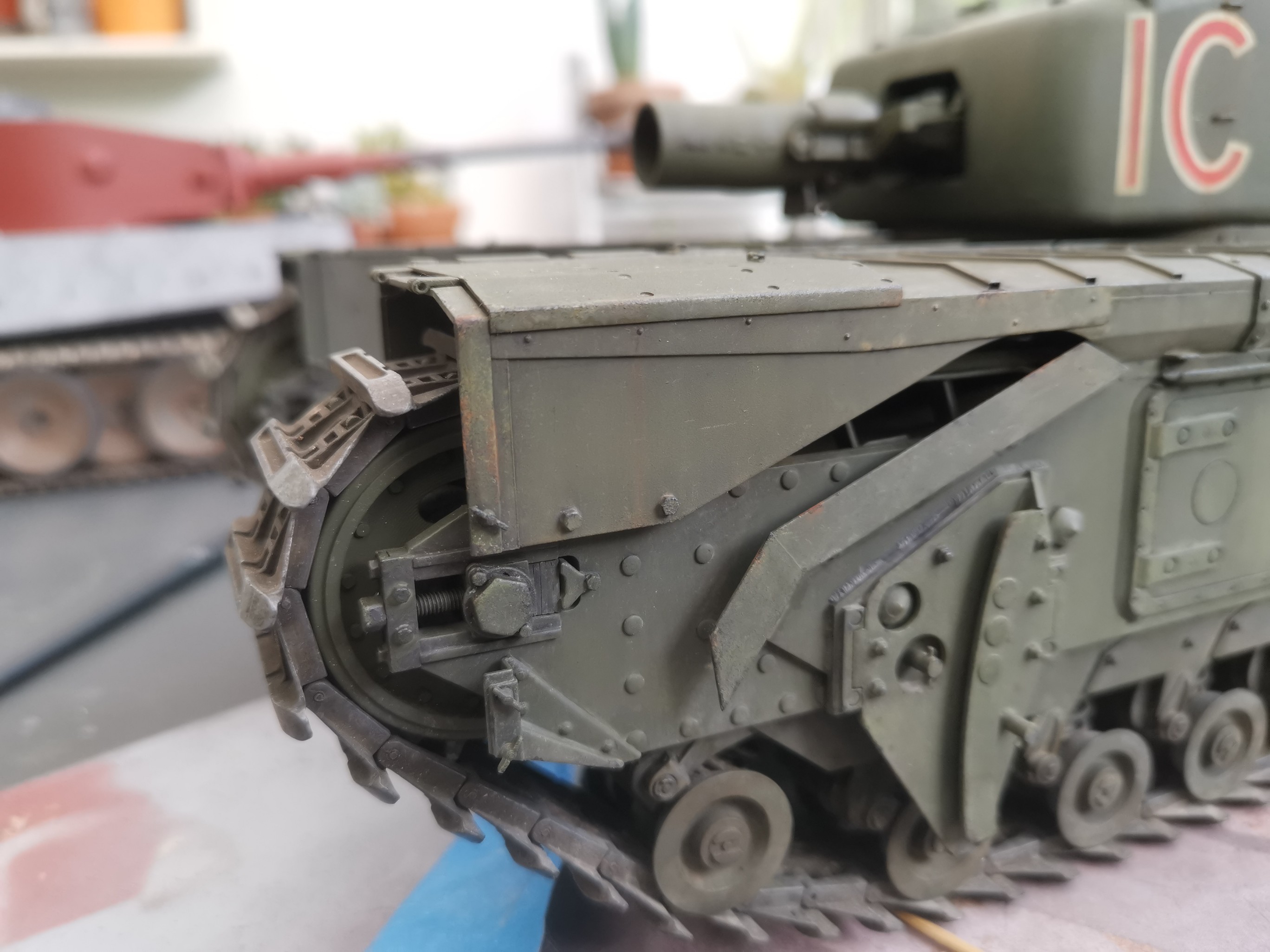

I have some pics I've never posted with a bit more dust on it :
My parts for 3D printing :

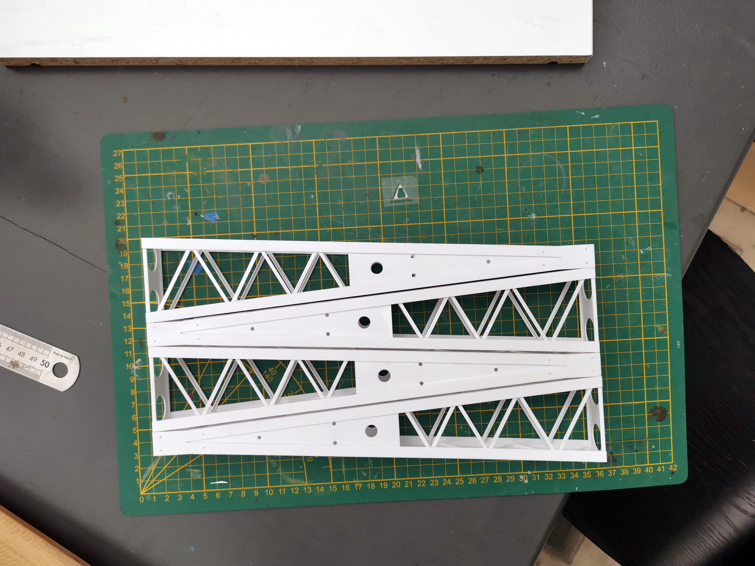

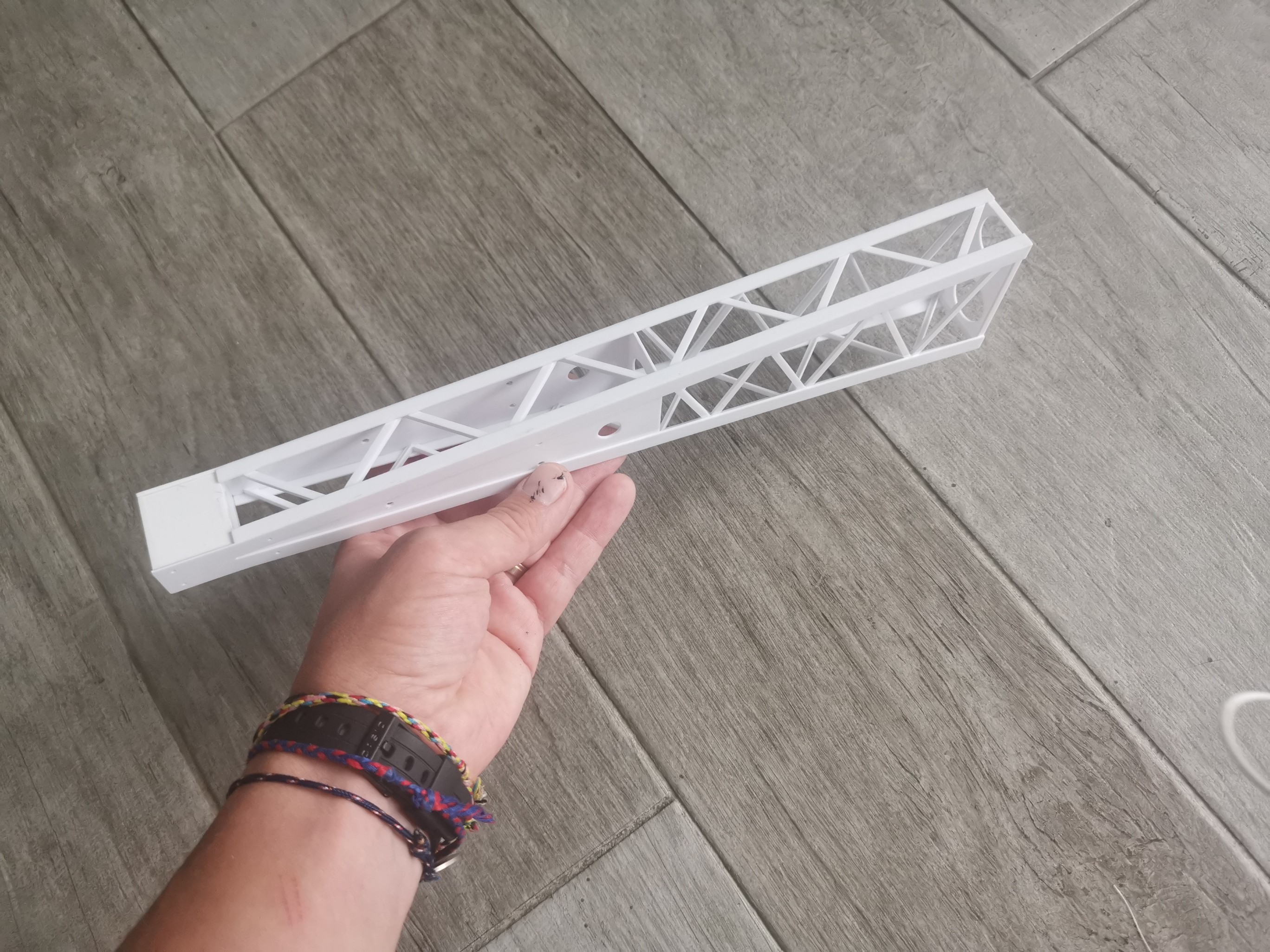

So now that part I is finished, it's time to start part II of this project !
This is a small box girder bridge.
I took as reference as much pictures I found as I can and the AFV Club kitparts as reference for the part breakdown when I designed my parts. The AFV Club kit is nice but not totally accurate. But to be honest, it's impossible to get it 100% correct, the pictures available are not enough, most often they are taken too far away and details like the bridge to churchill bracket is mostly hidden. I found some cool videos of a demonstration of Commonwealth soldiers building a SBG bridge (the one used with the Churchill was the same, with the middle portion removed and some parts added to it like the bracket, the 2 poles etc).

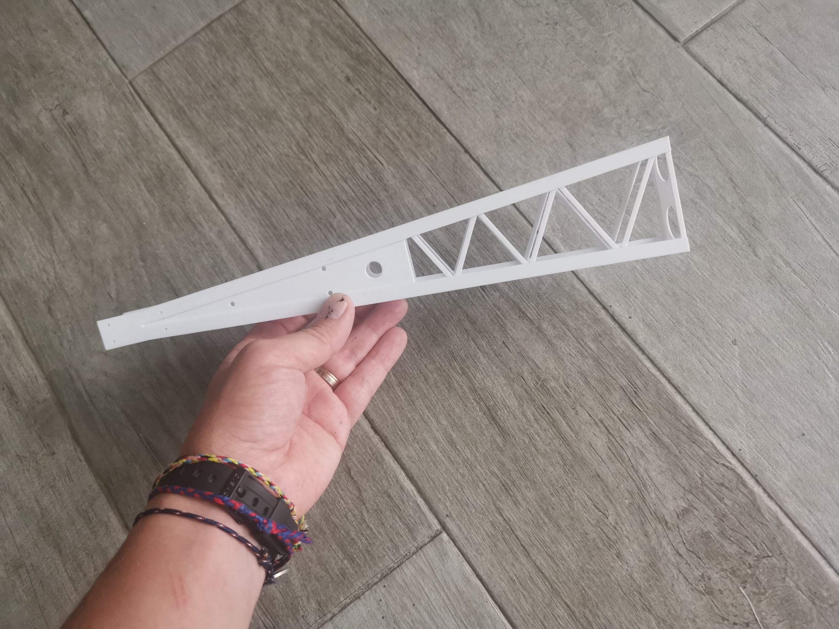

Parts have been designed in Rhino then I cut with the CNC. Instead of having individual corner profile, I prefered to make them as several sections with a M shape, like in the kit. It adds strength and it speeds the building, no need to cut them at the right length and gluçe it at the right angle...

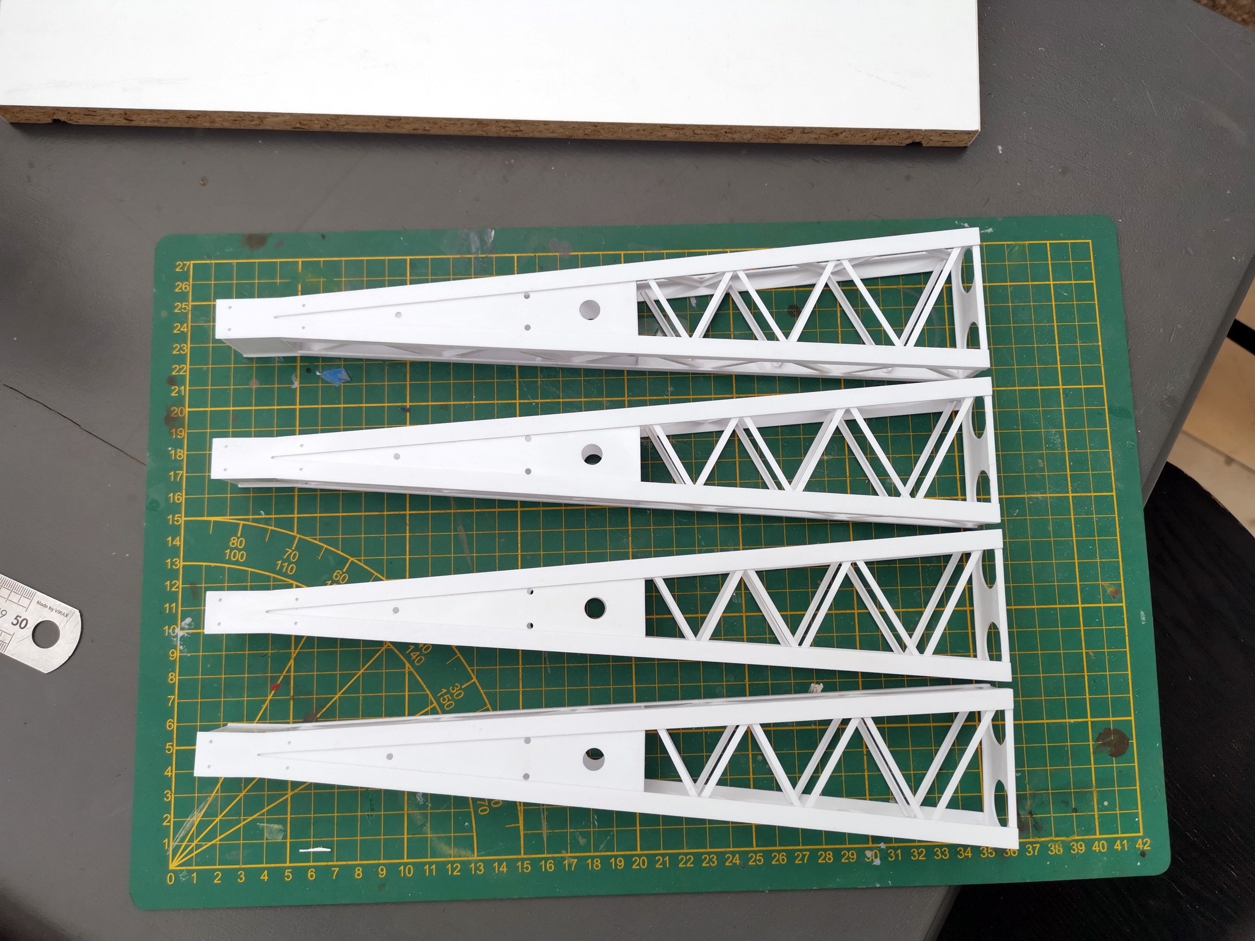

Most of the parts (but not all) for one section :

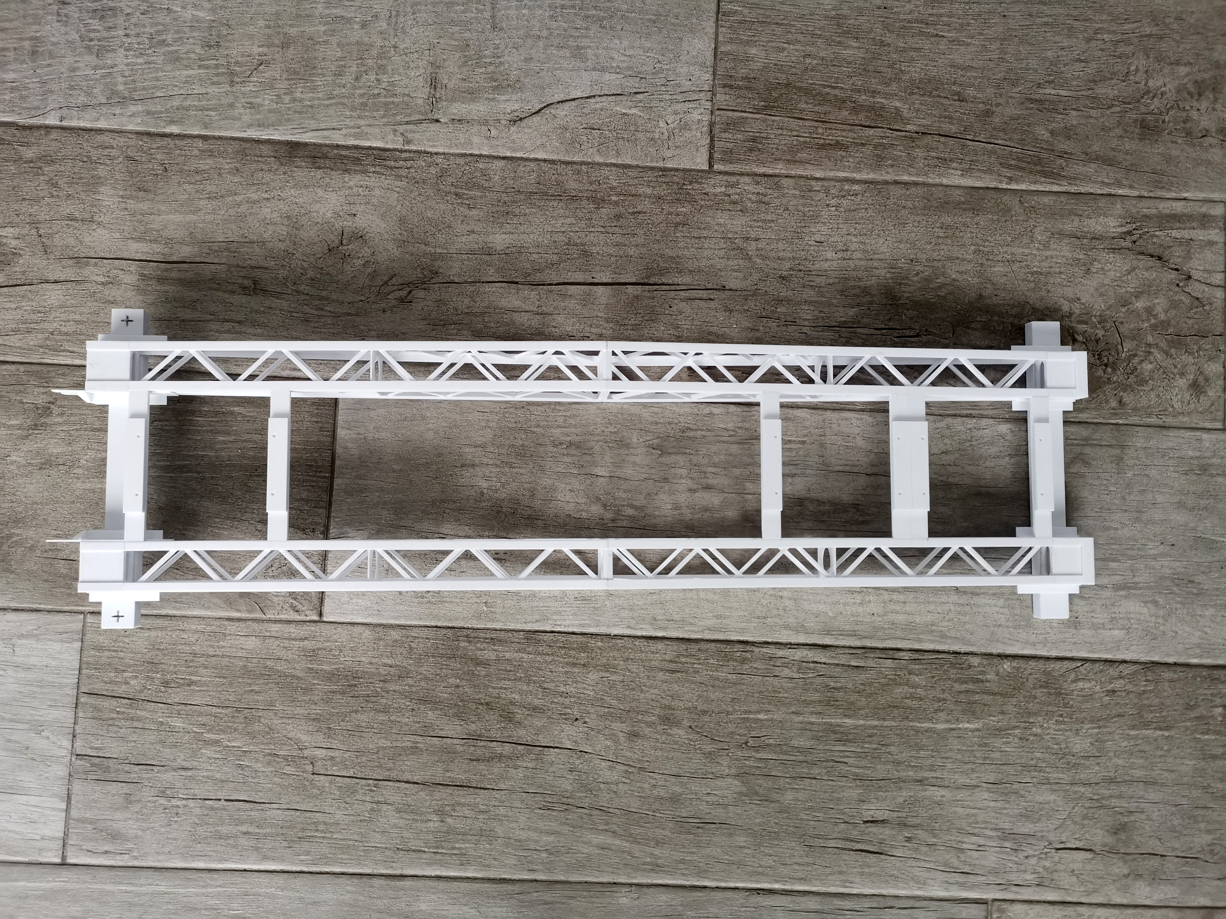

the 4 sections assembled :

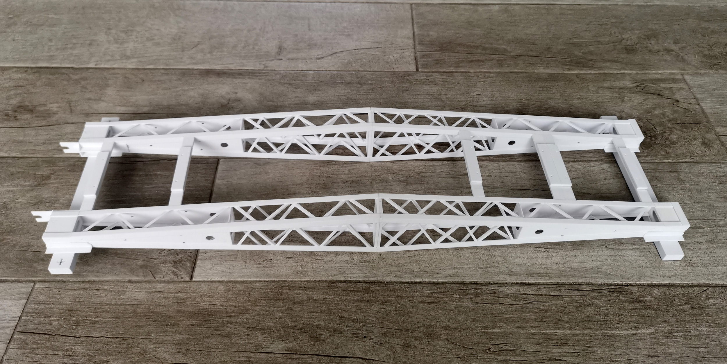

And finally it takes shape :
The planks will be made of wood, probably Samba wood as balsa would be too soft for the weight of the Churchill and its metal tracks.
I tested, the bridge has no problem to handle the heavy weight of the Churchill ! That's a good news. :)
