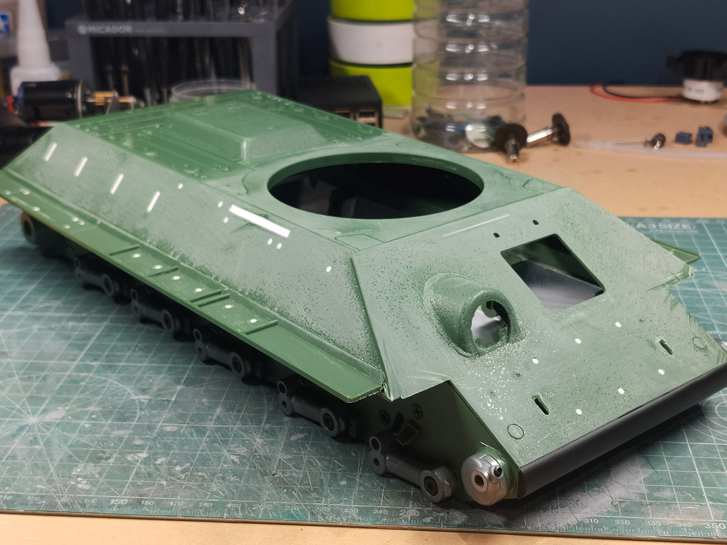

I think you're right, Derek and Mike; it's definitely not superglue. It looks like they've used the same stuff for the plastic and metal parts (the residue looks and feels the same), but It seems to have welded the plastic parts to each other. As the good Doktor suggested, I just needed to add a little violence...
If I had known how much of a pain in the arse this was going to be, I would've used a Trumpeter or Heng Long upper hull instead. You can see where the plastic has melted along the top of the rear panel and down in the triangular corners. The convenience of the Taigen upper matching the lower is far outweighed by the inconvenience of getting the transmission deck off. As always, I hope everyone else can learn from my mistakes!

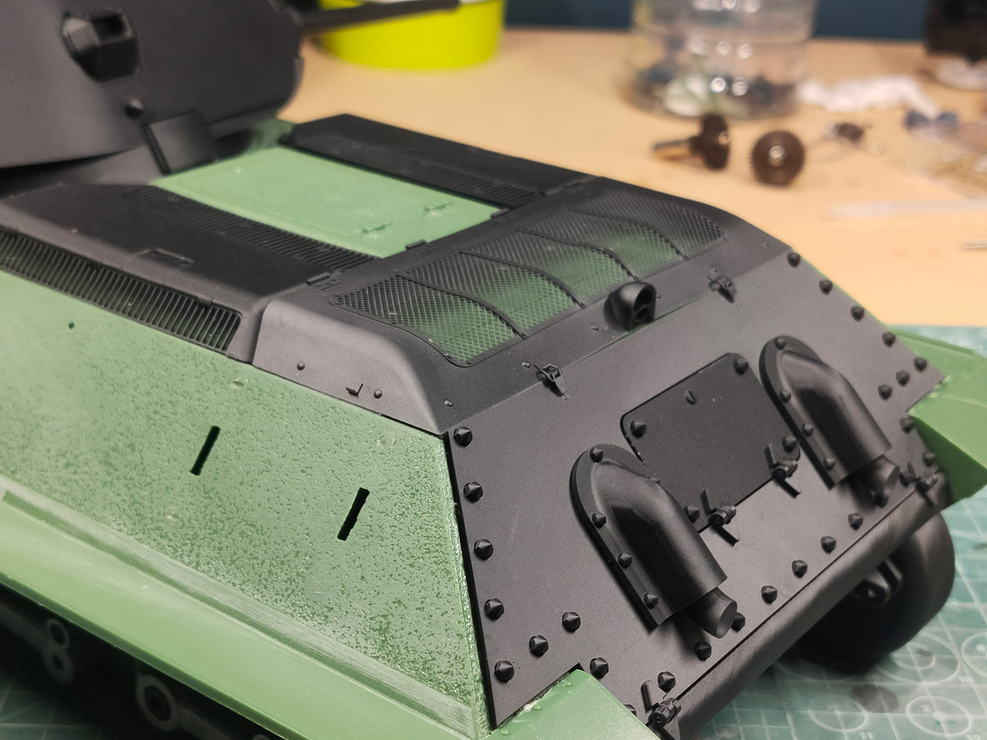

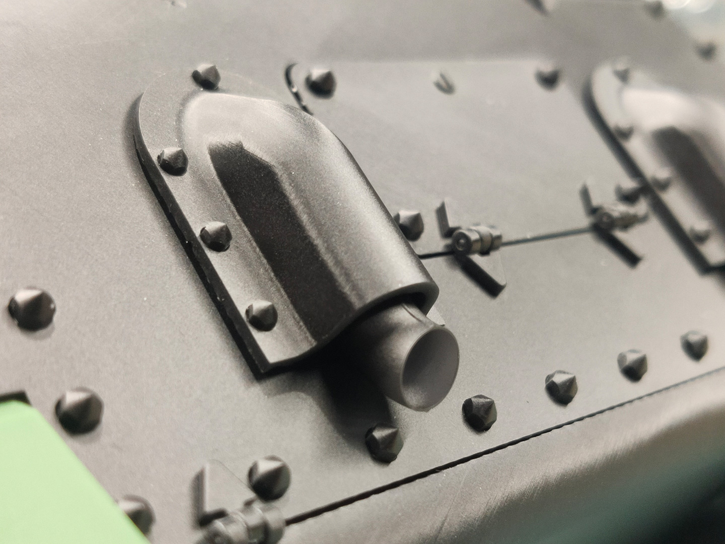

I've managed to get some test prints done during the week. The first set was to check dimensions and correct for differences between my original drawings (which were based on a combination of blueprints, the 1:16 Trumpeter kits, and a 1:35 Mono/Dragon T-34 1940) and the Taigen donor hull. You'd think they'd all match since surely they're measuring off the real thing, but it looks like the Taigen has the rear panel at 45° instead of the correct 42°. Three degrees doesn't sound like much, but it adds up to a few millimetres here and there; and depending on what you're measuring, sometimes every millimetre counts!
Here's the second round of test prints; everything now fits, but there are still some adjustments to be made.

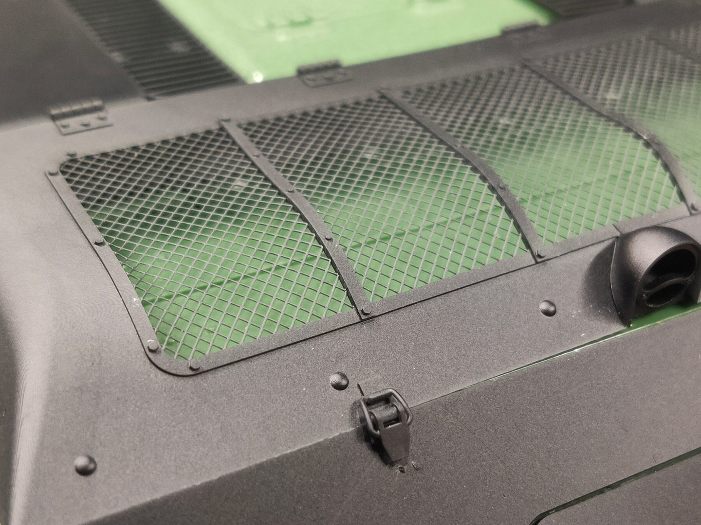

Again, I'm super happy with the quality of prints I can get with this new printer, here are some close-ups of some of the details:
The grille on the vent cover is actually modelled and printed, I'm amazed at how well it turned out. The mesh is surprisingly strong, and it sags and deforms realistically. I think it looks even better than a photoetched one!
I've got replacements for the front and rear lower panels in the Taigen lower to suit the earlier standard. They use the standard mounting points, and are fully compatible with the locking system for the upper hull and the bearings for the final drives for a seamless installation.

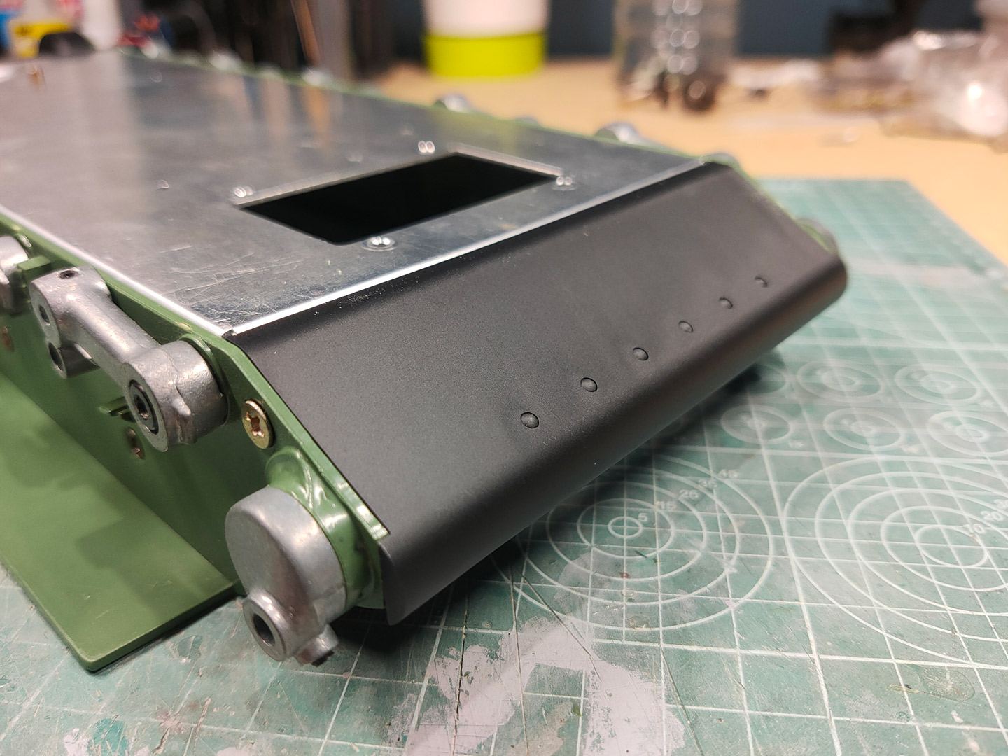

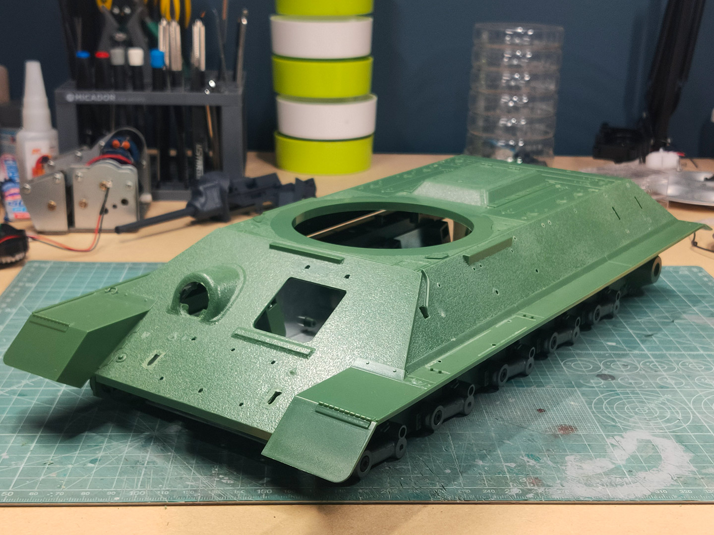

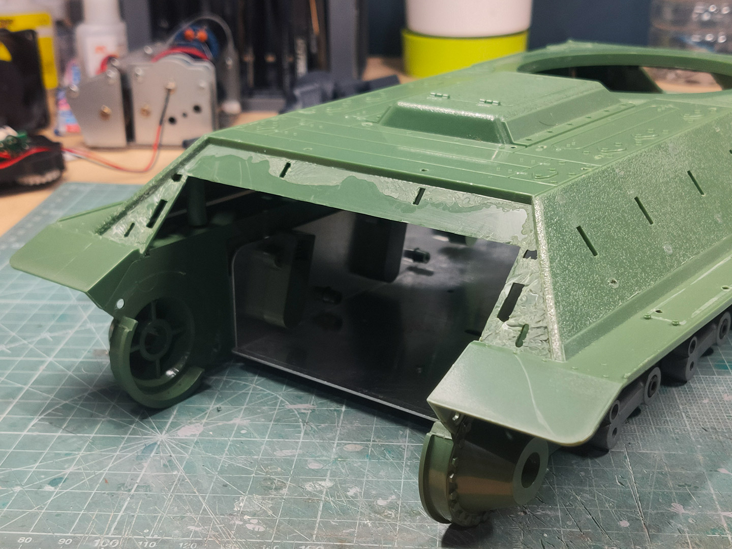

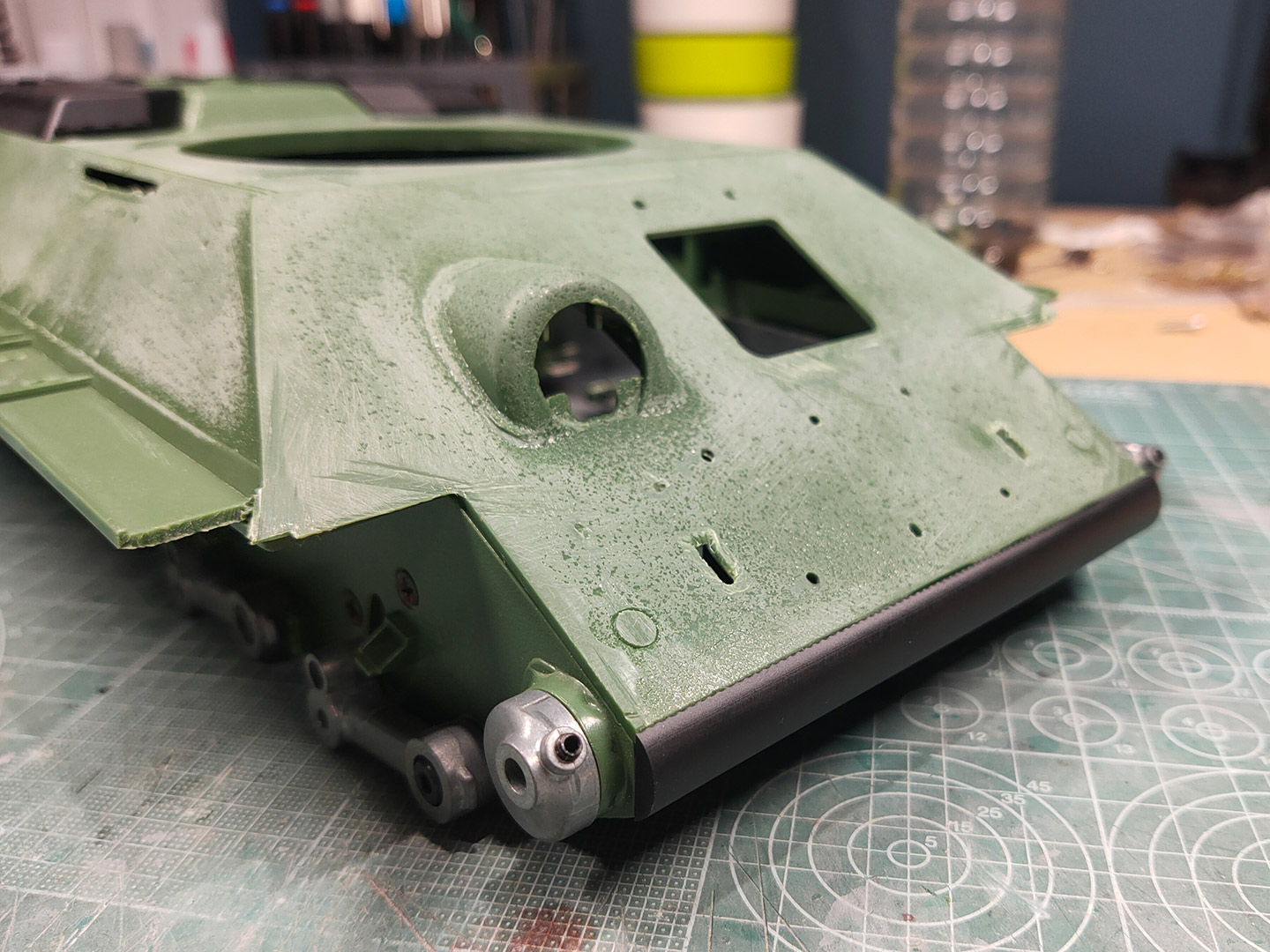

The front of the hull got the same treatment as the back. I would've done a neater job if I had sharp sawblades; these were chewing through the plastic more than cutting.
Some repairs with styrene tube and strips:
And then it's ready for some test prints. Just dry-fit and blu-tacked into place, but it's valuable to get a sense for dimensions. Ready for another round of adjustments and prints!
Starting to look the part, though!

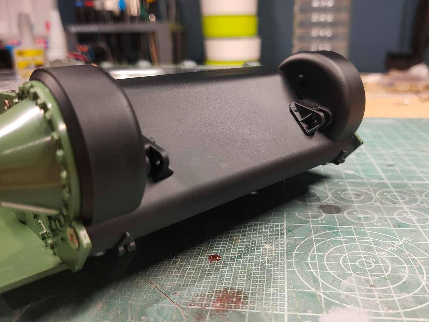

Those front guards look like they are off an old Morris Minor 1000 !!
Lovely rolled compound curves, way too nice for a tank.
