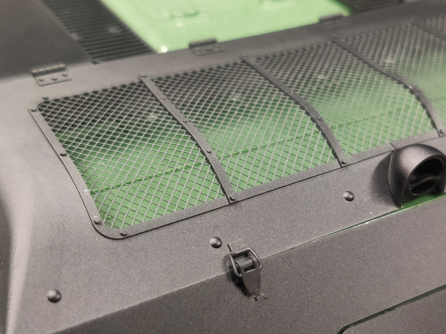

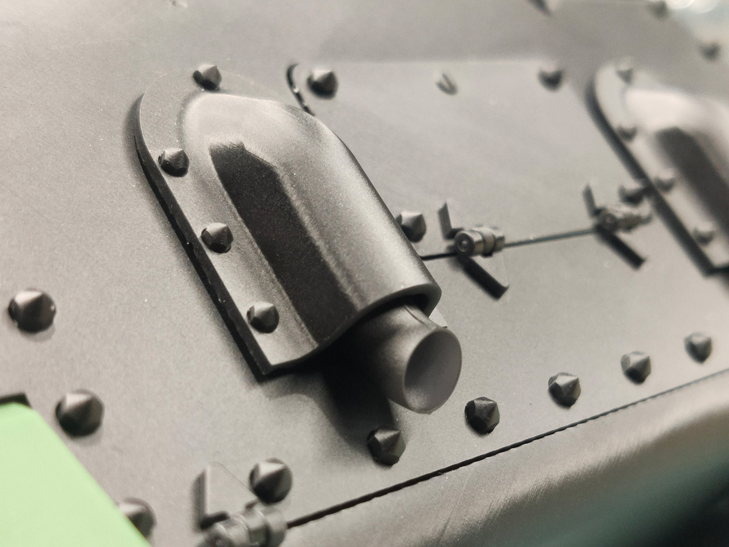

Again, I'm super happy with the quality of prints I can get with this new printer, here are some close-ups of some of the details:
The grille on the vent cover is actually modelled and printed, I'm amazed at how well it turned out. The mesh is surprisingly strong, and it sags and deforms realistically. I think it looks even better than a photoetched one!
I've got replacements for the front and rear lower panels in the Taigen lower to suit the earlier standard. They use the standard mounting points, and are fully compatible with the locking system for the upper hull and the bearings for the final drives for a seamless installation.

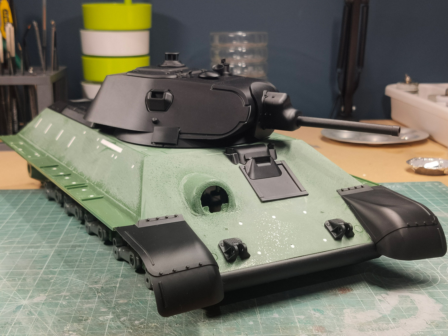

I went to a local art supply shop, the liquid pigments they have for epoxy and polyester resins work fine in 3D printing resin too (it's really only the initiators and additives that are different). Since they're meant to colour clear epoxy, they're really pigment-rich and great for our purposes. I think the UV-stable part is more so that the colour doesn't fade in the sun, which isn't really an issue if we're painting the parts. You'd just want black or any other dark colour to prevent light scattering during printing; white would probably cause blooming.
Meanwhile:

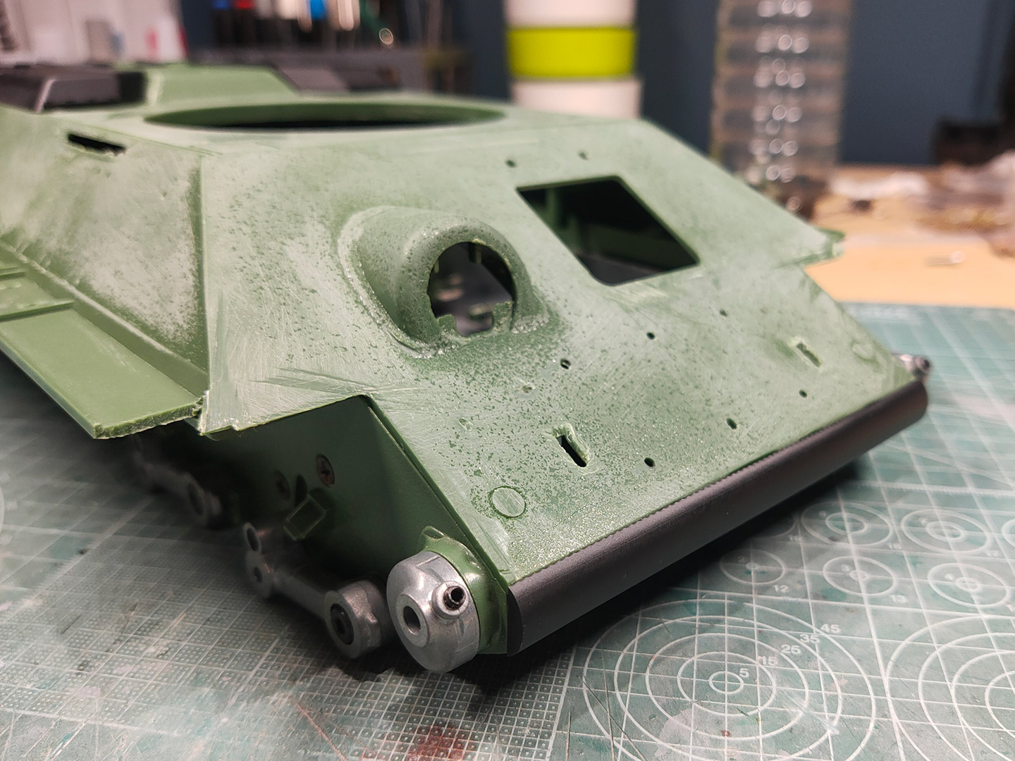

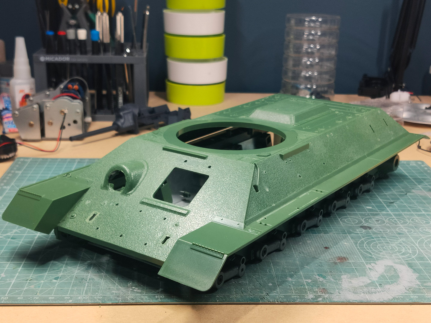

The front of the hull got the same treatment as the back. I would've done a neater job if I had sharp sawblades; these were chewing through the plastic more than cutting.
Some repairs with styrene tube and strips:
And then it's ready for some test prints. Just dry-fit and blu-tacked into place, but it's valuable to get a sense for dimensions. Ready for another round of adjustments and prints!
Starting to look the part, though!

Those front guards look like they are off an old Morris Minor 1000 !!
Lovely rolled compound curves, way too nice for a tank.
