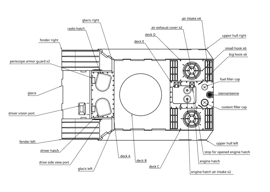

On this page you can download all available STL files: hull, upper, suspension and rear stuff. Go to Releases on the right side, and click on Source code (zip). Please read carefully the README file, this project is WIP and require additional non-printable parts.
Also take a look to the assembly documents, an example:
:wave:

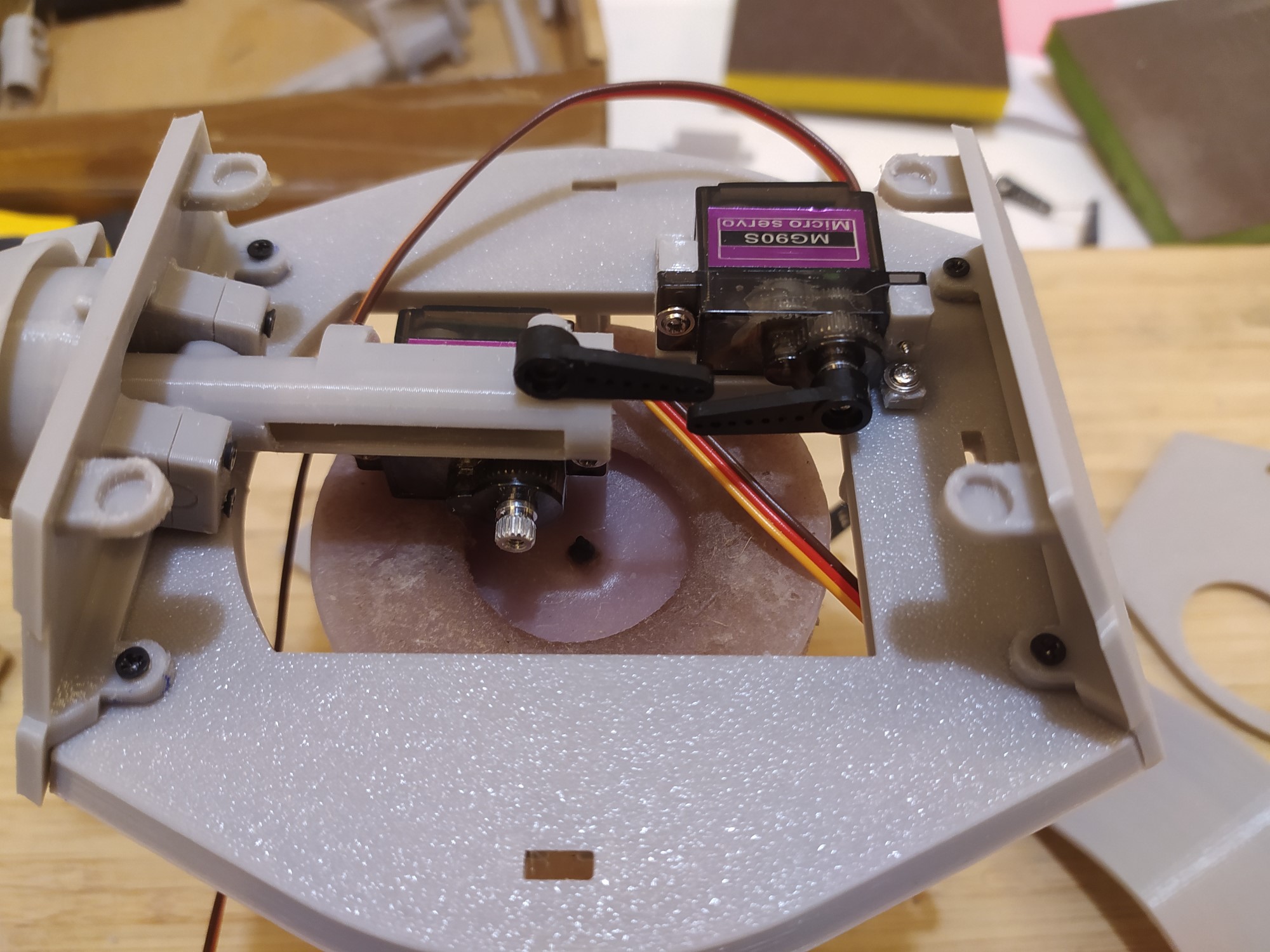

Hi gyus,

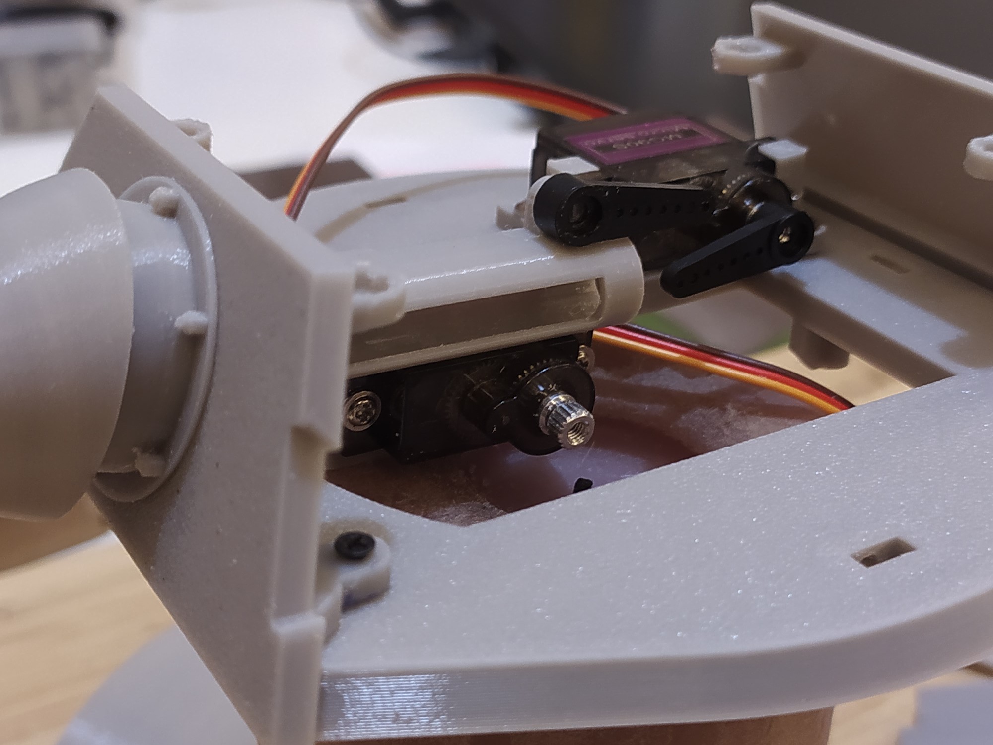

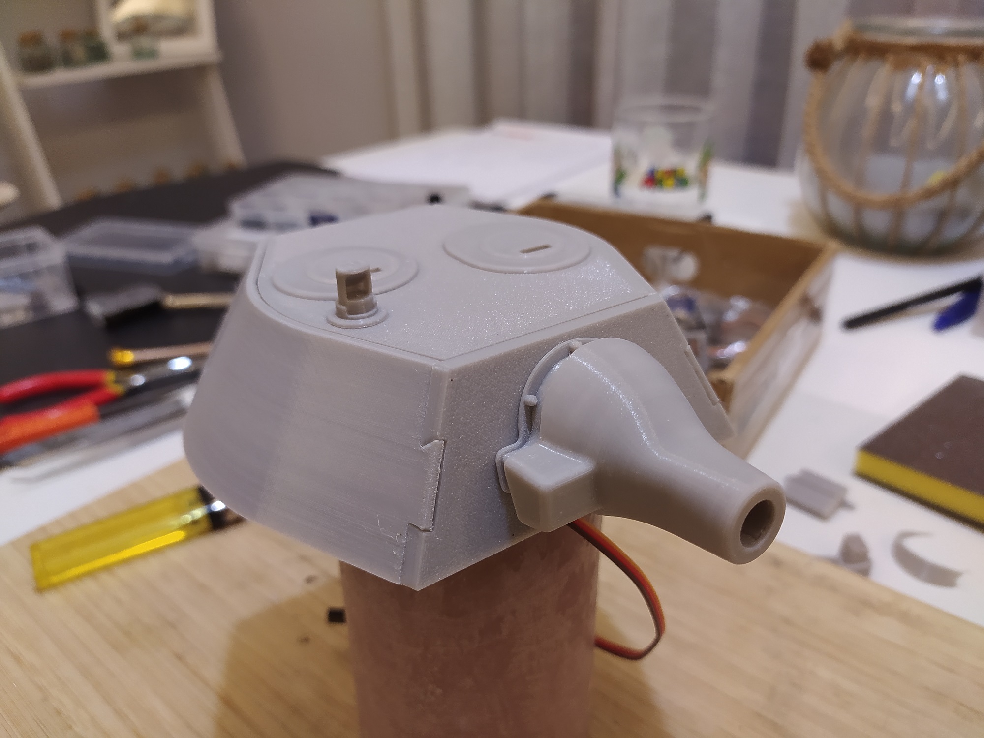

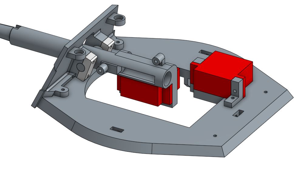

I've been busy with other projects, but good news! I'm about to publish the turret files, including turning, elevation and recoil ;)
I have spent hours and hours and hours redesigning and printing until I came up with a valid design. The recoil system is fully inspired in the RiskyR M4A1 Sherman.
A few photos of the model and construction:
turret 1.jpg (46.52 KiB) Viewed 3135 times
The entire turret and mantlet looks very smooth
:wave:

The first thing I was thinking when I saw your pictures: "hey, that looks familiar!" :haha:
Looks very nice, I'm glad I was able to inspire someone to do this themselves! Keep up the good work 8) :thumbup:

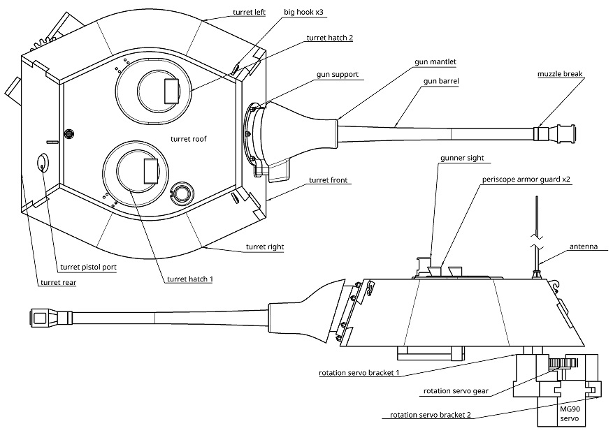

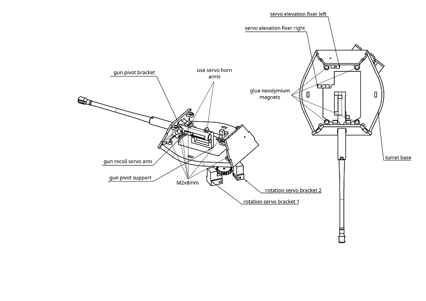

Hi guys,
I have released the turret files on printables: https://www.printables.com/es/model/245 ... 02-leopard
I also updated the assembly guide:
turret assembly 1.jpg (108.97 KiB) Viewed 3043 times
turret assembly 2.jpg (65.22 KiB) Viewed 3043 times
Enjoy printing 8)
