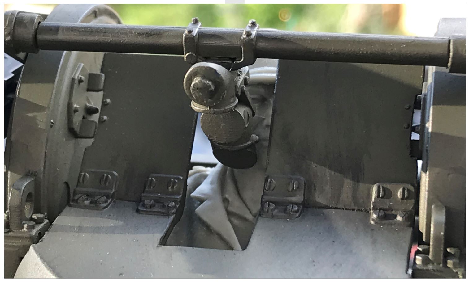

View of the radio armored box and loaders seats

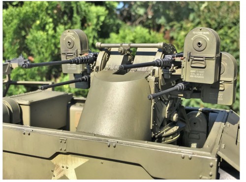

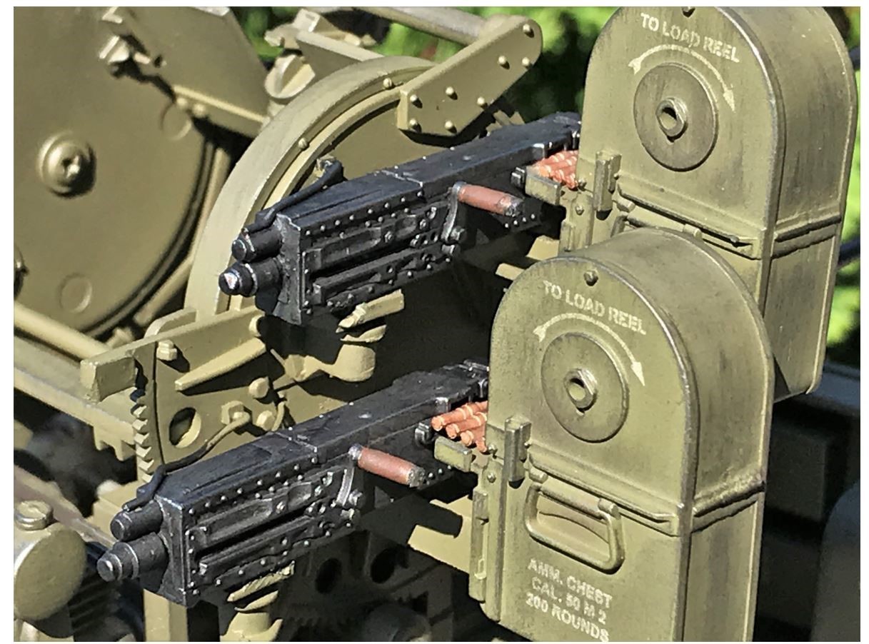

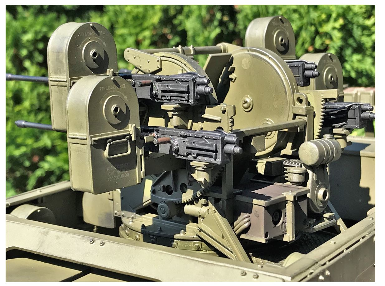

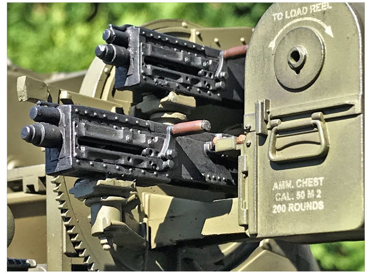

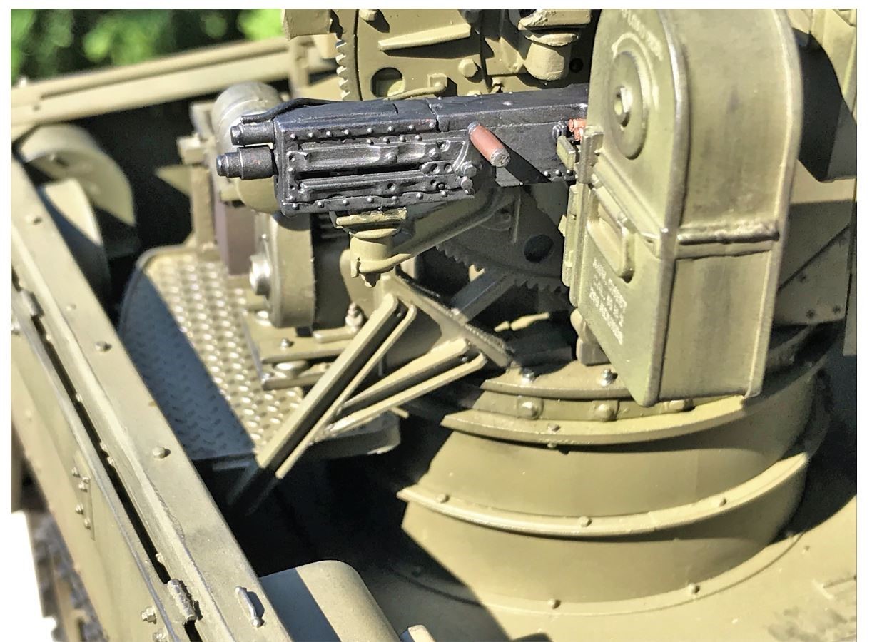

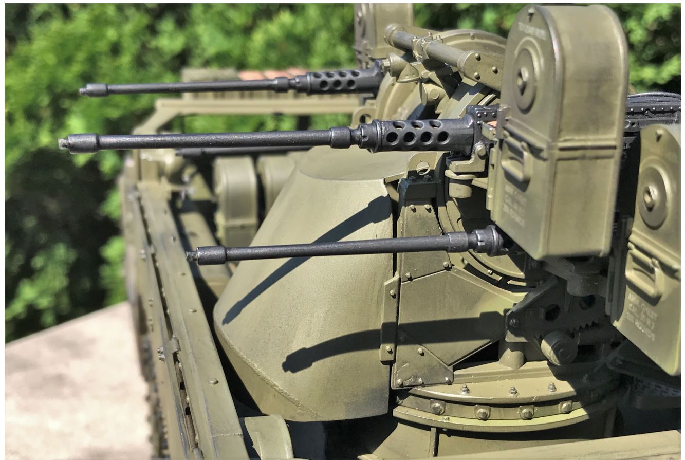

Now, the gun mount. The use of Tamiya M2 with brass barrels with Fibre optics really makes a difference compared to the original WSN guns.

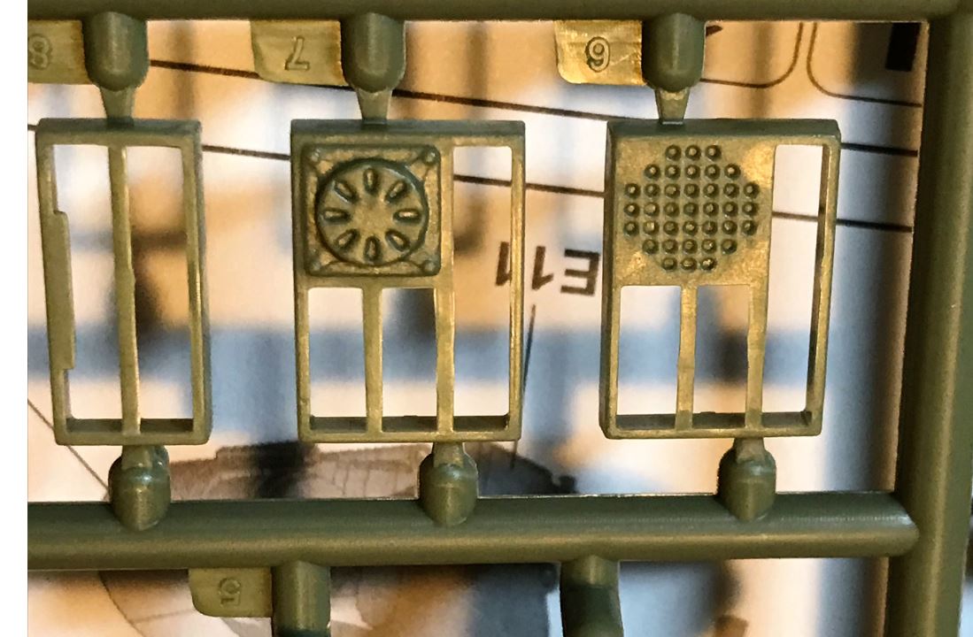

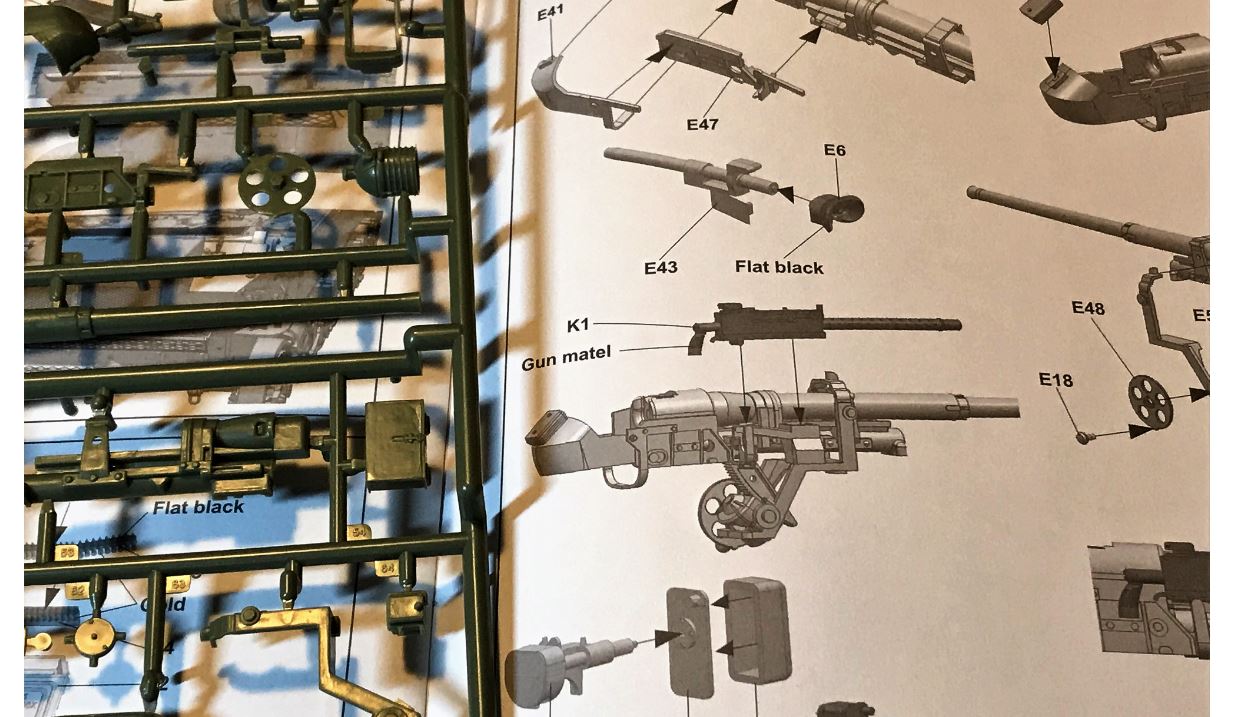

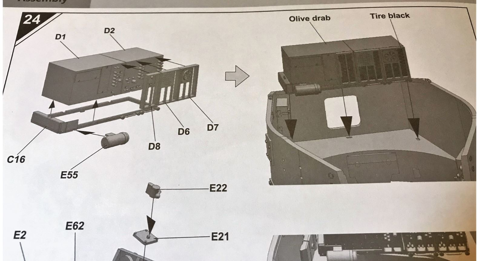

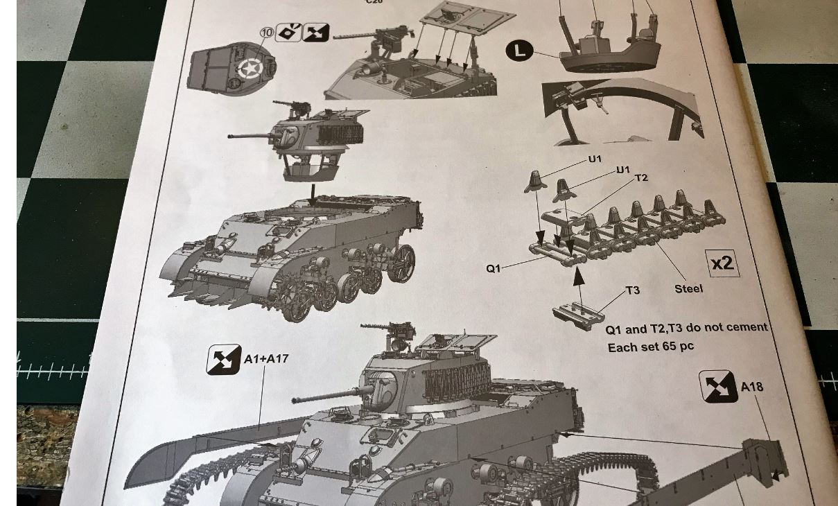

Of special interest for those who want to rebuild their M16. I just got this week the Classy Hobby M5A1 Stuart tank in 1/16 scale. Closer inspection show something very useful for the future that i was not expecting.
1/16 RC M16 Half Track MGMC Meat Chopper Korea build

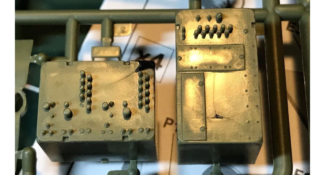

A US WW2/Korea tank radio in 1/16 scale ! Yeah
It's the type with 2 receivers and comes with the base. This is a first in 1/16 scale. If i had known, i would have been able to use it when the plan is to convert the M5A1 for RC and detailed interior becomes redundant.
It seems perfect for the Torro and WSN M16, and well detailed.

Also of interest to modellers is that the kit comes with a fully detailed turret interior, basket and everything, including the 37mm M3 gun. I can see a lot of use for this gun in 1/16 modelling because it was installed in many WW2 vehicle.

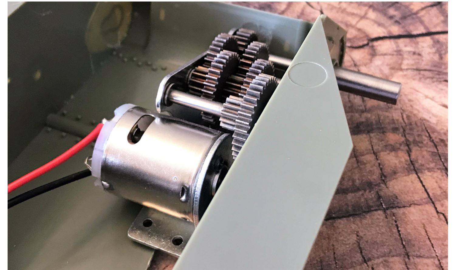

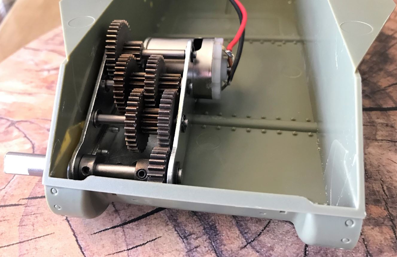

Re: M16 Half Track "Meat Chopper" Korea 1950 - Build
BarryC wrote: What gearbox did you order?
Mato panzer III MT197, it almost slides right in. I only have a right gearbox for tests, but it only needed some grinding of the front inside armor for the last gear to determine its a good potential for integration. To fit properly and give the last gear some room to spin, i will need to grind one more mm all the way through and apply a plasticard sheet on the outside. Height seems good for left side. I like the Mato gearbox because the main shaft can be easily removed, reworked and put back. But i am not recommending it yet until i have installed it and worked out the integration, seen the behavior with the suspension, tracks and what reinforcement is required. But that will be a story for another build.

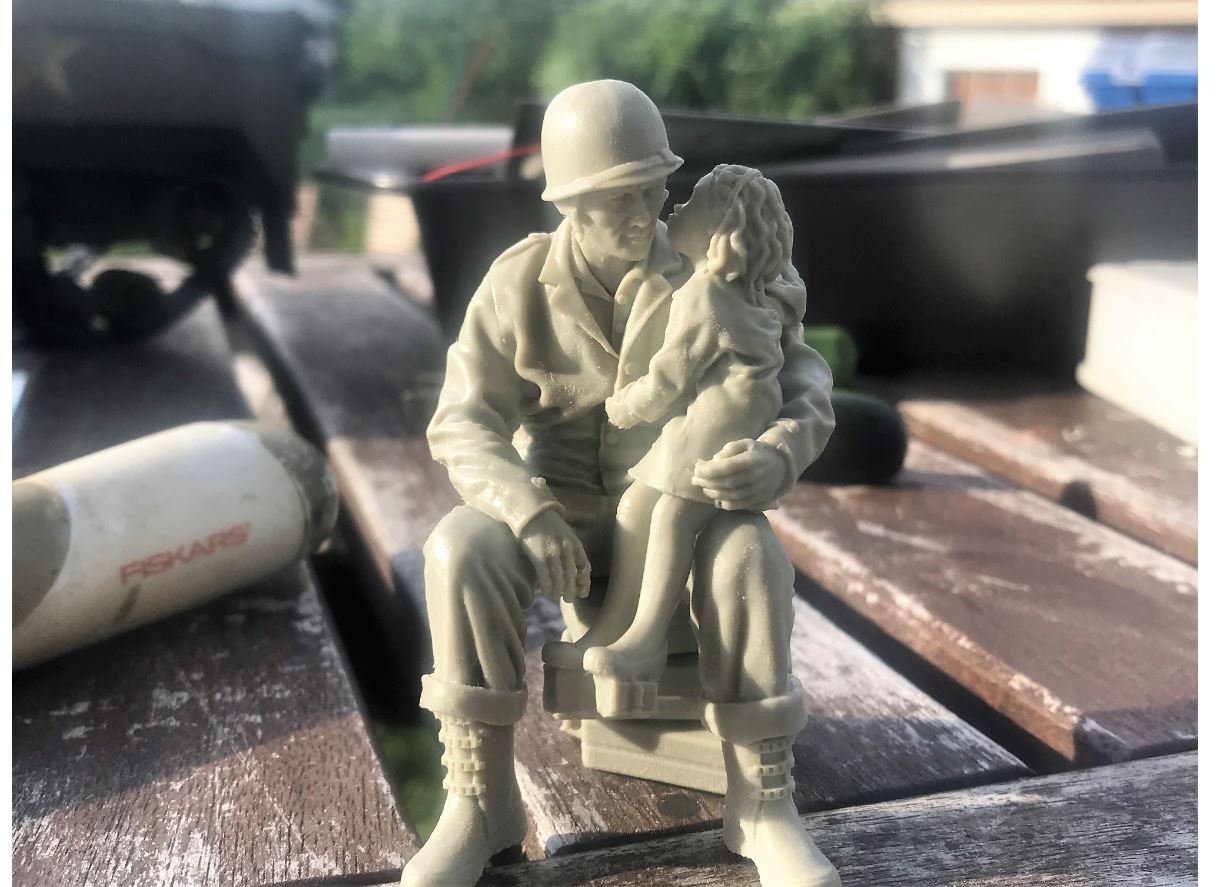

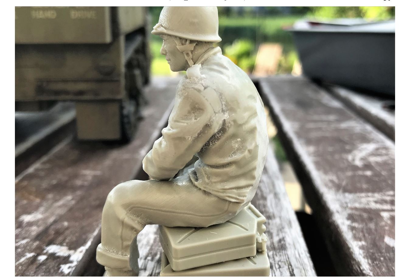

Here is a short post for the M16 gunner.
I received this figure today from eBay China, a 1/16 resin US soldier with little girl, about $22 with free shipping.

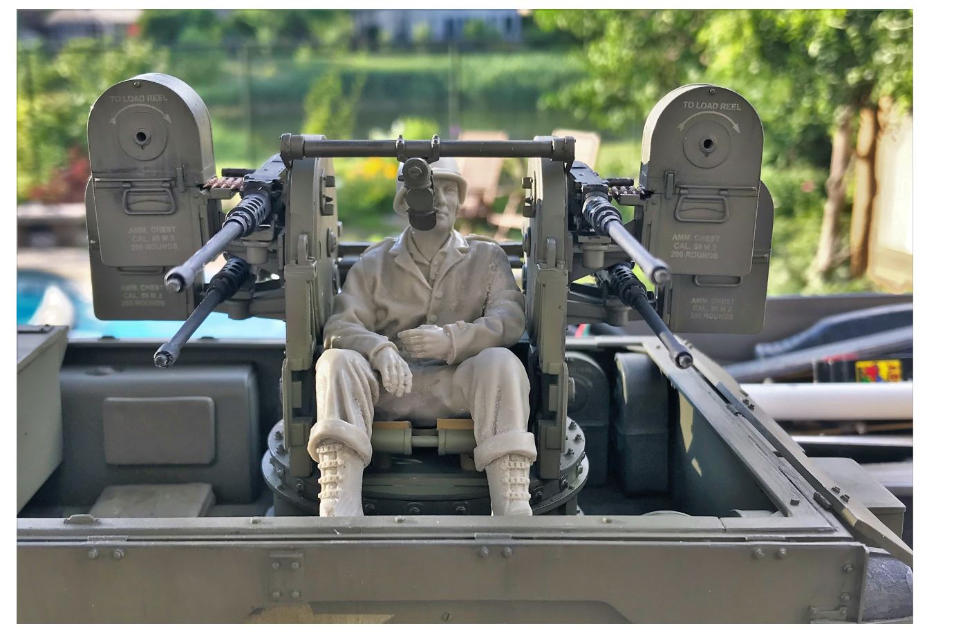

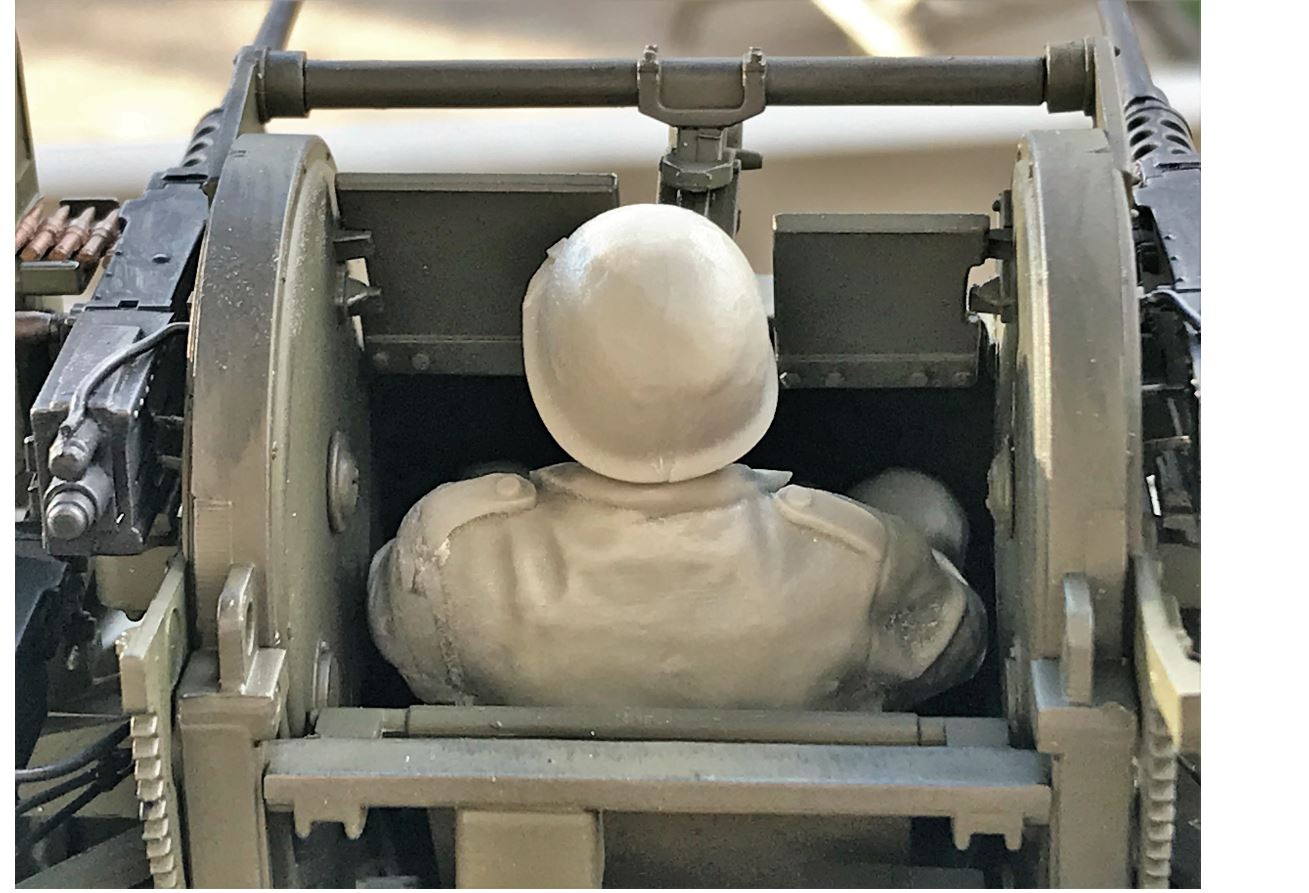

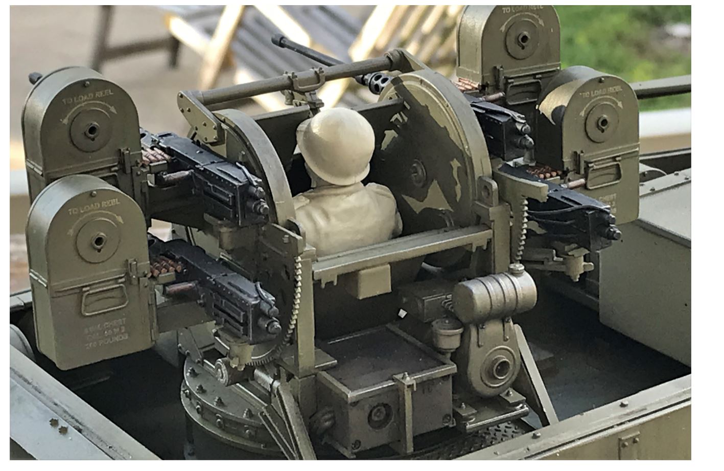

Dremel time. To fit the M45 quadmount limited gunner seating space, minor adjustments are required. Need to give his back a slope matching the quadmount seat inclination, cut a bit of the feet and calves to fit in. The left arm, freed of the little girl, is repositioned towards the inside. Residual resin pieces are cut and put into the gap with superglue, then sanded.
He looks pretty comfortable in his gunner's seat.

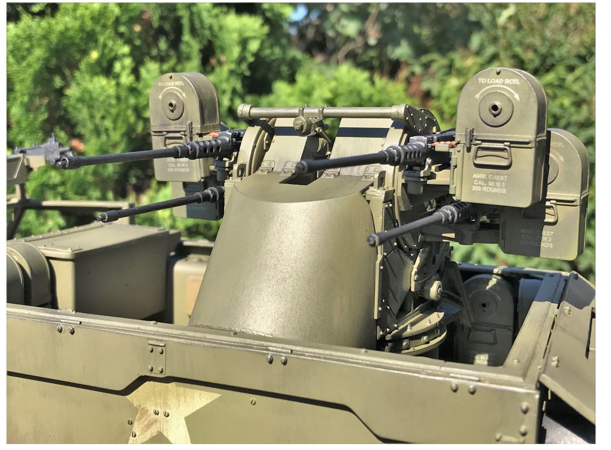

Repositioning of the frontal quadmount armor. The gunner is properly looking into the sight.
Here we go, from a little girl kisser to a mean M45 meat chopper quadmount gunner in the M16 crew. His face is correctly oriented towards the ground for the massacre. Just need to check that the gun elevation is still ok with the figure in place. Painting will wait for the other figures to arrive.
