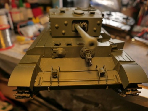

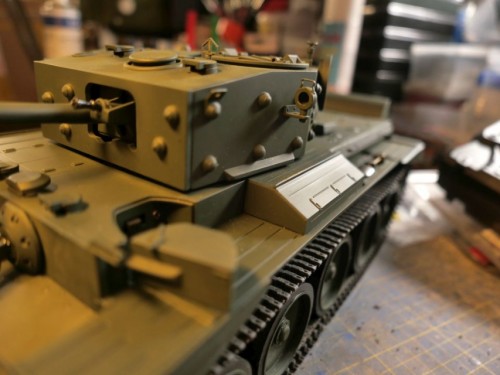

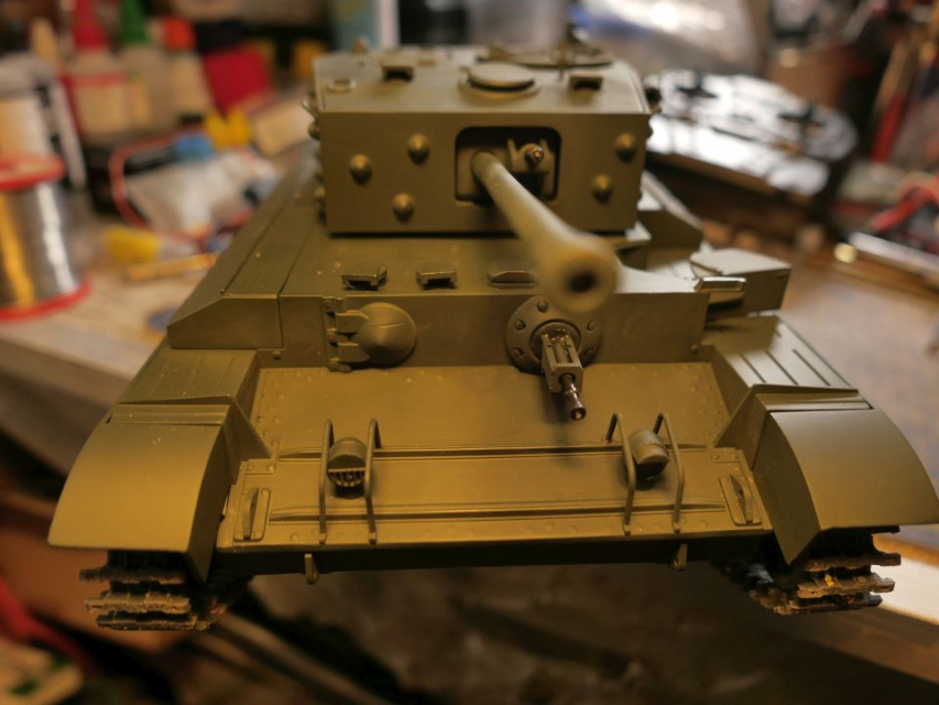

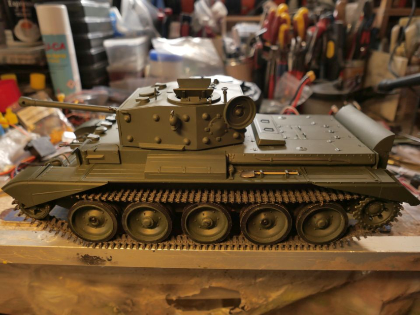

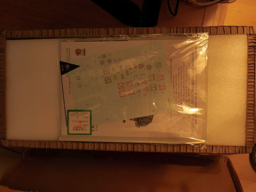

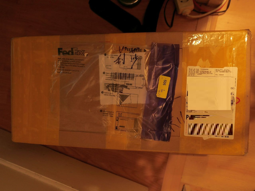

received the Cromwell today.
Ordered at 16. June - then nothing happened
yesterday tracking information was online - delivery date 05 July
Today the doorbell rang, the Fedex man was there with a large package...

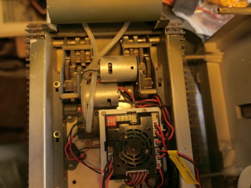

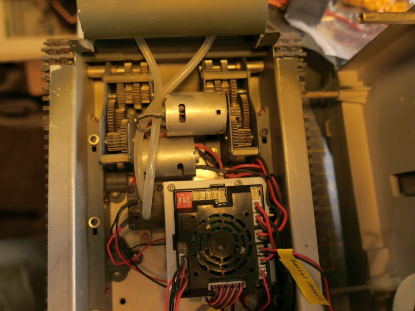

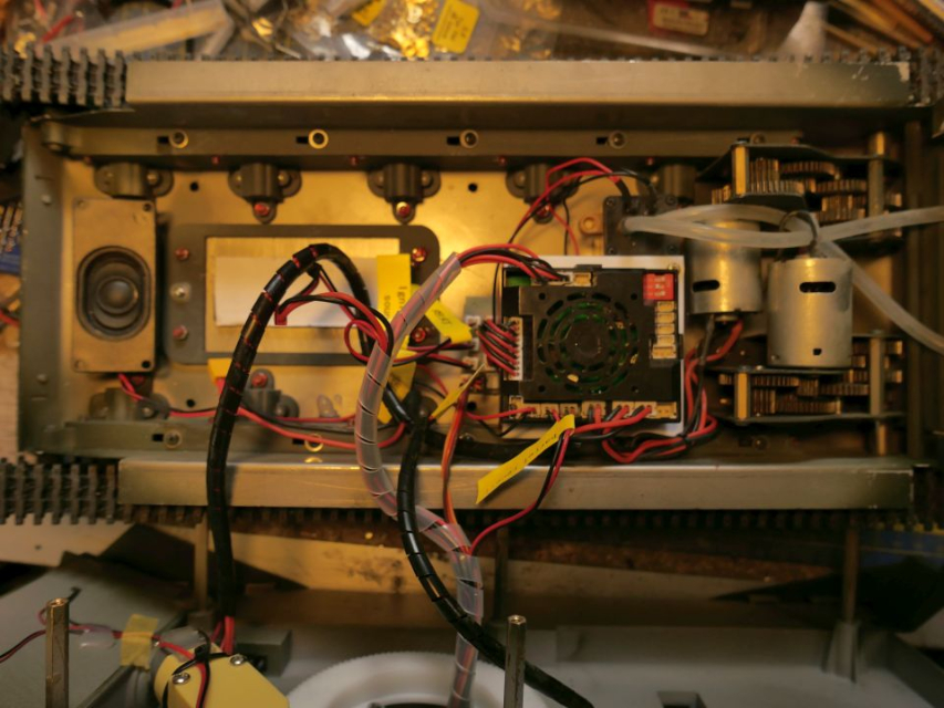

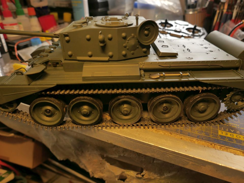

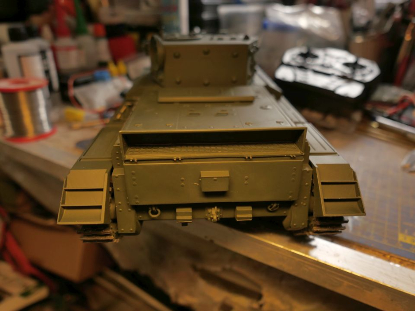

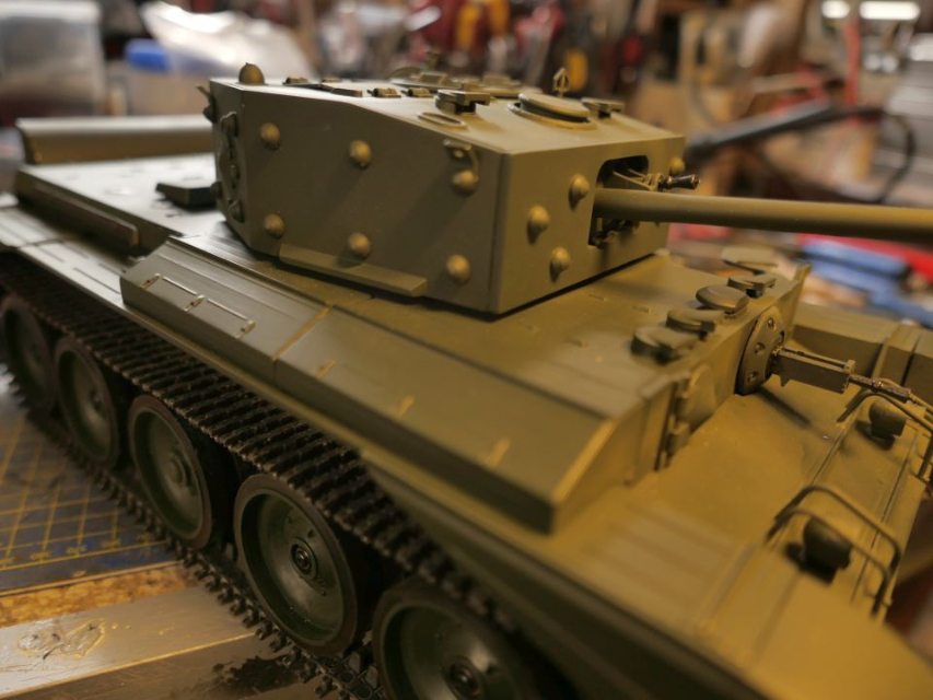

The hull is made of sheet metal
and the gearbox are the same as in the T-55 - steel gears and ball bearings - ratio is 52: 1
the upper hull ist mounted by six hexagonal studs - those are all metal parts..
The model is built entirely from 3d-printed parts.
Most of the parts are manufactured by resin 3d printing process a few parts were created using FDM printing.
The resin parts are very fragile, especially the parts of the suspension.
Therefore i recommend this model is not for beginners.

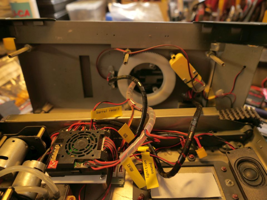

The VCU is like a Taigen V3 - it is notchy and sluggish to steer...
Smoker, light and volume can be switched from the transmitter
When the shot is fired, a servo is responsible for the barrel retraction and the absolutely useless track recoil is also available too.
The tank is painted in typical british green and the color stinks!
Really, the color stinks like a burned down house...this is also the first thing you smell when the box is opened.
the quality is exactly as you know it from hooben
one loved or one hated it ..
I will not make a recommendation.

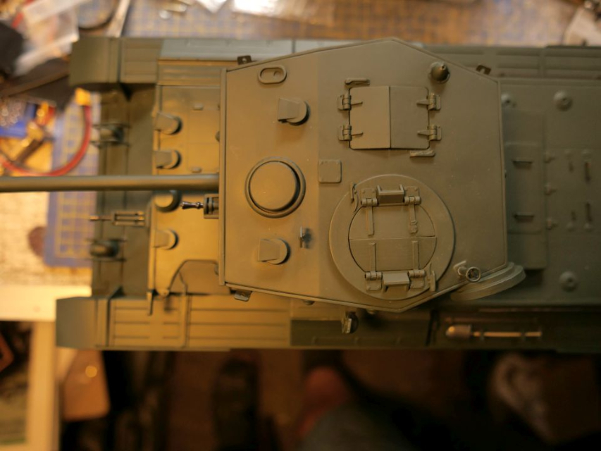

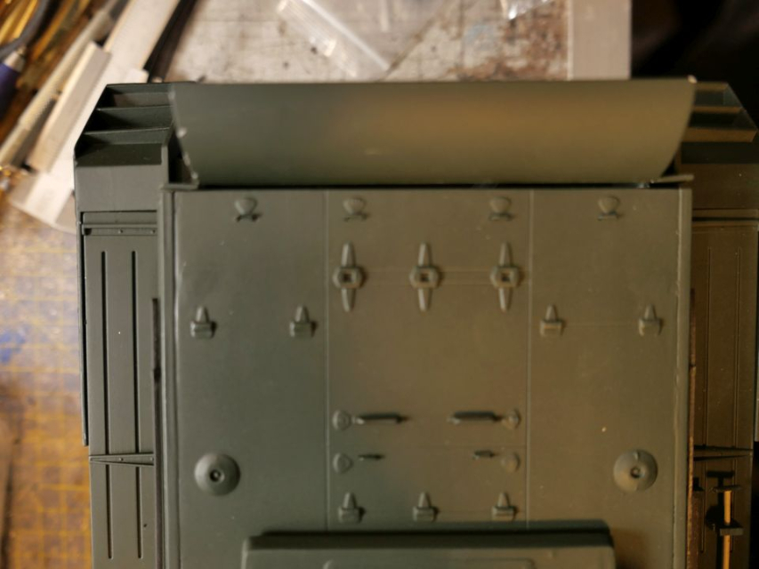

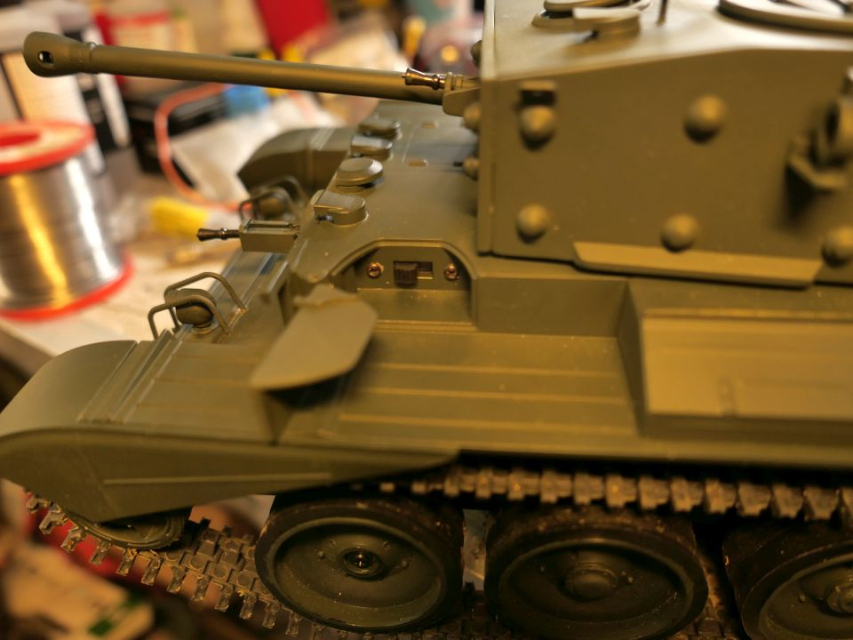

more pictures...

Are the tracks made of nylon?
jhamm
Posts: 1100
Location: Germany
Re: Cromwell from Hooben
Post by jhamm »
Kaczor wrote:Are the tracks made of nylon?
I think so...
